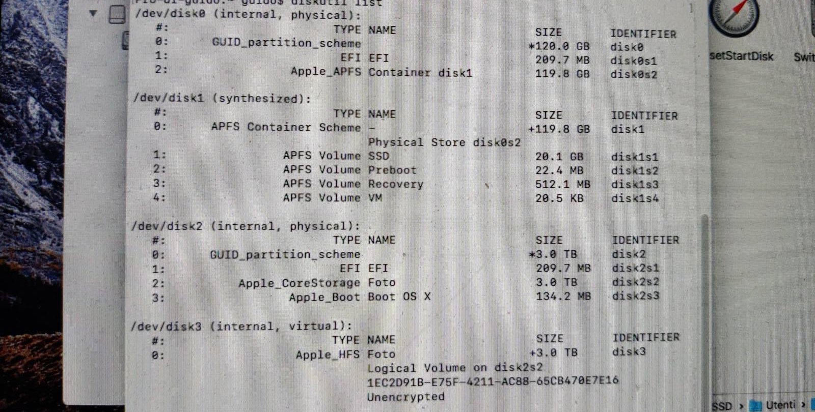

Hi there, trying to install but DeployESP gives Fatal Error: PhysicalDiskCheck 01.
Mac Pro 5,1: High Sierra.
Any suggestion? Thank you
I see.
Launch Terminal, run "diskutil list" (without quotes) and post a screenshot please.
Looks like a Fusion drive?
If so, then these are not currently supported.
Sorry that this is not explicitly set out anywhere (Configfactory only mentions RAID but this meant RAID and Fusion drives).
I will rectify this.
Try to find a regular HFS+ drive to use.

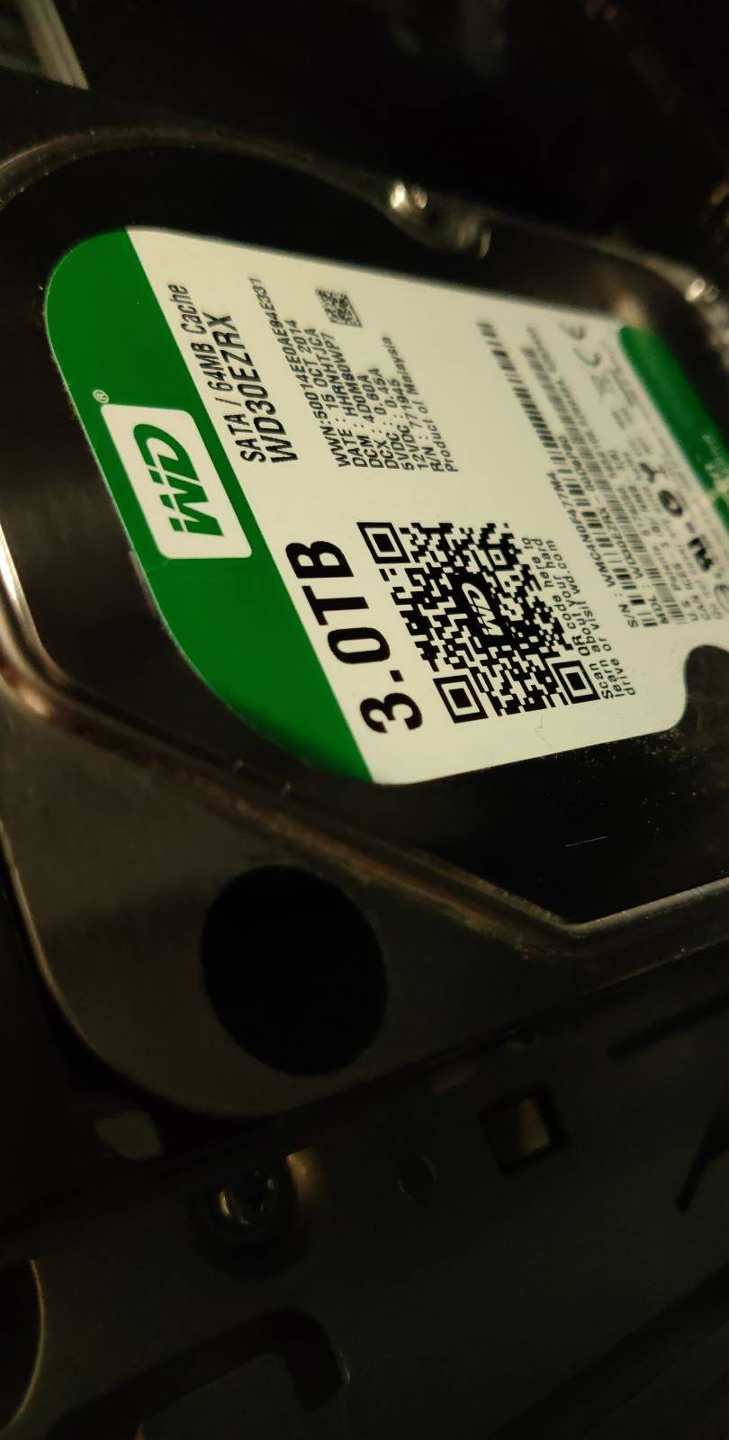

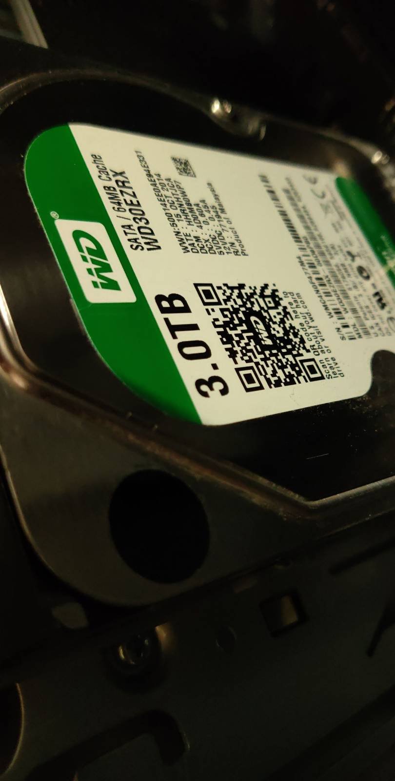

Thank you but is not a fusion drive, normal classic WD. It was used on a 3,1 catalina macpro and moved to my new 5,1.
I understand but is a normal WD caviar Green WD30EZRX. I can try to reformat? Thank you.
You could still use it as is but will have to do everything manually in Terminal.
As long as it is a standard HFS+ drive, the apps will be fully automated and on standard APFS, semi-automated.
I will amend the apps to handle such drives and update the guide with the manual commands later.

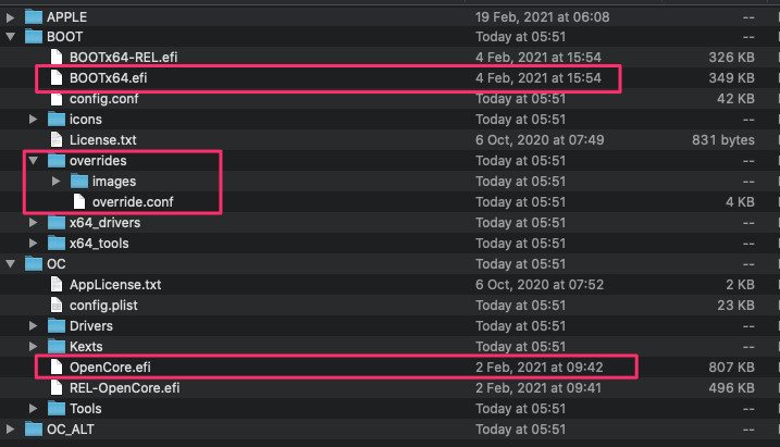

v067 of MyBootMgr is still deploying RP v0.12.0.AQ and v0.6.6 of OC. Can you please check your distro?
Edit: just checked twice by reinstalling v067 release of MyBootMgr and deleting previously deployed EFI folder on EFI target drive.
Just downloaded v067 again and installed. Checked the deployed EFI folder and the same old structure from 066f is present. BOOTx64 also has older time stamps.
Oddly, even without a MyBootMgr_BAK folder present in the /Shared folder, ConfigFactory is asking if I want to use an existing configuration.
My fault ... I uploaded to the wrong folder (you had the same package as before).
Should finally be sorted now.
