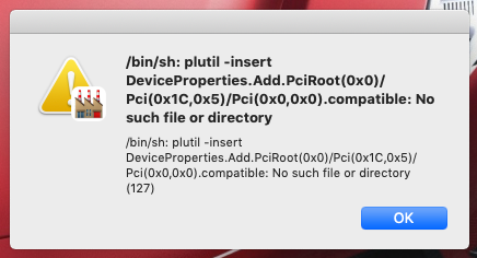

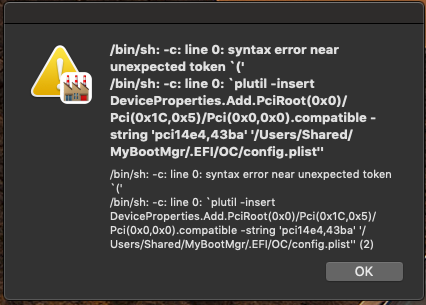

Hi Dayo. Have a question and one issue to report:
Question: what does enforcing CSR entail? Default is NO.
Issue: when attempting to build the configuration, ConfigFactory returns the following error:

Enforcing CSR is for RefindPlus to actively enforce a specific SIP setting, either enabled or disabled, whenever it is loaded.
That is, it will always specifically set the SIP as you specify if you have a reason to do so.
Default is that you don't have a specific reason to always want to make sure SIP is always set in one specific way every single time you boot up.
On the issue, try downloading again and rerun.
Let me know whether it is resolved. Thanks.

OK. Try again.
That worked.

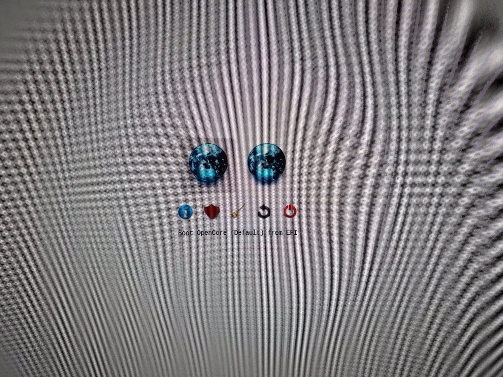

There's something strange going on with RefindPlus and it's a repeatable behavior.
When RP boot picker appears, I have four main options:
  1. OpenCore
  2. OpenCore (alternate)
  3. MacOS Mojave
  4. MacOS Big Sur
If I select option 3 (Mojave) and then restart the computer, RP boot picker no longer displays option 3. Options 1, 2, and 4 remain visible. However, booting into OC Big Sur, then restarting the computer will cause option 3 to reappear again.
Edit: I should mention that this behavior only appeared after going to release mode.

Had a few of those myself a while ago.
Not sure what cleared it. Maybe Triple NRAM Reset.

I'll try an NVRAM reset but just to let you know, going back to debug mode caused me to lose the Vanilla Big Sur boot option as well.

Disregard; triple NVRAM reset sorted it out. Probably had some conflicting weirdness with whatever 067 left behind in NVRAM.

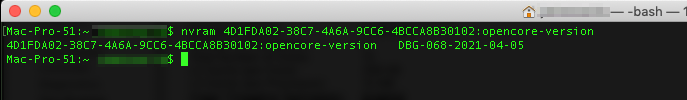

0.6.8 working fine on both of my cMPs.
Just one question: I have been in the habit of enabling SIP with CSRUTIL ENABLE --without kext --without fs and that brought greater stability to Photos app (stopped incessant iCloud syncing, which took days) and other oddities that I cannot quite remember now. So is this still necessary? Does anyone else use the --without conditions above, and for any particular or specific reason?
