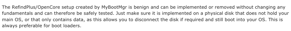

Hi, I'm gonna try the installation, but before, I have some questions.
-Is step 3 (soft bless with a non-opencore macos) mandatory ? Cause if it is, i have to install my GT120 and MacOS just for that ..
-Also, will my big sur nvme install still launch via opencore like always ? I don't want to mess up the config for my main OS ..
-And can the bootmgr be installed on any HFS drive ?
Thanks a lot.

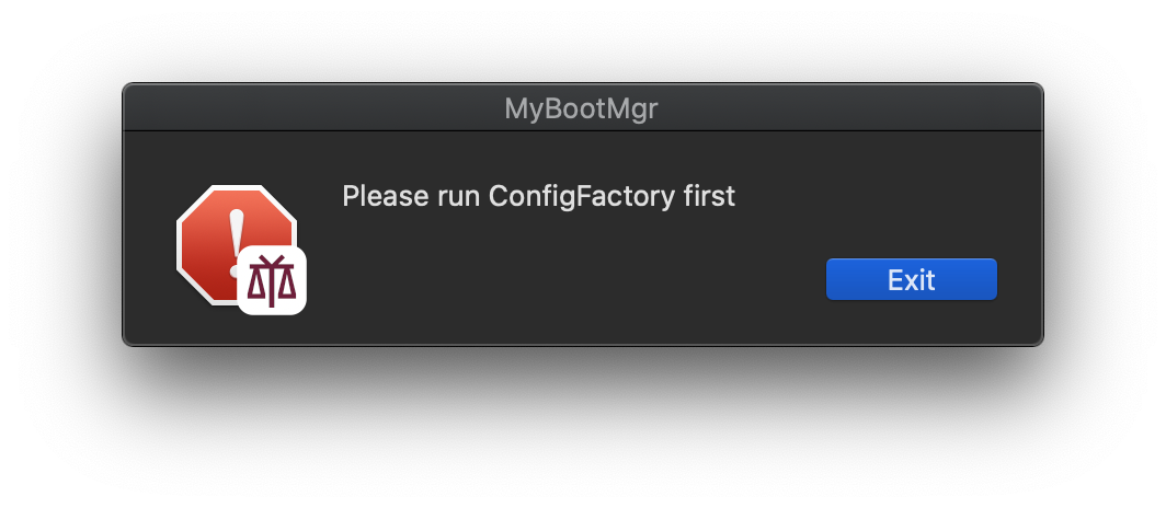

VerifyOC did not work for me either, so I skipped it.
What error did you get exactly? Can you post a screenshot?

ok, VerifyOC tells me to run ConfigFactory first, but obviously I cannot run ConfigFactory with OC.
You can run it with OpenCore. Users will not be able to upgrade MyBootMgr setups otherwise.
However, that is a flaw in VerifyOC. Will sort that out.
