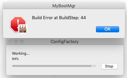

@Dayo I'm getting a build error.
I run ConfigFactory 0.7.1d (currently on 0.7.0b) with manual options (and then later using the default config) and always get to 94% with Build error at Buildstep: 44
I have double checked that SIP is disabled (first time via RFP main screen, second time via booting into Recovery).
I have double checked that SIP is disabled.
You actually don't need SIP enabled to use ConfigFactory and if an issue is SIP related, only relevant to app such as BootBlesser, it will be mentioned.
Anyway, will post a fix for this issue shortly

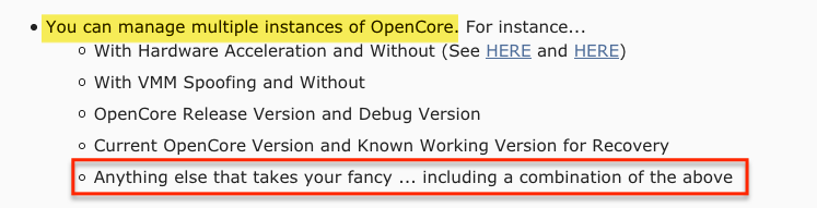

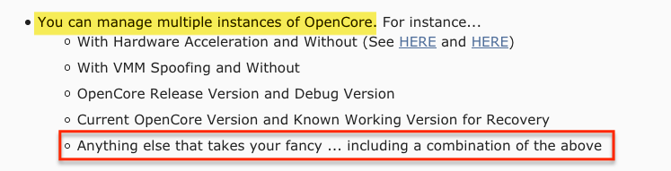

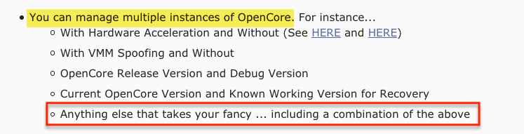

  • OC - Current Version with GPU Acceleration
  • OC_ALT - Current Version without GPU Acceleration
  • OC_Dev - Builds of the GitHub Code for Testing
    • Can easily misconfigure something here, in which case recovery means simply rebooting and selecting another instance.
    • No need to pull disks, reset NVRAM etc
  • OC_WRK - Some old known working implementation of OC (I think it is v0.5.9)
    • Just because I sometimes lose discipline and develop in the three previous instances concurrently
    • I can probably delete this since I can also get in with RefindPlus directly but just leave it there
The four instances work for OC tests but actually, screw ups are more likely with testing RefindPlus builds of which I have to do countless interim builds.
For this, I use a RP (Stable Version) -> OC -> RP (Dev Version) setup. If RP Dev blows out, it is simply reboot and carry on. Only restriction here is that another OC instance can't be added to that chain as mentioned earlier.
