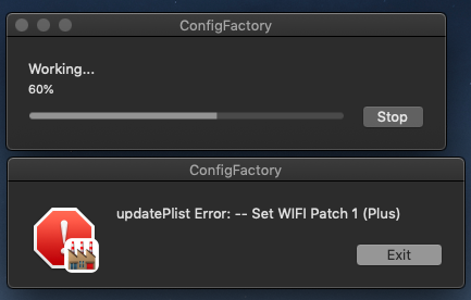

I followed the instructions but didn't get very far. The error is "updatePlist Error: -- Set WIFI Patch 1 (Plus)". I couldn't find any match of this error with Google so I figured I try my luck here. Here's what I did:
1. I downloaded MyBootMgr 071c
2. Launched ConfigFactory and answered as follows:
Would you like to use ConfigFactory Defaults for your Mid 2010 Mac Pro where Possible? -- Yes
Are you running any 'DosDude' or similar patched Mac OS instances? -- No
FileVault? -- No
HFS+? -- No
Mac OS 11.x or newer? -- No
Linux? -- Yes
Windows? -- Yes
UEFI? -- No
Windows? -- Yes
HiDPI boot screen? -- No
UEFI? -- No
Thunderbolt 3? -- No
Windows? -- Yes
Boot OS on external drives via OpenCore? -- Yes
Nvidia? -- No
Auto run WrangleConfig after ConfigFactory? -- Yes
Choose default Mac OS volume
Choose rEFIndPlus/OpenCore volume
3. The build always fails at 60% with the error "updatePlist Error: -- Set WIFI Patch 1 (Plus)"

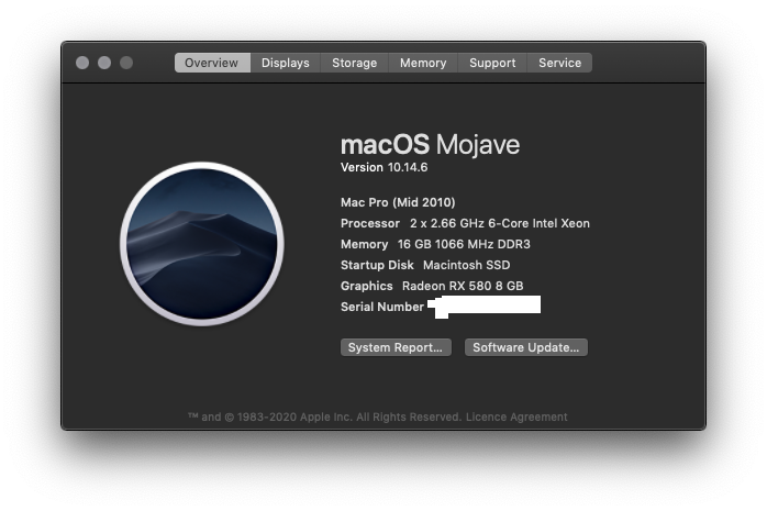

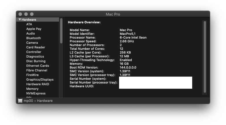

Below is my Mac's spec:

Hi,
Thanks for the report. The errors are internal to the App so will not show up in a web search.
Please try replacing your ConfigFactory file with this test version: (NOW DELETED)
I have tried spoofing a Mid 2010 for a test and it seems to work but do let me know how it goes on a real unit. It should give a more precise error message if it fails at least.
Thank Dayo! The new version works! I can get tot he rEFIndPlus and OpenCore screen after installation. Awesome!
