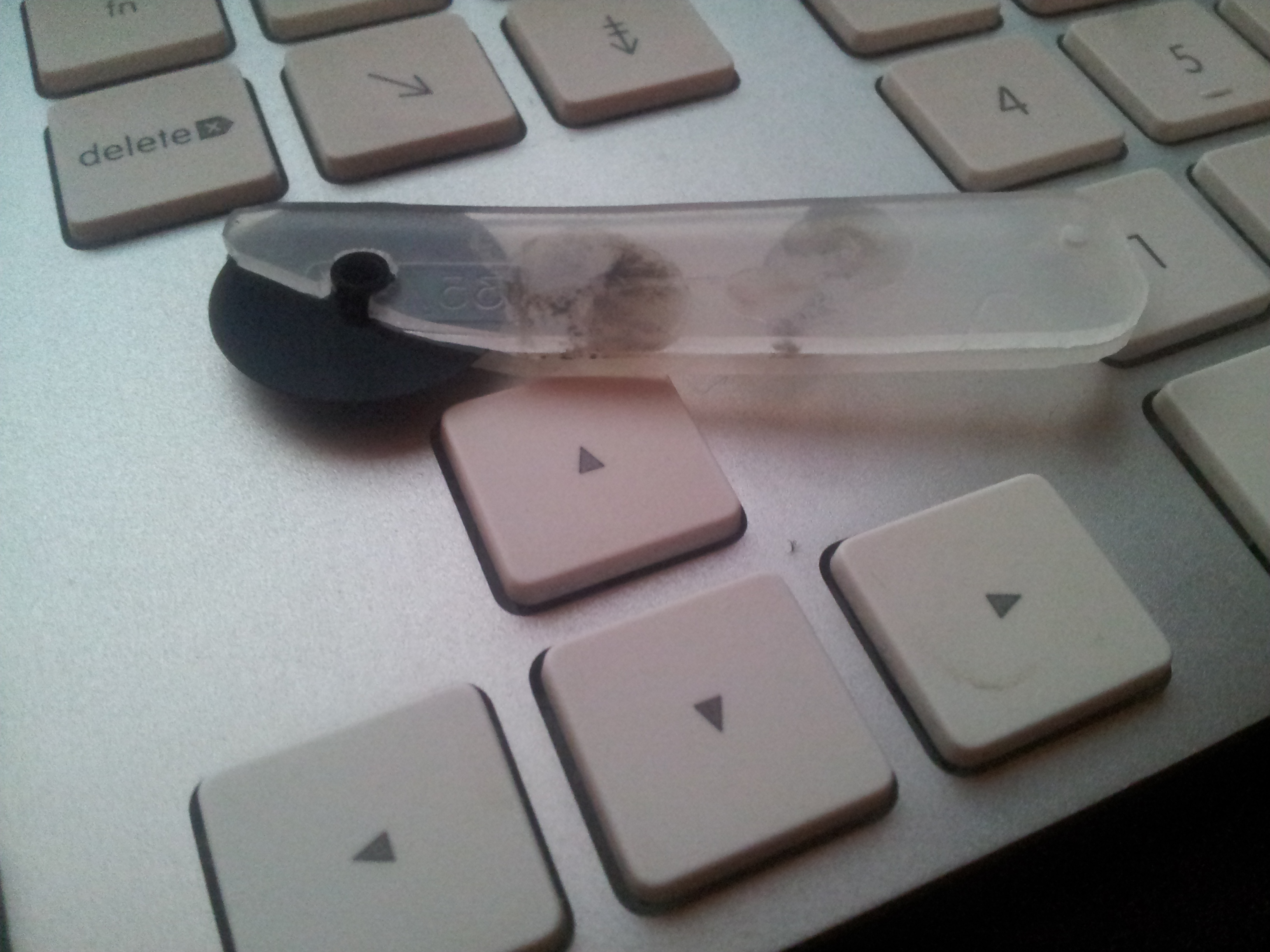

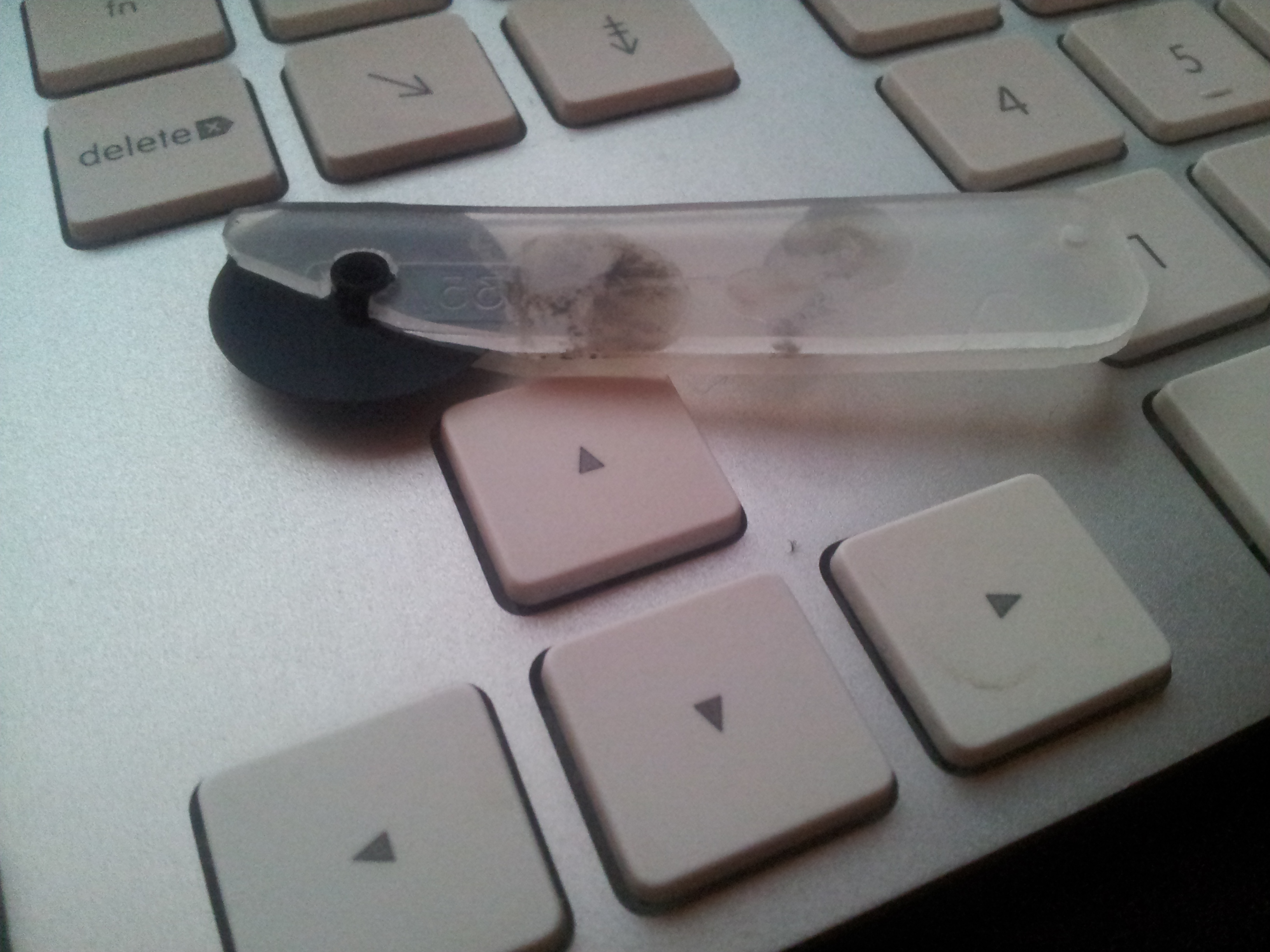

Has anyone opened with just a guitar pick? I'm only going to open the imac once and it seems a bit steep to pay another $100 for just the handle of the cutting tool. I don't want to damage the screen so will buy the complete kit if i have to, but it would be nice to save that extra money.
Yeah, it's no problem - takes some force, but there is nothing to break on the inside of the display, so don't worry.

I made my own cutting handles :)
