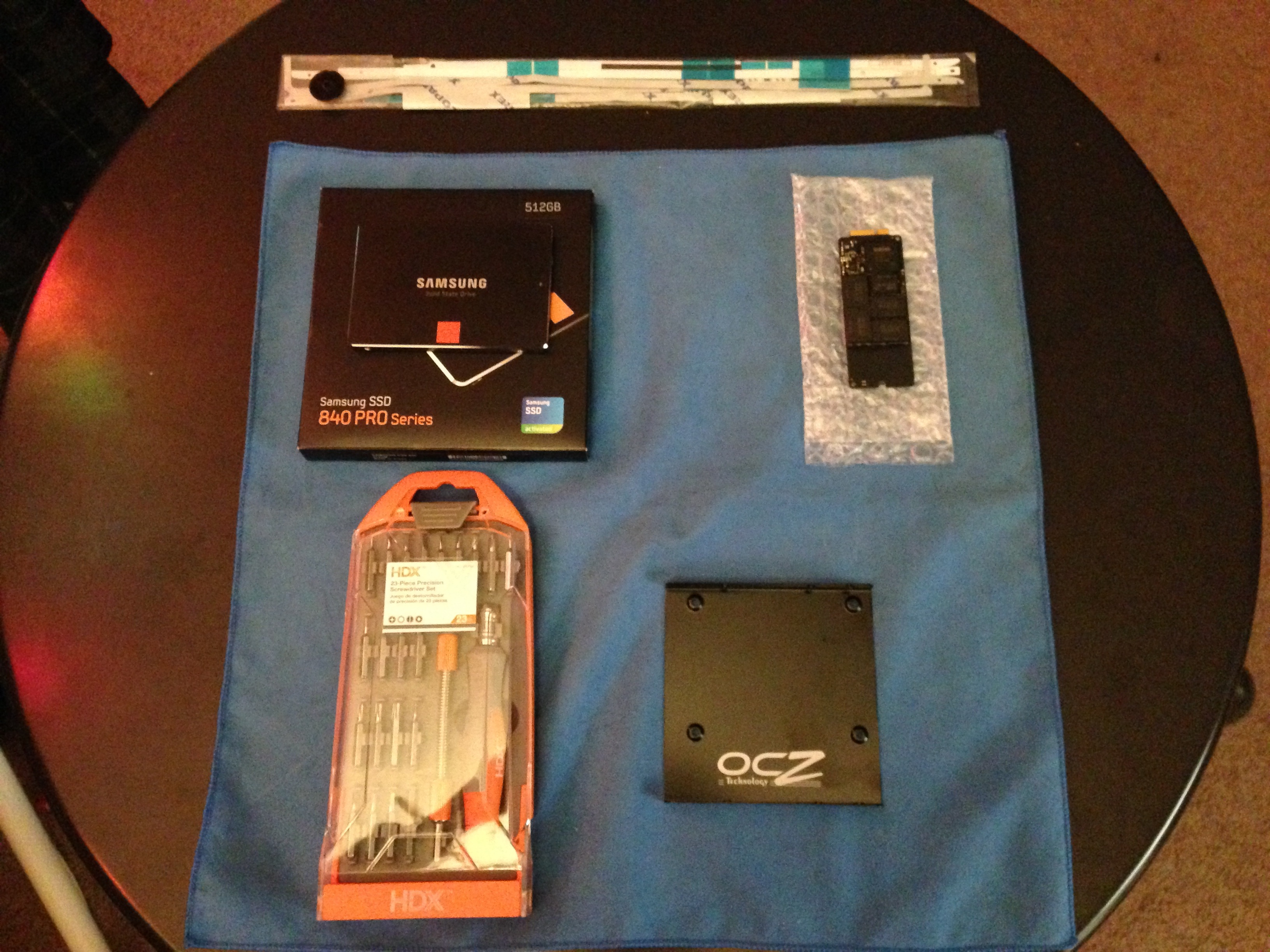

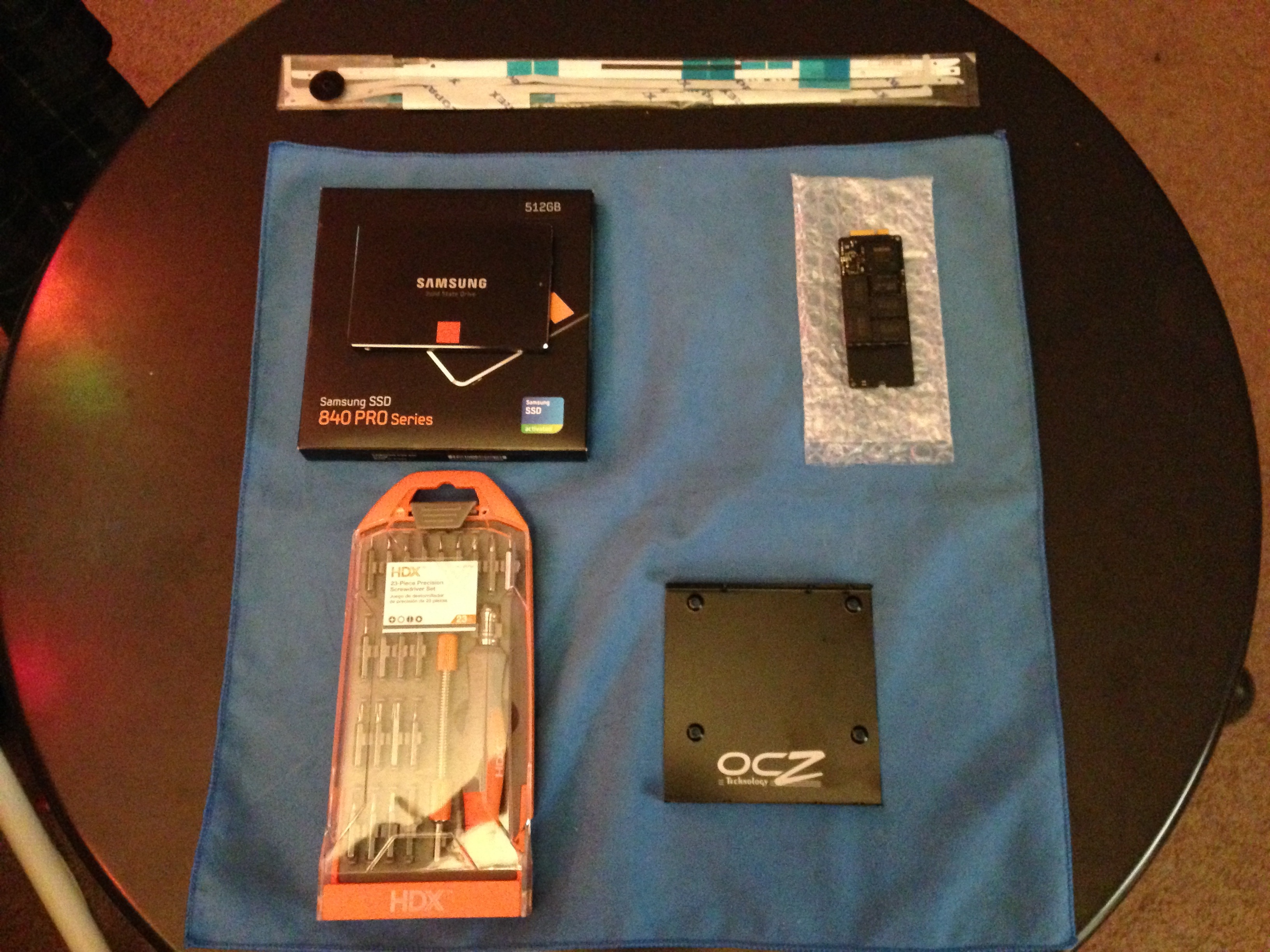

I actually used the OWC bracket to do mine, not sure how well the other one would work.
At the end I got this $6 OCZ bracket for a stylistic reason (I prefer the black color instead the OWC blue :p)

No, there are four holes in the OWC one, in that picture two holes are hidden just behind the front side. These four holes in the bottom are perfectly spaced so the 2.5" can screw into them.

It's going to be with these specs:
Apple Imac 27" 2012
3.4GHz Intel Core i7
32GB DDR3 RAM Crucial
nVIDIA GeForce GTX 680MX 2GB
Samsung 840 Pro 512Gb + Samsung SSD Blade rMbp 512Gb

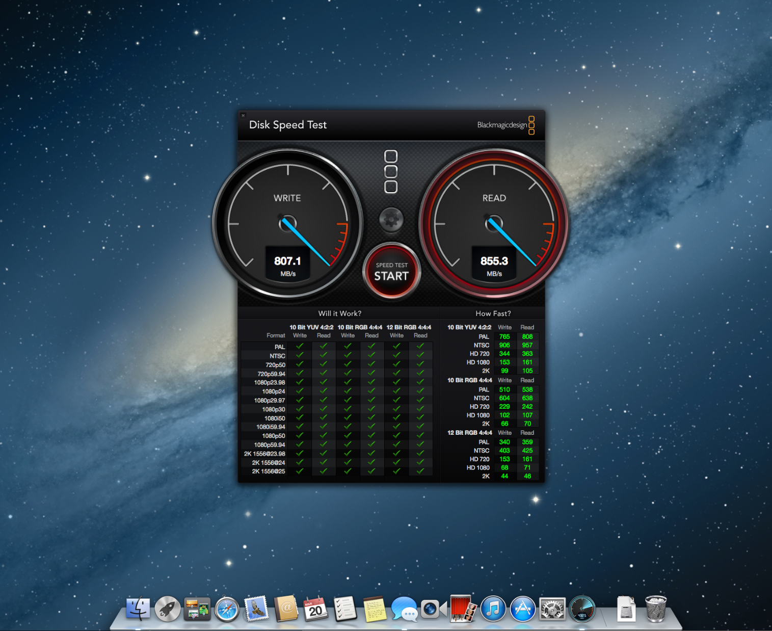

And imo benchmarks are damn great with this config, its perhaps the fastest iMac you can build by today.
Wow, that's impressive !!!!!

So, I made a SoftRAID-0 from a 256GB partition on the internal Samsung 840Pro and 256GB Samsung 840 Pro that is in de LaCie Thunderbolt enclosure.
Guess what, already impressive, especially considering it is partly on an external SSD. Looks like it's just missing around 100MB/s compared to "happyhacking"-s (all-internal) RAID setup.

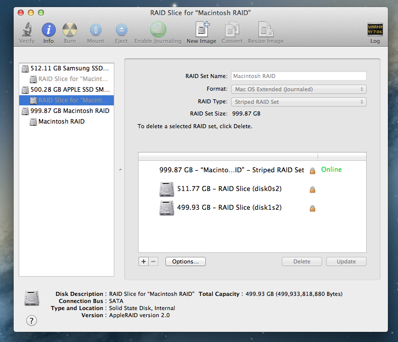

Hi all
I was planning to replace my 1tb drive with a Samsung 830 128gb SSD and raid0 that with the internal 138gbssd blade. I thought this was the best approach as the internal SSD was based on the samsung 830, however I now see many of you guys using the 840. Pro to raid o. Will this give more speed or will the SSD blade be the limiting factor as its based on the Samsung 830 ? I hope my question makes sense
Here we go:
Samsung Blade rmbp 512Gb + Samsung 840 pro 512Gb. The Imac is pretty happy I guess :)
A huge thanks to Qnsboy for the kindly support! My holy guide thru the process!
Do I need to activate TRIM?
Ps: I Set the RAID Block Size at 64k, I use it mainly for video editing, is it a good pick or do I have to increase it? Thanks.

TRIM is not an available option in a SSD RAID setup...garbage collection will do its job though.
