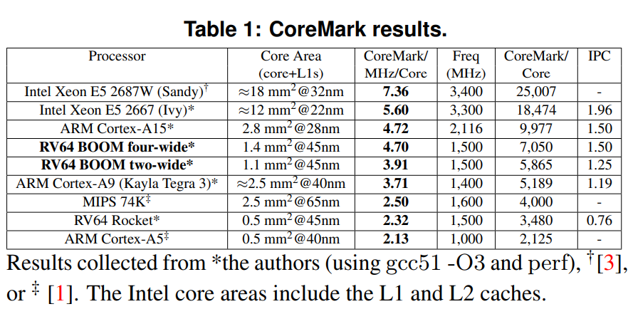

Even if RISC-V ISA has some design flaws that ARM ISA does not, I have not yet read what the consequences of those flaws are. Will RISC-V based SoCs be slower/more expensive/less efficient than ARM based SoCs?
As for now, the main problem of RISC-V simply lacks functionality (e.g. no standardized flexible SIMD instructions). As to the rest, there is no reason to assume that RISC-V CPUs will be slower or less efficient, just like there is no reason to assume they will be faster or more efficient.

I'm not sure about the other points, but the RISC-V organization has recognized the first point and has created profiles to avoid fragmentation. Also, the fence.tso instruction is now mandatory.
This is an ISA designed first and foremost for simple in-order architectures.
What makes you think ARM64 is more suitable for out-of-order SoCs?
It looks like the RISC-V organization will finish the remaining pieces of the standard this year and 2024 will be key to showing the true potential of RISC-V SoCs.
Reactions: psychicist
ARM64 is designed to pack a lot of information into a single instruction. Many ARM64 instructions can be efficiently decoded and scheduled as multiple operations on a modern OOO core. In other words, the goal is to maximize the useful information per instruction.
In contrast, RISC-V seems to be designed to simplify the execution of individual instructions. It looks like an ISA where the primary goal is to enable simple hardware implementations. This is great, but this kind of early optimization means that extracting more performance is going to be difficult. RISC-V authors explicitly mention operation fusion to solve this problem - the CPU will analyze instruction sequences and combine them into a single operation that can be executed more efficiently. But this is not free as it requires power and complex logic. Basically, the idea is that by pursuing extreme simplicity RISC-V might have sabotaged its ability to scale. Time will tell how much this is an issue.
