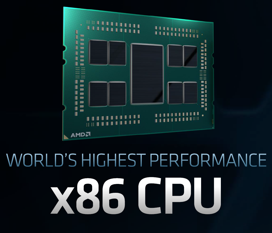

If there are chiplets, somewhat indicative that are possibly split into CPU ( base ) and GPU core focused camps.
[ for example chiplet 1: 8E-NPU-Thunderbolt-core I/O (USB etc) - one or two memory controllers
chiplet 2: 6 P cores + 32 GPU cores + memory controllers
So to 'crank up' the P-GPU count you keep adding chiplet 2's. ]
If not chiplets then they can tune to whatever combination they want.

It is easily possible to bring that chip well under 80W. We know from the macbook air the power usage of the cores when it is throttled. Going down to ~2.6Ghz reduces power usage by almost 3X compared to 3.2Ghz.
That's what high core chips have done for a long time. For example a threadripper running with 32 cores uses almost the same as when all 64 cores are loaded. Why? They decrease the frequency when running with 64 cores.
