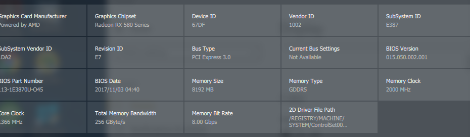

Anyone have any problems with a Pulse not being fully recognized? Bought one off Newegg when they got back in stock, but not getting the card fully recognized in “About this Mac.” Not super concerned but one of the reasons I purchased the card was it’s 100% OOTB-ness. Running 10.13.1.
Odd. Is it definitely 8GB and not 4? Perhaps they have started shipping a third part number? macOS only looks out for two specific part numbers.

ah, I had not even thought about that. Yes, definitely a 8GB.
Part number for my pulse is 113-1E3870U-O45.
Same here. Pulse RX 580 from NewEgg. The card is not fully recognized in “About this Mac.”
However, it works just fine.
