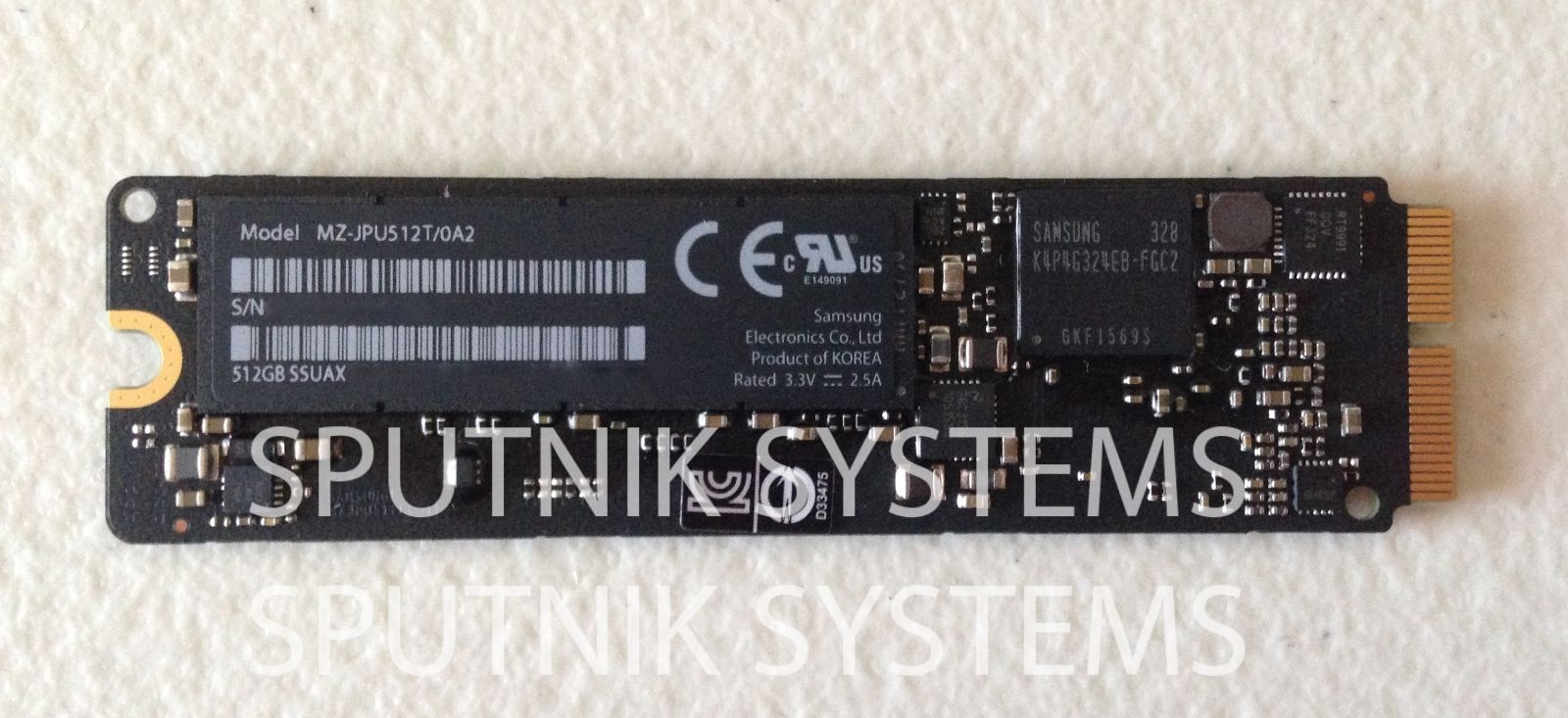

1) I believe that one is a 2x (SSUAX 512GB). It's pushing data through 2 PCIe lanes instead of 4.
2) I don't think this model with have any boot delay. I should work fine in any slot. If I'm wrong some will correct me.
3) Yes
That is a x2 part, with a top speed < 800MB/s. Apple's slowest offering.
In the lower left corner of the SSD label is the size and revision.
in this case: 512GB size and SSUAX revision.
No cold boot delay, fwiw... I rarely cold boot.
1TB versions of the Apple Samsung SSUAX chips are x4 and run around 1000MB/s, a bit slower than the XP941.
All XP941's are x4 and the 512 version can be picked up between 300-400ish (requires a different adapter). So a higher performance level for the same price.
The 512GB SSUBX that hits 1500MB/S read/writes goes for around $430. The fastest option available today for the cMP.

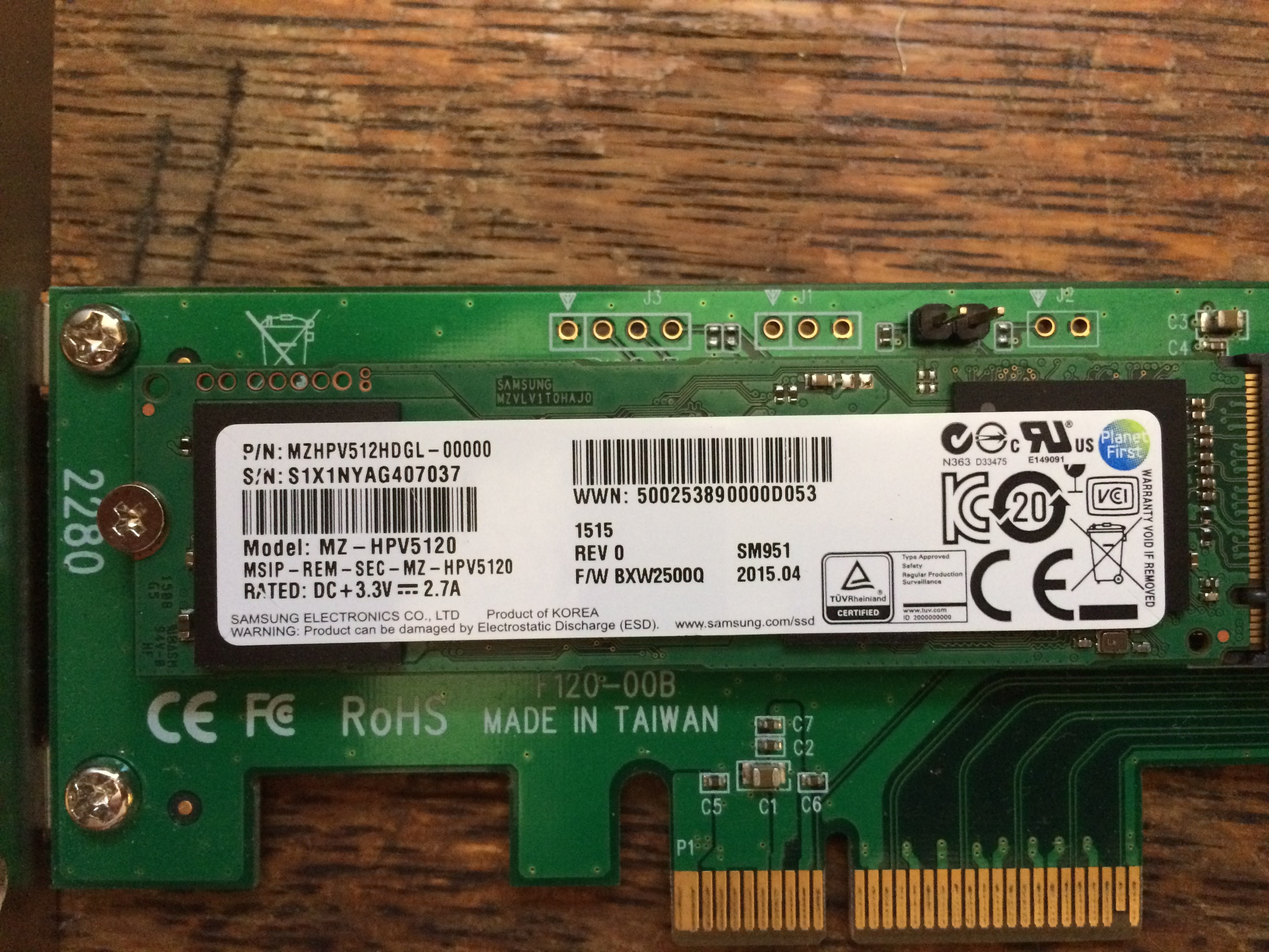

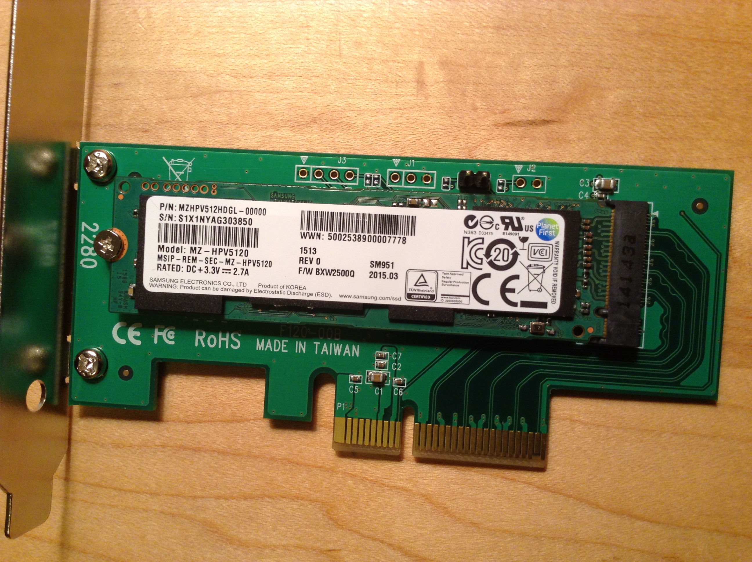

Trouble in Paradise? SM951 512GB running at x2?
So I wanted to join the fun and I ordered an SM951.
I pulled a SP941 from my adapter and put it in slot 3, eager for high speeds. Instead I got 750 or so.
It was running at x2 lanes at 5.0.
I tried moving it to slot 2, and got 2.5 GT/s, for some really lousy speed 375 or so.
Anyone have a guess what's going on? Wish there was a way to turn a x16 PCIE 2.0 into a x4 PCIE 3.0.
Bad card? New revision going to burn us? (From 4/15)
Not much use, and certainly not worth paying $500 for half the speed of the older blade.
Well, it's not as if those are not high speeds, but they are not what you should expect, either. As noted just above, I was getting 1427.9/1393.2 in a rather mundane configuration of a cMP 4,1/5,1. 750 for sequential read seems abnormally slow. The cards I tested were all 2015.3, whereas yours is a 2015.4, but there shouldn't be that much of a fall off the cliff, especially in Slot 3, which has proven to be a sweet spot. I wish I could be of more help. I would definitely see about swapping out that drive for another SM951, as I and others can attest they should be faster.
