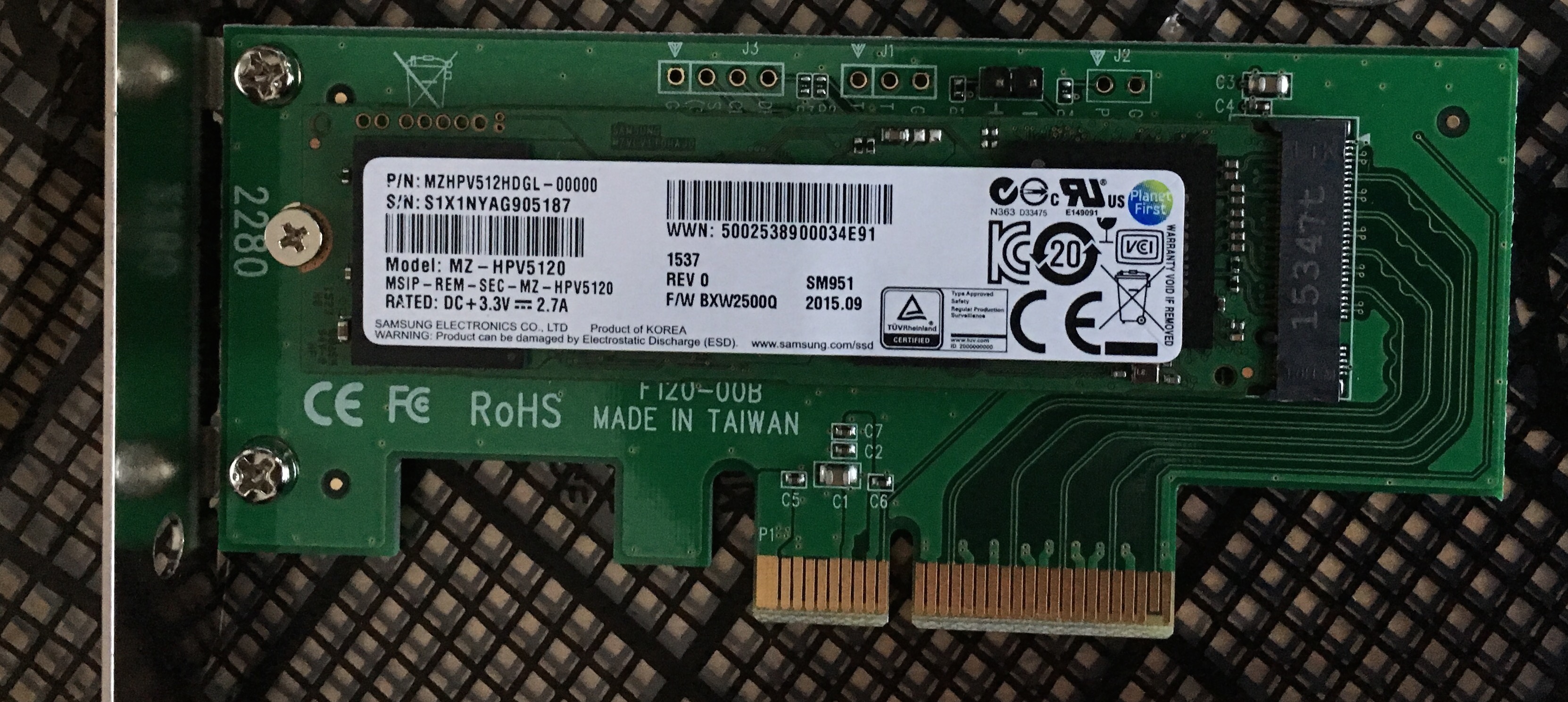

I bought this Ableconn PEXM2-SSD card
http://www.amazon.com/dp/B017JGVTAM?psc=1
for a 512MB SM951 because the Lycom was not available at the time.
The pictures of it look identical to the Lycom. But now I'm wondering if it is as advertised because it is not showing up as 6 Gigabit under Link speed or Link Width. I'm running 10.10.5 on a 2008 Mac Pro.
The card is in slot 2 which is x16 in the 2008

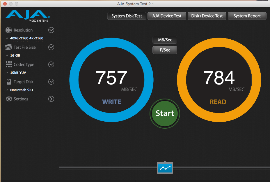

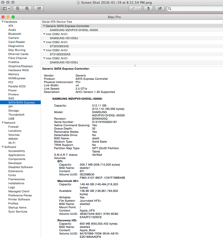

Here are the details and the speeds I'm getting.
Are these speeds good?
Is this card no good or is there a setting I need to change?

I believe the issue is with how the SM951 behaves in MP x16 slots. If you read back through this thread you'll see that the SM951 doesn't max out in x16 slots 1 or 2. That's why users with a 4,1 or 5,1 MP put it in slot 3 or 4 which behaves correctly. But you're using a 3,1 machine and slot 3 or 4 won't help.
The speeds you report are almost identical to what I get with a 3,1 in slot 2.
So, you're adapter appears fine and the SM951 is performing the same as similarly configured systems.

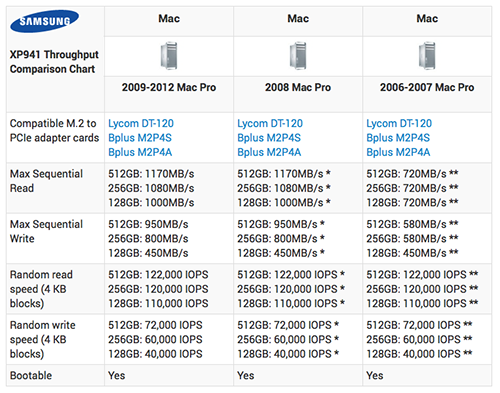

I thought the performance would be higher based on the image at Barefeats from Ramcity with a xp941
Is the Link Speed 2.5GT/s equal to 6 Gigabit, as seen on page 1 of this thread with the Lycom card and XP941?
Image from page 1 below
ngff-hardware-info-png.452272
[doublepost=1453260807][/doublepost]I ran the same test as Bare Feats and got the following
These results are 20.3% slower on the write speed and 33% slower on read than bare feats results using an XP941.
"* To achieve max throughput in the 2008 Mac Pro, one of the two PCIe 2.0 x16 slots must be used. These models have two x16 PCIe 2.0 slots and two x4 PCIe 1.0 slots. In our testing on May 12th, 2014, we confirmed the speeds listed above for the x16 PCIe 2.0 slot with the 512GB XP941. We also tested in the 4 lane PCIe 1.0 slot which measured 742MB/s READ, 588MB/s WRITE."
This is why I was wondering if there was problem with the card. The read speed is barely faster than barefeats 4 lane PCIe 1.0 speed at 742MB/sec/
Reading back through the thread I see slot 2 may be the problem. I had read through the thread before but it didn't make much sense to me at the time.
Would placing the card in slot 1 make a difference or is it really just a case of how either the card or the SM951 handles the x16 slots?
I still don't understand how Barefeats got the results they did with a 2008.

It's something to do with the way the SM951 responds to the x16 lane config in the Mac Pro. It's a quirk that the XP941 does not exhibit. This quirk in the SM951 does not occur in a x4 slot. I don't think Barefeats did anything special with the XP941 in a 3,1. If the SM951 didn't have this quirk it would indeed beat the XP941 in the benchmarks being considered.
