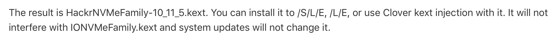

From https://github.com/RehabMan/patch-nvme:
You don't need Clover for a Mac Pro. Install macOS on a spare SATA drive (non NVMe) and create the HackrNVMeFamily-10_12_0.kext on the spare drive installation in accordance to RehabMan's instructions. Put the HackrNVMeFamily-10_12_0.kext on the Desktop and install it with KextBeast. Then, remove the IONVMeFamily.kext from the spare drive's /System/Library/Extensions/ folder and reboot without caches to the spare drive. (I can't remember the way to clear caches; I use OnyX or a similar program before rebooting.)
You should now see the NVMe SSD. Install Sierra to the NVMe. Remove the IONVMeFamily.kext from the NVMe drive's /System/Library/Extensions/ folder. Install the HackrNVMeFamily-10_12_0.kext into the NVMe drive's /System/Library/Extensions/ folder using KextBeast which will let you select the NVMe drive while running from the spare drive. (KextBeast defaults to the current drive but will allow you to change the drive as the last option you can choose before installation of the kext).
Change the startup drive in the System Preference's Startup Disk to the NVMe.
Now restart.
Note: I have not tried the above procedure on either of my Mac Pros because I don't use a NVMe in them yet. But, I have a hackintosh that uses the Samsung 950 Pro M.2 NVMe. So, the above procedure should work. YMMV.
Now restart.

Edit: You're probably right since the Mac Pro BIOS doesn't recognize non SATA drives. Oh, well, you can still use RehabMan's patch-nvme since NVMeGeneric.kext doesn't work with Sierra.
The Mac Pro doesn't have an NVMe EFI driver, so unless this guy finishes his work it's not possible to directly boot it. It should be possible though to store the boot.efi and kext cache (which can contain an NVMe driver) on a different volume. It's quite nasty though, wouldn't recommend that for everyday use.

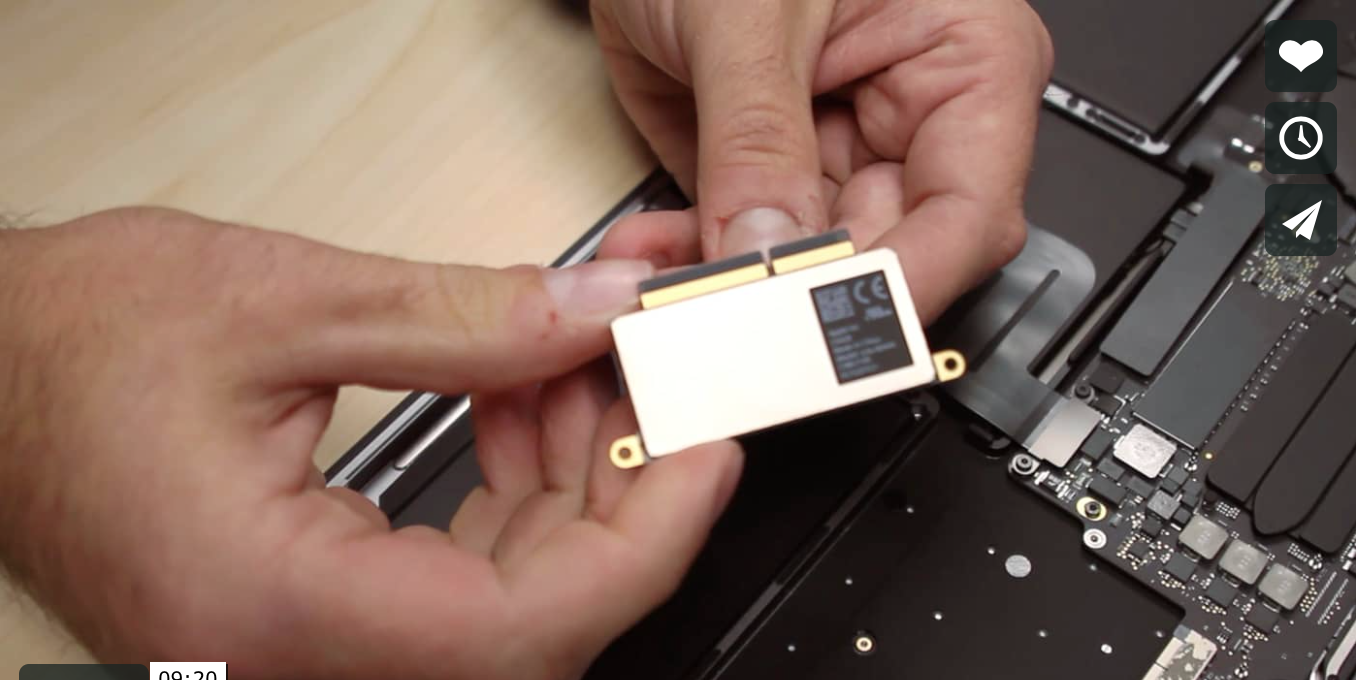

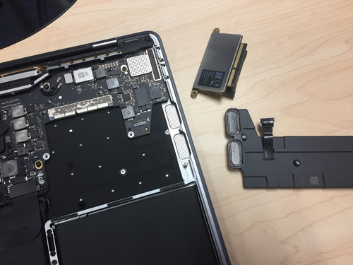

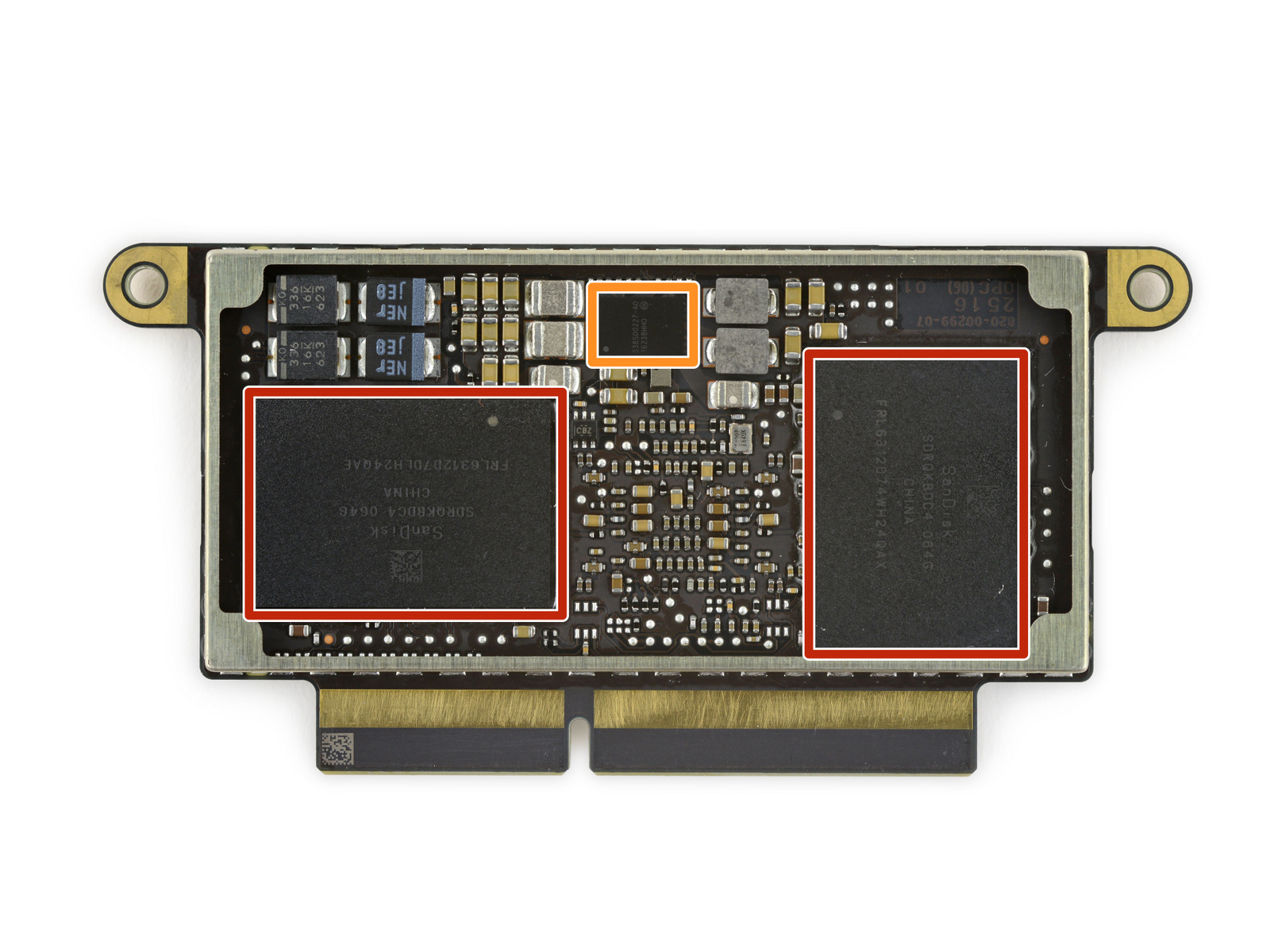

i wonder those little cute SSD can work in cMP and wonder third party like sintech mind to create an PCIe adapter to work with...
i planning to extending old cMP little longer and planning upgrade using SSUBX but those little things tempt me, main problem those little SSD contain proprietary NVMe Apple controller which is cumbersome for cheese grater which doesn't have NVMe capability baked in logicboard
