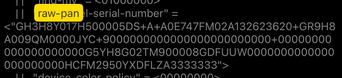

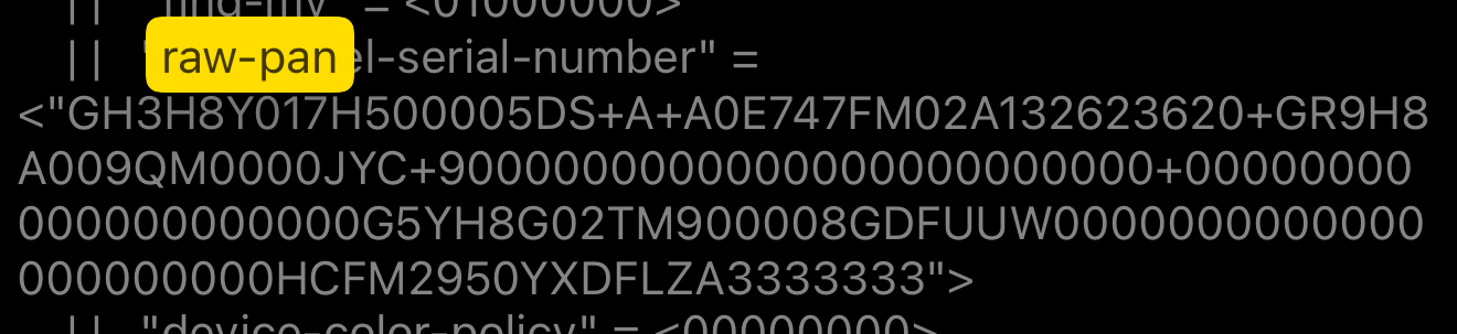

I will quote from someone from Reddit:
„For those wondering how to check your display manufacturer... You can run sysdiagnose on your phone (press volume up,
volume down, and lock button) all together for around a second. You will feel the phone vibrate. Wait a couple of minutes and then go to Settings -> Privacy and Security -> Analytics and Improvements -> Analytics Data. You will then scroll down and look for a file titled: sysdiagnose_XXXXXXXX You will click on that file and then click the arrow in the upper right hand corner and scroll down and click "Save to Files" Once it is saved you will go into your files and click the file to unpack it. Within the folder that is unpacked you will click on the folder "ioreg" and then click the file "IODeviceTree". You will then use the magnifying search glass in the bottom right hand corner to search "raw-panel". It will then give you a serial number. I have an LG display which has the beginning letters of GVC.“
G9N and G9P is Samsung
GHC & GVC is LG

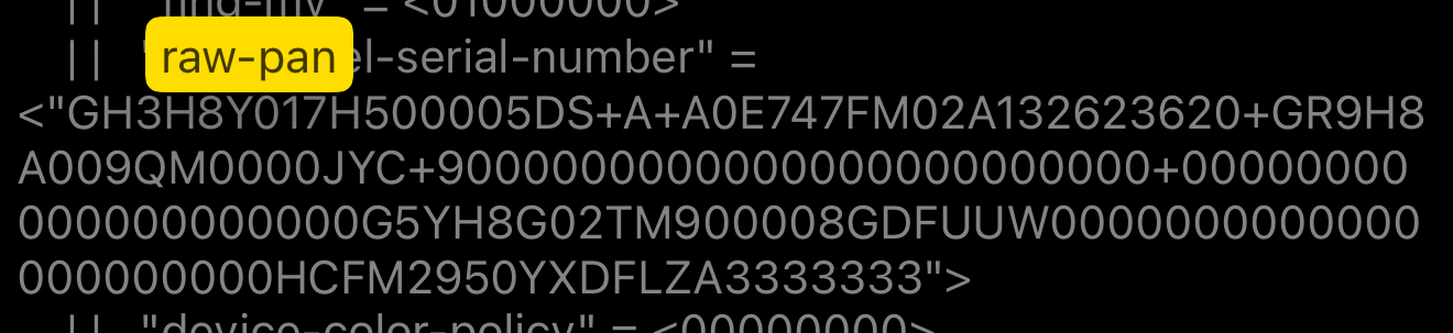

GHC & GVC is LG
Seems like mine’s an LG then

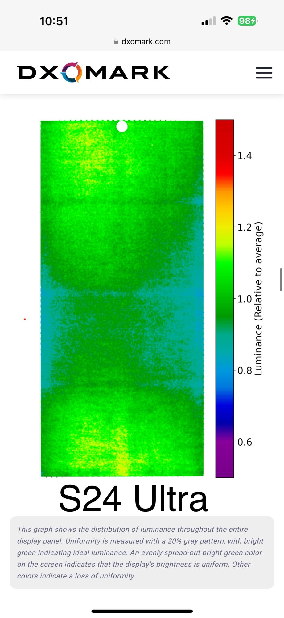

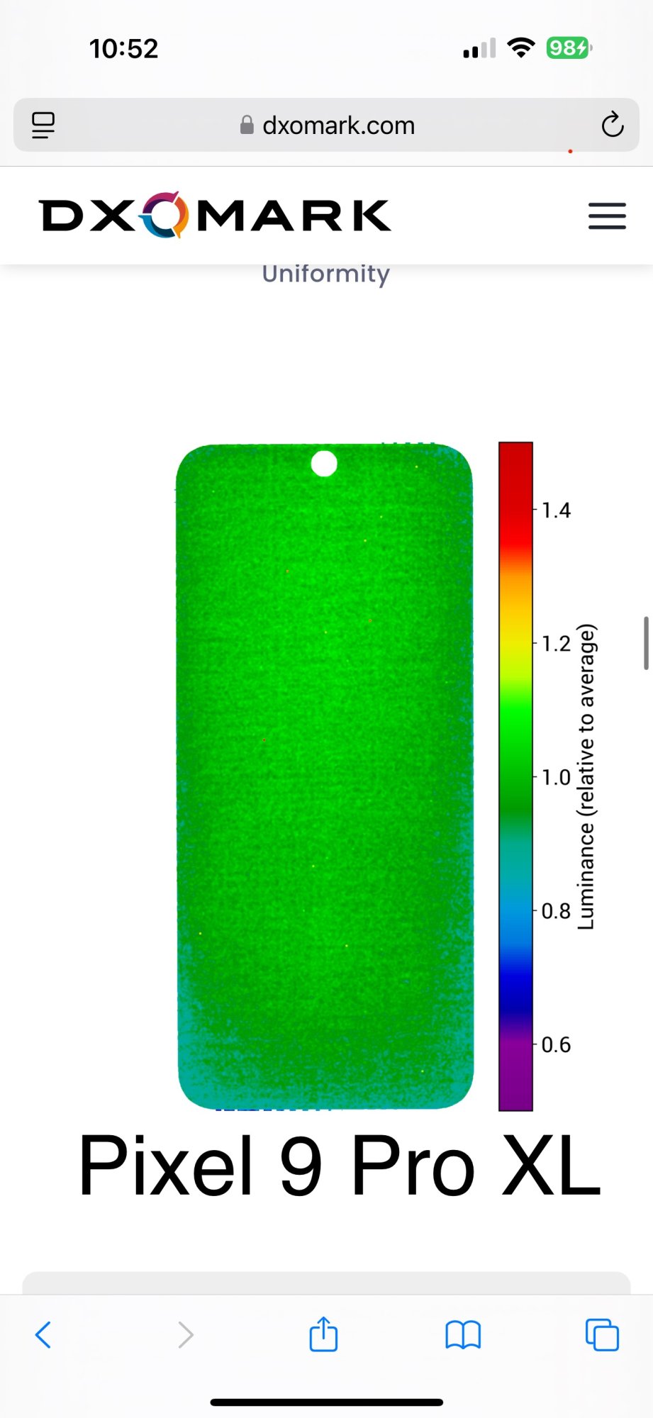

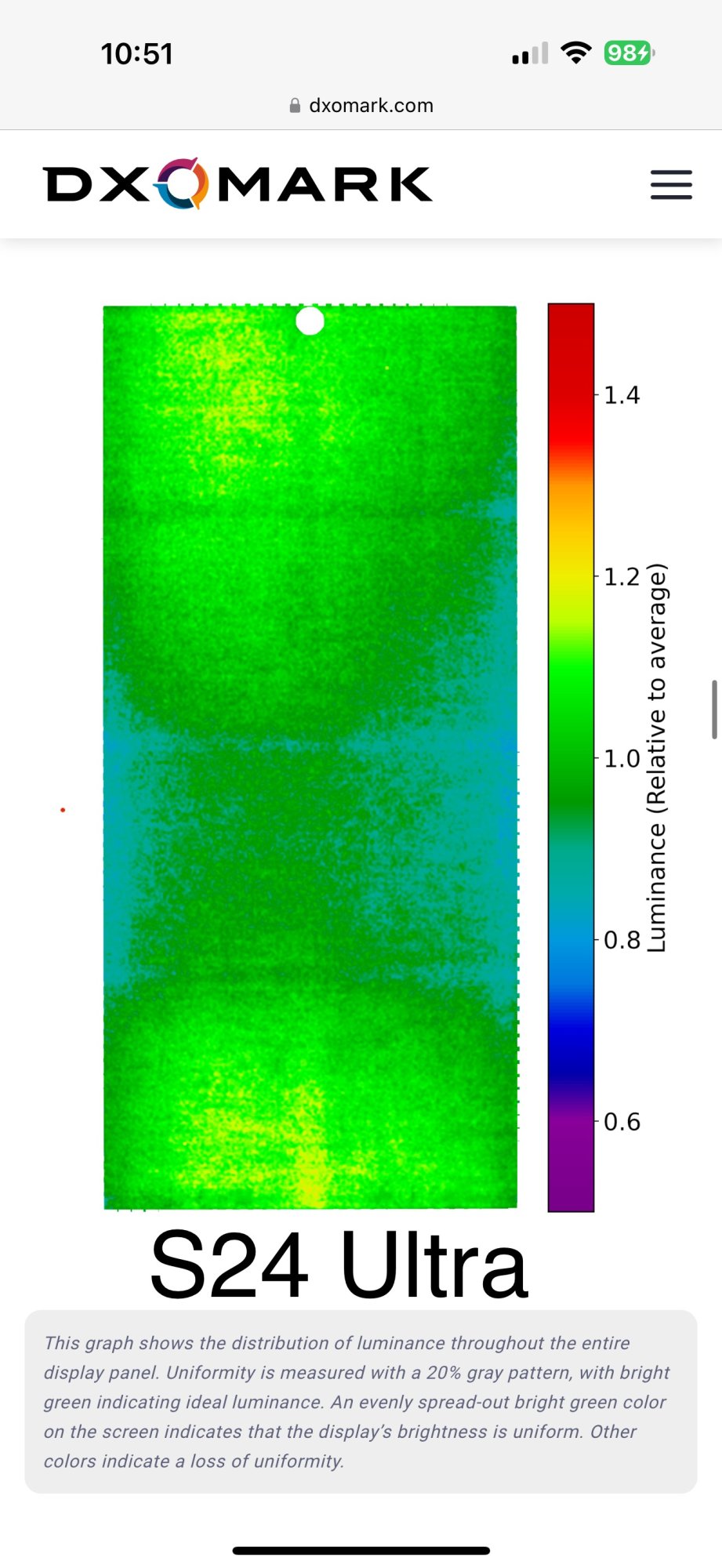

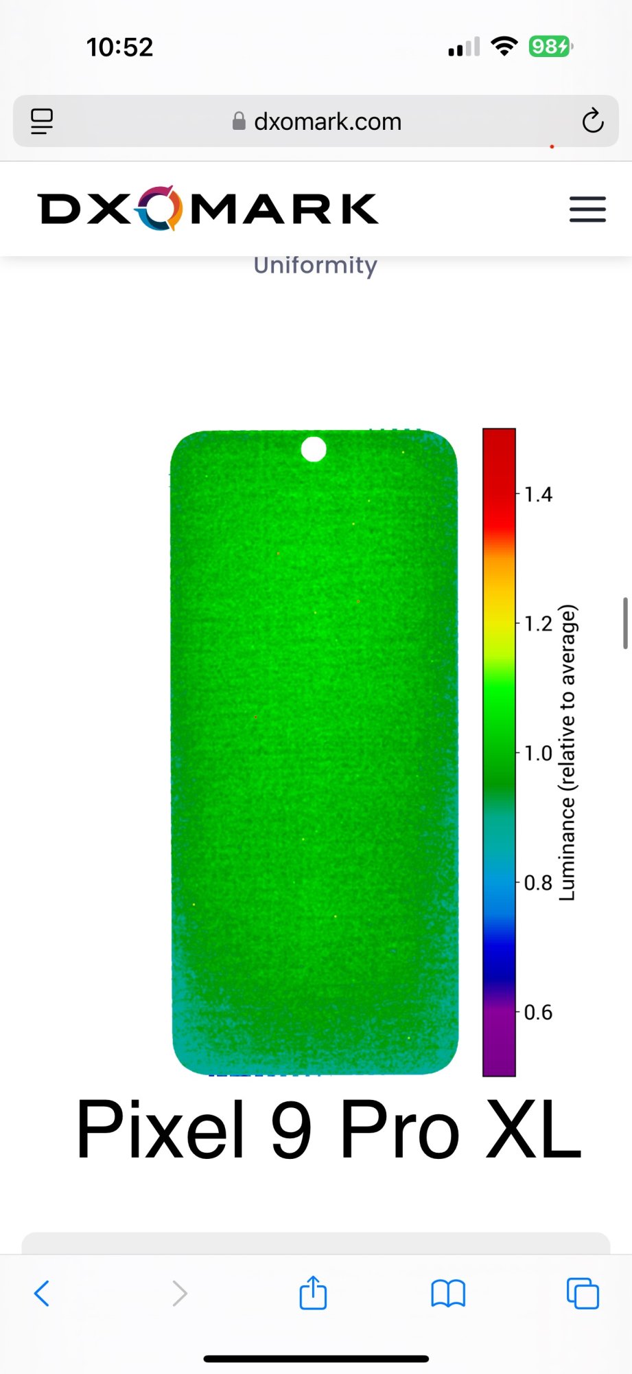

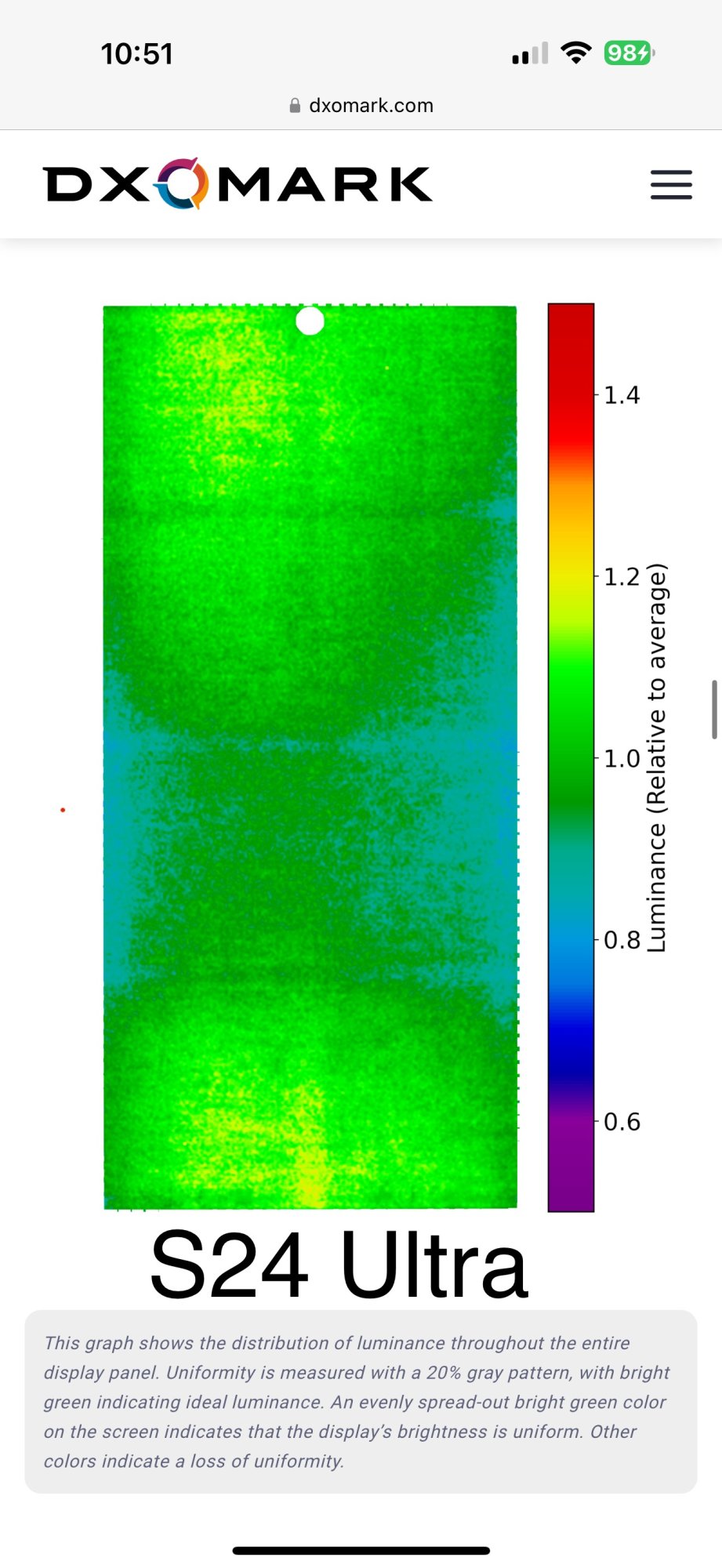

I think it has to do with the new M14 OLED panel. If you look at this S24 Ultra DXO Display test you can see it too. And this Samsung phones uses also the M14 OLED Panel.

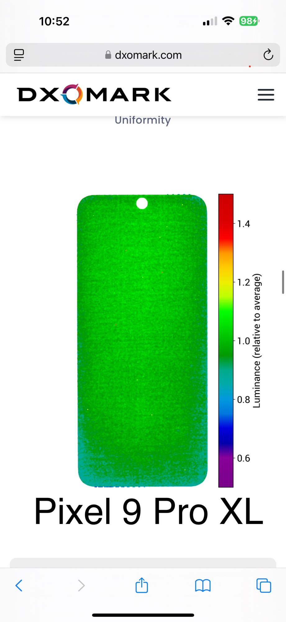

But the Pixel 9 Pro XL has it not so this is weird again 👀
