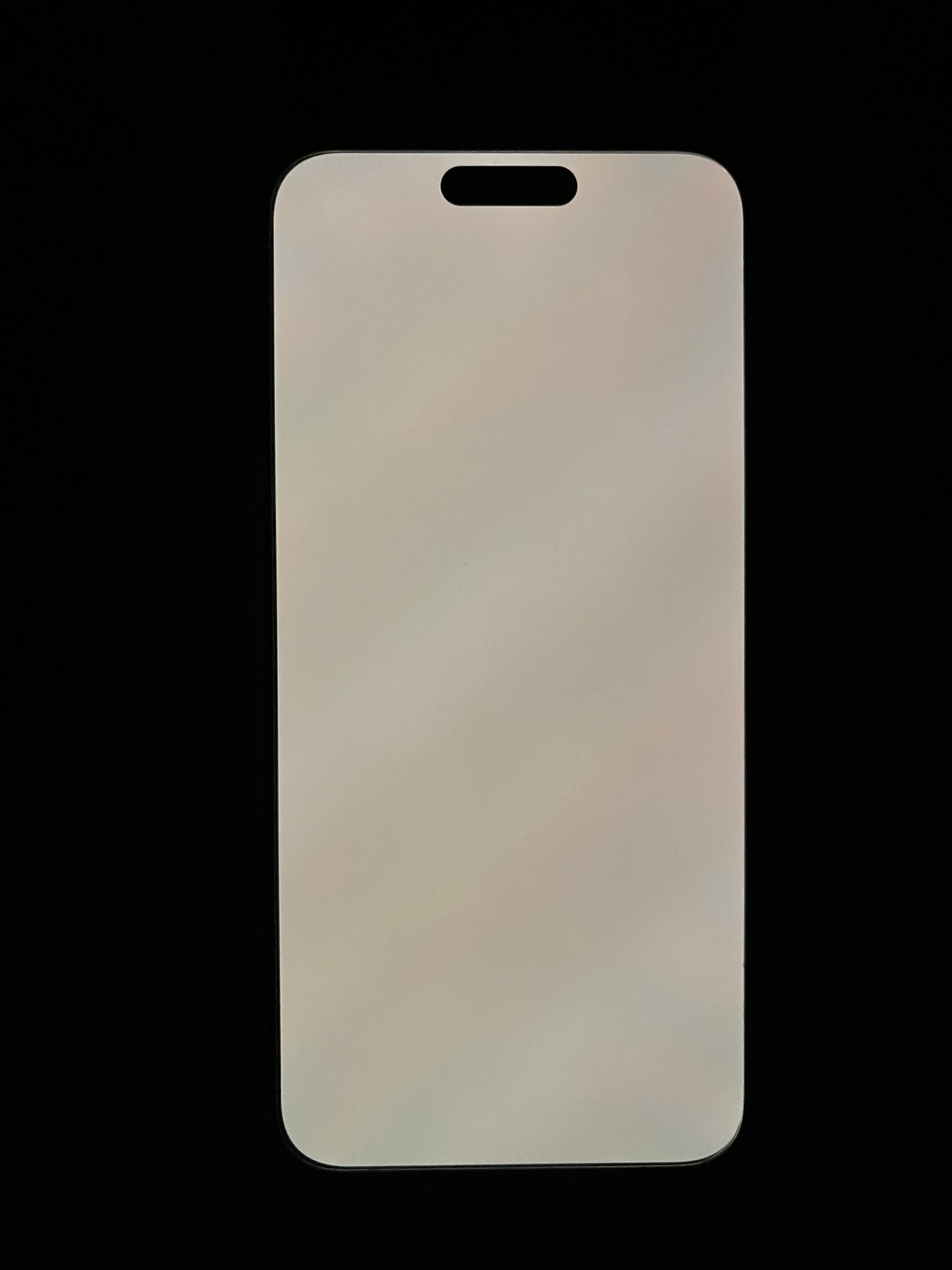

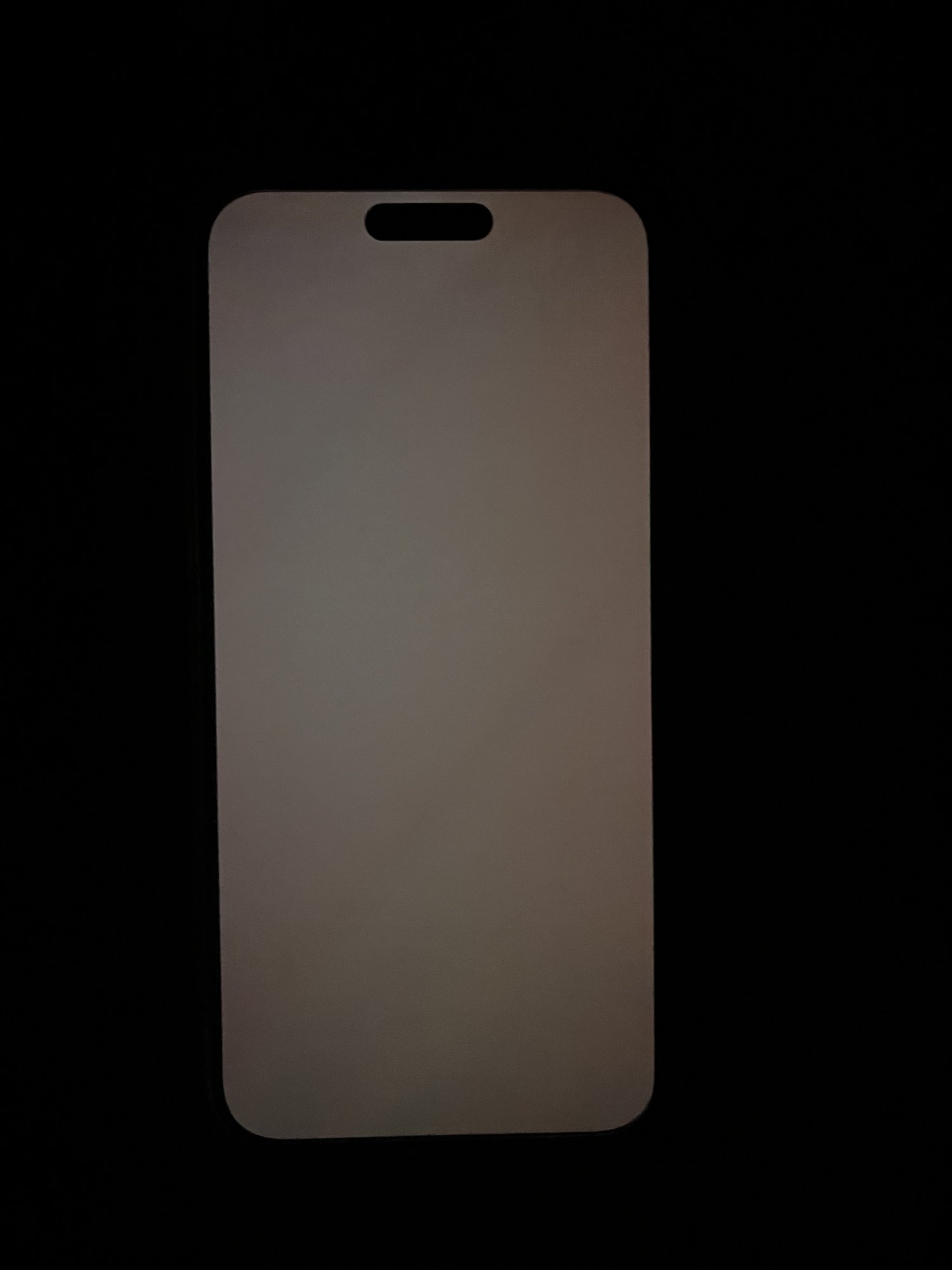

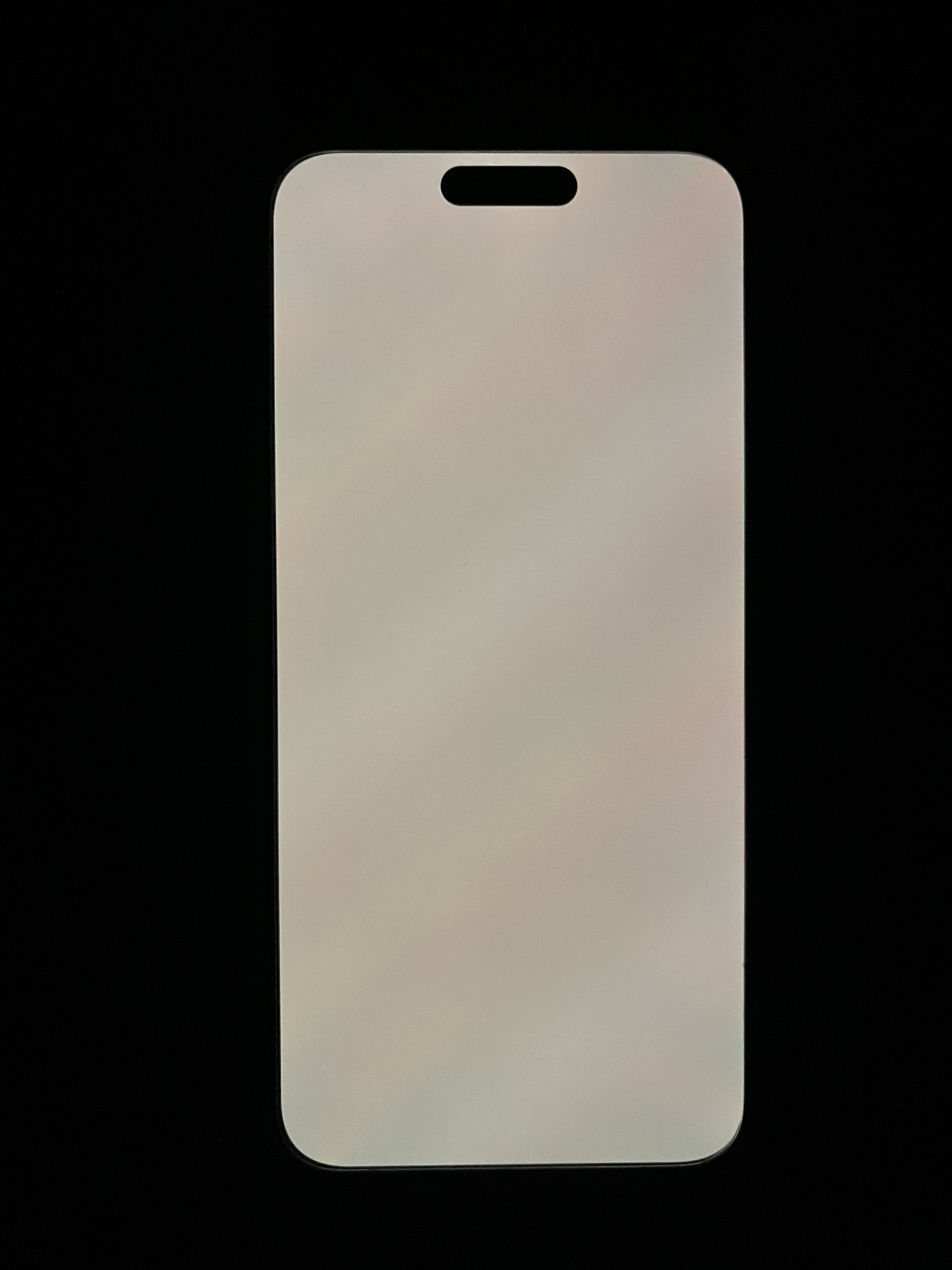

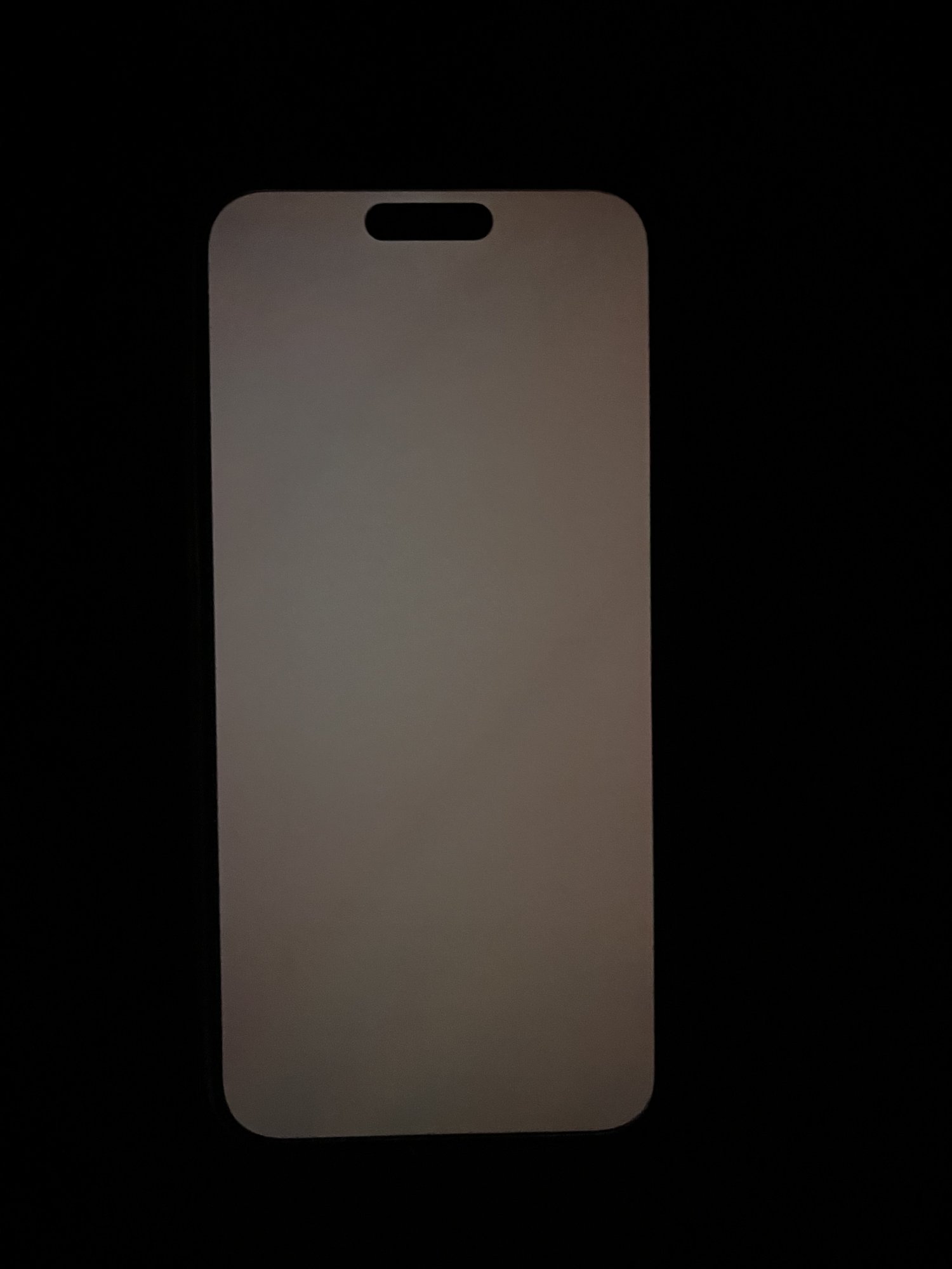

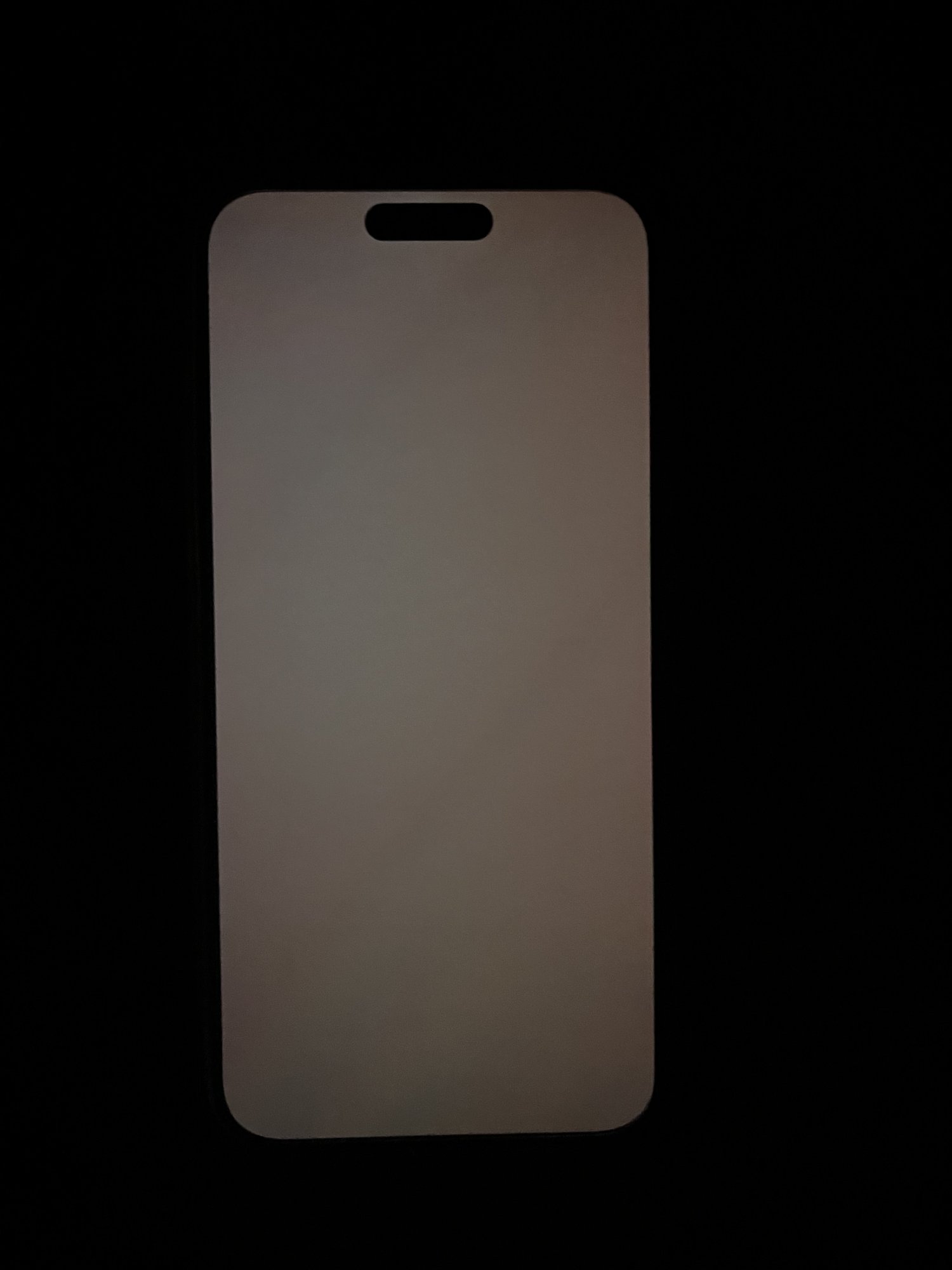

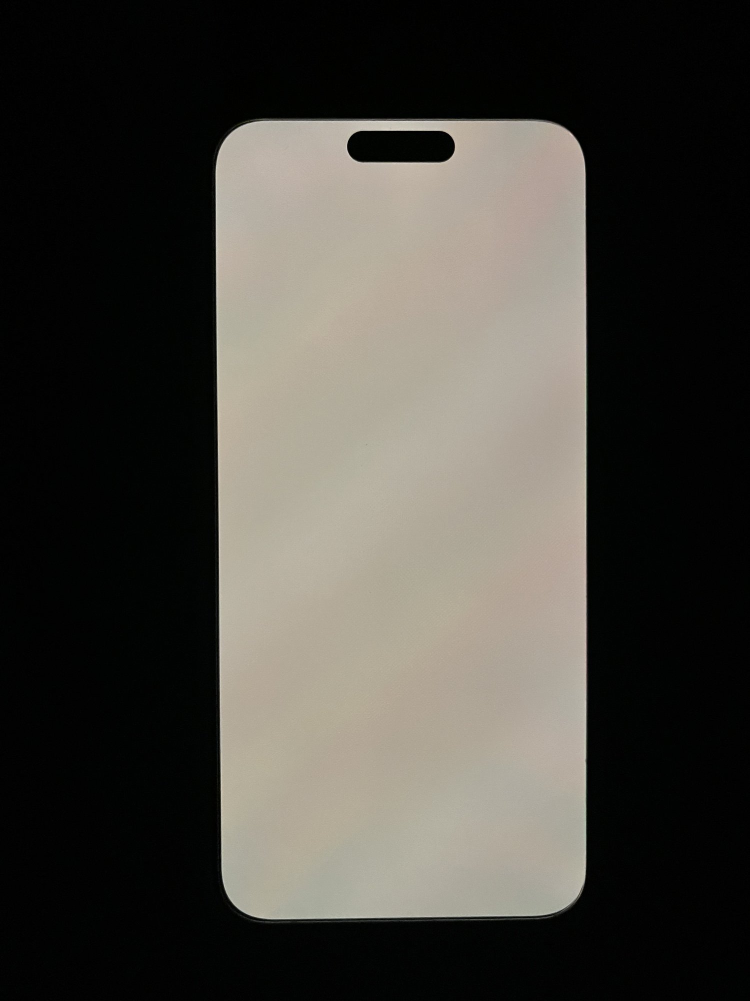

Guys, how can you comment my screen? Got my 15PM yesterday, a couple of hours later while reading noticed that the right side is more pink/red than the left side. The display is G9P. Night shift and TT on, brightness 10-15%.
Would you try to replace it? I’m in Europe.
The right hand side looks noticeably warmer, personally I would return it. If something is that noticeable it will always bother you.
I have checked so many 15 Pro Maxes. They all have a different bottom to top white uniform. Check it with 5% brightness TT/NightShift on, go to settings with White Mode, hold your phone landscape mode and now scroll up and down and follow with your eyes. You can see it will change the display Color from top bottom. 👀
Did you use a 100% white picture?
If it’s easy to exchange do it.
If you can live with it keep it.
Your screen is not bad but also not a unicorn.
It looks like only the top right side next to the Dynamic Island is a little bit darker. This is ok …
