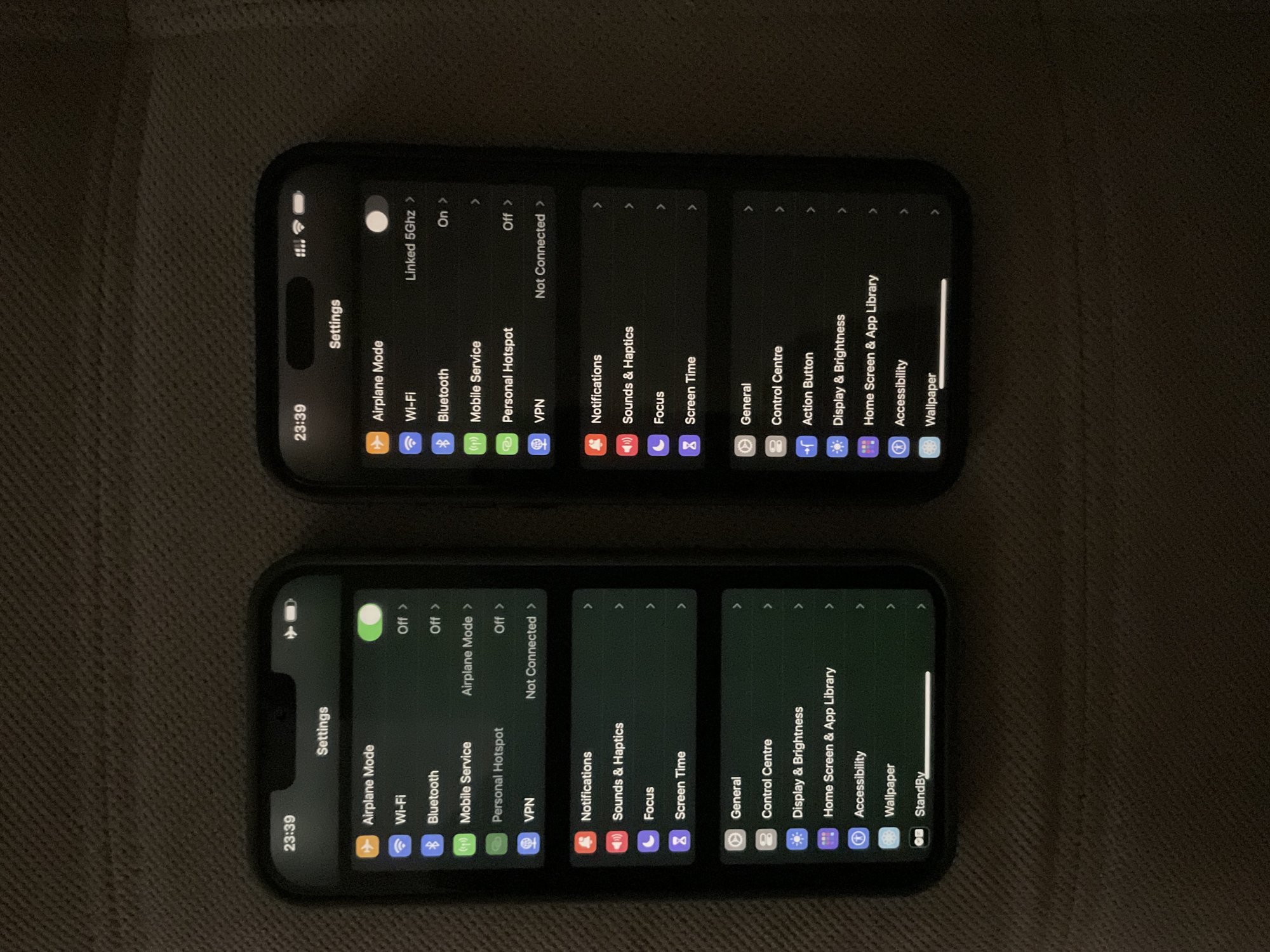

Just tried. Both are G9N. What do you think about the right panel? @sdante
For me it at first looked like left one was a bit different color balance reminding me of G9P but actually it is just a bit dimmer than the right one. I think the one on the right is ok, I'd take that happily.

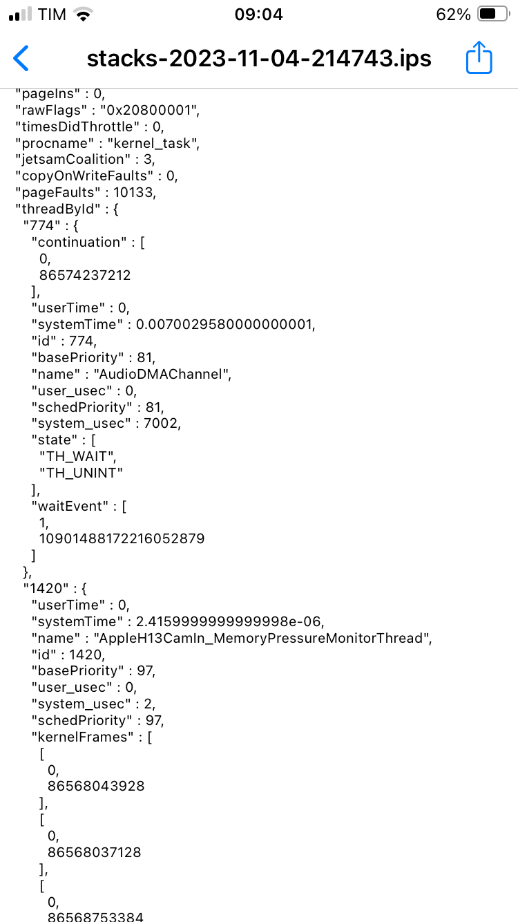

You can do it directly by the phone. Just run sysdiagnose and read the results in the phone, no apps needed. Takes like 60 seconds in demo models as they have pretty basic setup.

The one with an iPhone with a G9N32 screen has triumphed.
Most of them are G9N33 and those are the mediocre ones. I can say this since I have seen and tried more than 10 different iPhones.

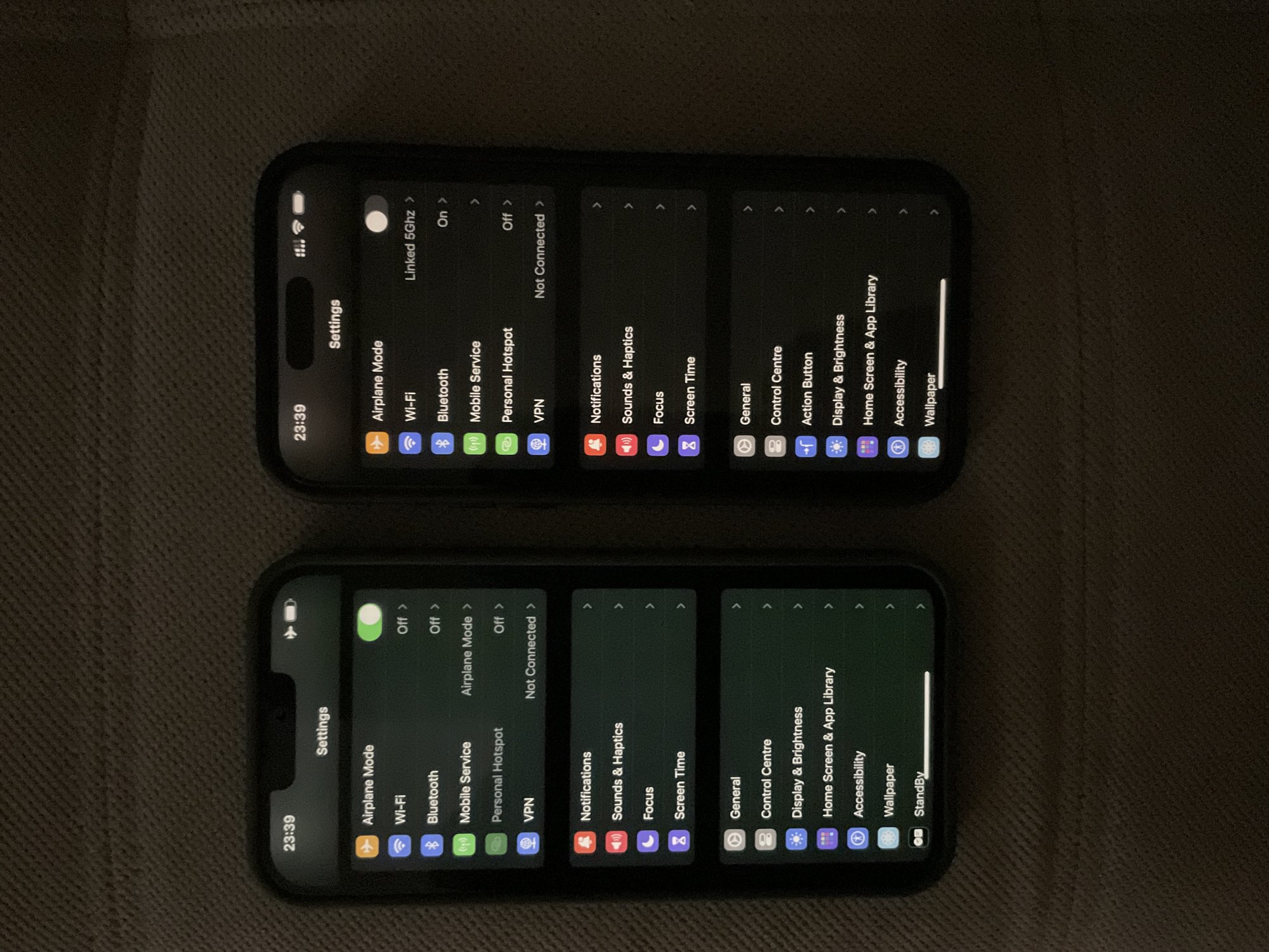

pics taken with an iPhone 12: NS (Max strength) and TT on.
Note: the model on the right has the protective film installed.

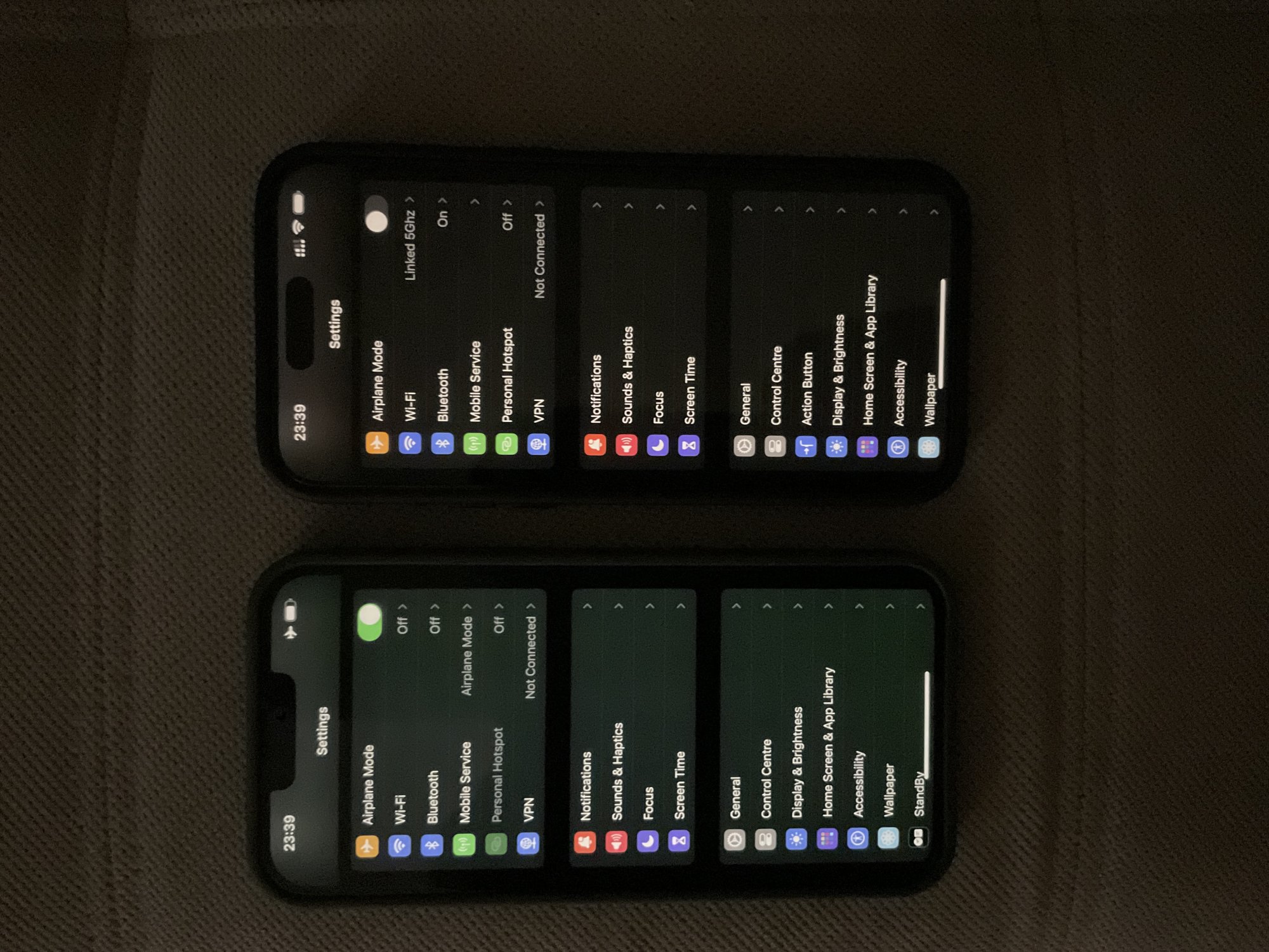

even this year I’ve been through some swaps. I decided to keep the one on the right (mainly because I like more the color, natural titanium). The one on the left (space black) has a pink blotch in the upper right corner, the other one, uhm, can’t tell.
In the everyday use (day/nugth, indoor) you honestly can’t notice anything.
Just checked.
It would be a coincidence but: left unit is G9N33, right unit is G9N32 :rolleyes:
How can you search inside the stacks file? There are tons of lines 😮‍💨

Local files of your phone.
But what should you do from this screen? saving to file the file is empty!
