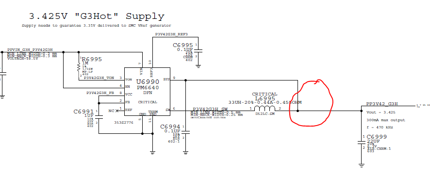

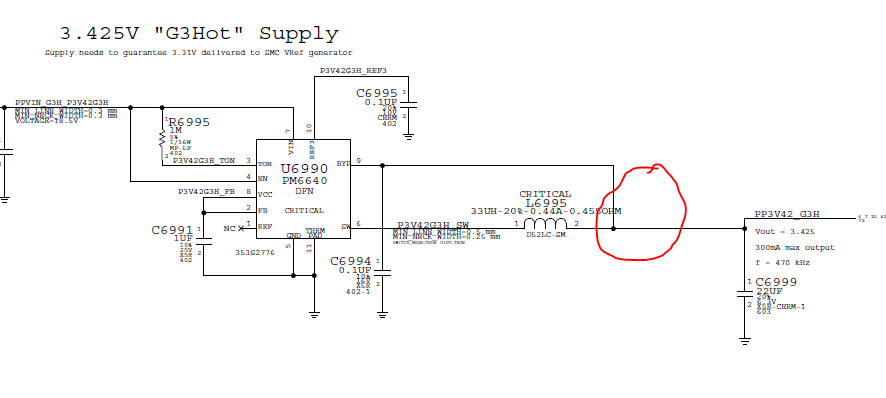

Hello,
Is there an easy and concrete way to detect G3Hot (or others for that sake) shorting to ground?
I have a water damaged logicboard that doesn't power on using battery OR charger.
1. I have noticed that the Charger light is dim and it is almost in blinking state and voltage fluctuates between 2-16.5V.
2. There is NO G3Hot on the board. When powered with battery, I can see that the G3Hot power supply does get 11.x volts but its output is short to the ground.
Now how can I determine what is causing that short? There are about 10 capacitors, mostly 0402, in different plaecs on the board that connect to PP3V42_G3H and a bunch of components. I was ondering if there was an easy way for me to detect where the short may be? Or would I need to step-by-stop remove each part and test?
Any advice would be helpful!
Many thanks!

Hello,
Many thanks!
Well.. You need to use a powersupply on the output of the 3.42v coil and increase current until something get hot... this is why i have a thermal cam....

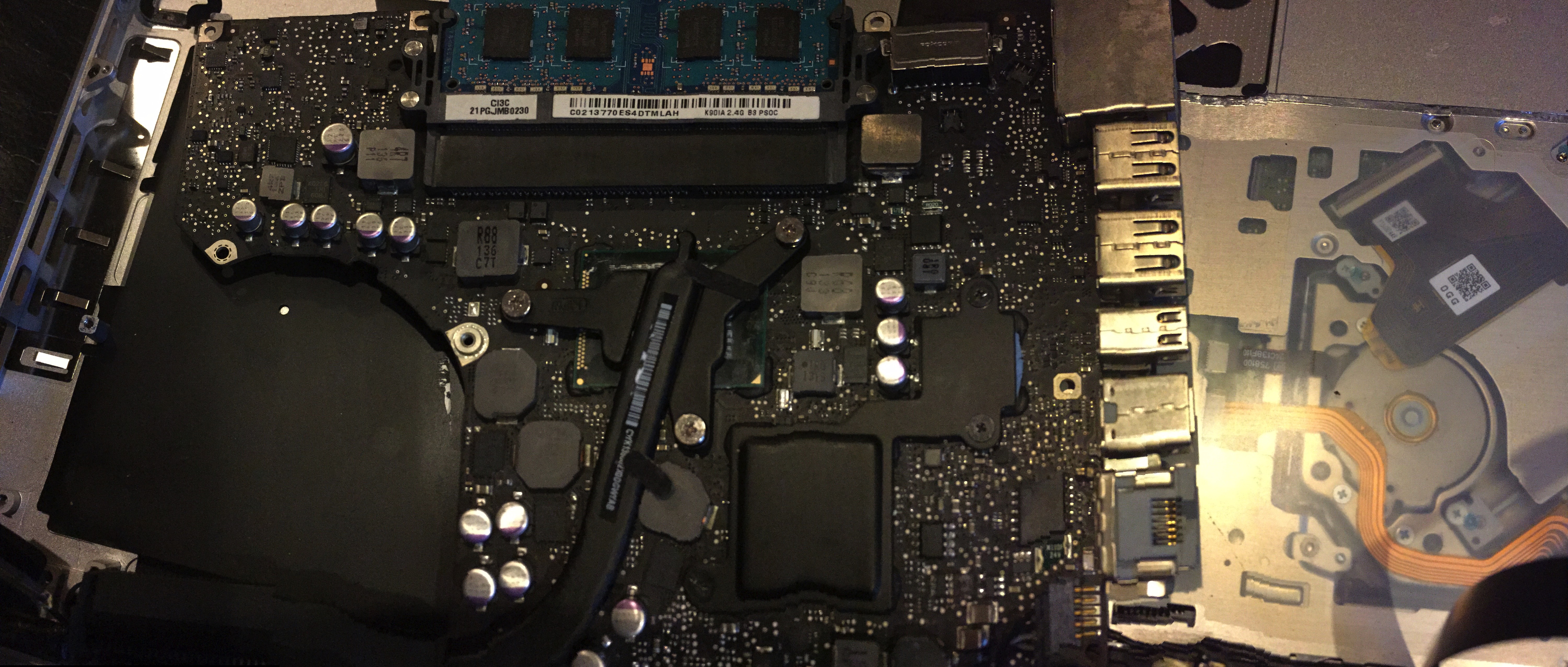

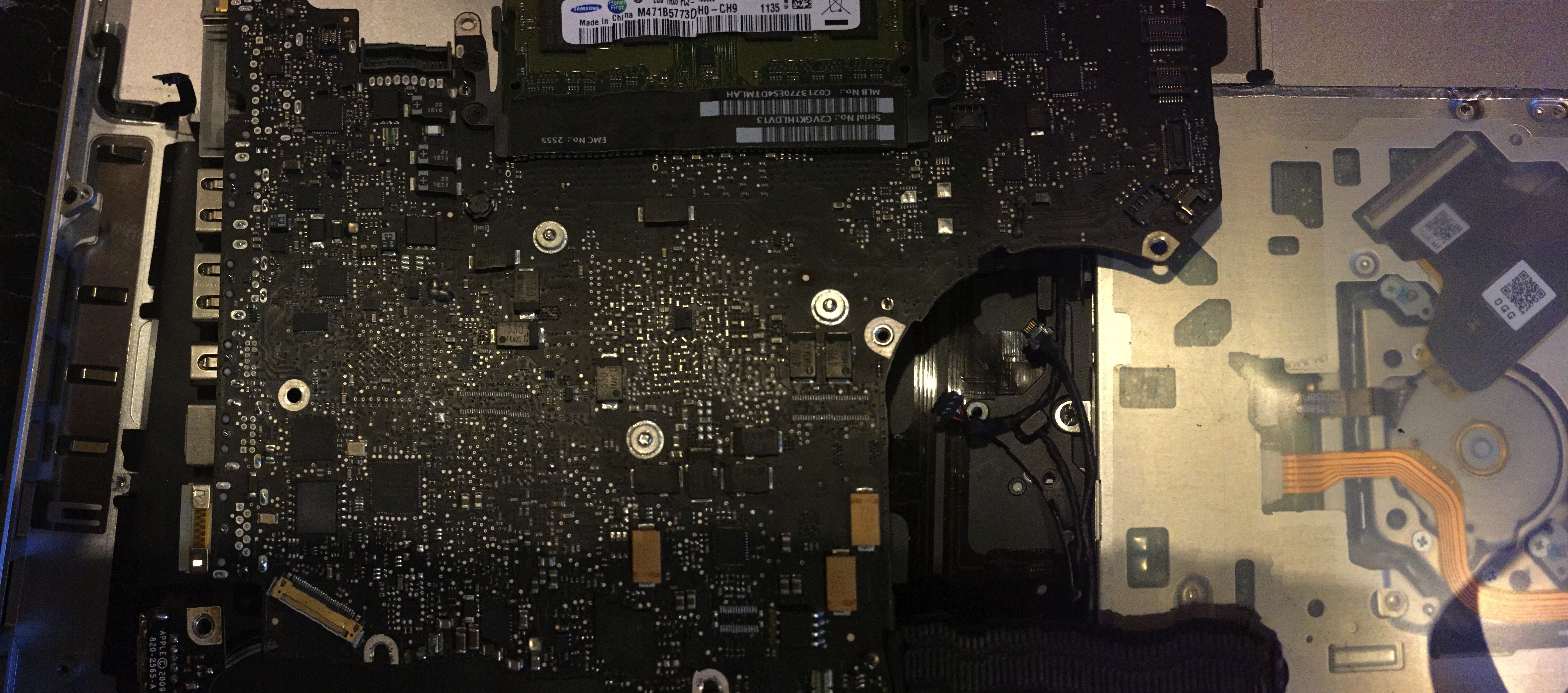

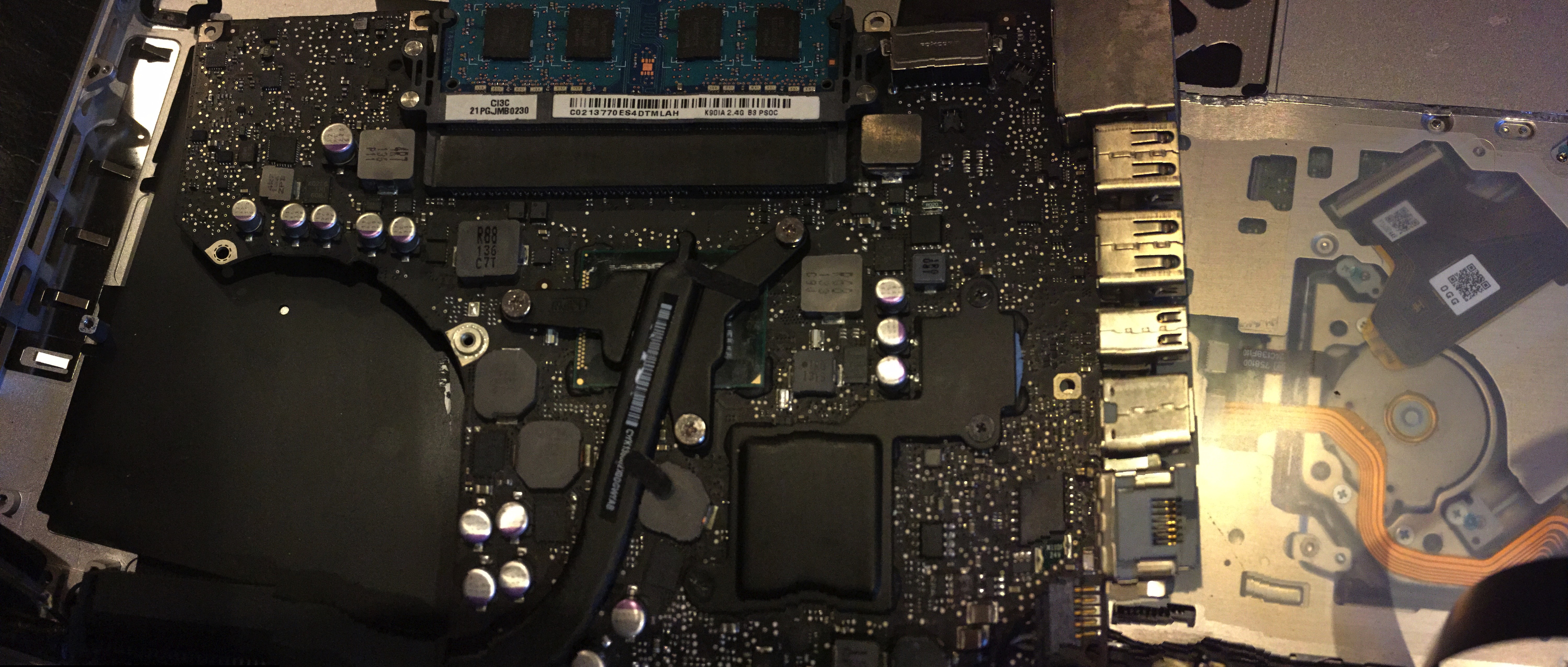

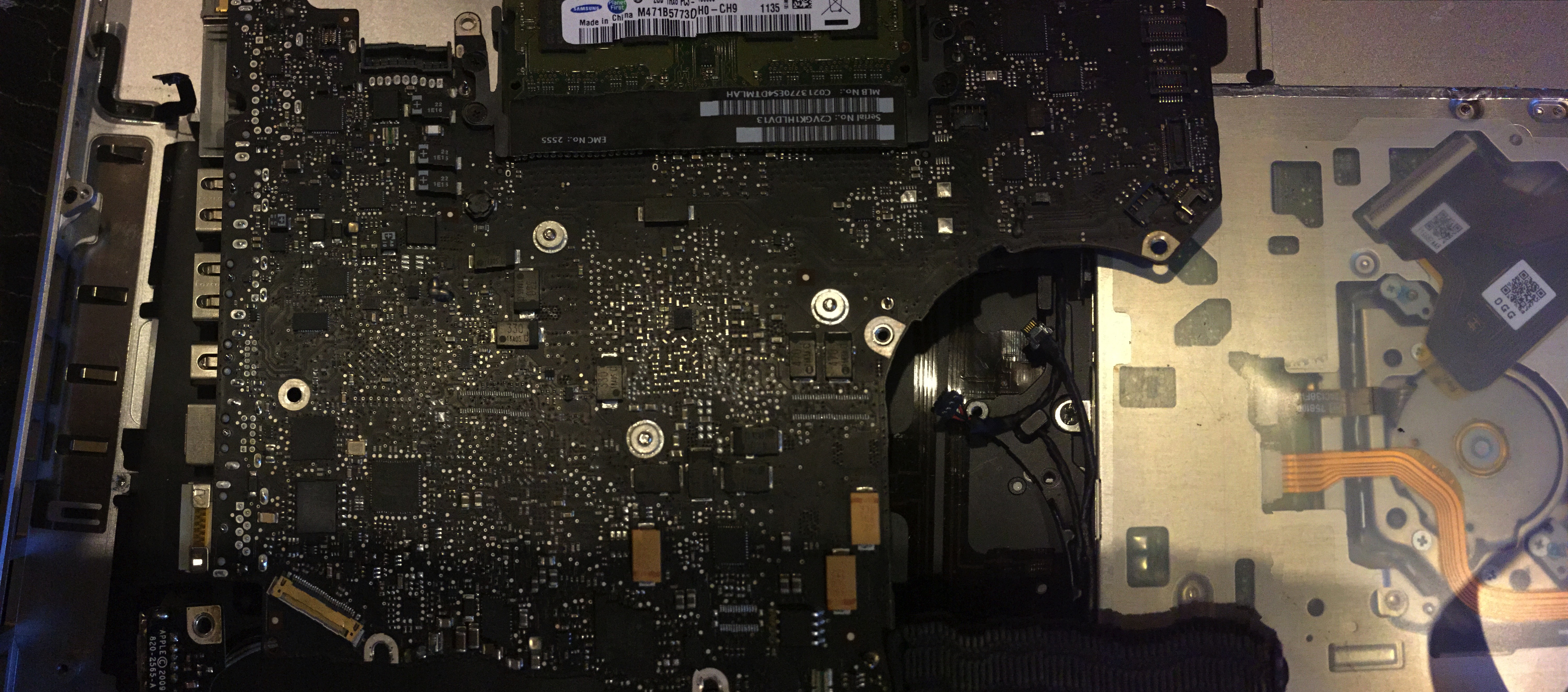

Hello everybody!
First, I want to say this is an utterly amazing thread; I haven't read the ENTIRE thing, but have gotten up to page 20 or so...
Basically, here's my situation:
I have a Late 2011 13" MBP (K20i), NO liquid spill; I honestly have no idea what the hell happened. One day it was okay but with the HDD had become badly corrupted, upon fixing it on another computer and putting it back, it wouldn't turn on.
After much debugging and trying everything I've though to do, here's what I've found out.
First, the symptoms:
  • Non-responsive to power button or shorting of power pads.
  • Magsafe does not light at all (occasionally it goes dim green and very rarely alternates dim green and dim amber), battery does not charge.
  • Powers on and can even boot the OS if I use the SMC bypass method (Obviously when I do that, fans on full, no sensors, etc.)
  • I've tried running an ASD while on that mode, it gives me an SMC communication error (which I believe is normal in that mode) and nothing else fails. Obviously, since there's no SMC there are no sensors.
  • This will only work if I charge the battery on another mac.
I have tried booting into rEFInd and force-flashing the SMC to no avail. I get an error because the SMC is in B (base) mode instead of the correct A (I think), if I reset the smc via the command-line with the smc flashing utility, the commands returns 0 and the computer immediately turns off and exists the SMC bypass mode, so again it won't boot.
I remember when I first opened it there was a little bit of corrosion around the SMC chip but I thoroughly cleaned with IPA the first time I opened it (of course, battery disconnected)
Now, I cannot spot anything physically wrong with the board.
Measurements I've done:
  • G3Hot is around 3.45V wherever I measure it.
  • No SMC_BC_ACOK.
  • Magsafe pins 2 and 4, 0.3V.
  • Both fuses are OK.
  • The SMC_RESET_L gave me (I think) 2.8V.
Have measured a couple resistances relating to the above measurements and they've all measure very close to the values the schematic gives.
I have no idea where to go from here.
Frankly I feel somewhat like a kid playing with his father's tools but just maybe I can learn enough and you can help enough to at least be able to diagnose the issue.
Here's the relevant portion of the ASD log:

Hello everybody!
  • No SMC_BC_ACOK.
This is very probably the SMC.... but you need some tools and skills to replace it...
Your pictures are in very bad quality to check the board appearance.
To me, its 95% probable to be SMC..
Wow, yeah, I thought they looked better. Well, nothing looks burned, anyway. Hahahaha.
