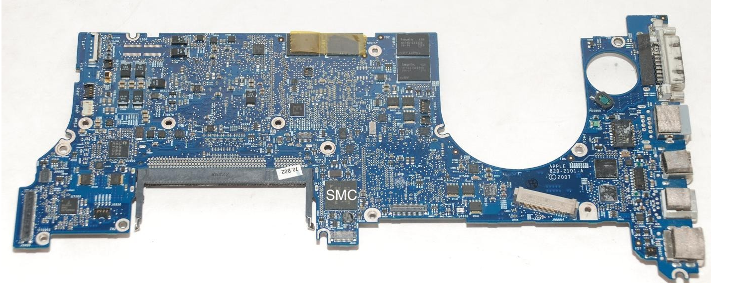

now show in Mac OS as 0%, and if i go to system preferences - power properties - the error occurs during collecting data.
I think water damage pull down SDA line of SMC.
kOhm.
So i believe that you need to start eliminating users of the Battery SM bus.
(battery, battery lever indicator, charger IC and SMC)
Sounds like you have unplugged the battery light indicator.
I would next (with the laptop off) unplug of battery with the magsafe plugged in, look and see if you see logic on both SDA and SMC pins. If so the battery was/is messing up communications on the Battery SM bus.
If the battery unplugged changes nothing, the only 2 thing on that SM bus that you have not eliminated are the charge controller and the SMC.
This is drastic, but it is how i narrowed down my sm bus problem.
I narrowed mine down to either the charger chip or the SMC. Since I can replace the charger chip, i cut the trace to the bad signal with an exacto at that pin of the charger IC. Doing that disconnected the charger chip from that pin on the bus.
The charger chip is being replaced now, will report back when it's done.

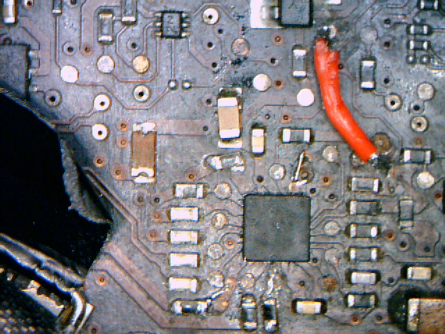

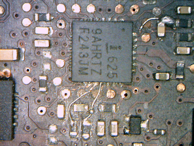

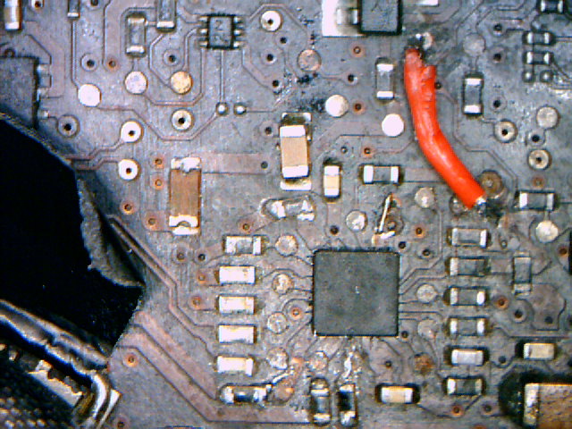

I started looking around on the logic board to see what I could find out. I came across a liquid damaged portion of the board that did not look great. As I was measuring resistance across one resistor it moved... not good. I desoldered it and repaired the landing pad and replaced the resistor with a new one from a spare board. I then noticed a test point that looked rather corroded and indeed the entire copper dot had rotted out and opened up the trace between two capacitors. I repaired the trace with a small mod wire and...
Problem resolved. Just thought I would report this in case anyone had run into this. It may be a good idea to have a look at these particular circuits on your logic board.
The model is a Macbook Pro 13" mid-2010 model. The photo is one I dug out of my files so ignore the notes concerning backlight voltage. However, see the red and green notes concerning the bad traces I discovered.
Hope this helps someone rescue a Macbook. 🙂

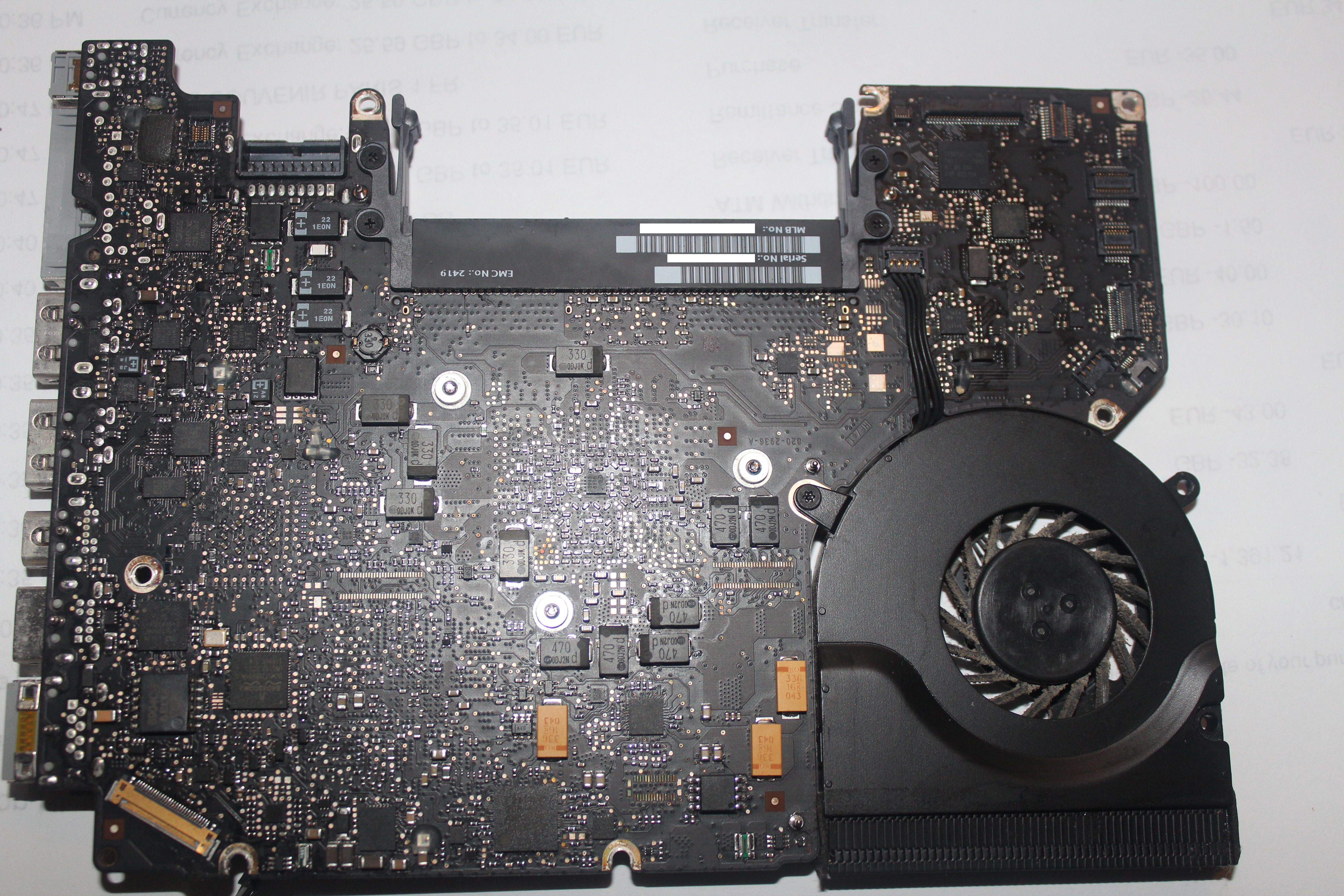

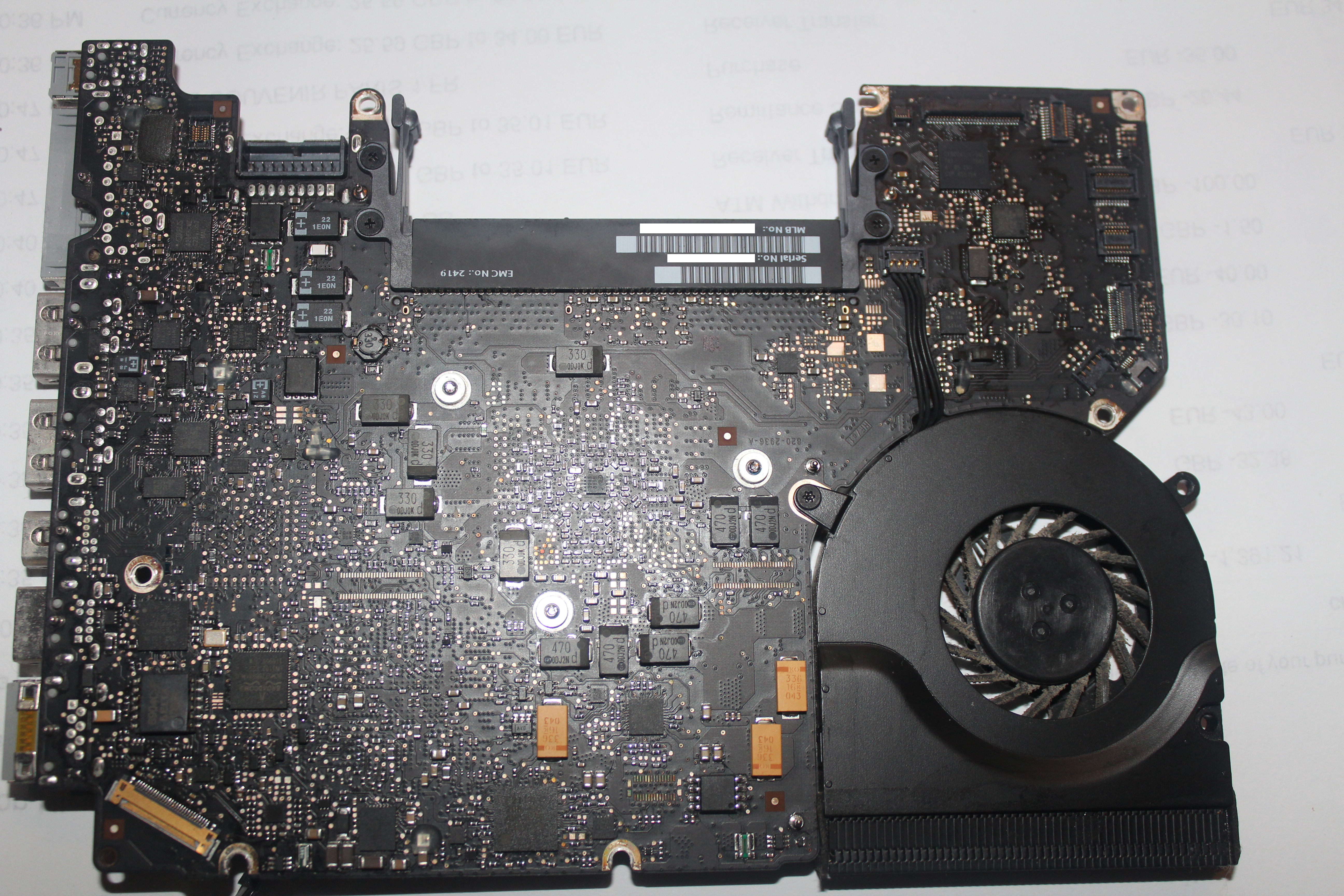

Hello everyone, been following this thread closely, searching for something to help me out. I keep thinking I'm getting closer, but no such luck. I have the computer in the title, and it will only boot with the SMC Bypass. No battery charge, high fans, etc. I have taken it apart a couple times, but cannot find the SMC chip. I found an upload of Landrex Board View, but don't have, and cannot find, the .brd files for this computer. I believe I need 820-2101-A, but I am not sure, and don't have the computer in front of me at the moment, so feel free to correct me! I just would like someone to take a picture of the chip, or explain where it is, if you could. It would be much appreciated.
Here you go....
Battery Indicator
Anyone has a problem like this?
My Battery Indicator always appear even magsafe disconnected.
Some corrosion inside and i clean it already but still doesnt help.

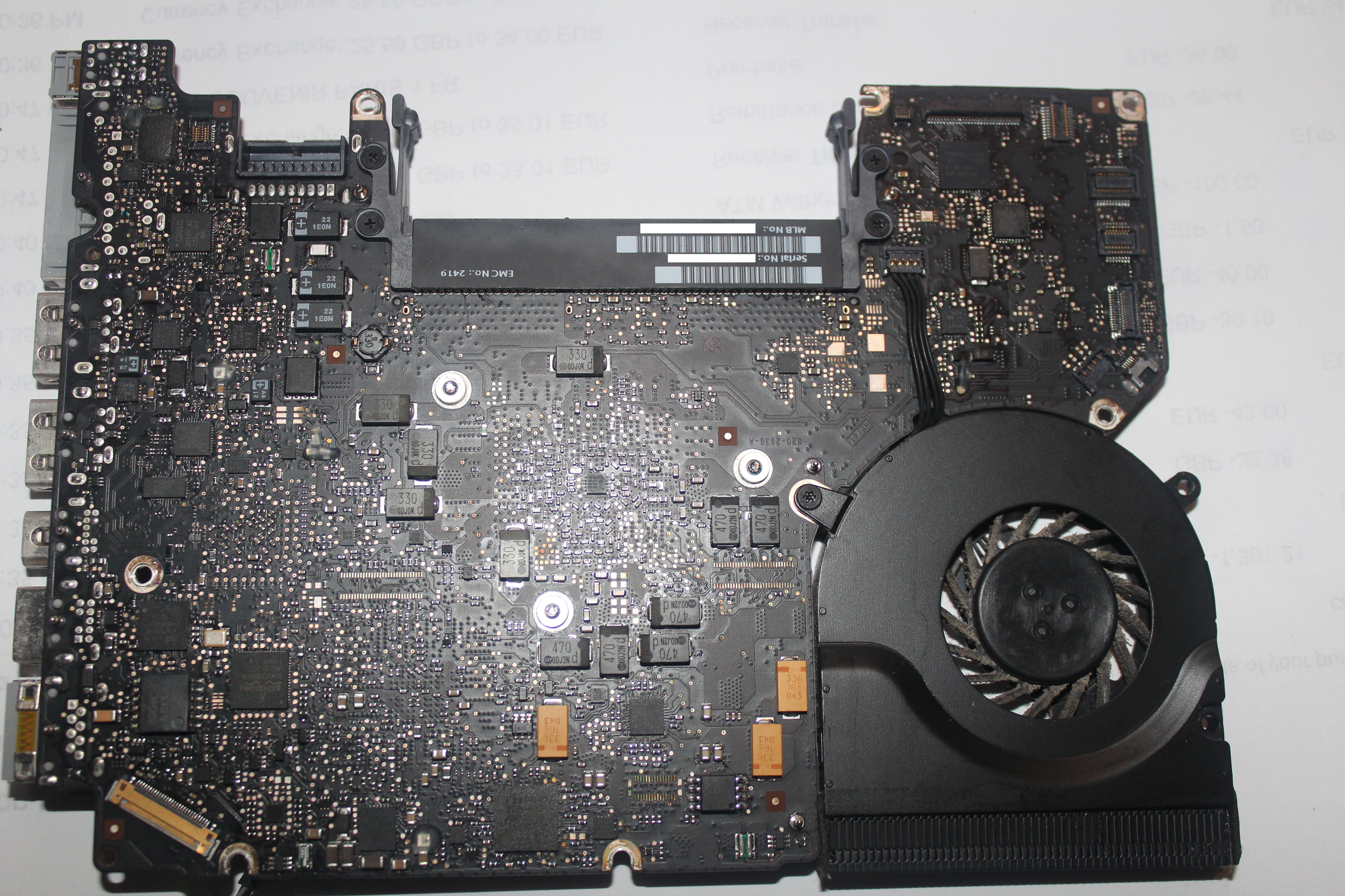

Hi, all. Hoping someone can help me.
I was taking a look at a Macbook Pro 13-inch, Early 2011 for a friend - who reported a dead battery and other difficulties starting. The way it was explained I thought the OS got corrupted with one too many power disconnections when running, which seemed to be confirmed when the battery was fixed and the system would only work again after a reformat.
Everything seemed fine, until (when I was foolishly testing it with the metal back plate still off) it died when running and wouldn't power back on no matter what. Battery only, nope. Magsafe only, nope. The SMC reset key combination, nope. SMC bypass trick, nope.
So I'm trying to get to the bottom of this. It seems either a strange coincidence that it died just as I was testing it after a routine battery change, or I did something catastrophically stupid and... well, I'm not sure. Maybe I shorted something out with the board exposed?
The battery charges, and the green (or orange if it's charging) light comes on. Measuring with a multimeter, many of the voltages are live - including G3Hot. Nothing seems to get burning hot, but many of the components are warm to the touch.
I've attached a photo. Seems there's a bit of corrosion, but I can't remember if it pre-dated me working on it, and I didn't take a 'before' photo.
Based on this evidence is it clear what happened? Whether the board was on its last legs or whether I killed a working board (guess it doesn't really matter, but if I did it I want to make things right)? Is there hope for it (I don't have much in the way of diagnostic equipment, only a multimeter, soldering station and heat gun)? Any guess as to what the next step would be?
Thanks a lot in advance for any assistance. This is really driving me nuts.

HI, i'm new in this forum and i have a question:
i have a macbook pro (mid2010) A1297, 820-2849
with an 85 W charger, battery and MagSafe-DC-In-Board all new and working
but the battery is discharged only 10 mv left
No response to power button. No response to standard SMC reset procedure.
light green on magsafe but do not charge the battery
here i attachted some mesurments that i made with fine tips and a digital multemeter
sorry i i gave too much info at start
any help would be appreciated.
