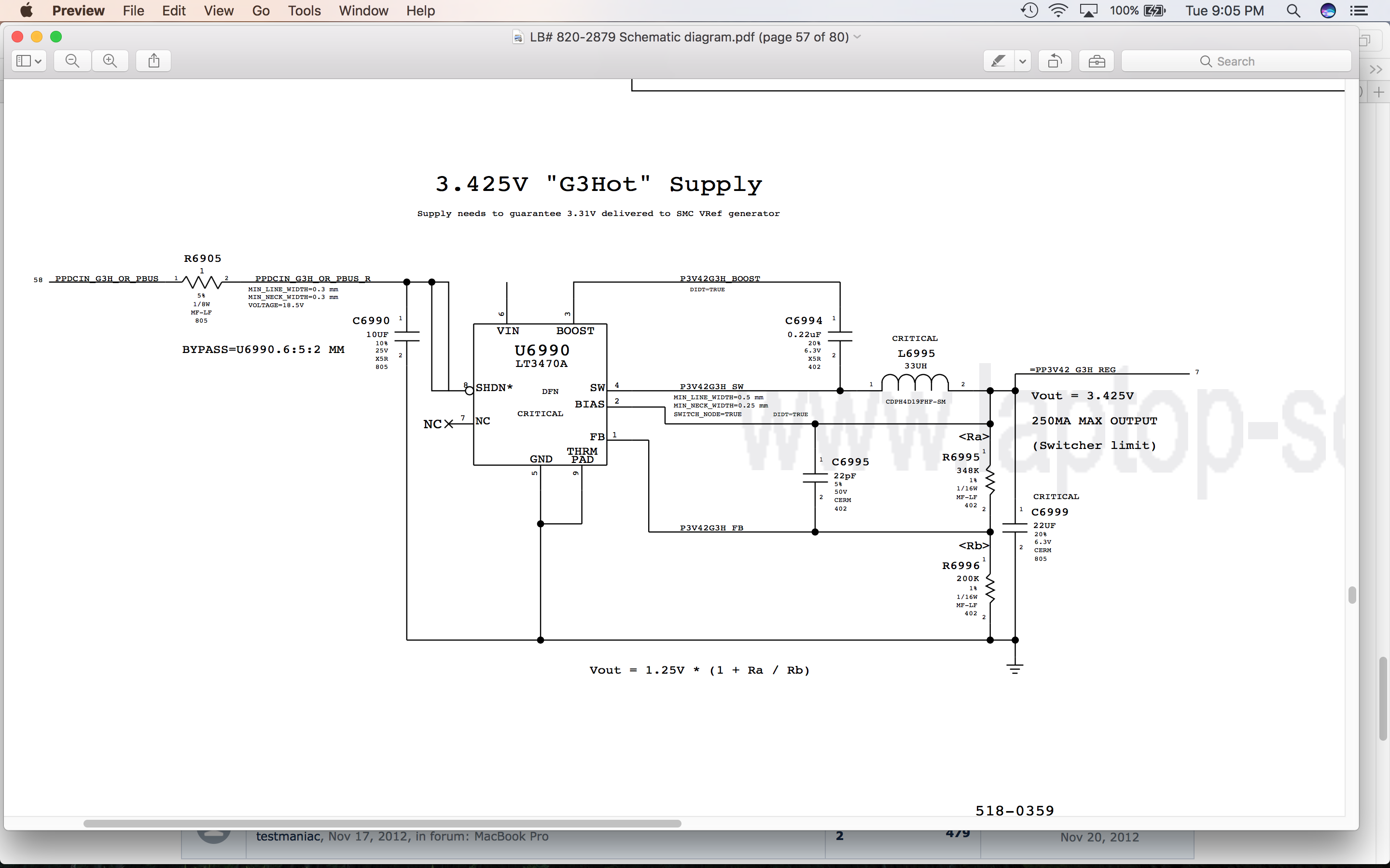

Start with the one wire circuit. G3hot is supposed to be 3.42v so thats too high. See attached pdf. Look in that area for damage. DC in board appears fine. Pin 2 and 4 are attached to ground thats why they drop. Is the battery disconnected? if its bad it can cause problems. If its connected and just dead then your light should turn from green to orange. If it does not then you have a problem with the charging circuit

Sounds like the battery is not being recognized. Check data lines, is this a known good battery?

I received an A1278 13” mid 2010 i5 macbook with what looked like minor water damage. Tested logic board without the keyboard connected and it booted fine.
Replaced keyboard and everything works great again.
The issue is when charger is attached there is neither a green or orange light on charger. When booted in the upper right of the display shows 41% and the battery indicator symbol shows the charger is connected. As long as you have the charger attached the battery level does not change either up or down.The system will boot with only battery, but will not with just the charger
System Report shows Charge remaining: 2339 Fully Charged: No Charging: No
Full: 5664 Cyc: 3 Condition: Normal Battery Installed: Yes Amp: 0 Voltage: 11402
AC Charger info: Connected: Yes Charging: No Have tried a couple of magsafe chargers, replaced the magesafe also.
SMC has been tried
Logic board 820-2879B
Have full setup for testing voltages. I have the board Schematic and board view need to know what to look for and where.
Thanks in advance for any help!!!
The centre pin being 0V is why the led isn't green. How familiar are you with reading schematic and boardview files? You can find them searching the web. You need to check pin 14 on the isl6259 charger IC to check if it is 3.3V. If not then the charger IC is not happy. Then you need to troubleshoot that circuit to find the issue. Output of charger should be 12.58V.

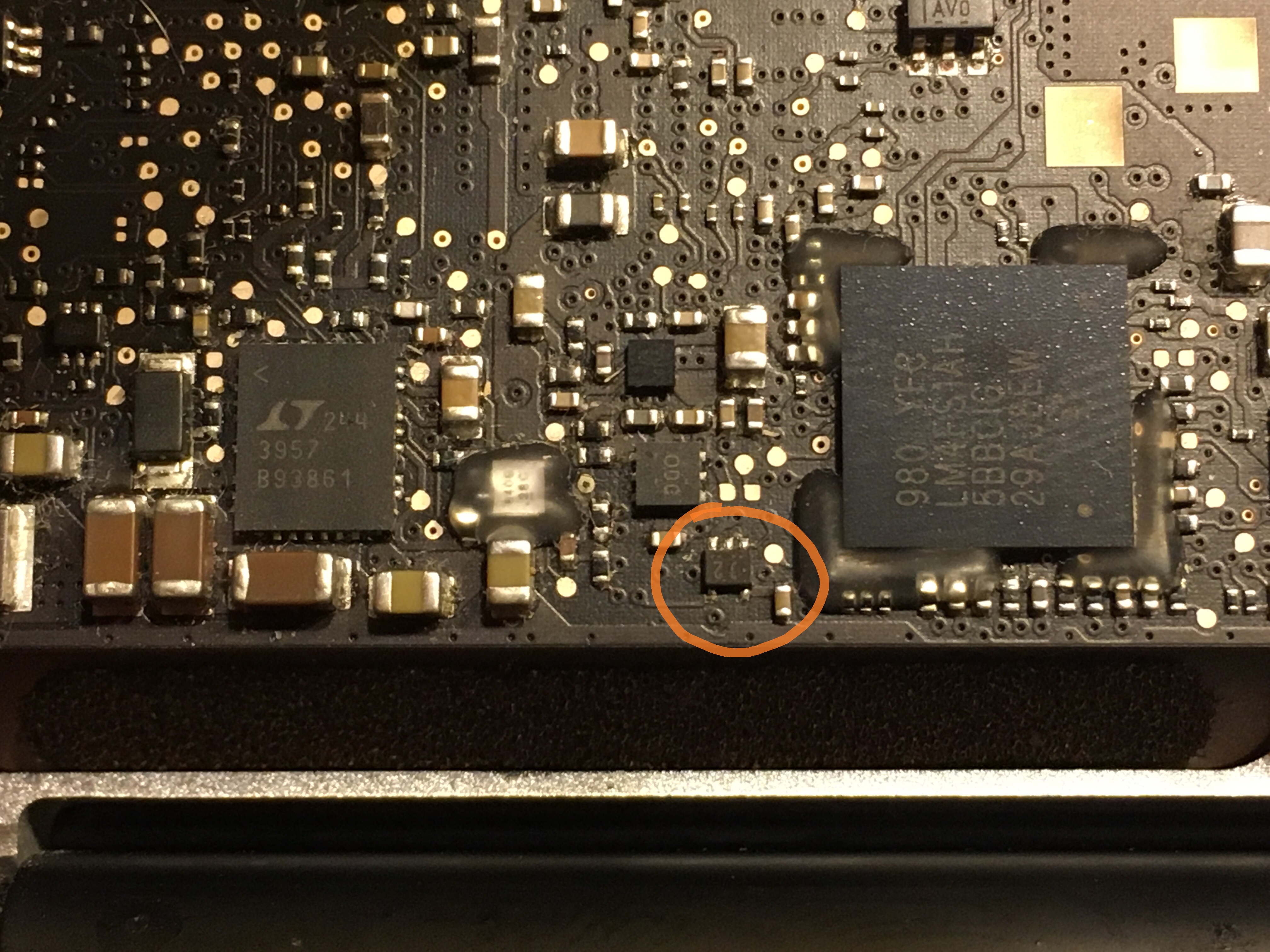

In order to get a green light in the magsafe ,you need to have G3hot (3.42V) in pin 5 of U6901 and 3 V (SMC_BC_ACOK) in pin 1 and pin 2 of U6901 .so check if you have SMC_BC_ACOK (3V) ?
Also check the voltage in the white fuse next to the battery connector you should have 12,5 V.
If you can charge the battery in an other macbook pro ,you probably can start the mac,the battery you have is discharged .
Thanks for the prompt reply. I measured 2.36 V on pin 1 and 2 of U6901. On pin 5 I have 3.46 V. The white fuse is reading 12.22 volts.
I just wanna make sure, was I testing the right part? I have attached a photo in which I circled what Boardview showed was U6901. I'm pretty sure I got it right but I wanna check.
Also, when measuring, I place the positive terminal on the pin to be measured and the negative on the ground around the screw on the motherboard?
SMC _BC_ACOK suppose to be 3V ,2,36 V is kind of low. check the voltage of pin 4 of U6901 ?
measure the voltage of pin 3 of DC in board if you get 0 V it means the SMC is not communicating with the magsafe .
3.43 v on the third pin of the DC in board. 3.46 v on the 4th pin of U6901.
