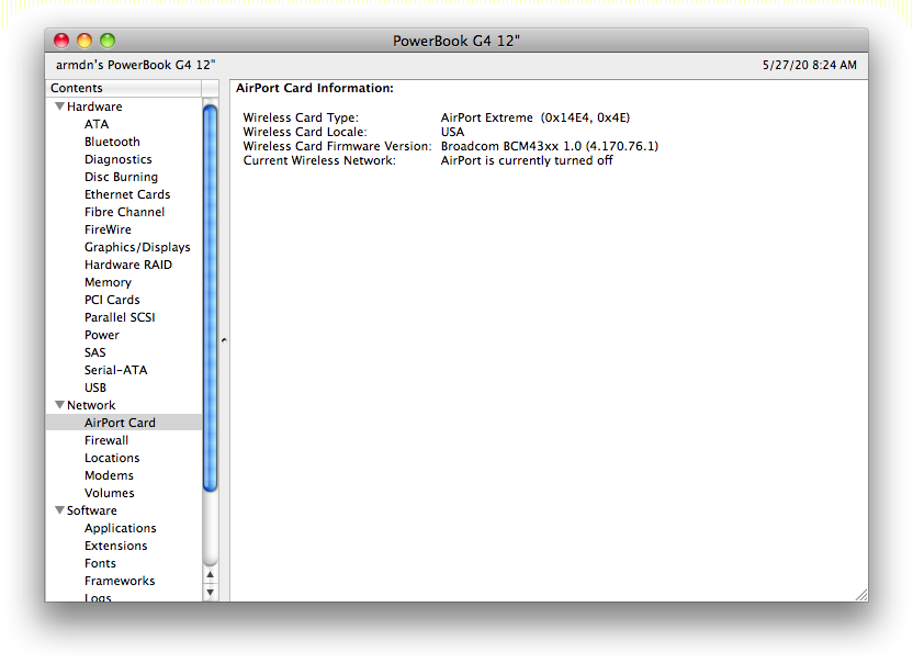

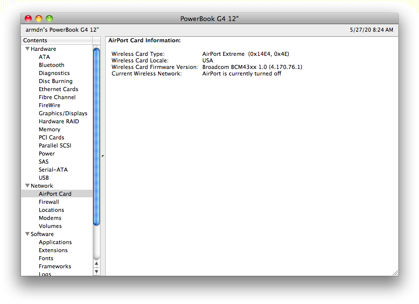

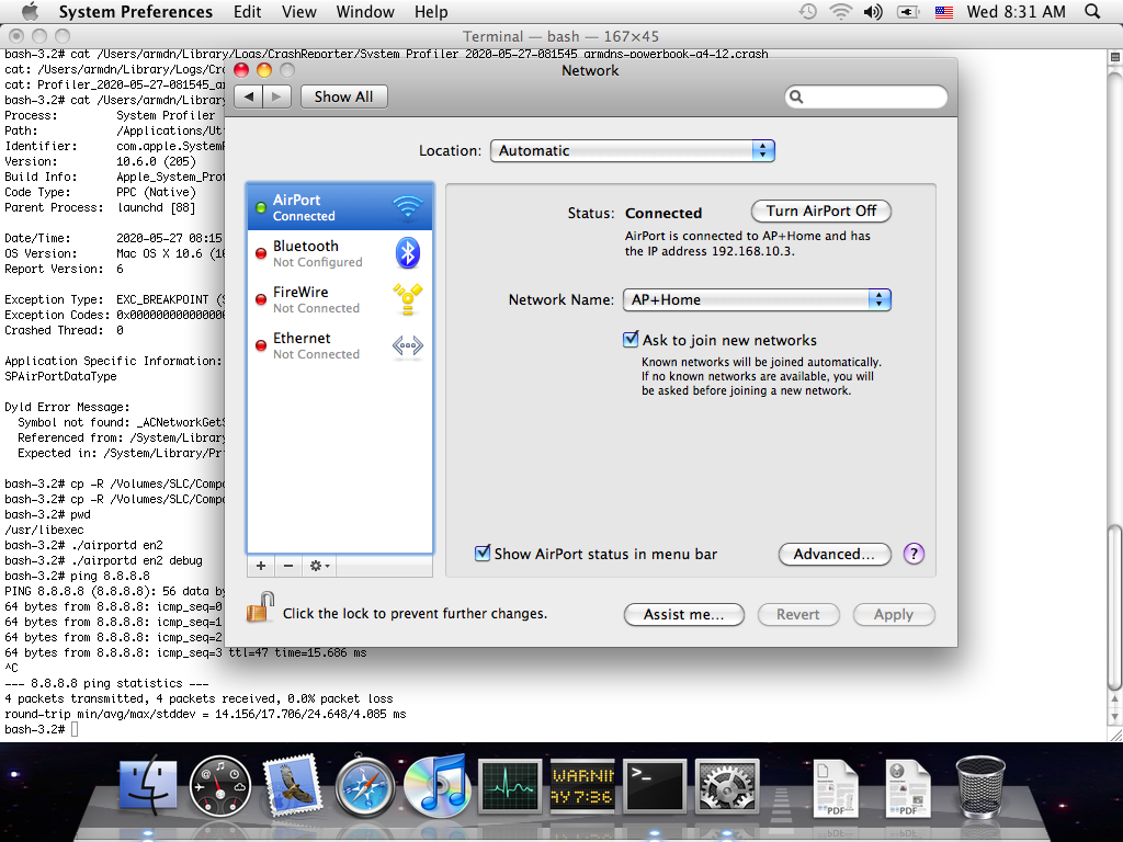

Mac OS X PPC 10.6beta Clouded Leopard
FIXED! Airport Extreme is now working!
And somewhat fixed AirPort section of System Profiler. But it is incorrect detect status of AirPort Extreme. Actually it is active...
What to do with that little bugs is still a question. And in logs many errors about CarbonLib or something...
To make AirPort Extreme working, we need to import these components from 10A96 above the same in 10A190:
/System/Library/CoreServices/Menu Extras/AirPort.menu
/System/Library/CoreServices/Apple80211Agent.app
/System/Library/Frameworks/AirPort.framework
/System/Library/PrivateFrameworks/Apple80211.framework
/System/Library/Extensions/IO80211Family.kext
/usr/libexec/airportd

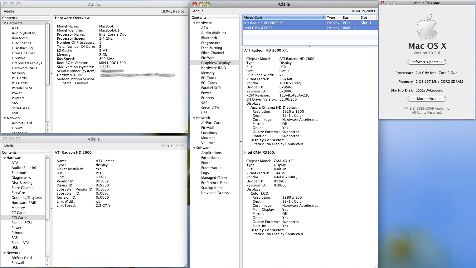

This is a total and absolute shot in the dark but when I used an HD 2600 XT externally (with a MacBook) on Leopard and Snow Leopard, I used ATY_Init to initialise it.
However, iirc @LightBulbFun said that the drivers for the 2600 (and presumably newer Radeons) were compiled for x86 only, making the X1x00 series the newest to work on ppc in OS X.
Yeah, whether AMD and NVIDIA bothered to write big endian PPC drivers for specific video cards so to accommodate parsing compute shader data (namely, to accommodate professional customers who were running Quad G5s during the transition) is the big question some of y’all will need to test. And I hope y’all do!

But QE/CI are supported on low end GPUs such as e.g. the GMA 950 on the mini 1,1 under SL, both are clearly activated with CI hardware accelerated. Just to be sure that this was also the case on 10A190 I booted up a mini 1,1 from a PPC 10A190 install and it they are both clearly activated with CI hardware accelerated. Needless to say that for OpenCL, one obviously needs an OpenCL-supported card, so ≥HD 4XXX or ≥GF 8XXX; however no OpenFirmware or ppc kexts have ever been written for such cards though
