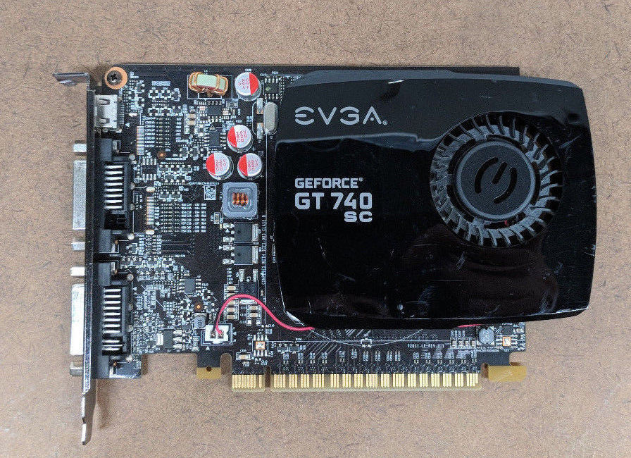

These were the lowest powered GPU'S supporting Metal:
  • ATI Radeon HD 5770 from Mac Pro (Mid 2012)
  • NVIDIA GeForce GT 640M (aka: GK107 N13P-LP) from iMac (21-inch, Late 2012)
(edit removed nvs-510 due to high cost) The GT640/740, based on GK107, should be enough power and costs $70 on ebay. No boot screen. Drivers are built into macOS.
The NVS-510 may be the physically smallest card to support metal. 35W TDP, 2GB memory, 192 CUDA cores and a GK107 Kepler GPU. No boot screen. Drivers are built into macOS. Looking at ebay, too expensive.

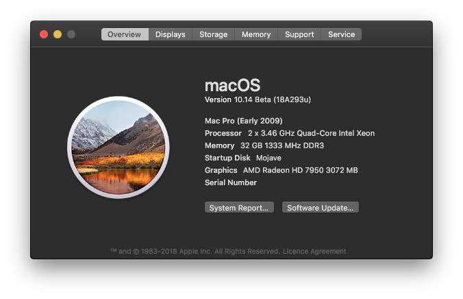

Can someone confirm that the Radeon HD 7950 3GB (Sapphire for example) supports Metal(2) and will hopefully also work in Mojave? Or is there a list which GPUs support Metal or are supposed to work in Mojave? Thought I've stumbled upon such a list today, but can't find it anymore ^^
crjackson2134
macrumors 601
Mar 6, 2013
4,847
1,957
Charlotte, NC
99.999% certain that card will work... ;)
The cards in the nMP are all 7xxx AFAIK, and they are supported...
Reactions: h9826790
