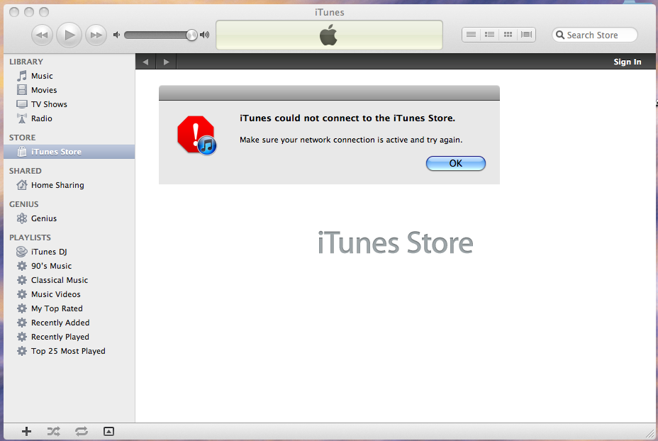

Now this is interesting.
This guy on reddit, running vanilla 10.5.8, recently reported an inability for iTunes 10.6.3 to connect to the iTunes Store. For reference, I just checked another 10.5.8 (w/ iTunes 10.6.3) install on my end, and sure enough, I was unable to do so as well. I ensured beforehand that it had a connection to the Internet, as well as the correct date and time.
Can anyone else on regular Leopard confirm if they are still able to connect to the iTunes Store? Maybe Apple finally pulled the plug with a recent TLS upgrade?
iMac G5, 10.5.8, iTunes 10.6.3, logged into the store OK but not able to view my account or make a purchase.
I am in the UK.
By contrast, a Macbook Air on 10.6.8, iTunes 11.4, logged into store, not able to view my account but apparently still able to make a purchase.

Hi @Hughmac
Have you relinked the 10.5.8 copy of iTunes against LWK? Also from the UK by the way! I’ll check mine when i get a chance and report back.
@z970 Is iTunes on Sorbet relinked against the certificates included in LWK or have you used the latest certificates available on Apple Open Source Projects?
Reactions: lepidotós
Hi @Hughmac
Sorry, no re-link as I'm not sure what you mean. I don't normally use LWK as I'm an InterWeb user.
All working fine in Mojave so there's nothing wrong with the store 😉
Cheers 🙂
Hugh
@ChrisCharman The version of iTunes shipped with Sorbet Rev. 1.4 is the system stock variant, linked against the default certificates (which in this case I suppose would be the ones from 10.13.6, unless iTunes uses its own certificates, which I would need to double-check). I did try linking iTunes against WebKit during testing, but that made no difference in neither usage nor connectivity except inflate the application size, so it wasn't included in the end.
I wonder if this is a US-specific issue?
@ChrisCharman The version of iTunes shipped with Sorbet Rev. 1.4 is the system stock variant, linked against the default certificates (which in this case I suppose would be the ones from 10.13.6, unless iTunes uses its own certificates, which I would need to double-check). I did try linking iTunes against WebKit during testing, but that made no difference in neither usage nor connectivity except inflate the application size.
I’ve just tested under vanilla Leopard in the UK using relinked and stock versions of iTunes and the same issue presents itself. Seems Apple have changed something on the backend. Perhaps they’re finally moving away from WebObjects or changed something else and have broken compatibility with older versions of iTunes?
Reactions: lepidotós and z970
I’m from the US and I also have noticed that iTunes 10.6.3 won’t connect to the store. This applies to both vanilla Leopard and Sorbet.
