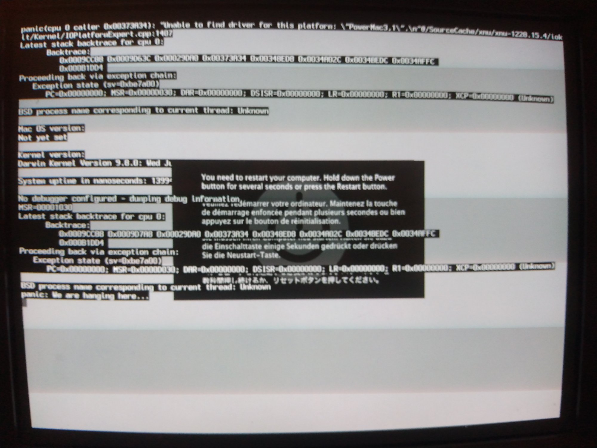

It does show 1MB. I installed Sorbet to my external drive and was able to boot my PB G4 Ti 867 from it. I then tried my Pismo using the drive and the same error showed up. You said you used Migration Assistant. Maybe I’ll try using that instead of Disk Utility.
No, I used Disk Utility in Tiger to restore the Sorbet.dmg to the partition I had made ready. I only used Migration Assistant once I had Sorbet running, to put my account on from a backup firewire disk.

Can I trouble you for one more thing? What is Boot ROM Version number?
Mine is 3.2.7f2.
The most recent one appears to be 4.1.8.

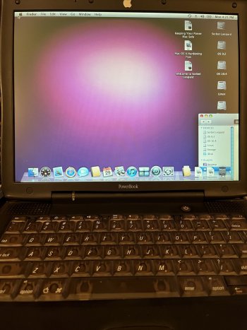

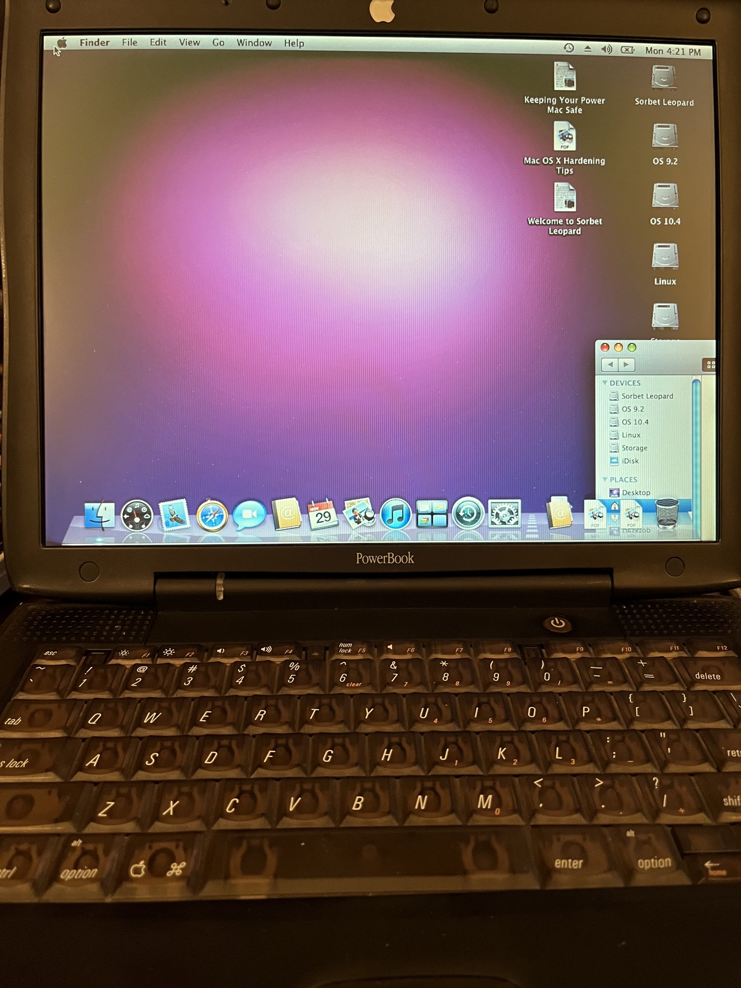

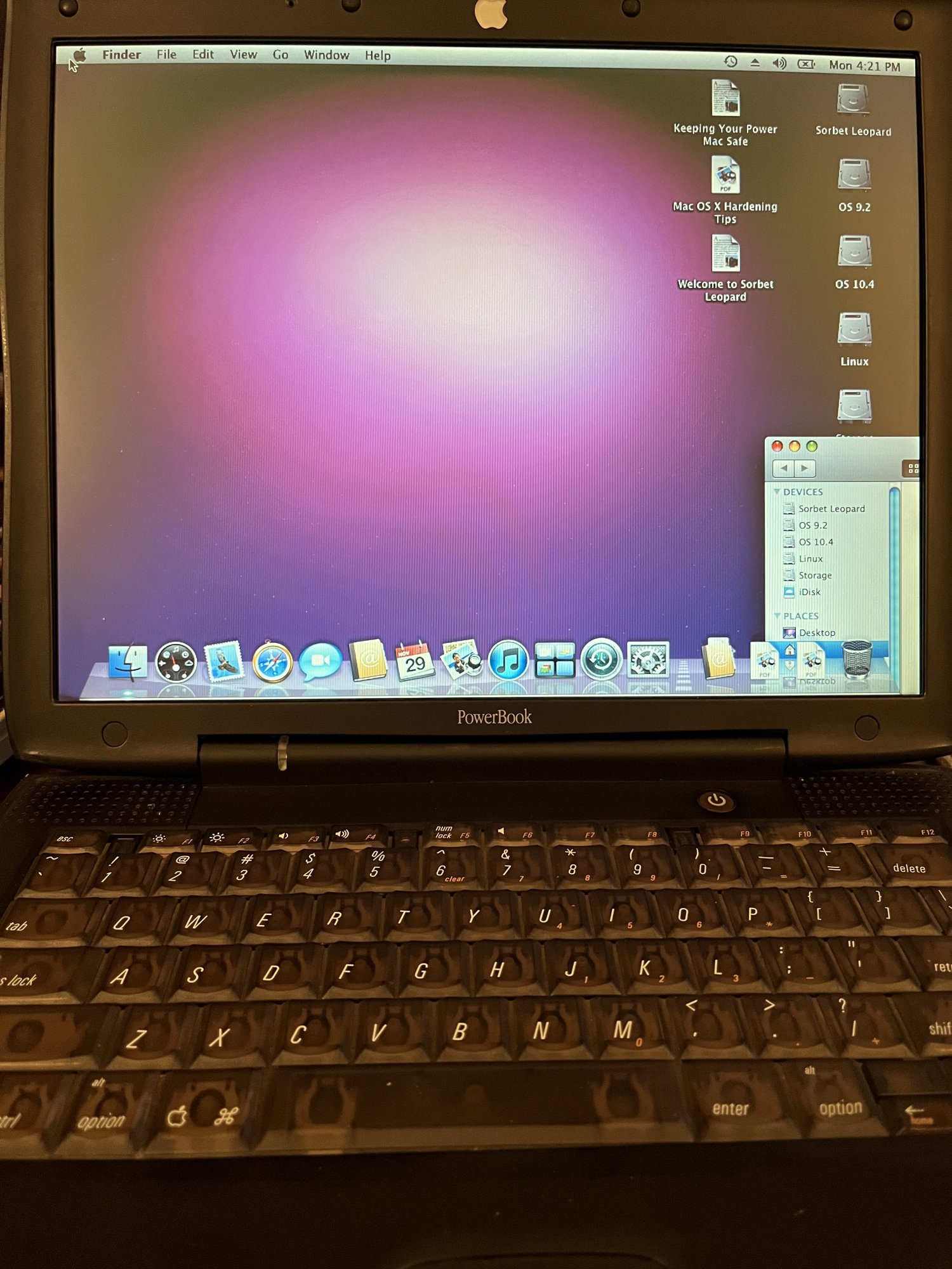

Success! I got Sorbet Leopard running on my PowerBook Pismo. I had to up date the firmware.

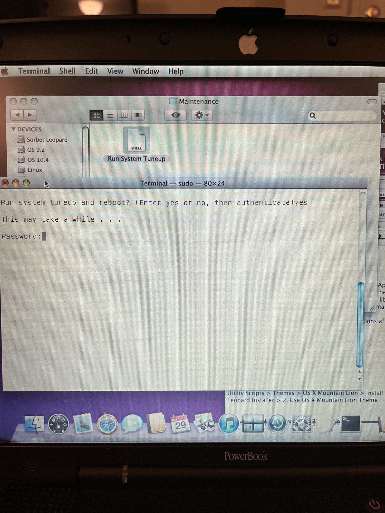

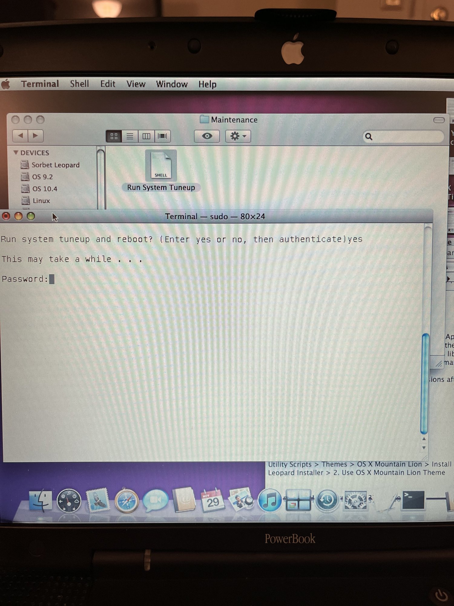

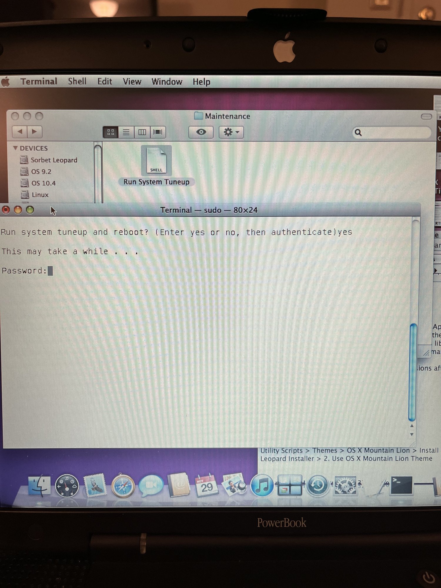

I am trying to run the Run System Tuneup. I typed in the password and but nothing showed up on the screen and then hit return. Is that normal? Is this actually running?
Yes, it takes a long long time on a Pismo! You may need to enter your password a few more times for each section of the tuneup.
Terminal doesn't show the password as you type it, by the way 😉

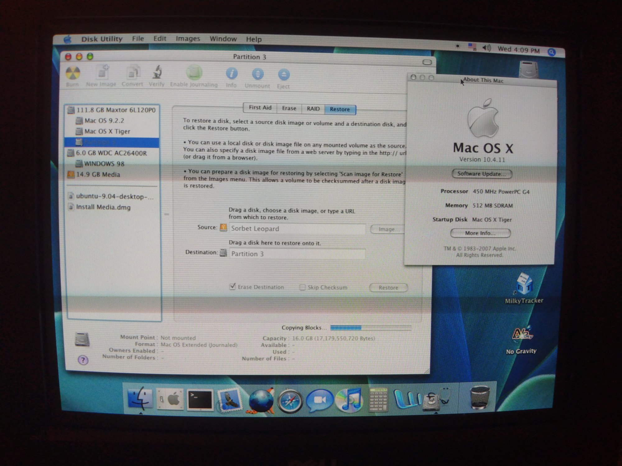

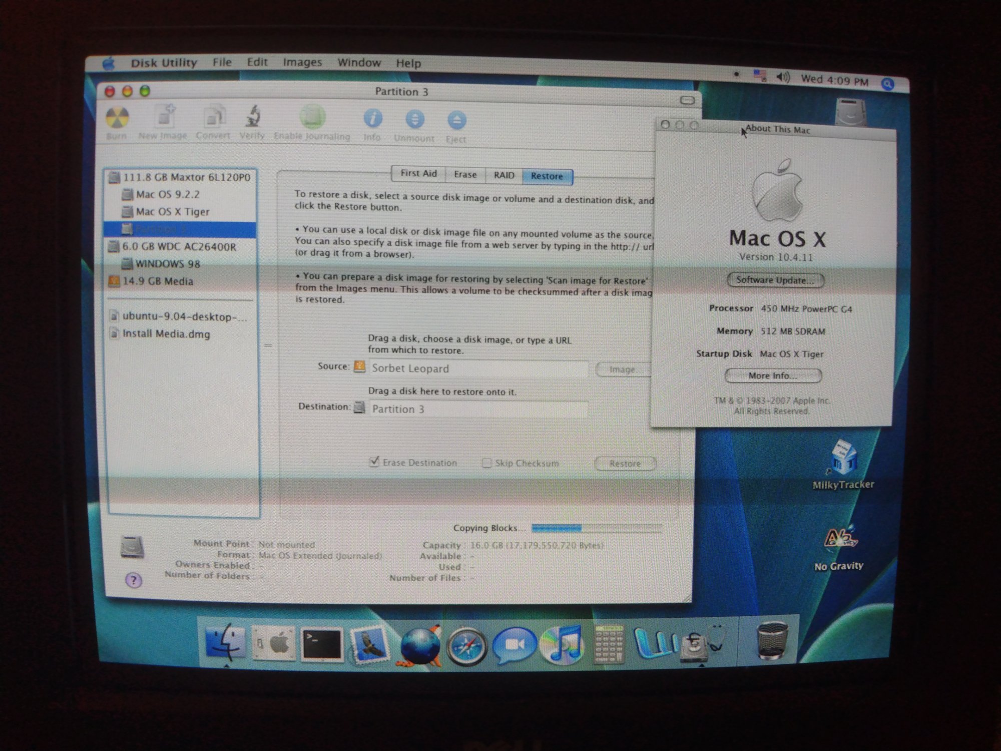

Ripped the 128MB stick out of Oddball, just to see how a nearly worst case scenario for Sorbet would perform (the only generous thing is that I'm at 450). I am now regretting it because that could have made the copying just that much faster.
Edit: image 2

Is there a firmware update for that computer? That solved my issue
Reactions: lepidotós
Probably not installed on it, I haven't installed any, and the guy I got it off of didn't seem to use it for very much. How do I check?
Click on more info. Under Hardware you should see Boot Rom Version
You’ll have to search Google or maybe post asking about firmware updates for your particular machine. The updates for my Pismo were luckily on the internet archive under an archived apple.com page.
