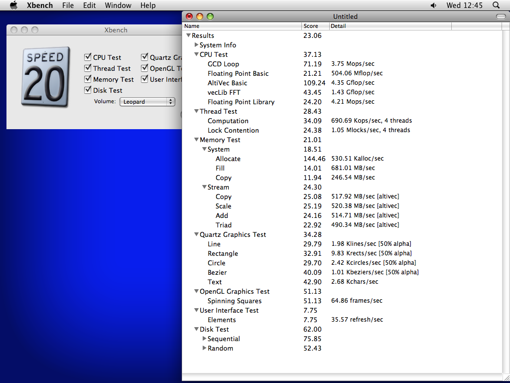

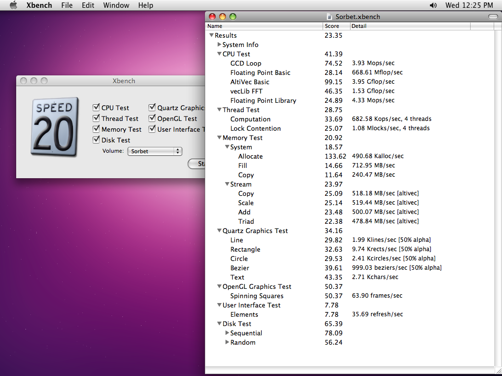

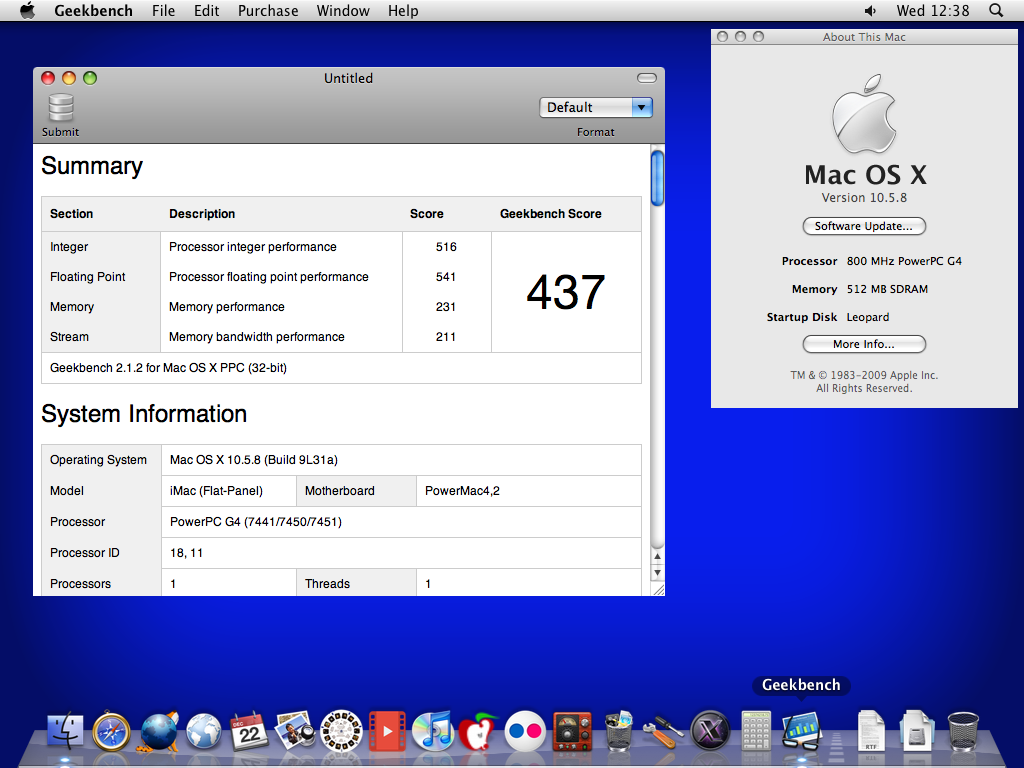

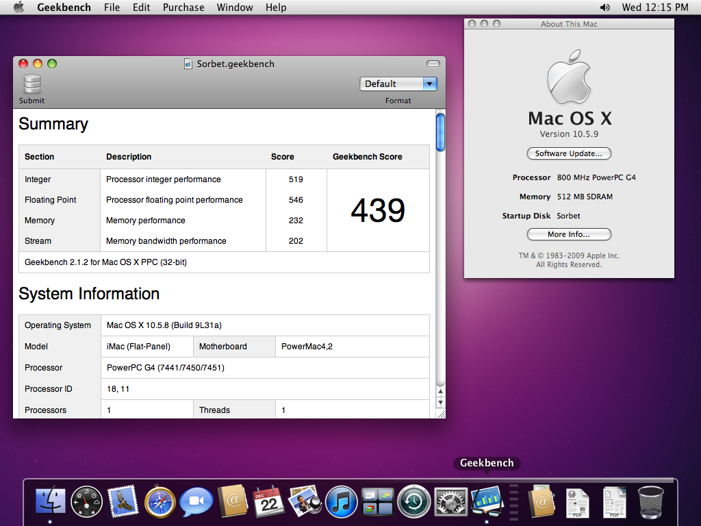

At long last I got round to trying Sorbet by taking my G4 iMac off OS9 duties and re-partitioning the drive.
It’s the 800Mhz model with 512Mb RAM and a 5400RPM spinner - so an ideal underpowered candidate.
As I was pitching Sorbet against my standard Leopard install which has nearly the same bundle of tricks applied, I wasn’t surprised to see no apparent performance difference - however, Geekbench and XBench both showed a few points in Sorbet’s favour.
My own ‘real world’ benchmark gave Sorbet the best lead, shaving between 30 and 50 seconds off the results from Leopard.
