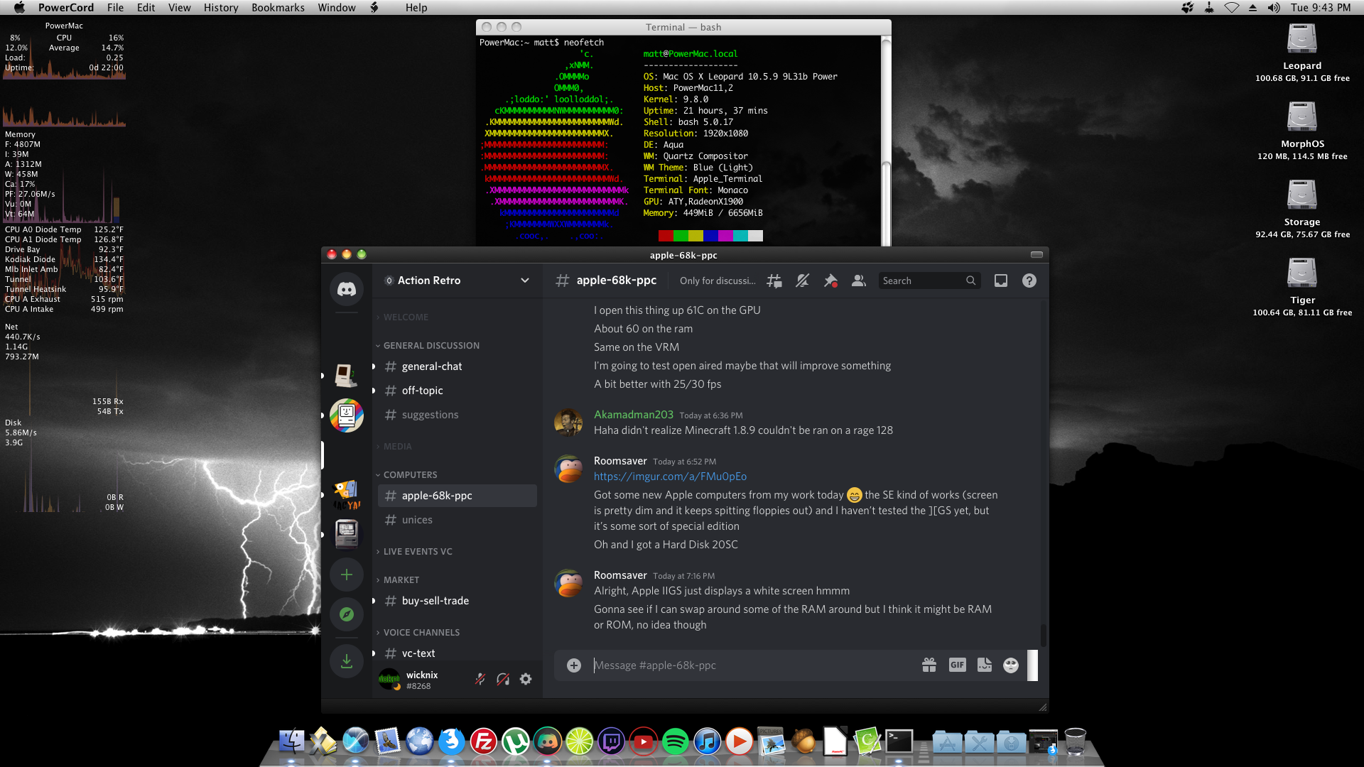

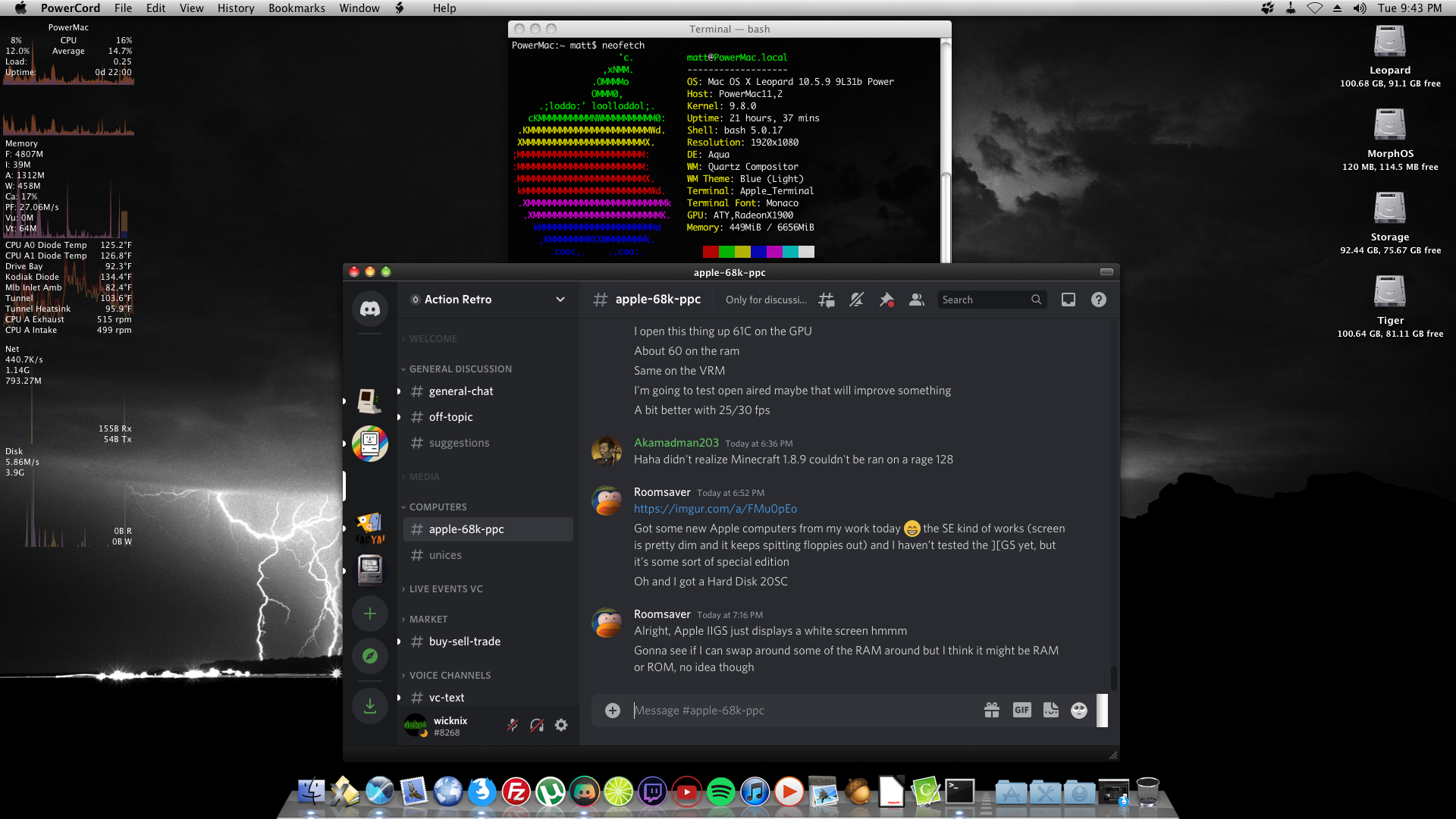

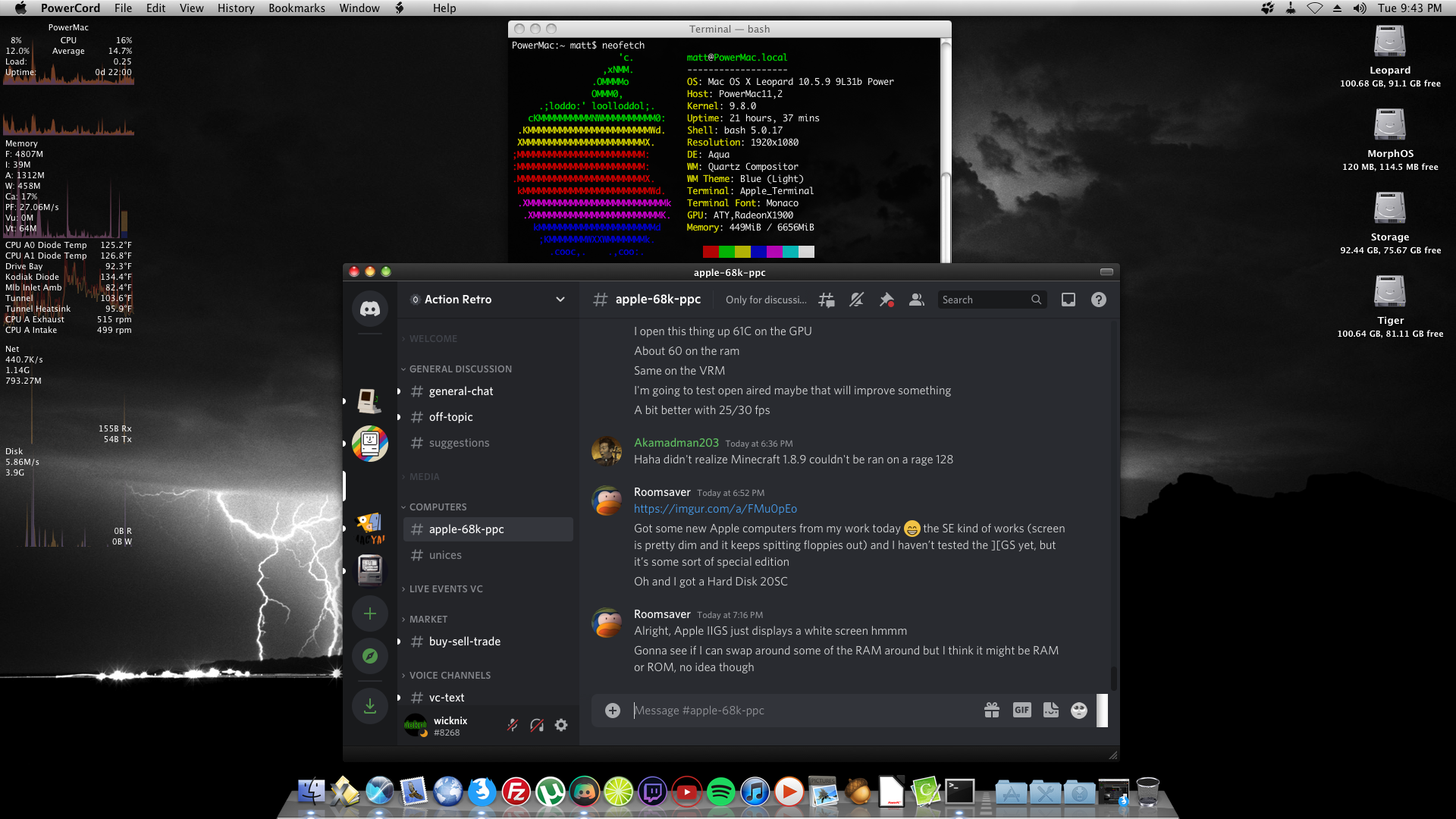

Since i acquired a new to me G5 last week where i replaced the old hard drive, i figured it'd be a good time to try the final release. Works really well, and i like the tweaks/hidden gems. As i did with my ubuntu remixes, i'm sure you had a lot of fun creating this. I think it's a keeper. Good job. 🙂
Please @wicknix , what is that stat stuff displaying on the screen's left side ? Conky for Mac OS X 😛 ?

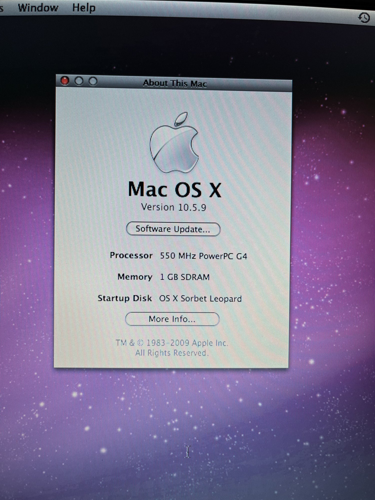

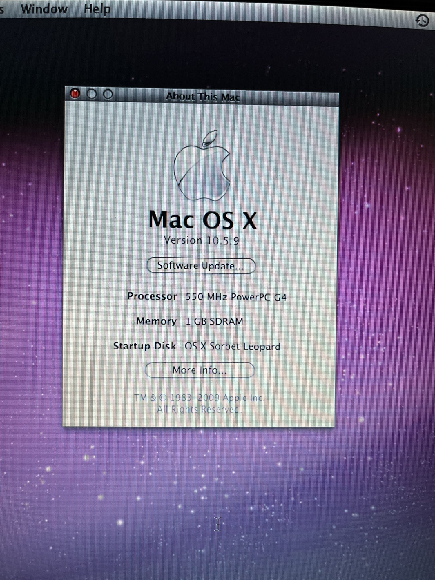

First I want to thank Z970 for this! My G4 550mhz Pismo is running so smooth. It is even handling multitasking better than the original version of Sorbet. Really, this is just unreal.
I’m repairing permissions now.
I have some questions-
1. Should I create a RAM disk and if so, how large? I have 1GB of ram.
2. Is leaving the dock 3D really taking up a lot of resources? I like the look and want to retain it if I can. Does setting it to hide free up resources?
3. I looked through the utility scripts and I don’t see a shadow killer. I thought the original version had that. I could be wrong.
4. What other scripts are recommended for my setup?
What will you use the RAM disk for? OS X just generally loves RAM, and so do web browsers.
The GUI is definitely snappier with the "2D" Dock, and the fact the Pismo's GPU doesn't support Core Image so the CPU has to handle the 3D Dock's effects intensifies the difference.
Reactions: ww2_1943
@ww2_1943 I will append @Amethyst1's answer with the following notes on using RAM disks ...
Typically, you should not create a disk as large as the entire installed capacity. If you fill that with files, the system will end up swapping to disk for everything; and because you control what resides in memory (via the RAM disk), the system can't automatically get rid of it and go back to using its native memory banks.
As a rule of thumb, I would suggest leaving 512 MB to 1 GB free for the rest of the system to use (at minimum), so in your case that would be creating one anywhere from 64 MB to 512 MB in size for most uses. Be aware though that with such a relatively cramped amount of memory to begin with, while you will see certain I/O performance improvements (with files stored on the RAM disk), overall memory performance (for normal RAM tasks) may suffer. All in all, it is really a feature for higher-end G4s and G5s with RAM to spare.
In regards to disabling shadows, Sorbet does not ship with ShadowKiller; rather, it uses a custom implementation provided by @AphoticD in the form of an embedded binary, with a user-accessible switch located at Sorbet Tools > System > Quartz Compositor > Toggle Window Shadows (just as the Sorbet Tips section @ the project's Macintosh Garden page describes).
For more post-install tips, tricks, and tweaks, please see Sorbet Tips at the above link.
