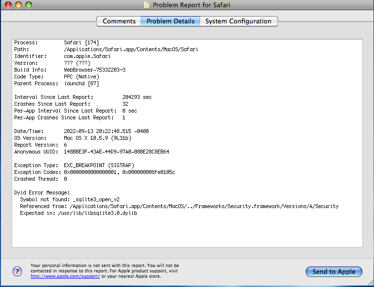

Here is the error info
Thanks. I'm guessing, but it looks like code is missing from the /usr/lib/libsqlite3.0.dylib library, causing 64-bit PPC Geekbench to crash. To check, fire up Applications > Utilities > Terminal, type file /usr/lib/libsqlite3.0.dylib, press [Enter] and paste the output here.
If 64-bit PPC Geekbench works on vanilla Leopard, I'd try replacing Sorbet's version of that library with the one from vanilla Leopard. You may have to do this from another OS X install or in single-user mode.

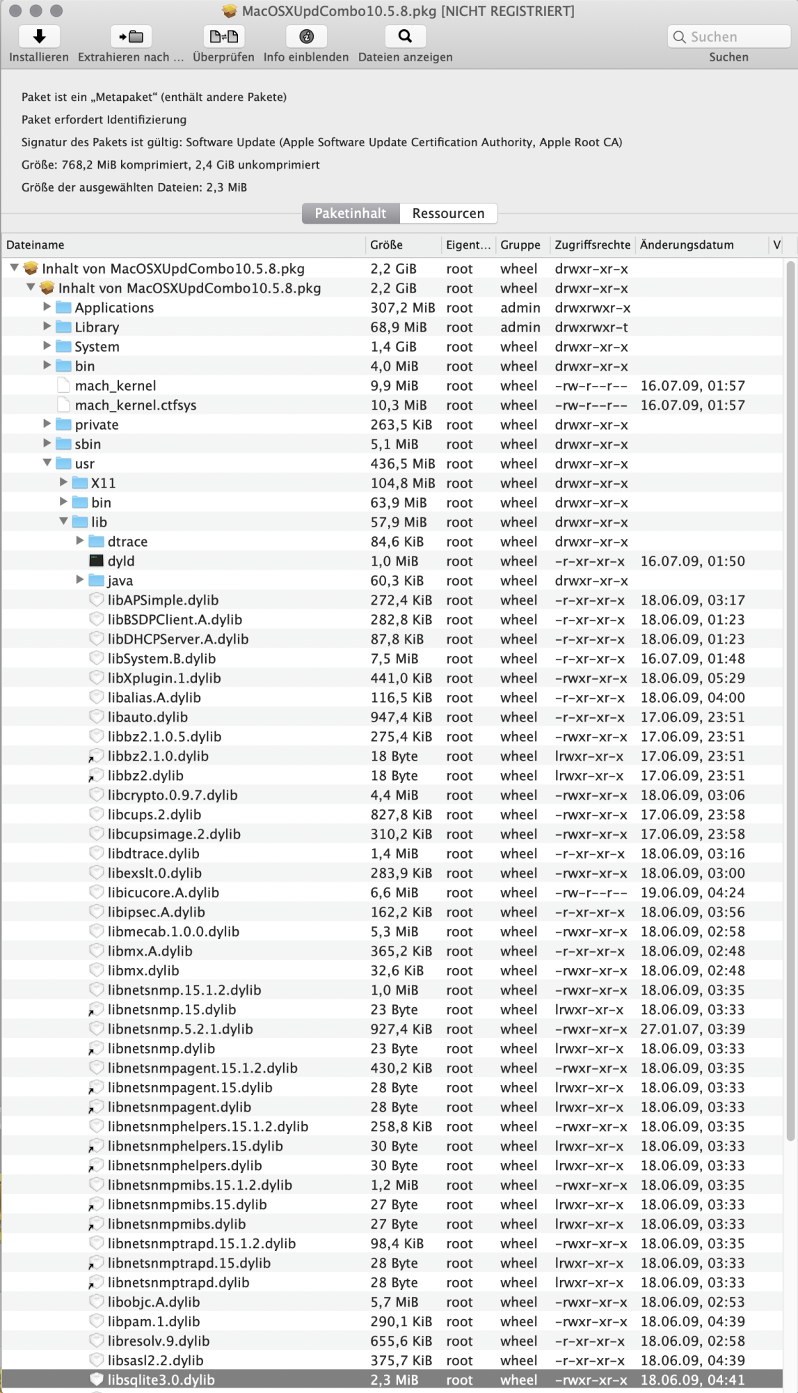

I've just pulled the library out of the 10.5.8 Combo Update... and it looks like I was right:
Code:
libsqlite3.0.dylib (for architecture ppc7400): Mach-O dynamically linked shared library ppc_7400
libsqlite3.0.dylib (for architecture ppc64):   Mach-O dynamically linked shared library ppc64
libsqlite3.0.dylib (for architecture i386):    Mach-O dynamically linked shared library i386
libsqlite3.0.dylib (for architecture x86_64):  Mach-O 64-bit dynamically linked shared library x86_64
Vanilla Leopard's library contains code for 32-bit PPC,64-bit PPC, 32-bit Intel and 64-bit Intel. Sorbet's only contains 32-bit PPC code. So I'm afraid you need to replace Sorbet's version of that library with the original one.

Thank for looking into that. I never used Pacifist- That us what I need to pull this, correct?
Yes. You open the MacOSXUpdCombo10.5.8.pkg package that is in the Combo Update dmg using Pacifist, browse to the /usr/lib/libsqlite3.0.dylib file, select it, click "Extract to..." in the toolbar and select a folder where you want the library to be extracted.

@Amethyst1 You can see here that Leopard's libsqlite has been replaced with another version - that's likely the problem.
Is that what this is referring to?
o Updated Safari with never-before-used security fixes from Safari 12 (replaced csparser.bundle and Security binary with updated versions from October 2018 Security.framework release, plus replaced /usr/lib/libsqlite3.0.dylib with libsqlite3.dylib from WebKit files), stabilizing browser memory usage
Reactions: Amethyst1
I assume so - so may well have the 64bit component but not a compatible one?

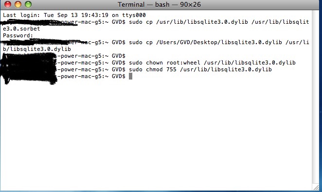

@Amethyst1 I extracted the file using Pacifist. What is the next step to replace the file on Sorbet with this one? I don't know how to use Terminal to replace a file.
1. Fire up Applications > Utilities > Terminal.
2. Back up the current version of the library:
2.1. Type sudo cp /usr/lib/libsqlite3.0.dylib /usr/lib/libsqlite3.0.sorbet
2.2. Press [Enter], enter your password, press [Enter] again.
3. Replace the library:
3.1. Type sudo cp but don't press Enter!
3.2. Press the space bar once, then drag the extracted file into the Terminal window so that its full path appears on the command line. Don't press [Enter] just yet!
3.3. Press the space bar once, then add /usr/lib/libsqlite3.0.dylib to the command.
3.4. The full command should now look something like this, but the path to the extracted library will be different:
sudo cp /Users/john/Desktop/libsqlite3.0.dylib /usr/lib/libsqlite3.0.dylib
3.5. Press [Enter], type your password, press [Enter] again.
4. Fix ownership of the library:
4.1. Type sudo chown root:wheel /usr/lib/libsqlite3.0.dylib
4.2. Press [Enter], type your password, press [Enter] again.
5. Fix permissions of the library:
5.1. Type sudo chmod 755 /usr/lib/libsqlite3.0.dylib
5.2. Press [Enter], type your password, press [Enter] again.
6. Reboot for good measure and hope for the best.

I thought this would happen, changing libsqlite3.0.dylib broke compatibility with Safari in Sorbet. It isn't a huge deal since I mostly use InterWebPCC. Still, it was a pretty decent version of Safari all things considered.
@Dronecatcher @Amethyst1 @z970

Where did this back up to?
The same folder the original file is in. Would you like instructions for restoring Sorbet's version?
I followed the instructions, but it did not ask for a password in the places you indicated it would. Does that mean the commands did not work?
That’s fine. sudo can remember the password for a few minutes after it’s been typed once.
I just followed the steps in post 1067. I assume my answer is no then
The steps only replace the library. They don’t do anything else.

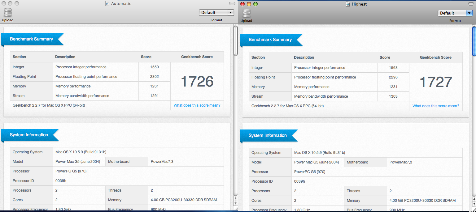

Here are the final Geekbench results. [...]
Those are a whopping 4.4% higher than the 32-bit ones. :D
