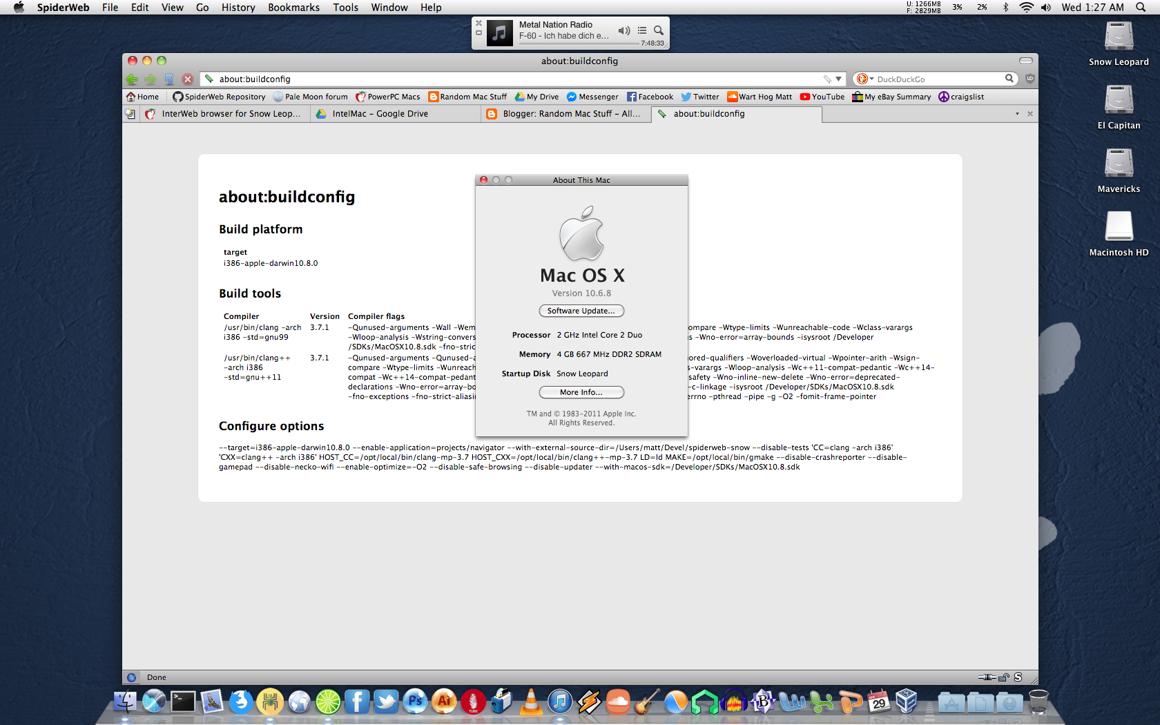

Yes, you read that right. Now, just so you are aware, this is based on Basilisk/Borealis code from early 2018, which was probably it's first or second release after it forked from FF52.9/seamonkey. I had been picking at this on and off since then. So, with that said, it's not the latest and greatest with any security updates or bug fixes since that point in time, but it's modern enough to surf the web pretty hassle free. This will probably be the only release. I rarely use 10.6 these days, and between my other projects and work, time is limited. Anyway, enjoy.
Download here: spiderweb
(I took down InterWeb for 10.6 as it has odd issues on some systems. If you already have it, and it works for you, keep it. I may bring it back if i can fix the quirks.)

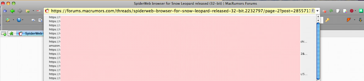

First, the prefill of the location bar for sites I already visited even with Preferences/Location bar/autocomplete features proposed. Nothing autocomplete, did I miss something ?
Then, I would have the links at the left bottom in a popup, but there isn't status bar preferences for that. For now I need to maintain all the status bar displayed to see them. Is there an alternative ?
Now to complete my happyness I'd need two things I can't have like ArcticFox do :
I'm not sure I follow what you mean with your second point, but I agree about the first one. For the moment, small solace, you can click on the arrow to the right of the location bar — although I don't quite understand which URLs get remembered and when:

If you disabled your "history" settings, it will be empty. Make sure these are enabled.

@RobJos For my first point I noticed as you thet the right arrow don't propose what I would, a simple autocomplete choices as AF do.
For my second point I mean when you pass the mouse over a link, I appreciate to read it at the bottom left as a popup without opening the entire status bar.
@wicknix my history is not empty, all the sites I visited are here. I check your box there are default settings I didn't change. Higher in Preferences everithing is enabled but not any autocomplete choice proposed.
2nd point — I think I understand what you mean, but it's not a feature I've got in my installation of AF. Instead, URLs show at the mouse cursor (as native in Firefox, but an add-on in AF, if I remember correctly), so it's possible that your feature got “toggled away” in my setup, a few IT centuries ago.
1st point — same here, Location Bar history checked, but URLs still don't show and there's no autocomplete. Moreover the Clear Location bar button has cleared what I had there, but after that nothing comes back at all — ever since, the right hand down arrow brings up this: “(Nothing Available)”.
On the other hand, @wicknix, checking “Remember visited pages” in the History pref panel now gets the History (window) populated on the fly. When setting up SW I must have checked it off with the understanding that it wouldn't remember them, but only after ending the session.

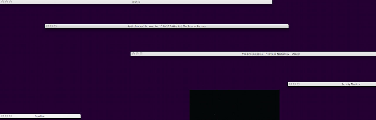

One more thing a little disturbing, SpiderWeb needs to have a tab opened to run. If I close everything, bookmarks don't run, I have to open a new tab first.
I say a little disturbing because this blank tab is always here while switching between opened applications that doen't take all the screen, Finder for example.
@RobJos to get the popup at the bottom left in AF go to Tools/Status Bar Preferences/Links/Show Links in Pop-up
Ah, I had forgotten about this menu's existence. Maybe not just this popup, but some other stuff in there that could be useful. Thanks.
You could try using the WindowShade X CP, for example — one of the many good reasons to stick to 10.6.8. See (background is the Finder, of course):

@RobJos I had to do search about WindowShade X I didn't know ?
Anyway the yellow button of the window can do the job.
For now, SpiderWeb is always open beside ArcticFox that remains my default browser with it's ability to autocomplete links in URL bar.
Made by Unsanity.com, which apparently has gone down the drain — just shows that once SnL is running (I installed WS X in 2010) you don't have to bother about anything else, kinda. You'll read lots of pros and cons in that post — I'm definitely among the pros, and not only for their WS X. The advantage, among other features, is double-clicking anywhere in the bar instead of having to focus on a button. I'd happily mail it to you (5.9Mb), but then where would you get a registration key?

@RobJos Thanks for the idea and the proposition, as the yellow button mask the window in the Dock it's good enough for me.
This way when I switch to SpiderWeb (-Tab for example) the SpiderWeb main menu allows to choose a bookmark or ask something else and the window comes back with the result of the action.
Windowshade X reminds me OS 8 on my former G3 beige ;-)
Confused here. Today I did  + W by accident on the last open blank tab, thus closing the window. Yet, SpiderWeb did not quit.  + T (as well as  + N) brought a new window/blank tab back on the screen. I closed it once again, SpiderWeb remained active.  + B then brought up the Bookmarks (window), as it should. All by itself. In this open window I clicked randomly on a bookmark, which then opened in a new window/tab. For that matter,  + Sft + H also opened the History (window) all by itself, and from there I could also open a new window/tab.
