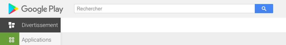

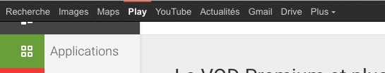

Hi,
I've been using ArcticFox as my default browser for years with InterWeb aside to get bad sites.
I've to switch more often, so I'm trying to use InterWeb only, to see and I found a problem with google pages (I know google is often the guilty with our maintained fox browsers).

But, if I want play.google, I get this with AF
And that with IW, the main black menu bar upside overrides all the play.google menu and impossible to do something like "Search".
For information this is the same with SpiderWeb.
I tried to proceed with about:config and modified the useragent values, including "general.useragent.override.google.com" the same that in AF ( without any effect.
Any idea to progress ?
Thanks for your help.

The play.google page is not a big deal as AF do the job. I'm just a little surprise about the way SW and IW manage that page.

Odd that it displays correctly in AF though which is an older code base than SW and IW.
My assumption would be that AF lacks some feature which causes the Google Play website to use a polyfill or at least a different code path. On IW it uses the newer feature but it doesn't work quite right for whatever reason.
