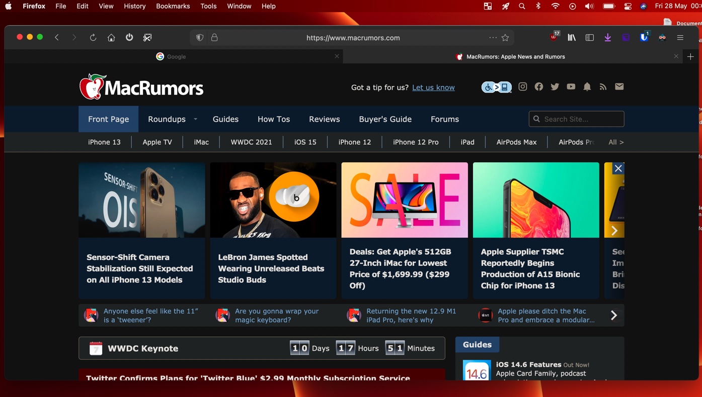

Welcome to the ‘stopped using Safari’ club ;).
If I kept using Safari to this day ever since I noticed heavy SSD writes some time in December, I’d probably be on atleast 400TB written and counting. But I was lucky enough to notice the issue quite early and I switched from Safari to any other browser, and it’s honestly the biggest reason why my SSD wrote 23.1TB between November 26th and December 30th, and now since then it’s only written 2TB in 6 months and as of now I’m on 25.1 TB.
I think if you take any steps needed to circumvent the issue on your part now, you’d still have a macbook that would last for a very long time. E.g. if you were to write ~4TB a year like I do now, or even something larger like 20TB a year, then your mac would likely still last for more than 24 years, and maybe even 50+ years (these SSDs seem to be rated at around 1400TBW according to the percentage used value).
Currently I use Firefox with a few tweaks and modifications, which I’ve even managed to make look like Safari - I browse with 100s+ of tabs all the time with no issues as a computer science student.
I highly recommend it, and if you want I can point you to useful tweaks and modifications that reduce swap writes even further. Other good browser choices that I know of are Brave, Edge and Vivaldi.
It’s not too late!
