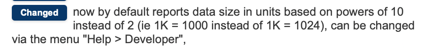

Someone else has pointed out that 16.1 TB (Terabytes) is close to 14.7 TiB (Tebibytes) so maybe DriveDx should be reporting 14.7 TiB.
TB to TiB conversion
Todays update to DriveDx corrects this.....without admitting that they have been incorrectly reporting TiB but labelling it TB.

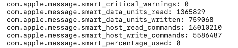

I might be missing something here but is there a way to work out GB written from the statistics here? There is a number given for the data units written, but what does this mean?
