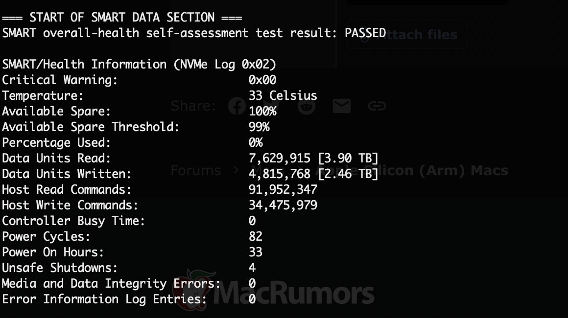

I got my Air a few weeks ago, and using every day between 8-10h this is how it looks like. It's a base model
I use this device for everything besides gaming.

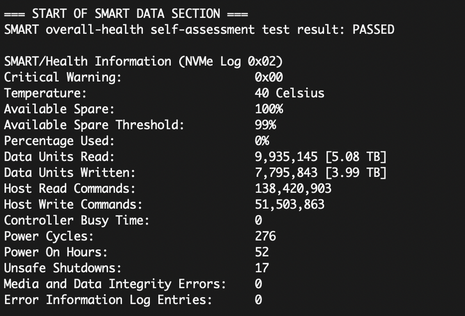

I picked up a refurb 8GB MBP that's being used very heavily for development. I went with the 8GB just as a trial to see if it could work with the intent of upgrading to a 16GB when the 16" models come out, but this disk use is a little scary.
After 10 days I'm at close to 4TB and 276 power cycles. Some of these must have been already logged by the previous life of the machine, but I saw the data units written go up by .01TB in the 20 minutes I was reading this thread.

Did you check this before you did anything? How much of that 4 TB was already there?
The worst case we have is a 518 GB drive going bye bye at the 600 TB mark and there are serious questions about those numbers (they don't jive with others reporting their usage) and the M1 Mac was used in something that is write happy.
The key number is not how much is written on its own but also Percentage used. A 0% means at worst only 0.49999.% of the SSD's rated lifetime capacity has been used. This gives us at worst 800 TBW before it hits 100% (and most SSDs even in 2014 went way past that number)
If 10 days gets 4 TB than it should take 2,000 days (800/4*10) to hit the 100% mark. That is ~5.48 years - more than enough time to get an external or replace the machine. And this is the worst case. May people are coming up with 1000+ TB for their drives.

I do believe that I was responsible for most of that 4TB in 10 days. Every time I clear my database cache while developing it goes up a small, but notable amount. On the one day when I didn't do much work and just browsed websites, the disk writes only nudged upward a little.
I'm getting my 2018 MBP back from service tomorrow. The first thing I'm doing is checking to see how much mileage I put on it in its 2+ years of very heavy daily use as a development and photo editing battlestation. I have a lot more RAM in that 2018 unit, but I'm going to guess that the SSD is still going to show some hard mileage.

I don't understand this "options to service" mentality. As I mentioned before based on the numbers you gave us and using the worse case situation you were looking at 5 years before the drive hit 100% and the 2014 test shows odds are the SSD would go way past that point. External SSDs are cheap and small enough that in most cases the "dongle" argument is moot.
As for the battery that is a little more on the usage side - what the expected usable lifespan of the machine going to be? If it is substantially north of 2 years yes that is an issue provided having an outlet nearby is not an option.
I was floating around 20G/hr in writes. On a 500GB drive, I guess that should amount to 5-7 years, but that wasn't anywhere near my worst case scenario. That was me working pretty leisurely for a week without pressure.
So yeah, I know that before the SSD is likely to fail, I'm likely to have moved on to another computer, but the excessive writes were a clear sign to me that my 8GB experiment wasn't going as well as I had hoped.
I'm not obsessed with having a pristine machine. I'm obsessed with avoiding the possibility that my computer is going to act up on me when I can least afford it.

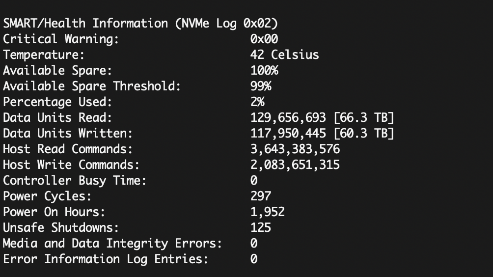

Ok, here's my disk write data on my 2018 MBP with 32GB RAM for comparison. To recap, I've been test driving an 8GB M1 MBP while my 2018 MBP was getting battery service. I intentionally got the 8GB model just because I wanted to see if I could drive my workload on an "under resourced" machine. Even on only 8GB, it did quite admirably, but I was racking up very heavy disk writes that weren't attributed to the bug that was fixed in OS X 11.4.
So here's what my disk stats look like for my 2018 that I've been using for almost 30 months. It's at 60TB of writes.
In comparison, here's what my 8GB M1 MBP looked like after 9 days. It's at 4TB of writes.
Either the kind of things I do is just going to be like this on M1's or skimping on the RAM really puts a surprisingly heavy burden on the SSD.

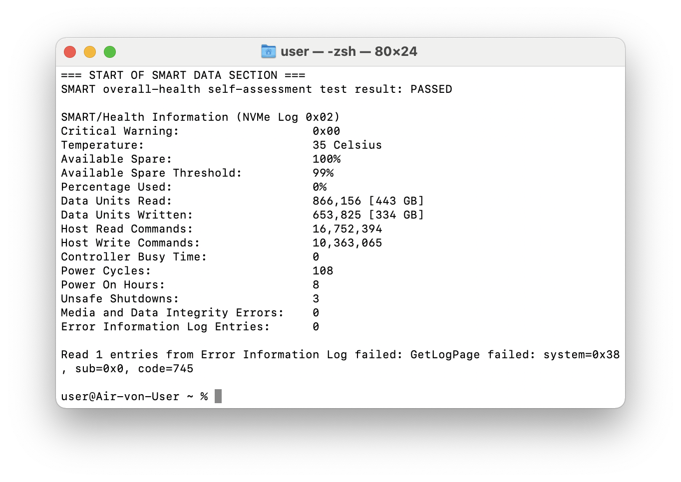

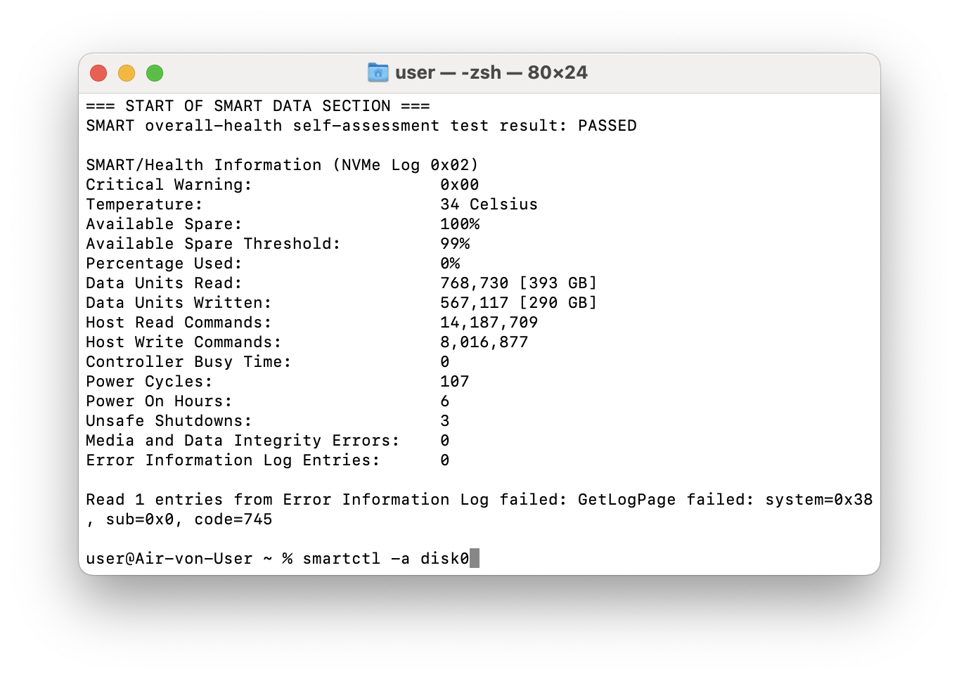

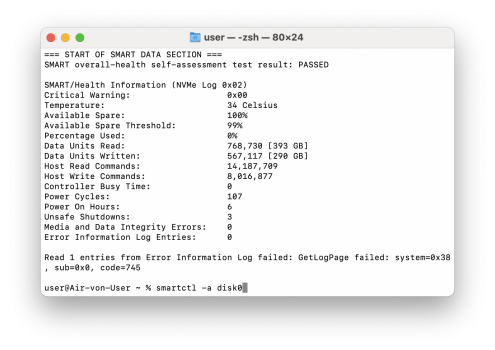

My results after few days of regular usage(Home Office, browsing, YouTube, streaming movies, light photo editing), when all initial setups/updates/installations are done.
29.06 / 09:00 AM
Read: 393GB
Written: 290GB
30.06 / 01:00 AM
Read: 429GB
Written: 320GB
01.07 / 01:00 AM
Read: 443GB
Written: 334GB
I'm totally fine with it 👍

But yet you still don't know if these 3.99 TB are a result of your working week for sure. You mentioned that this Mac was a refurbished one, right? So most of these 3.99 TB could have been written by the previous owner.
I beg your pardon but, again, I think you need to work for another week and then compare...
It’s possible, but not likely because what led me to my conclusion was that I racked up .6TB over the course of 12 hours. At that point the question of how much of the writes came preloaded was no longer relevant to me. I was on pace to hit 1TB a day and I hadn’t been doing my most resource intensive work.

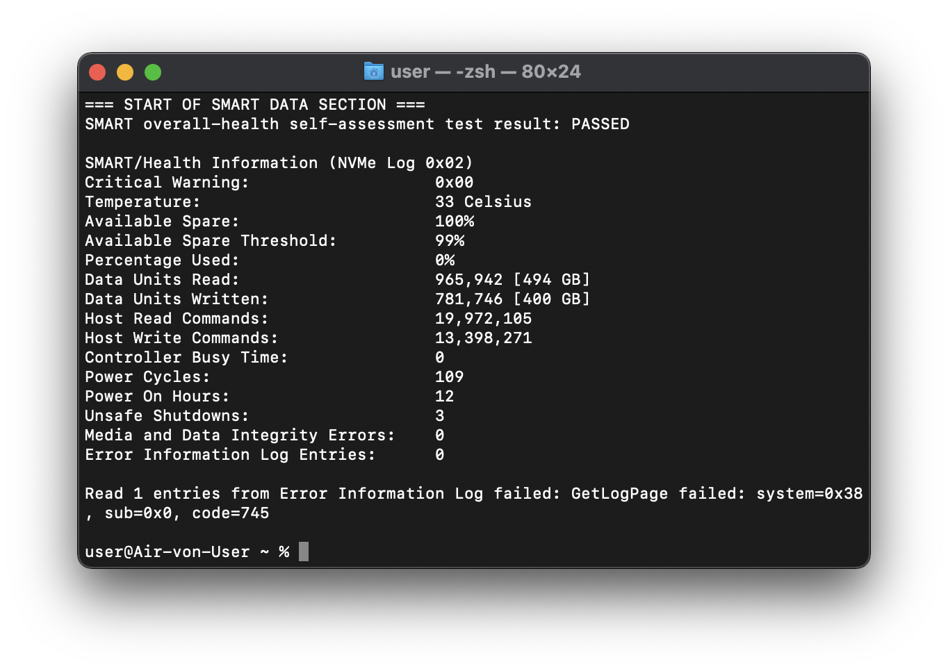

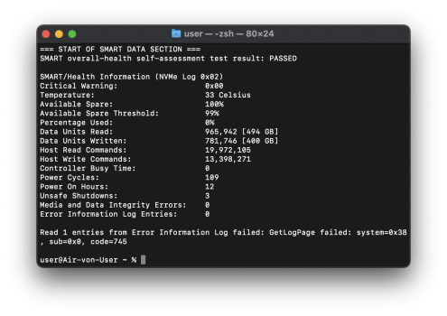

And small updated after another 3 days
04.07 / 0:25 AM
Read: 494GB
Written: 400GB
It is 101GB read and 110GB written in 5 day with my regular usage.
PS
I just find out, what different video players have drastically different approach on caching while streaming.
For example Movist player caching everything on SSD and it can be pretty intense if you for example often stream heavy BDRemux files 50-70GB each.
Meanwhile VLC and IINA players consume more RAM, but without huge cache on SSD.
