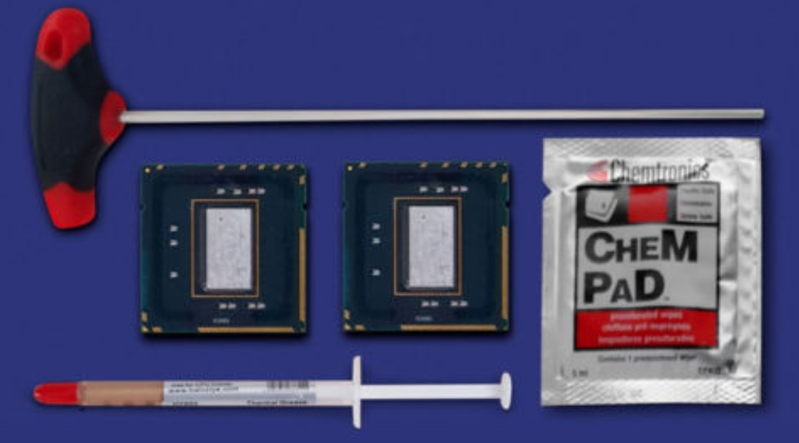

Did you order a complete kit with the processors? In that case you are all set, just follow the instructions carefully if you haven't done these before. I've done about 5 of them recently, with almost 20 still to go (for a school), and it's not difficult or tricky, but you do have to be careful. Drop one of the chips into a socket accidentally? That could easily kill your system. So go slow, use care, and you'll be fine. I see you've already updated the firmware to the 5,1 firmware, so that's great. Oh, and last thing: If you haven't installed processors before do follow the instructions regarding the thermal paste (or whatever solution your kit come with - the most common is a paste), and don't use too much! Look up some YouTube videos if you want. Oh, and a second last thing: Your kit may have delidded chips, or it might have "normal" chips with the lids still on them. If it is the second option, then you also go through a process of modifying the power-connectors for the fans in the heat sinks and then installing washers so you can get the heat sinks to seat properly. And a third last thing: Don't forget to replace the thermal strips too. Hopefully you got a kit with all that stuff.
A clean install is certainly not a bad idea, but as long as the computer is running well, then a clean install probably isn't actually necessary. The MacOS is still better than Windows at some things, and long-term stability is one of them.
yes it's a complete kit , two processor without lid IHS I hope it's the same model !!!!

There are thermal strips on the bottom of the heat-sink assemblies (along one edge, not on the copper section). They can be in pretty bad shape when you take everything apart - many of mine have been getting kind of oil and gummy - like the material is starting to break down. It's not a bad idea to change them out. But if they look fine then don't worry about it! You *have* to change them if you go with the lidded-chip solution, which you didn't, because you have to have thicker ones for that application.
