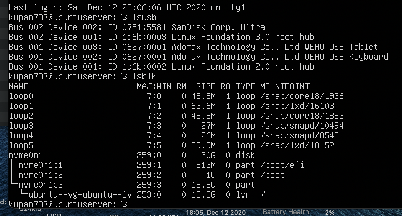

USB pass through - The linux guest will show the device in lsusb, but not in lsblk, and I can't seem to figure out how to get it to show up.
On Mac:
Code:
macbookair:~ kupan787$ lsusb
Bus 000 Device 002: ID 0781:5581 SanDisk Corporation Ultra  Serial: 4C530001021027120270
Bus 000 Device 000: ID 0781:5581 SanDisk Corporation USB 3.1 Bus
Then to pass it through I am doing:
-device usb-host,vendorid=0x0781,productid=0x5581
On Linux I see:
So it seems that the VM is seeing the USB device, and recognizing it as the SanDisk that I have connected. Interestingly, on my Mac desktop, the USB disk disappears for a second but then reappears.
Did you "unmount" the drive in MacOS first? (not Eject)
