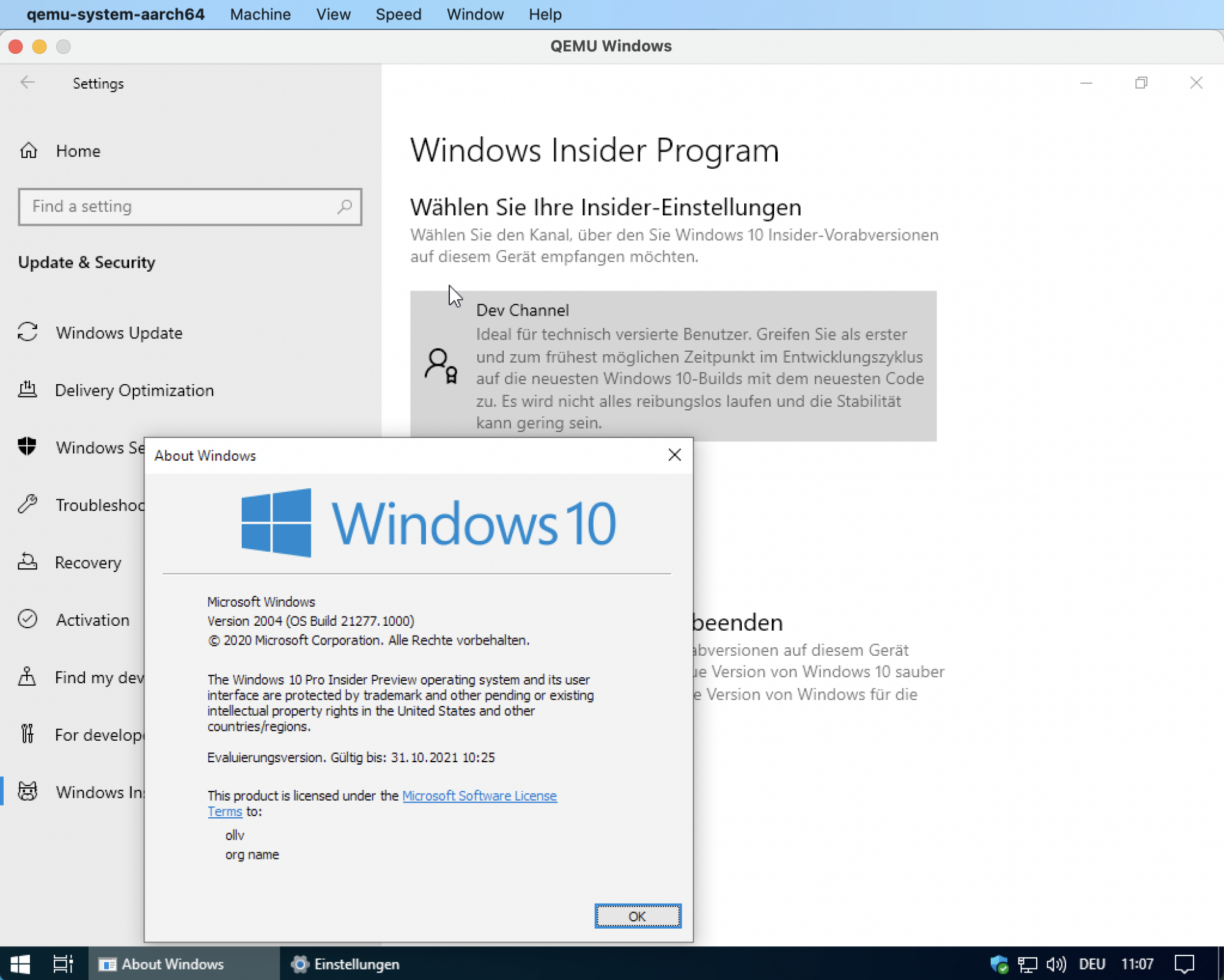

I could add my Windows VM to dev channel and install the version 21277 afterwards and even install German language pack with a lot of reboots without any corruption again:

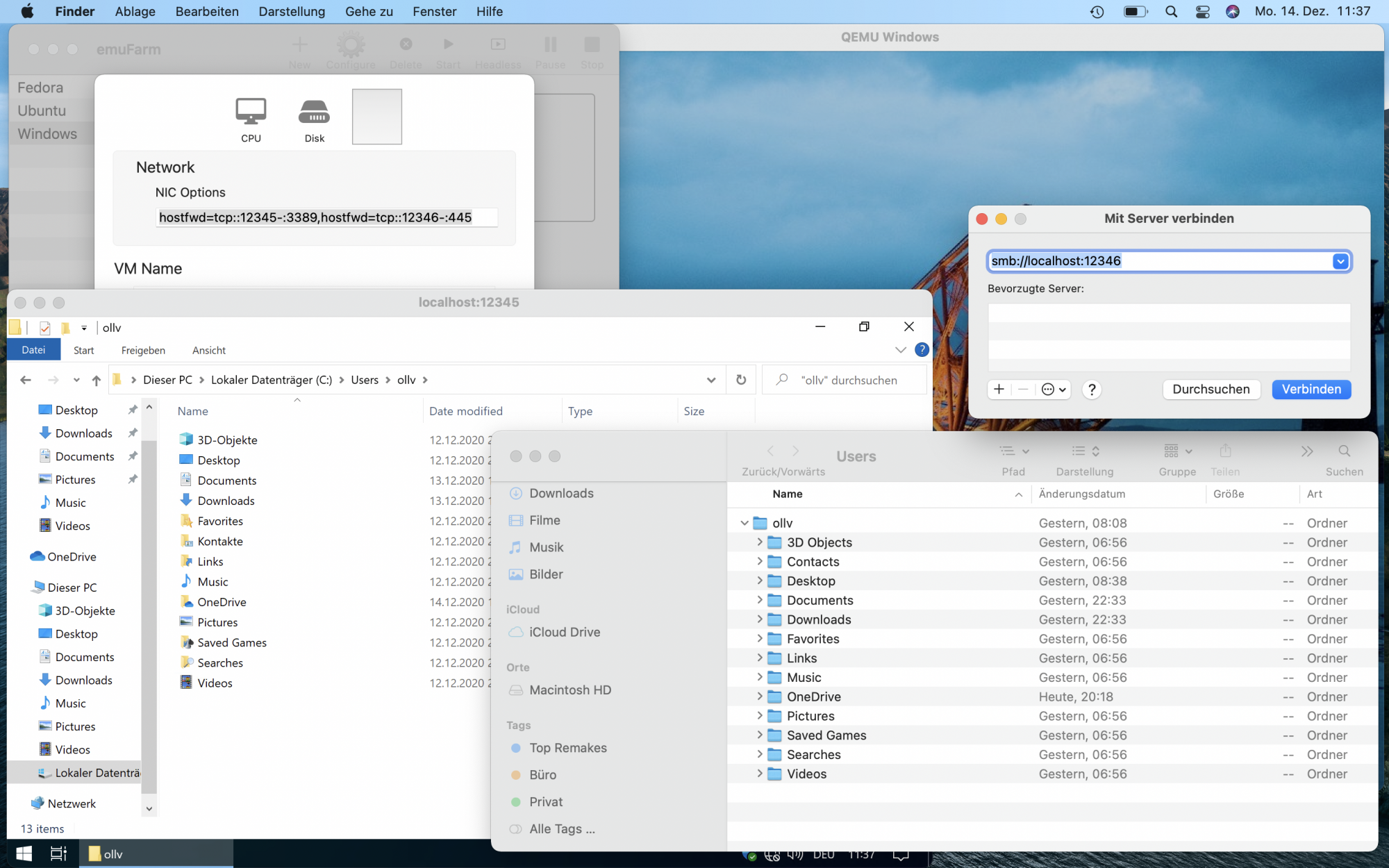

Seems logical. I tried it but cannot connect:
- RD enabled in Windows. Windows network is working.
- added hostfwd=tcp::12345-:3389 to NIC options
- rebooted
- In RD localhost:12345 is not connecting, neither is 127.0.0.1
- Firewall is off
Any ideas?

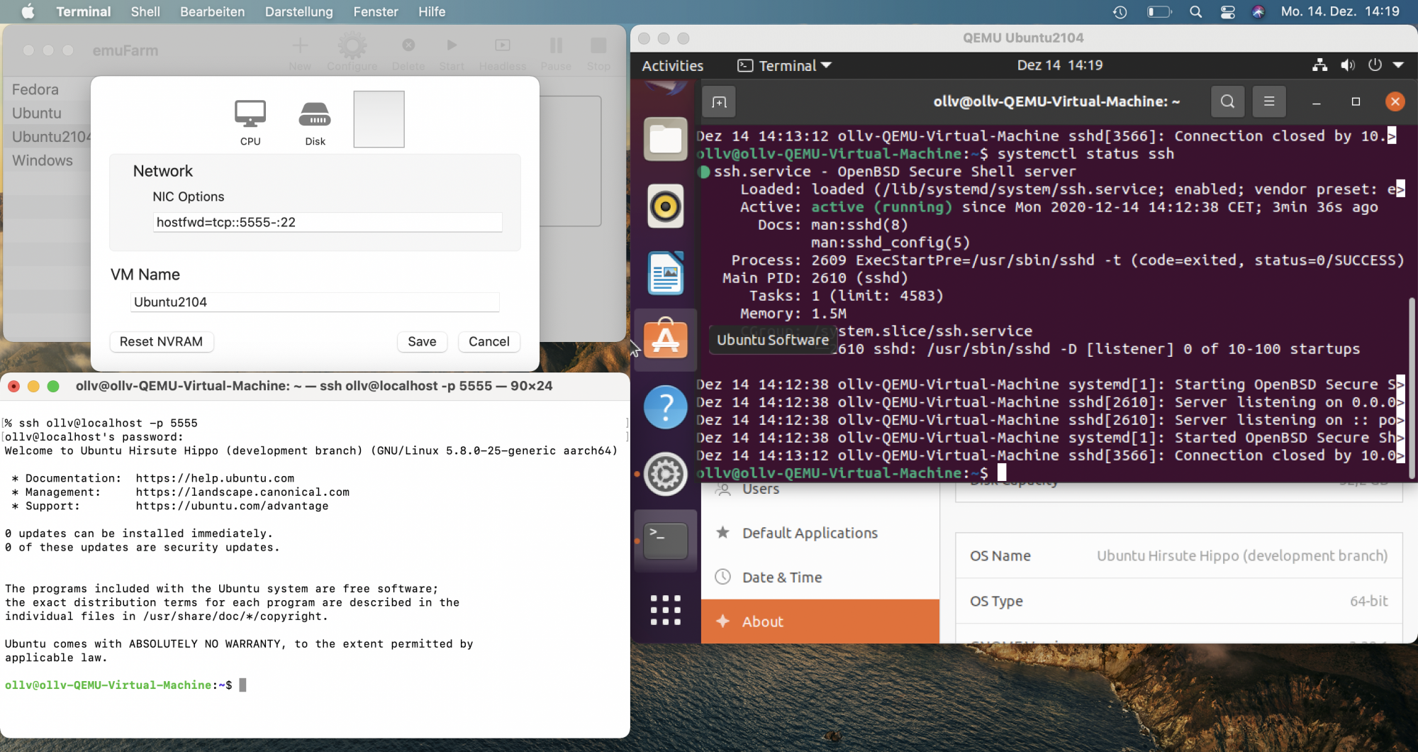

No idea, I could also open the SMB connection after adding the SMB port to "NIC Options":
hostfwd=tcp::12345-:3389,hostfwd=tcp::12346-:445
You will find the forwarding example for ssh in the QEMU documentation:
under "Network HOWTOs" - "How to get SSH access to a guest" you will find the infos for SSH access. They use option "hostfwd=tcp::5555-:22" for SSH access and you should connect via "ssh localhost -p 5555".
Because of port forwarding you should be able to connect to "localhost" not the IP address of the VM.
Edit: I have tested SSH access to a Ubuntu 21.04 desktop VM now, you can connect to linux with the given QEMU documentation via "ssh localhost -p 5555":

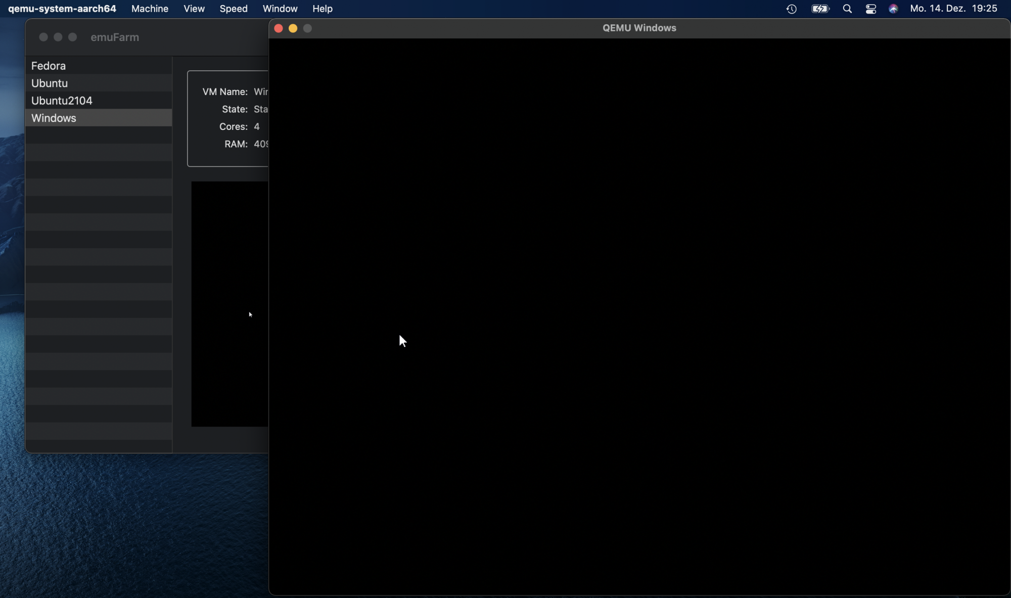

Could someone, please, explain why virtio-gpu option cannot be used to launch W10 (black screen).
P.S. Any chances of using HiDPI directly?
There is no build in driver for virtio-gpu in Windows. The same applies to the NIC, that's why you have to install the NIC driver with virtio-win-0.1.190.iso. I don't know if there is a Windows driver for virtio-gpu available.

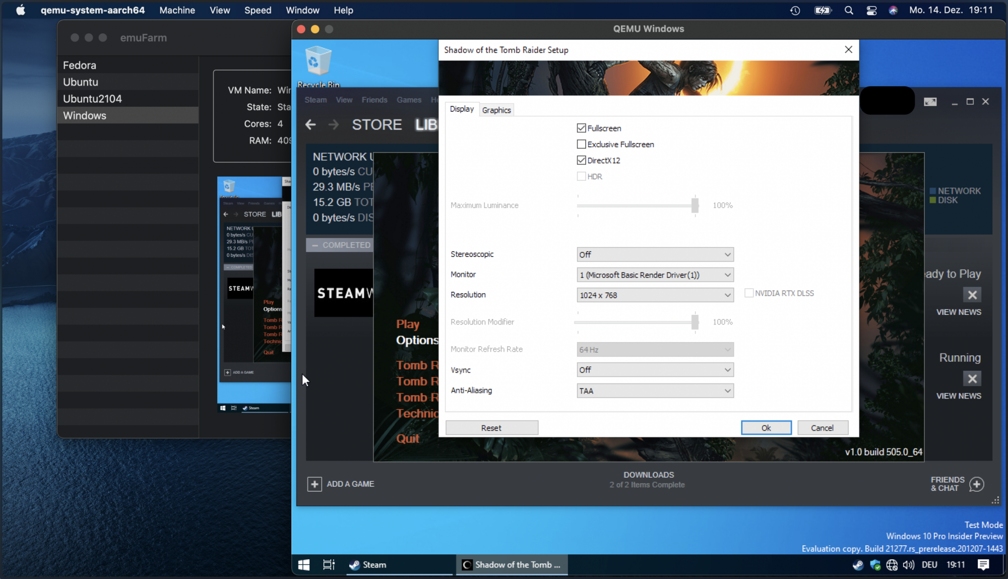

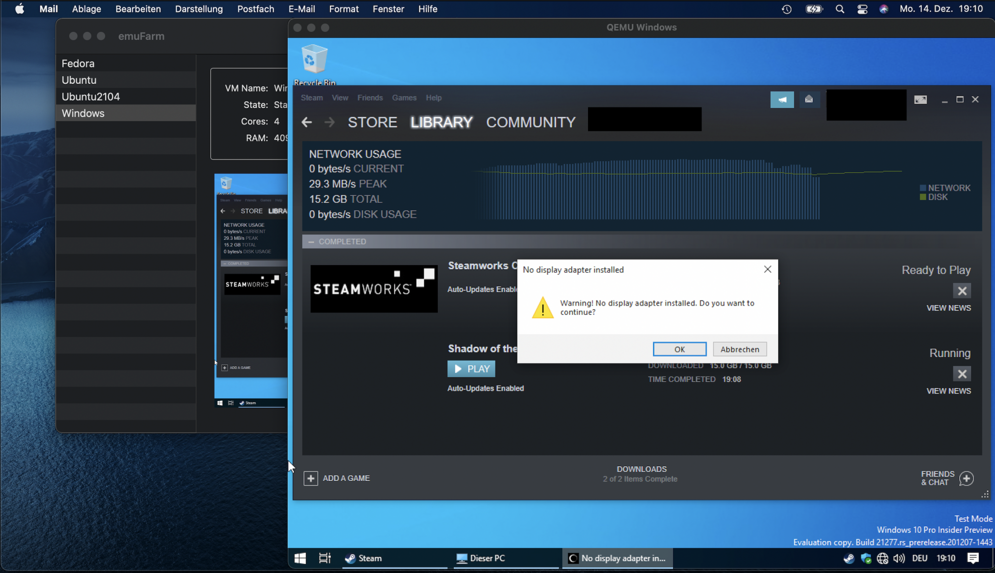

I have converted VHDX into qcow2 with your command. Installed the netkvm drivers, internet is working. But whenever I click on "Get Started" inside Windows Insider Program I get the error "Something went wrong".
The existing windows defender and cumulative updates are also stuck at 0%.
Can you try some games to see how well it runs? Will it run better than crossover?
I don't think that you will have success with playing games on the QEMU Windows VM. I was curious and tried to install Steam and I was able to install Steam and a demo of Shadow of the Tomb Raider but Tomb Raider only starts with a black screen and then crashes. And there is only support for a resolution of 1024x768 as far as I know or you will have to use RDP.
There is no DirectX driver/support at the moment...

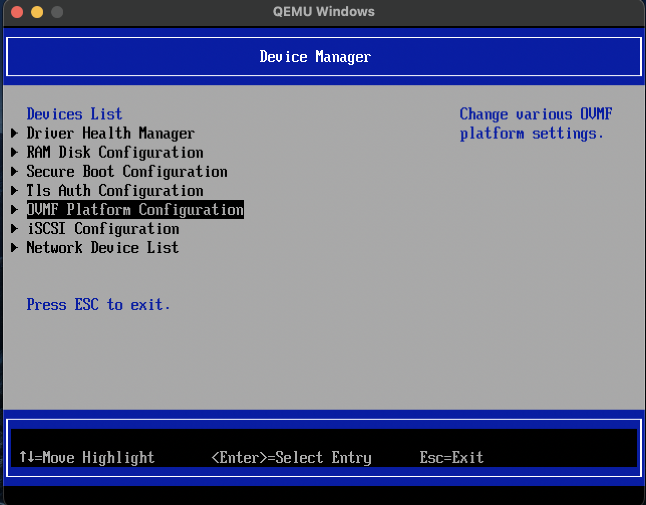

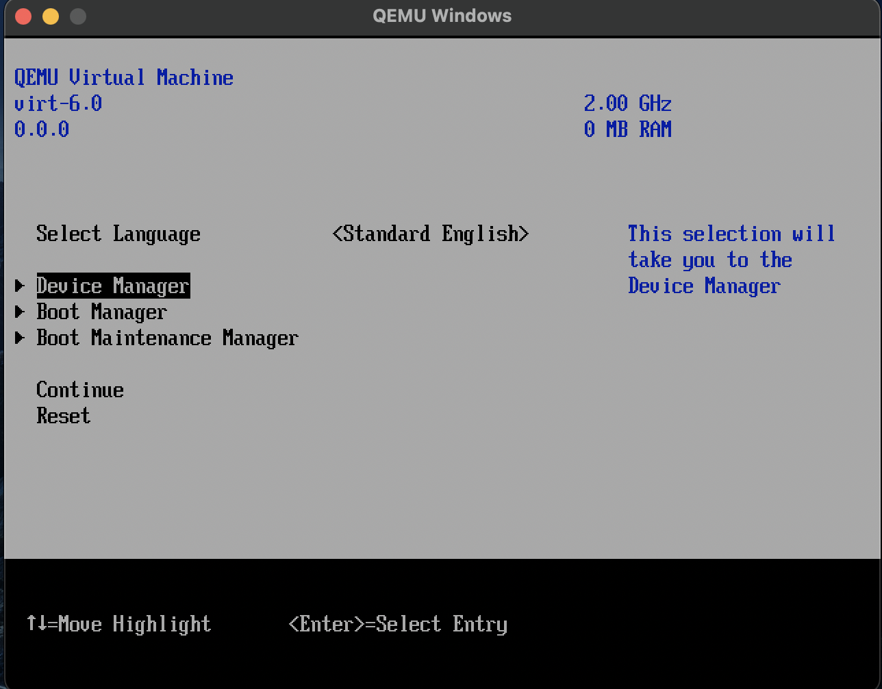

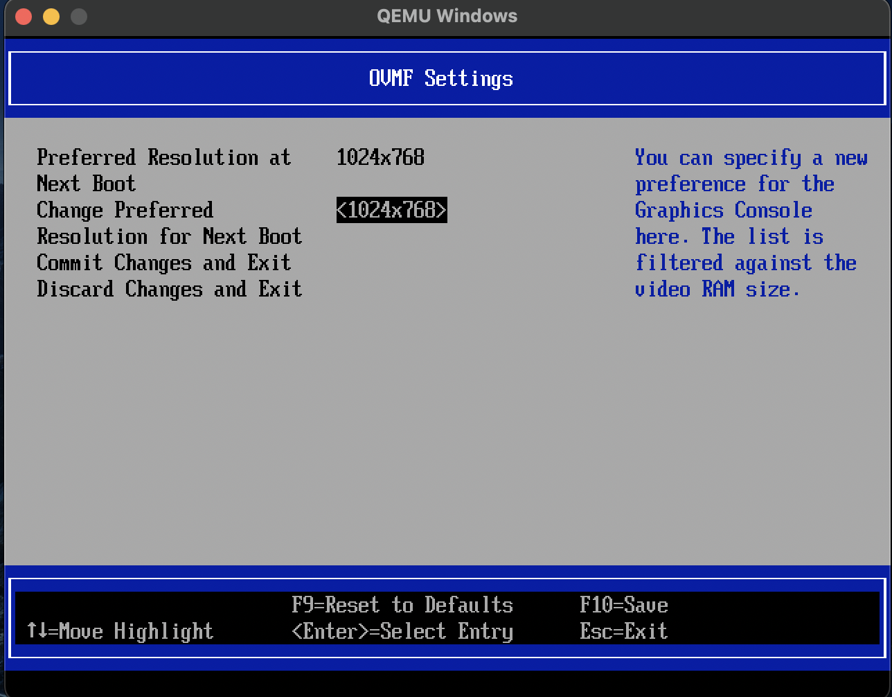

You will have to press ESC key at startup to get into BIOS/UEFI menu, there you can change the resolution:
Select "Device Manager":
Select OVMF Platform Configuration:
Maximum resolution is 1024x768, you will have to press F10 to save:
You can select "Continue" in the first menu to boot into Windows and you will have to reboot the VM a second time to get the higher resolution active.
