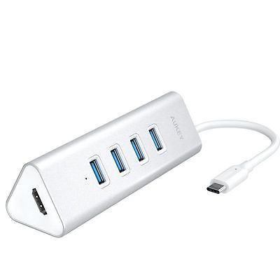

For info I just got below USB-C hub :
And I get tons of disconnected HDD events for no reason.
Plugged one on my disk on a simple USB C to A dongle, no disconnect for now
Probably comes from this hub...

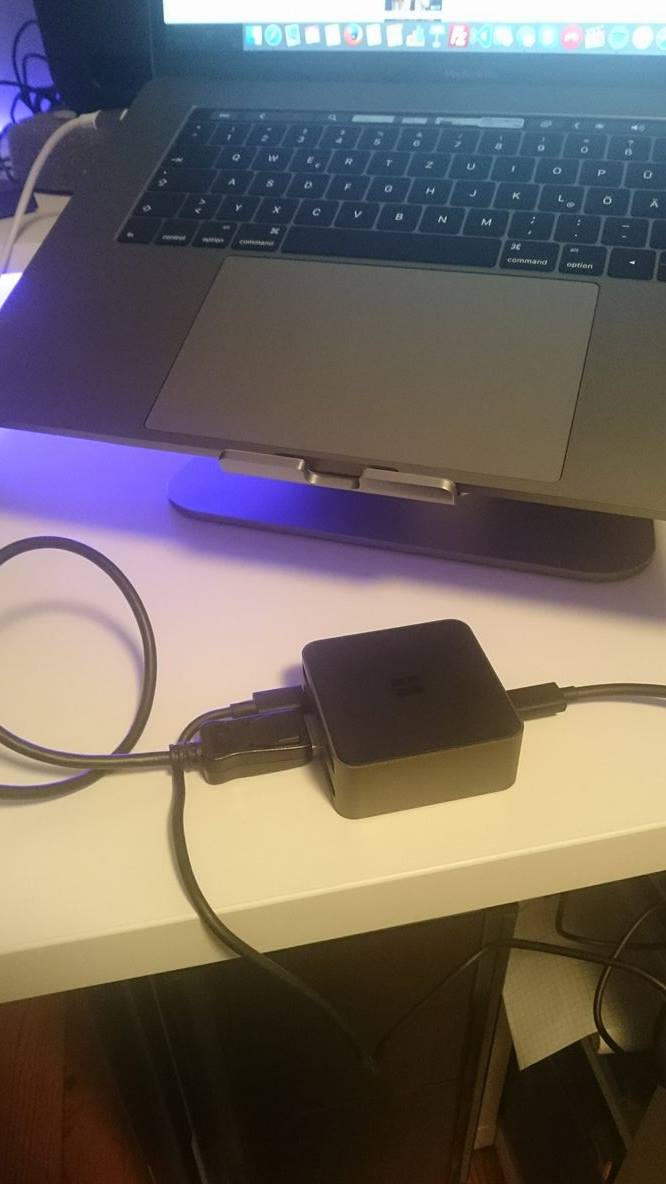

So hello there,
I didn't wanted to start a fresh thread on this but I ran in some Problems.
So the goal over here is to build a minimal Setup.
I read about the Microsoft Lumia Dock, which can charge the Macbook trough a single cable.
Also there are 3xUSB Ports, 1xDisplayport and 1xHDMI Port.
It's almost the perfect dock, but for some reason I can't get a image out of it. Doesn't matter if Dp or HDMI, there is no Signal coming through.
Some other people in the internet claims that it works fine for them.
Can someone help me out with it?
Thanks

So hello there,
Thanks
Wow, too bad it does not work :( , would be perfect for me
Note : regarding the above USB C hub, I didn't manage to drive a 4k display(LG 27ud88) at 4K with the hdmi either (didn't try for very long, so using USB C cable provided with the display to the MBP)
Maybe it will work and I'm just to dumb for it :confused::D
I really need a Display Dock like this soon. I have to connect 2 Displays and I wanna charge the Macbook as well through 1 cable.:rolleyes:o_O

I wish there was the same hub as Aukey's with a "USB-C out" plug instead of the short cable sticking out of it.
