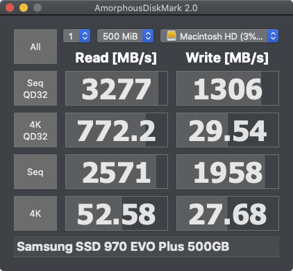

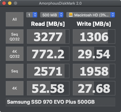

The EVO Plus results are definitely not spectacular on the Write side, I should've purchased the Pro. Can anyone post the AmorphousDiskMark results with their Pro? Here are mines, I hope the Writes are as bad for Pro also.
You should check the EVO Plus FIRMWARE REVISION in "About This Mac / NVME
It SHOULD be 2B2QEXM7.
If you see 1B2QEXM7 then you will probably have problems with the blade in the future.

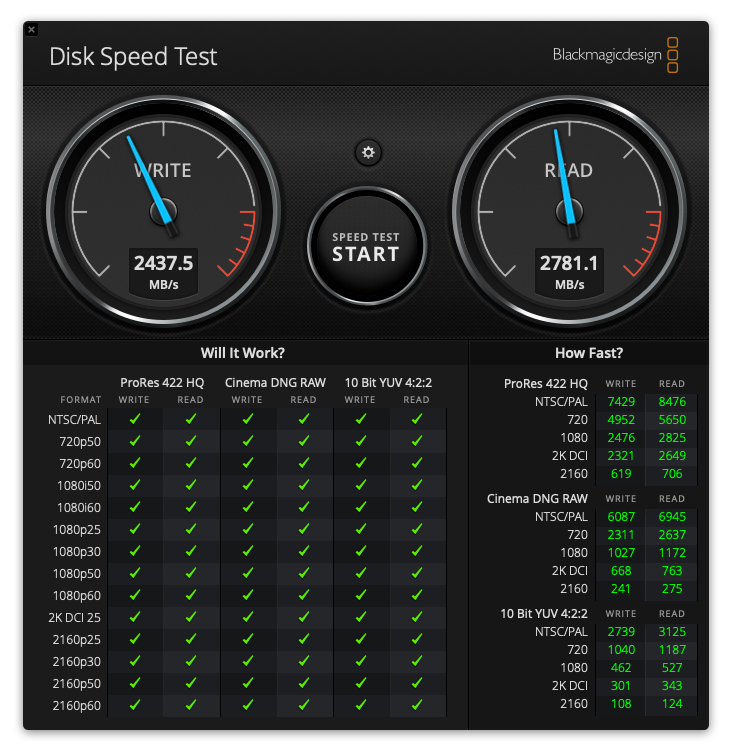

The main differences in the Samsung 970 EVO - 970 EVO Plus - 970 Pro range is CACHE and how speed drops as CACHE fills. The blade size is also a factor speed-wise. 250gb blade will read/write slower than for example a 1TB blade.
The 970 PRO is the definite winner, just keeps on going but the 970 EVO Plus comes close as it has been optimised.
My 500gb 970 EVO Plus in slot PCIe 2
Formatted as HFS+ with Mojave 10.14.6 Build 18G2022​

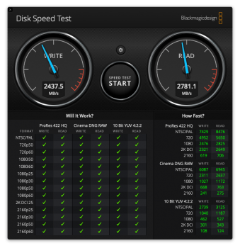

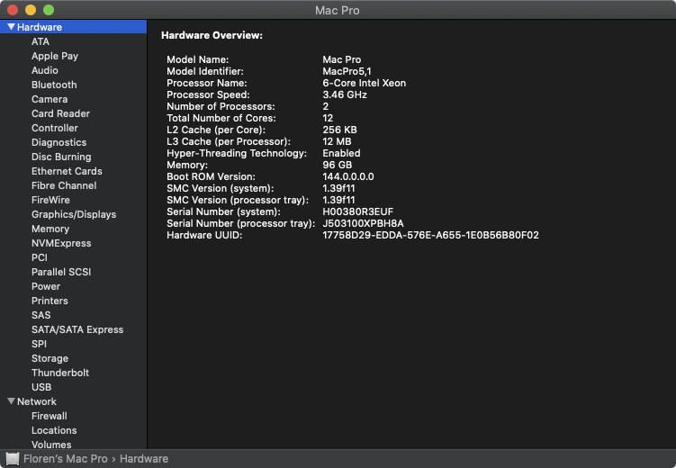

Is a 5,1, what do you mean real.
a 4,1 flashed to 5.1 > SMC 1.39f5
or a real 5.1 > SMC 1.39f11
you can see this in the system profiler
i ask because it occurred to me that in a 4.1
less space above the CPU tray than in a real 5.1
but I still can't see why that is the case
Is a real 5,1, now I understand your question @IndioX. 😅

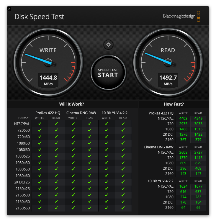

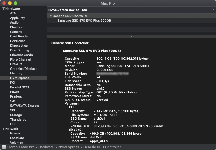

Thanks for the tip, I did not know I can check the NVME firmware there, I believe it even shows into above screenshot. My drive has the manufacturing date of 2019/11/28. I believe the new firmware was released on September 2018, so all new drives should be loaded with it? That is why I did not bother performing the check. I read about it, but I believe the kernel panic is related to several brands, not just Samsung.

Click NVMEexpress to see your 970 EVO Plus firmware / revision.
Although the latest firmware has been released, that doesn't mean that it was installed to the batch of 970 EVO Plus blades in which your blade was shipped to the seller from which you purchased yours.
I bought my " NEW " 970 EVO Plus LAST WEEK ( Jan 16th. 2020 ) . .the firmware was the original problematic release version = 1B2QEXM7.
NOW . . . . it is 2B2QEXM7.
I highly doubt that 970 EVO Plus sellers check the firmware revisions.

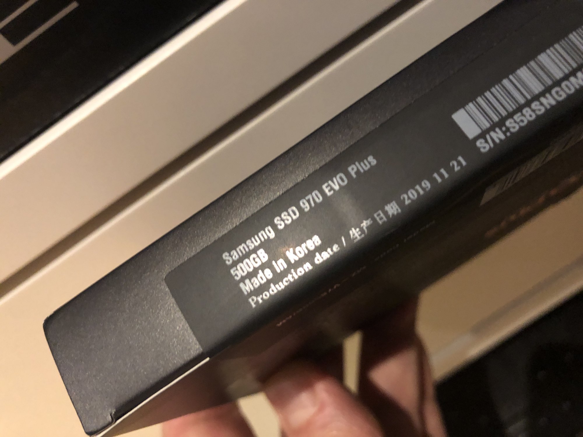

2019 June 6th.
EDITED : It had the OLD ( problomatic ) firmware 1B2QEXM7
Kind of proves my point, doesn't it.
What is the Firmware revision on your blade ?

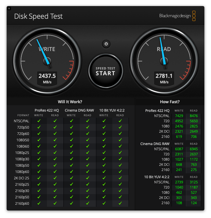

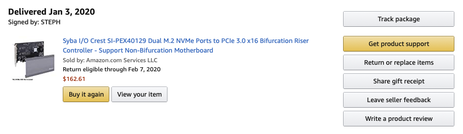

Alibaba is selling the Syba for around US$150 last time I looked and about US$209 on Amazon.
I paid mines $162.61 shipped to my door, on Amazon. You can find sometimes decent prices on Amazon, that is why I purchased mines recently along with the 970 EVO Plus. I like that it adds bifurcation support into a non-bifurcation motherboard.
TECK
Nice to know your 970 EVO Plus is up to date.

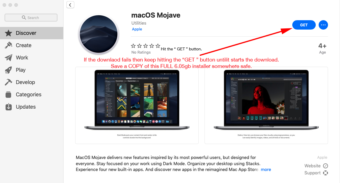

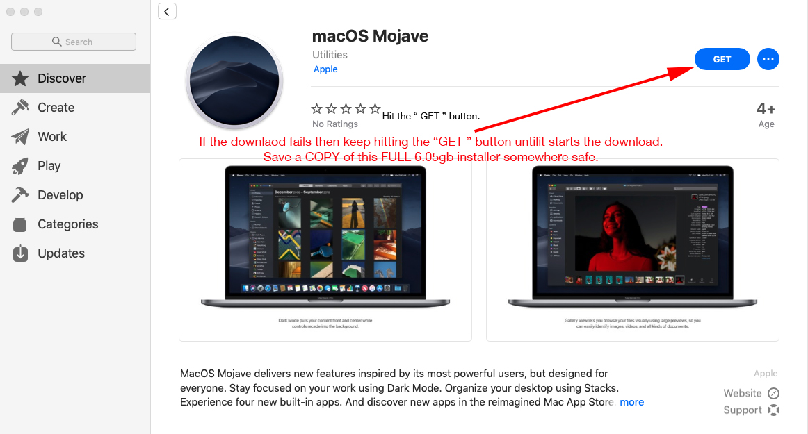

Perhaps you need to re-install Mojave to a spare drive formatted to APFS.
if you have another Mac OS such as High Sierra or El Capitan or on a spare ssd/hdd or a MacBook Pro or MacBook you can use the download link below to download Mojave via the App Store and then
You can download the FULL Mojave 10.14.6 installer here in the App store HERE
Doing this FULL 6.05 gb Mojave 10.14.6 install is the best possible way to install.
Don't do any COMBO installs.

1. Mojave can ONLY be initially installed to an APFS formatted volume.
2. Unfortunately, re-installing ALL of your usually used programs is the best way to end up with a
trouble-free installation.
3. Create a folder on a spare SSD/HDD to save the FULL 6.05 gb Mojave 10.14.6 installer.
Mojave FULL 6.05 installation + Security Update
Create an APFS BACKUP drive.​
4.
https://apps.apple.com/us/app/macos-mojave/id1398502828?mt=12
I would recommend doing the first install to a spare APFS volume ( non-ssd drives can be
formatted to APFS but will be slower that's all
4.1 Then download and install the latest 18G3020 build Security Upgrade Build to this drive -
this drive can be your new Mojave APFS backup.
4.2 Apple Mojave Security Updates can ONLY be installed to an APFS formatted Mojave installation.
5. Install your usual programs to the above drive & test the install.
6. Now you can CCC clone this APSF Mojave ( build 10G3020 ) BACKUP drive to your Samsung M.2 blade.
the CLONE can be formatted to either HFS+ or APFS ( I use HFS+ for my 970 EVO Plus - works well. )
Now you should have a working M.2 blade with Mojave, you should use either TIME Mmachine or . .. much better buy Carbon Copy Cloner and set to to back up your Samsung to the above BACKUP drive once a week or whatever suits you.
DONE
