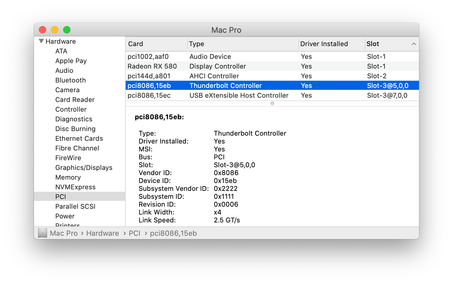

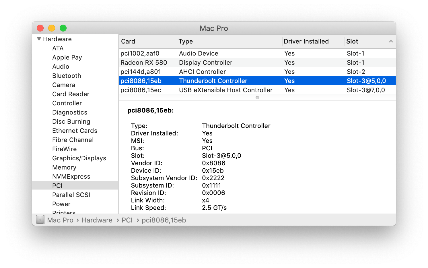

Testing with Open Core. I'm pretty sure that the card wasn't recognized like this before...
Making a PCIe device appear in the PCIe list has nothing to do with making the PCIe device work. Thunderbolt controllers and many other PCIe devices don't appear on normal Macs in the PCIe list. Only devices with certain Apple properties (related to slots or Thunderbolt) are listed. Actually, if you have a Thunderbolt controller in a Mac slot or a slot connected to a Mac slot, then it will appear. My Mac Pro has two Thunderbolt controllers that appear like they do in your screenshot and it isn't running Open Core or Clover.
A Hackintosh doesn't have the slot properties that a Mac Pro has, so often you won't see any devices listed in the PCIe list. Open Core or Clover can add the properties to make PCIe devices appear in the PCIe list including PCIe devices that aren't connected to a slot.
To make Thunderbolt work, you need to make a kext driver or make modifications to the DSDT or both. The DSDT is modified on Hackintoshes using Clover or OpenCore. People have gotten Thunderbolt to work on Hackintoshes by modifying the DSDT. There is a version of Clover used with automate eGPU EFI that is specifically made for real Macs which can modify the DSDT of the Mac. In either case, the modifications are made in RAM. The DSDT modifications consist of code (ASL -> AML) so it's almost as complicated as making a kext driver.
My card is listed as Unknown in System Information, good to see it listed as a Thunderbolt Controller.
What version of macOS are you running? I'm using Catalina.
Thanks @joevt for the clarification. I was just excited about seeing the card listed that way, and got a bit ahead of myself: it seems that Catalina, not the boot loader, is responsible...

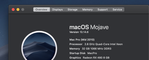

Hello to every one here,
I really, but really need your help.
I have a Mac Pro 5,1 Mid 2010, qua-core 2,8. 32GB and 500 GB SSD, Radeon RX480 8GB. but not monitor, it broke, then I went to buy an Apple Thunderbolt 27 Display, thinking that it has a mini-display port, but dam it was also a thunderbolt port, no I am stuck with a monitor that I can't use, and with a Mac Pro still does a good job for video and picture editing. Now my question is. I bought the Gigabyte GC-titan Ridge Thunderbolt 3,
I did my research, so I got window 10 installed and also the drivers for the PCI card, then I do what people says to do, ( I use boot champ), no problem I am in windows 10 all the drivers are loaded, then I use boot camp to boot into macOS "Mojave", no I am in Mojave- I can see the PCI active, but when I connect the Thunderbolt 3 adapter to the thunderbolt display, it will not work, the monitor is off , I tried both thunderbolt port and nothing, ( I have the DP connect from the video card into the mini-DP GC-Titan).
What am I doing wrong here?
Looks like people have been able to do it, but I can't. Am I missing a program? to activate/disable a promt/command?
BtW my apple display works with no problem when I connect it to my mackbook pro's thunderbolt, I get picture and sound, of course is apple's made, but please someone with more knowledge can guide on how to get this working.
Thanks MR community.

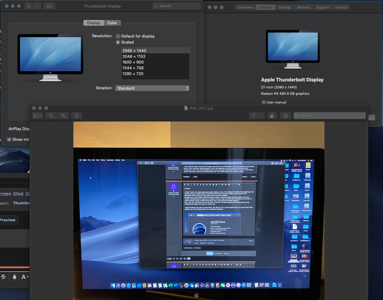

Hi Joevt,
I made it work, by making apple boot system believe I have a Titan Ridge PCI install at the beginning, then remove and put an Alpine, load the GC-Titan drivers first, because the Alpine does not work with BootCamp, there it won't load the drivers when you boot in MacOS.
So again, put a Titan Ridge, install the drivers, restart , remove the Titan and put a Alpine, boot up in MacOS, use BootChamp to boot up on windows 10, then, make sure that your hardware is all normal, no drivers missing, reboot in MacOS using Boot camp, and @_@ let the magic happens.
But, if you turn of the Mac Pro, you are dead, it took me 4-6 times trying to load up the drivers to be recognized by Apple's OS. here is a screen shot.
I wish everybody luck, just one more thing, The Titan is a Re 1.0 & the Alpine Rev 2.0, I don't know if this matters, but I just wanted bring it up to anybody's attention.

That's a little more clear. But it seems you are connecting the Apple Thunderbolt Display to GC-ALPINE RIDGE instead of GC-TITAN RIDGE? I think this has been done before and doesn't require Windows.
Do any of the other devices on the Apple Thunderbolt Display work (USB, audio, Firewire, Ethernet, Camera) in macOS or Windows?
The camera doesn’t work, but the rest do, I don’t know why @-@! But is not my priority for now, all I wanted was to use my Apple Monitor. Cheers!
That's great. I would like to see an ioreg dump of the Apple Thunderbolt Display.
