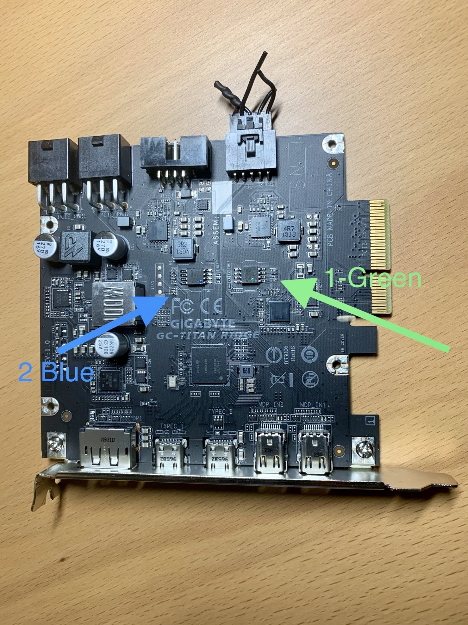

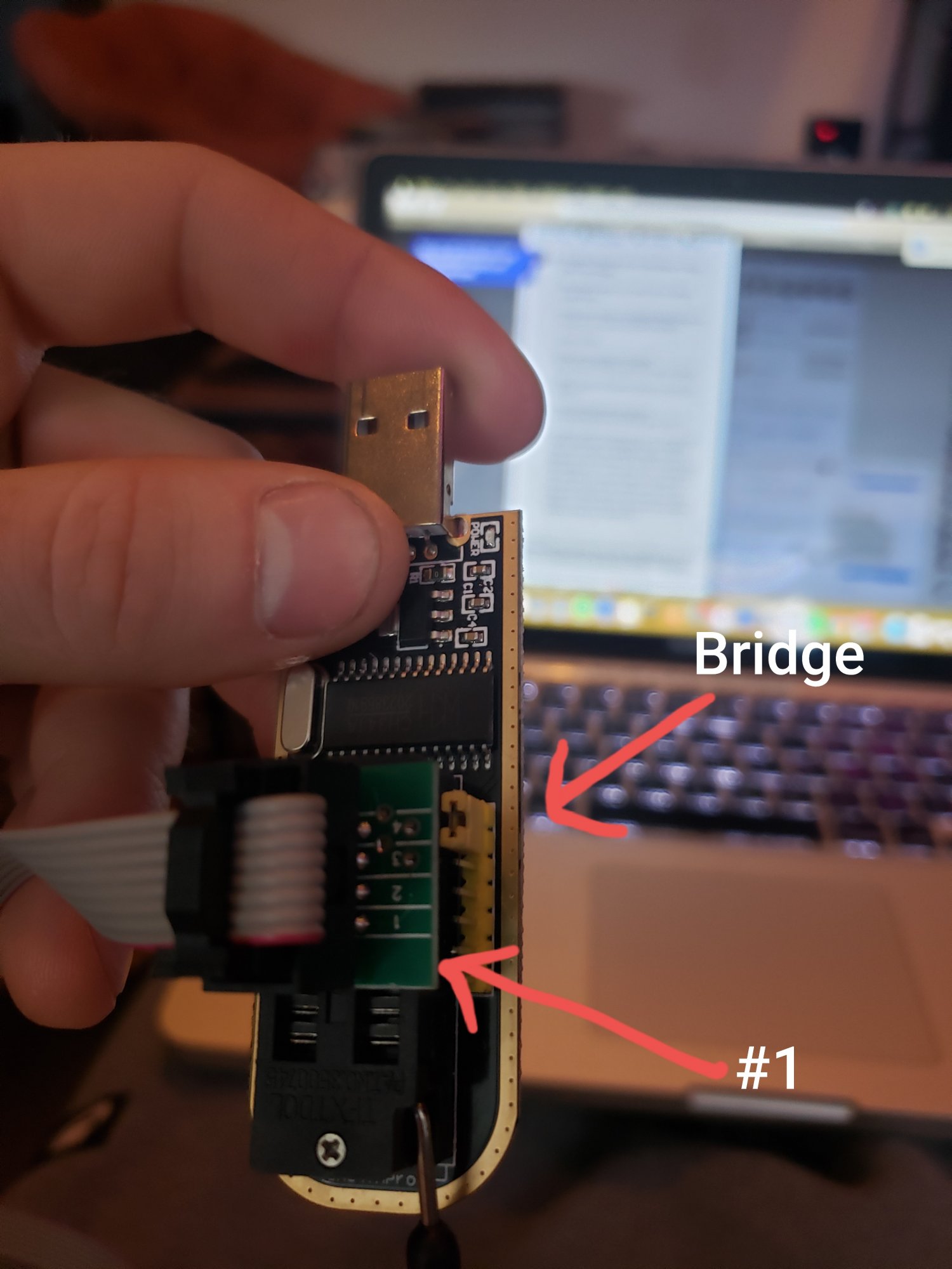

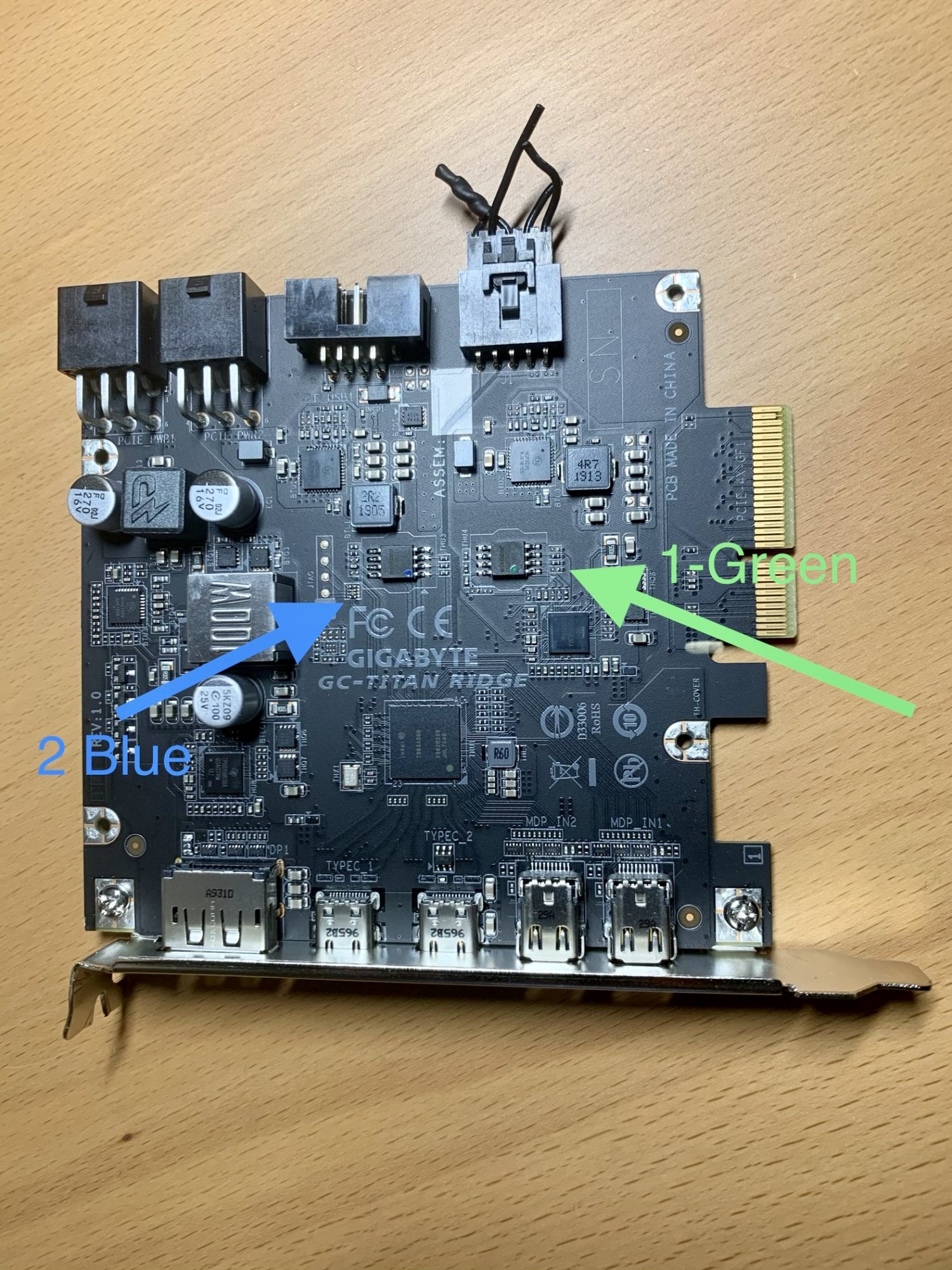

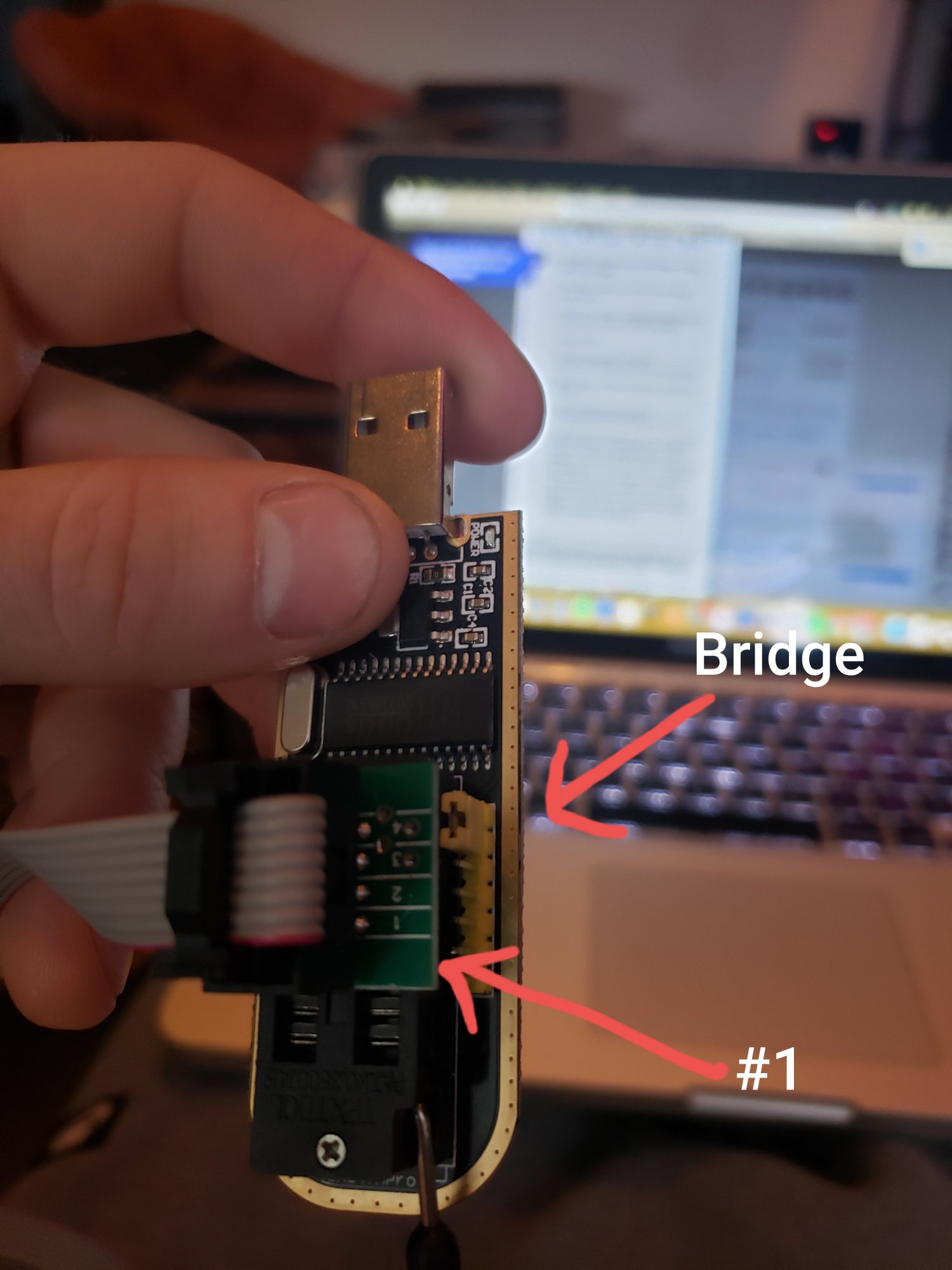

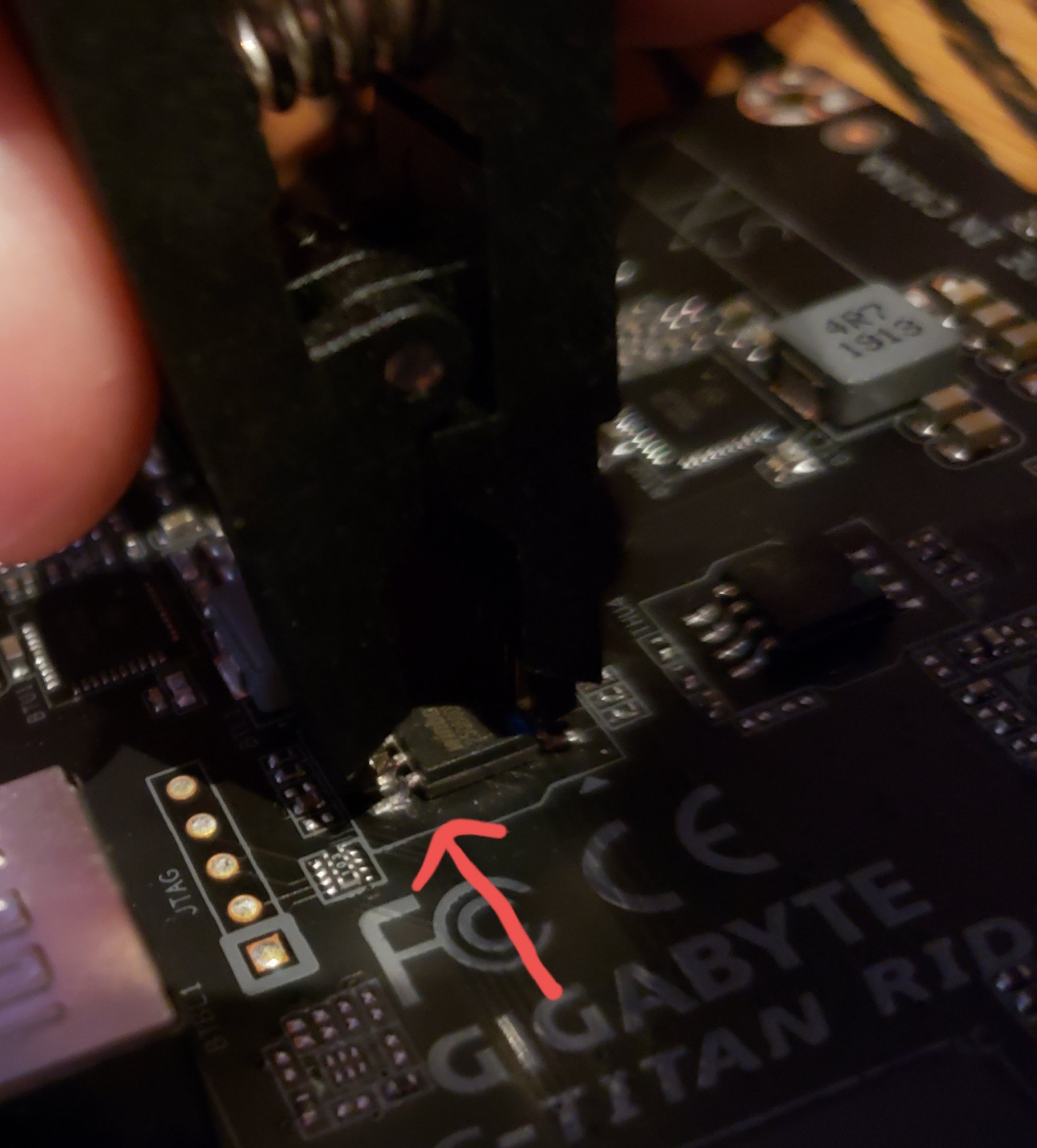

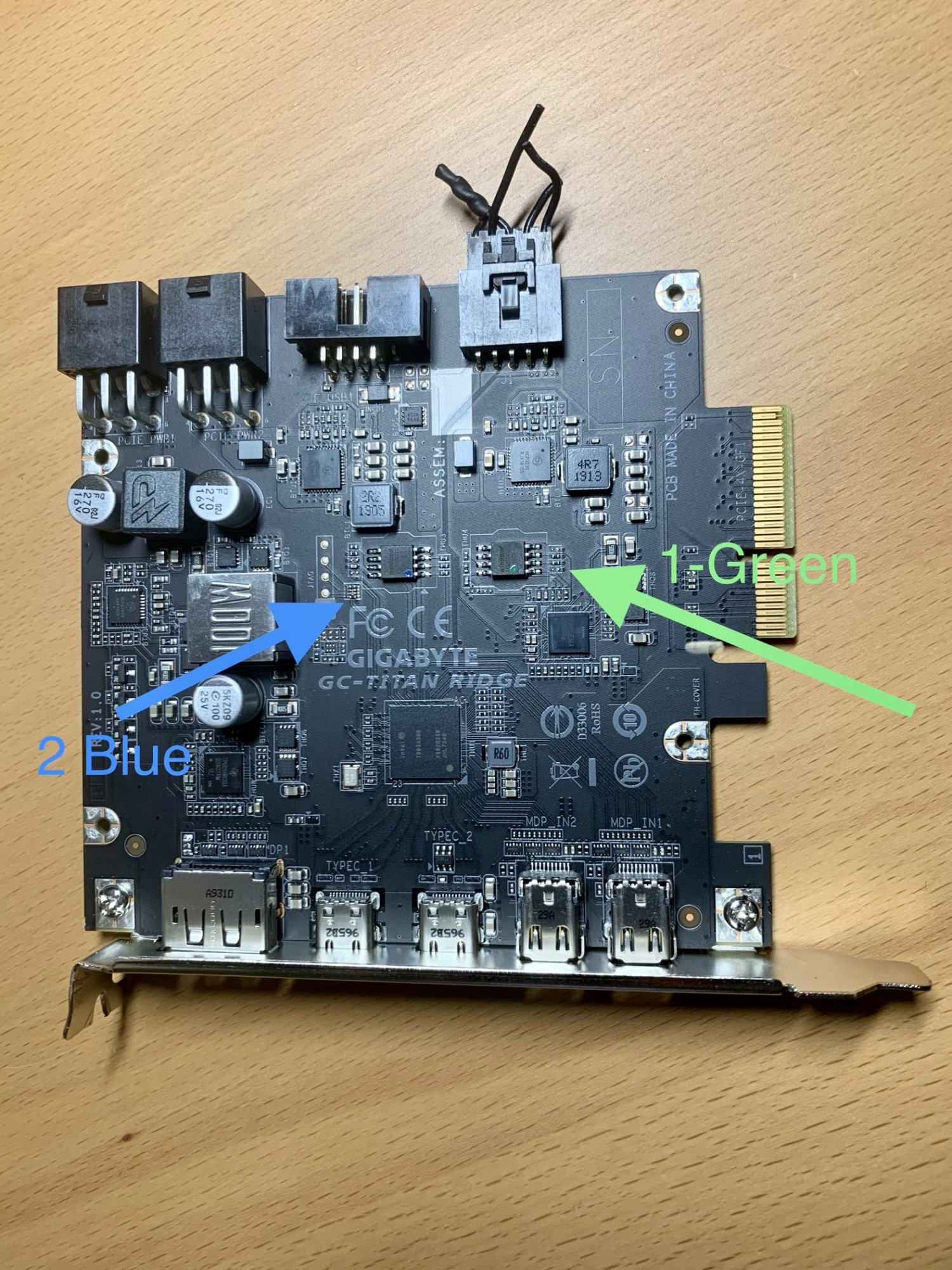

Attention! Anyone who is interested in fixing their Titan Ridge. You need to flash your chip with an eprom programmer.
https://www.amazon.ca/…/ref=cm_sw_em_r_mt_dp_U_OJstEbC523B2M
Correct BIOS https://drive.google.com/open…
Clean version of CH341A Software (Install all drivers)
Connect to Blue chip first

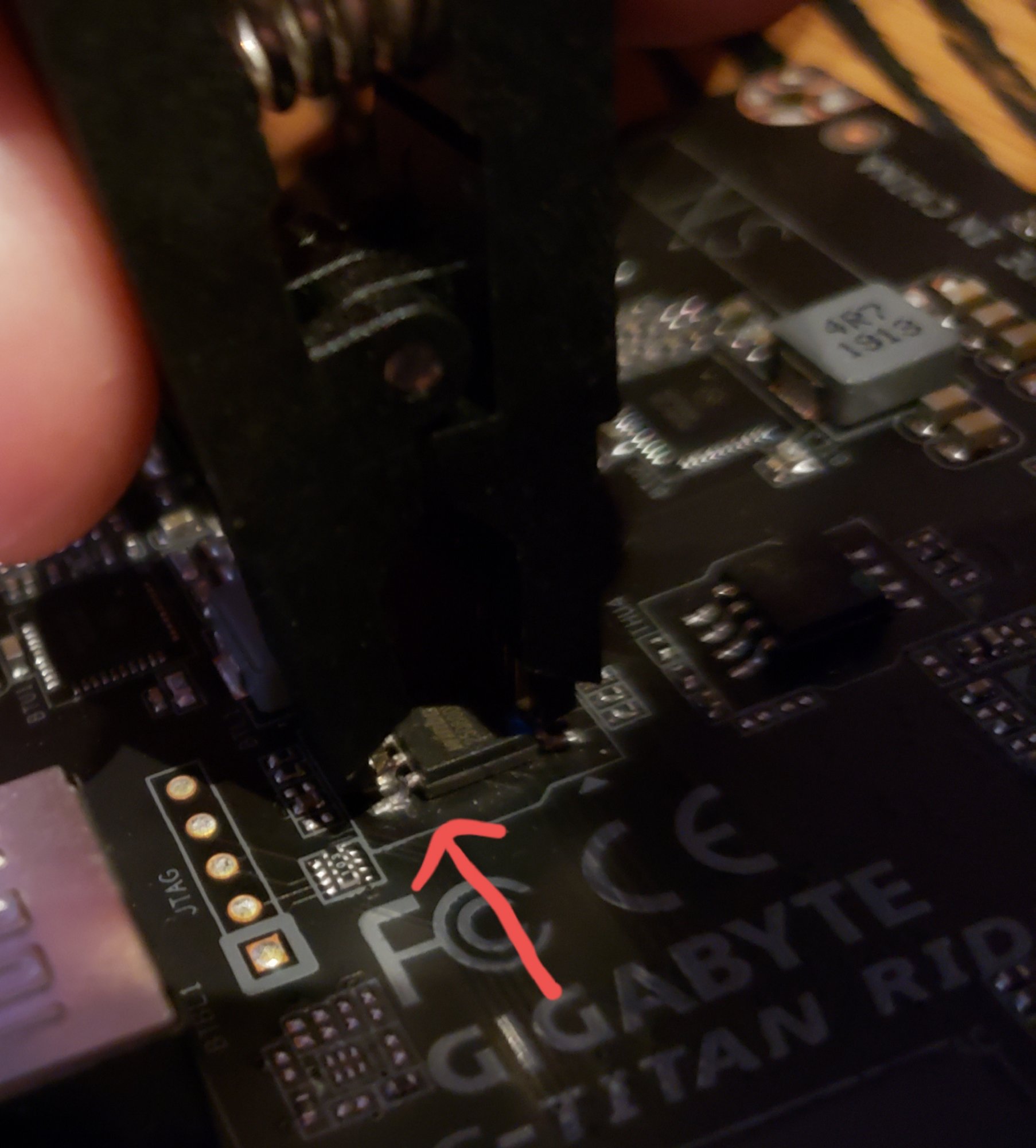

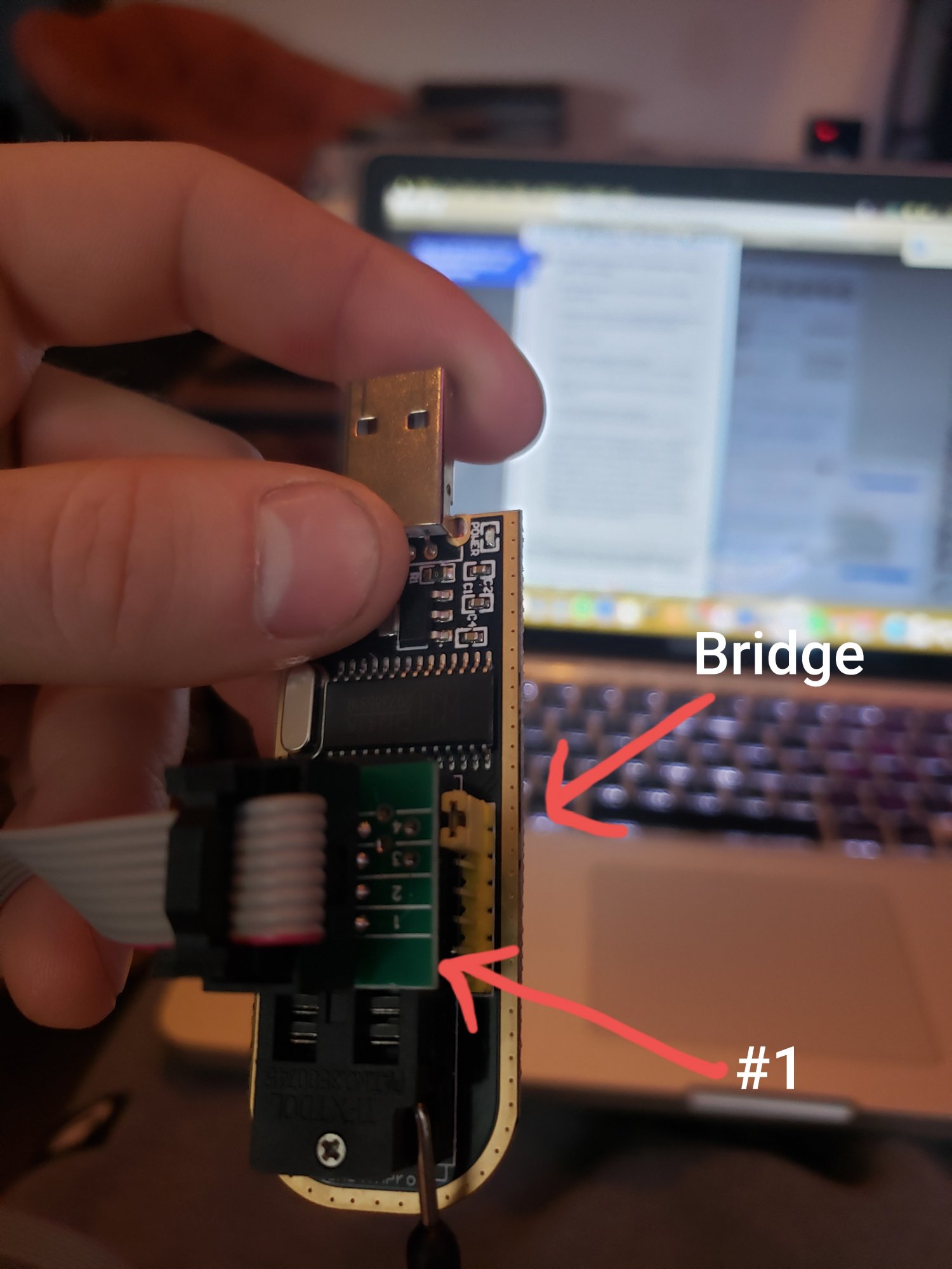

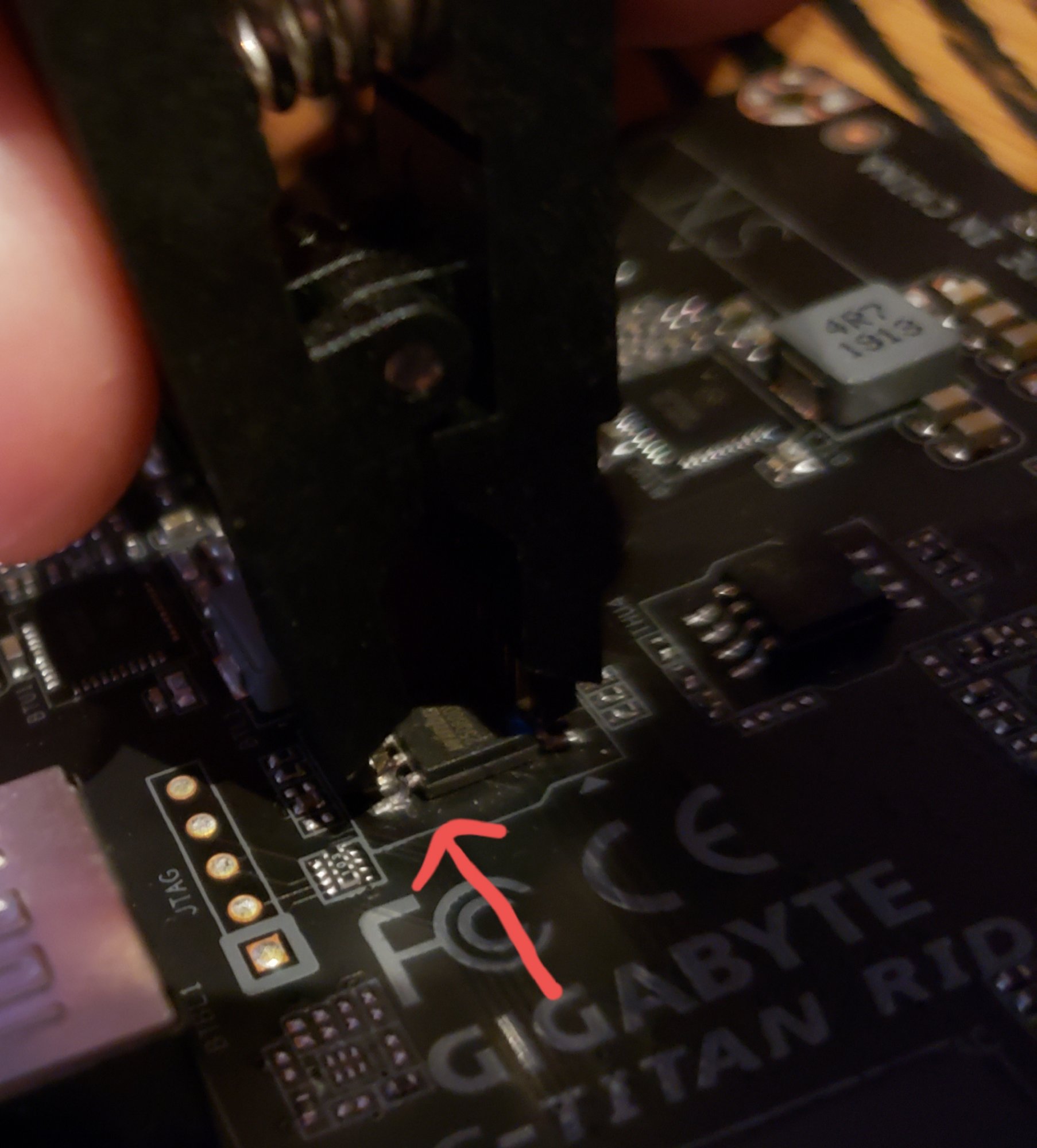

Patience is KEY! Trying to clip onto the chip is the hardest part! Unless you buy a nice clip $$ then you'll need to be diligent in your efforts. The dot on the chip always indicates where 1. Make sure the red wire on the clip is positioned correcting with 1 on the chip. 2 the orientation of the piece you place inside the programmer all depends. Open the software and see the diagram. Some peoples cards may be a mirror image of what they see, ignore this and follow where it tells you to place pin 1.
When aligning the clip with the chip look from the side like in the photo. Focus on one side of the clip first. Make sure the metal connector lines up perfectly with the pin. Then the same on the other side. Make sure the whole time you are pushing down firmly. When you release do it very slowly and do not move it around. If you can't see near you may need a magnifying glass. After 30 mins I could do it first attempt each time. Just be patient.
Open program and click READ. If you are successful you should be able to grab the scroll brand see content on your chip. If you see nothing then you probably have not connected it properly. Keep trying until you are successful.
Once you succeed in reading the chip. SAVE the bin on your chip. Backup backup backup.
Do the same for the green chip.
Now that you have backed everything up go ahead and connect to the Blue chip again. Once successfully connected wipe chip. Go and open up the blue chip file I have provided you. When you open it you should be able to scroll along and see its contents. Hit Program.
Once it is complete test your card. For those of you who have 23.0 cards that updated them this should fix your issue. If not, keep reading
For the cards that came stock on newer firmware 43.0 I found the green chip varied from the updated 23.0 cards. So go ahead and clear/program the chip with the firmware I have provided for the green chip.
Make sure your clip is properly secured and reading the chip properly before flashing the green ship.
I am not responsible if you brick your card!
GOODLUCK! Pm me for assistance
If anyone continues to have issues without results we can arrange for me to ship you a TR card.

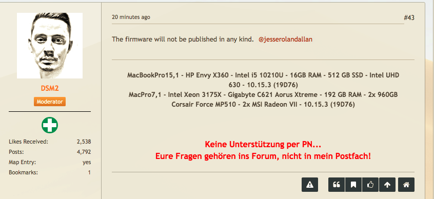

DSM2 is the guy behind this work.
Like I understood he made a custom firmware and flashed it to the Titan Ridge.
Someone he works with or something created the custom firmware and they have ask for it to not be released so I personally asked him. He said in no, it will never be released.
