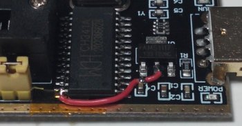

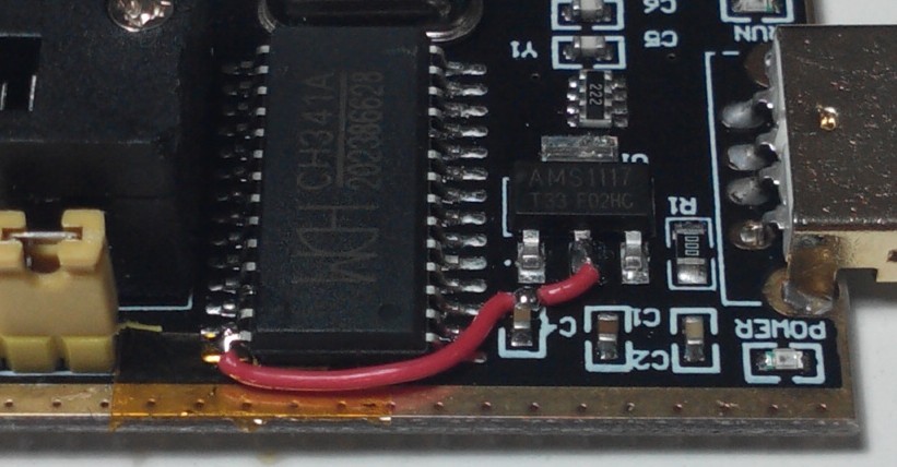

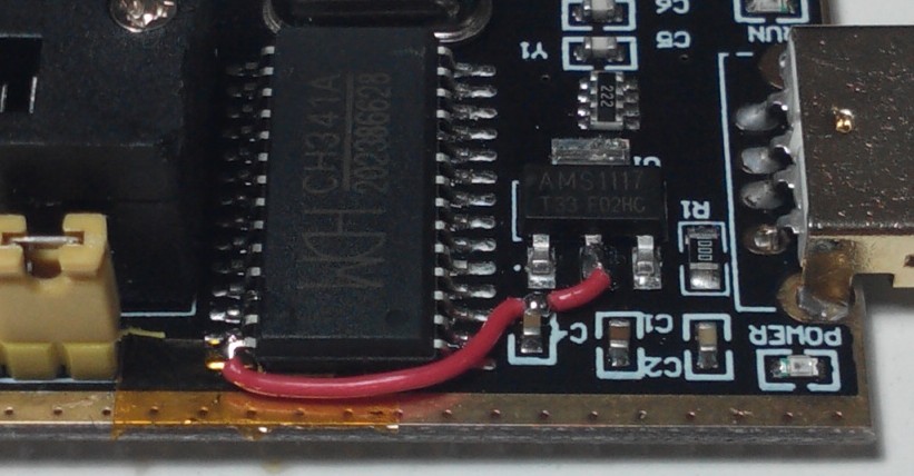

This has to do with the fact that the Clip EEPROM Programmer is wrongly polarized and permanently uses 5 volts instead of the 3.3 volt concerns.
I doubt that someone who doesn't know how to do a flash, suddenly knows how to rewire it correctly.

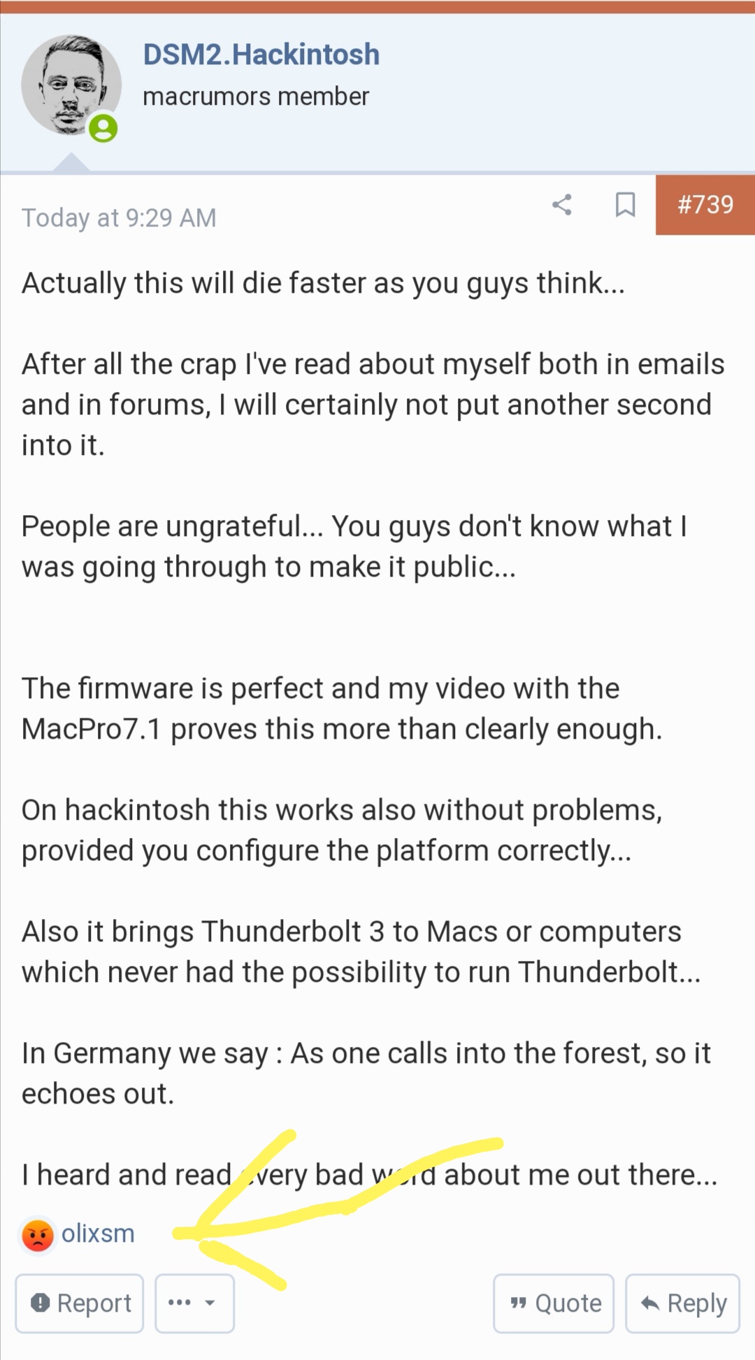

Actually this will die faster as you guys think...
After all the crap I've read about myself both in emails and in forums, I will certainly not put another second into it.
People are ungrateful... You guys don't know what I was going through to make it public...
The firmware is perfect and my video with the MacPro7.1 proves this more than clearly enough.
On hackintosh this works also without problems, provided you configure the platform correctly...
Also it brings Thunderbolt 3 to Macs or computers which never had the possibility to run Thunderbolt...
In Germany we say : As one calls into the forest, so it echoes out.
I heard and read every bad word about me out there...
Thanks DSM2 for the heads up re the polarity issue.
Does this apply to every CH341A 24 25 Series EEPROM programmer out there ?
And secondly I am pretty handy with a soldering iron ... it would be awesome if you could explain the correct wiring config.

also DSM2 be happy to pay you for a detailed explanation of how to fix the wiring issue and how to proceed with the firmware update.

The red wire ist point 1, and the point 1 on the blue chip is the blue point 🙂
