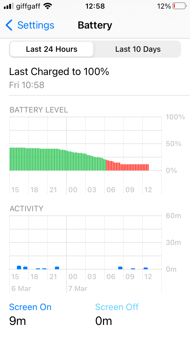

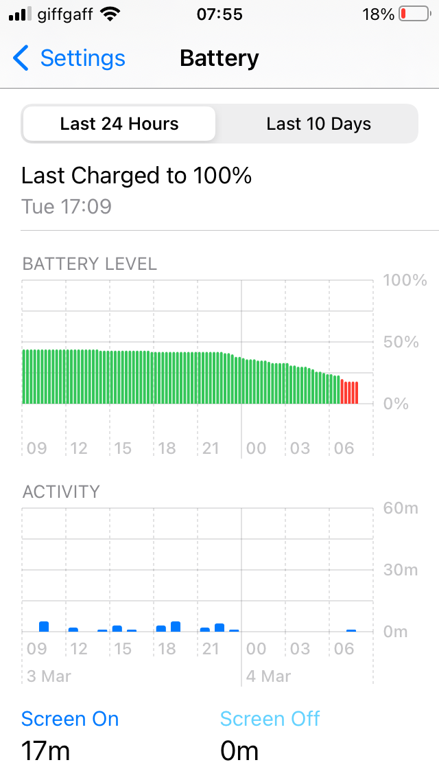

Looks like Apple leave work early on Fridays. This is the lowest overnight drain for a while:

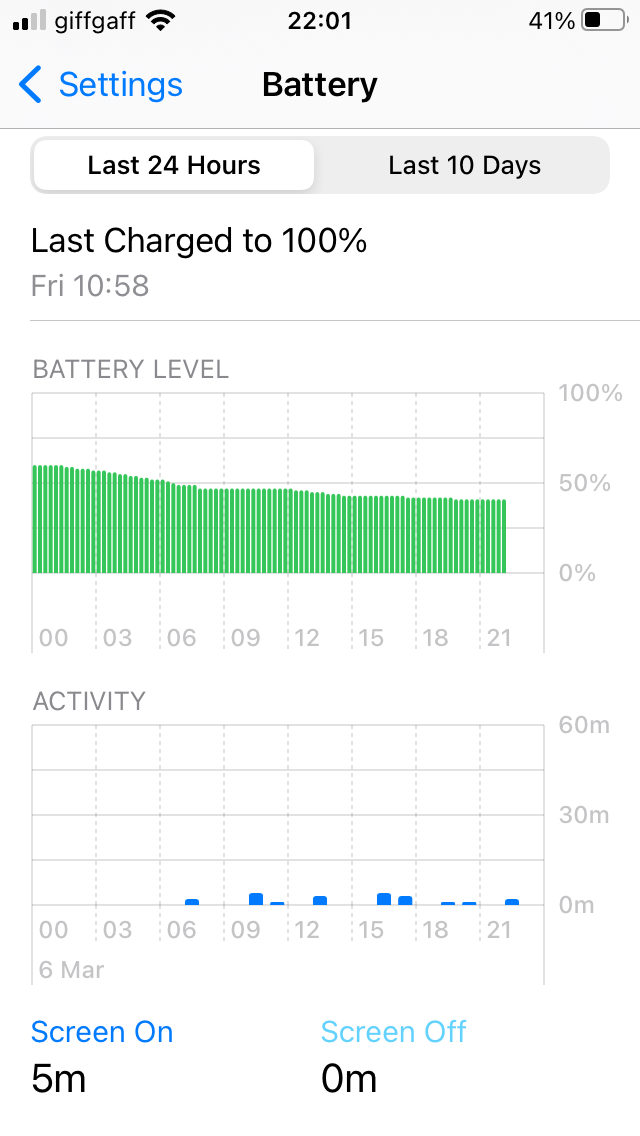

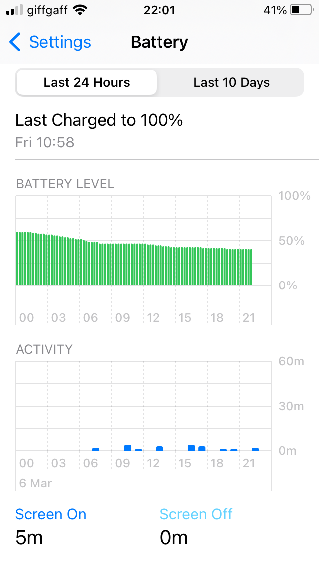

Okay, so phone drained more rapidly overnight, but not as much as it has been, and it's now sitting at 41% after 2½ days (since fully charged).
I find it weird that significantly more battery is used overnight than during the day. I would like to know why.

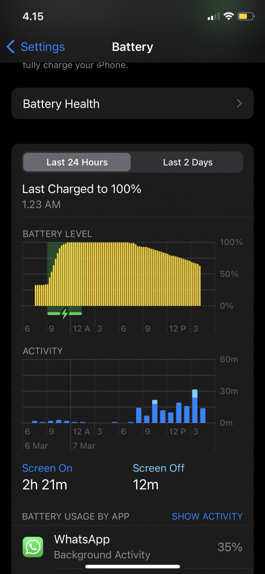

Hi all … i want to ask something
Is this a normal battery discharge with a usage like this?

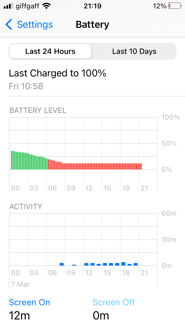

Overnight battery drain 29%: 41 to 12%. Five hours later, still on 12% ?‍♂️
It is not normal but looking at the graph, it was whatsapp that killed the battery. I would first try disabling background app refresh for the app(Despite it should already be off due to low power.) If that does not help, maybe remove the app and see what happens. It could be a bug in their app, or the fact that Zuckerberg could be spying.
Agreed, i knew something was wrong with my xs.. i think thats not normal too…

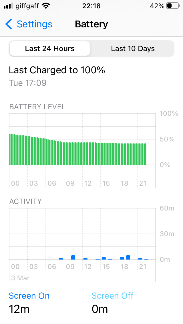

Hard not to agree. It's been a suspicion for a while. More evidence:

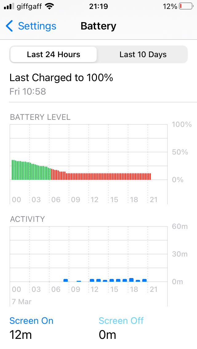

It's at 5% now – it started its 22:00 drain as usual after no drain all day, as shown above – and I'm going to bed!
I'm not clear how I can guarantee it's charged to 100% without unlocking it. Nevertheless, I presume it will fully discharge overnight, and will charge for six hours, which will be ample.
My understanding is that since iOS 14.5 battery calibration is "automatic". Presuming that's what's out of kilter here, it's bonkers there is no way to override this "automation".
