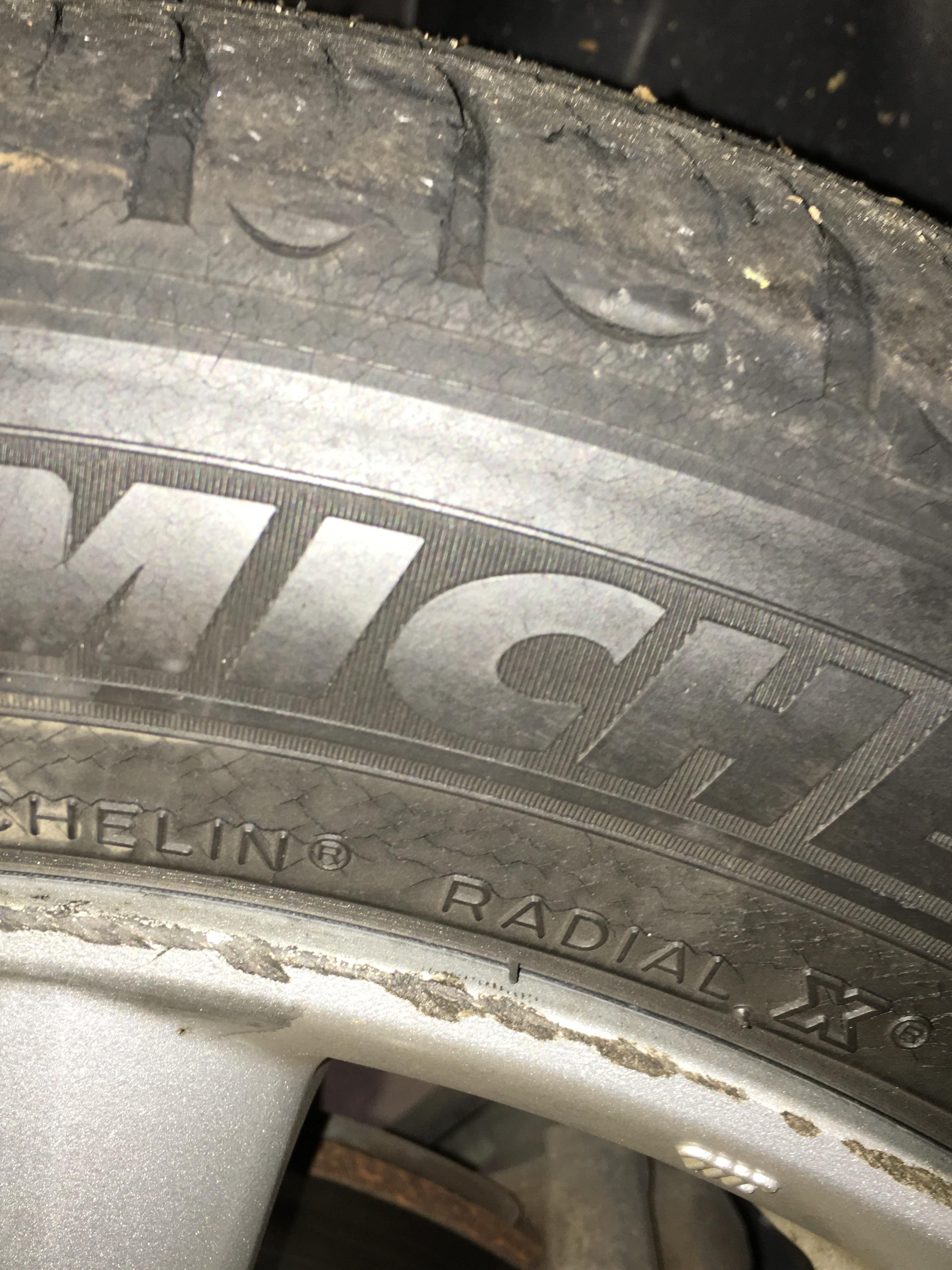

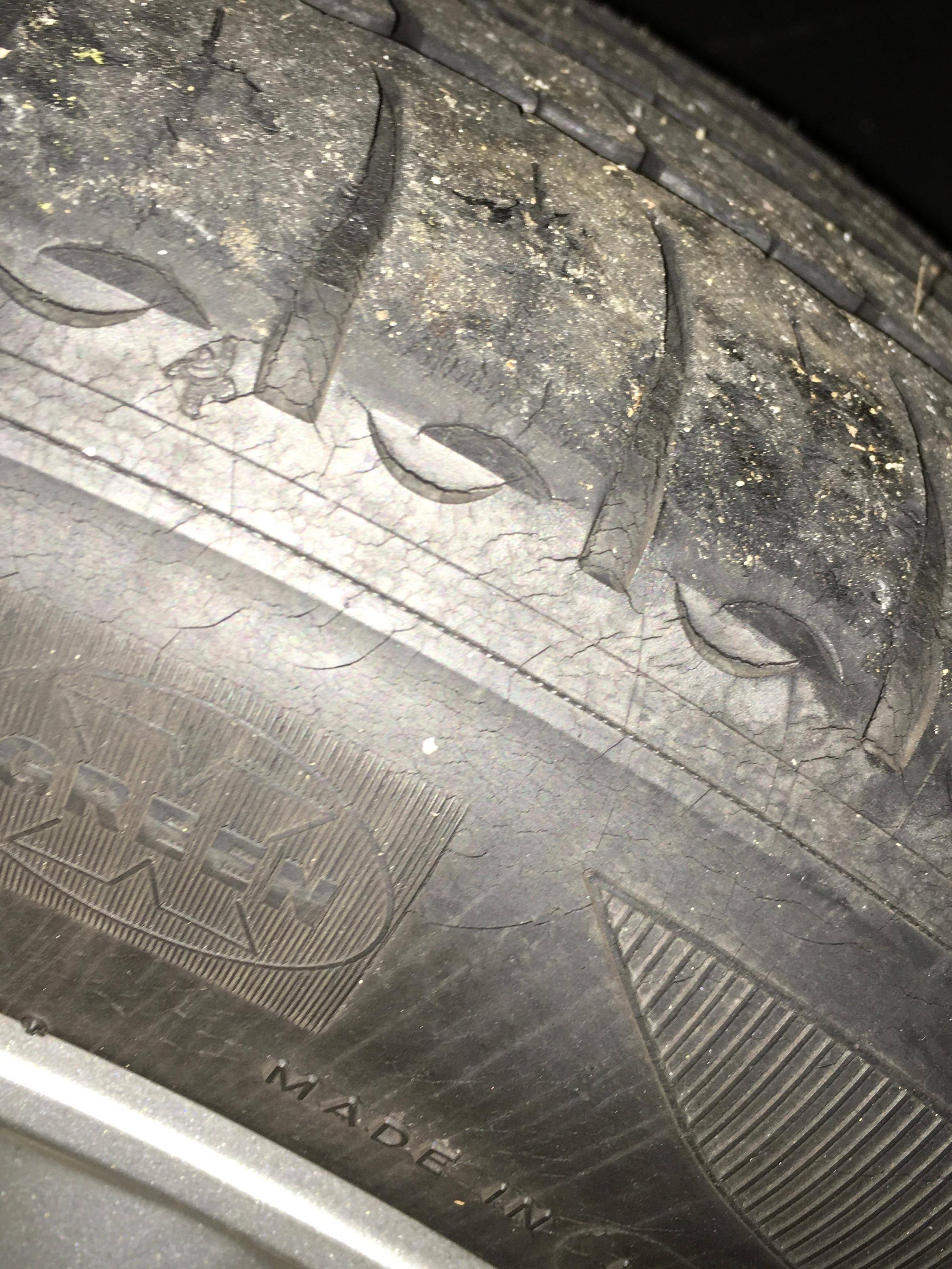

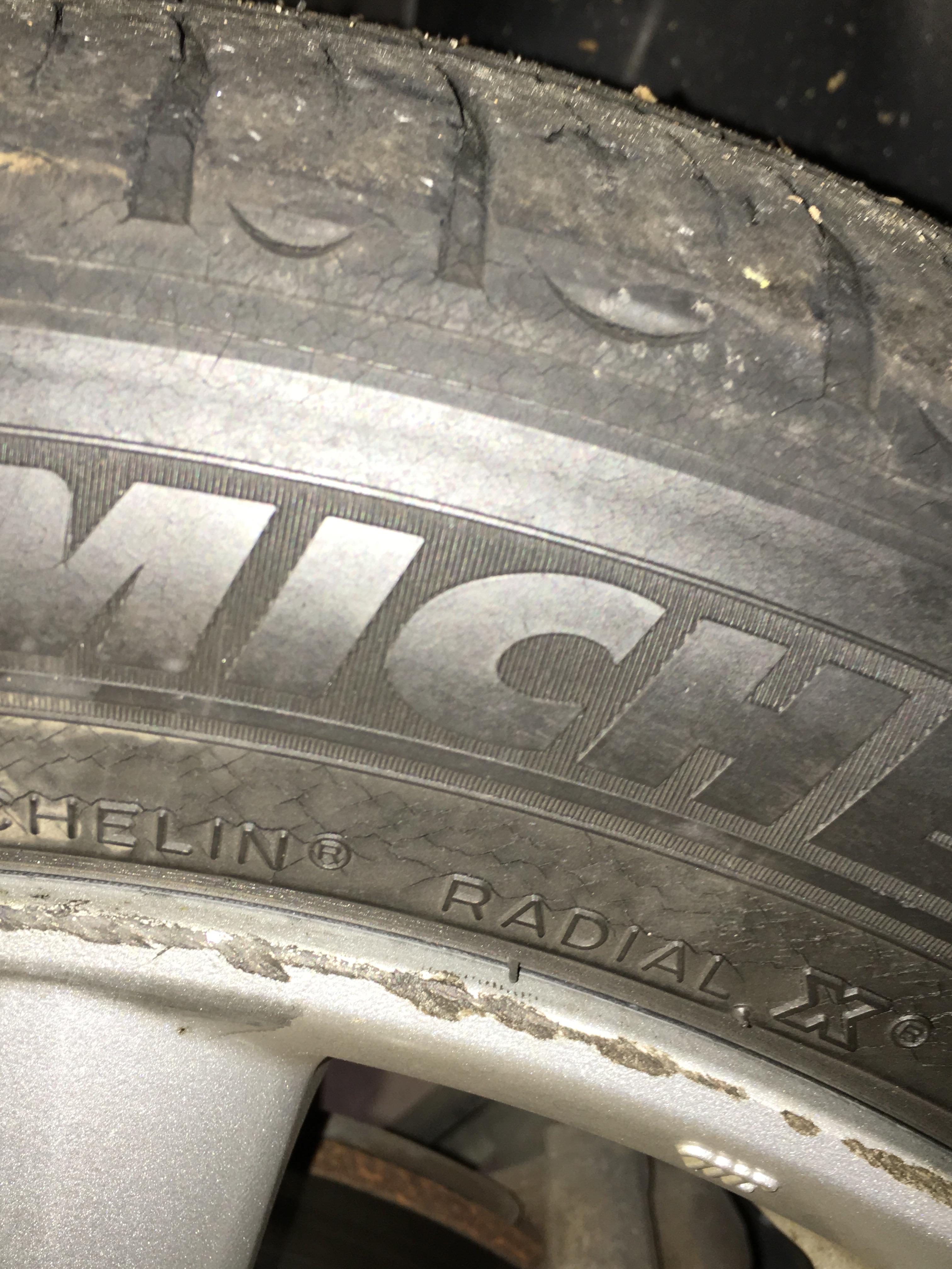

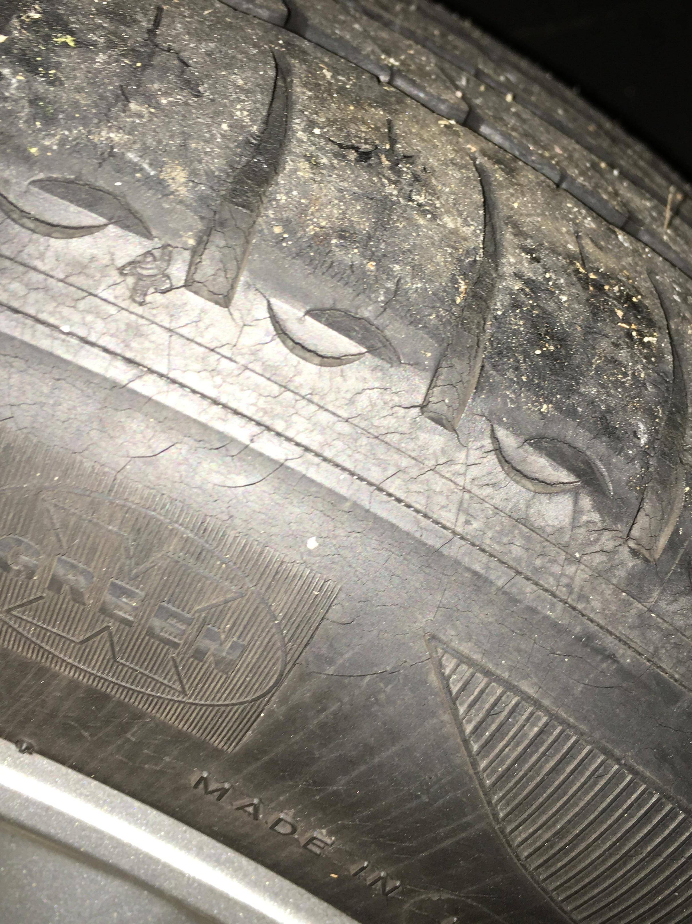

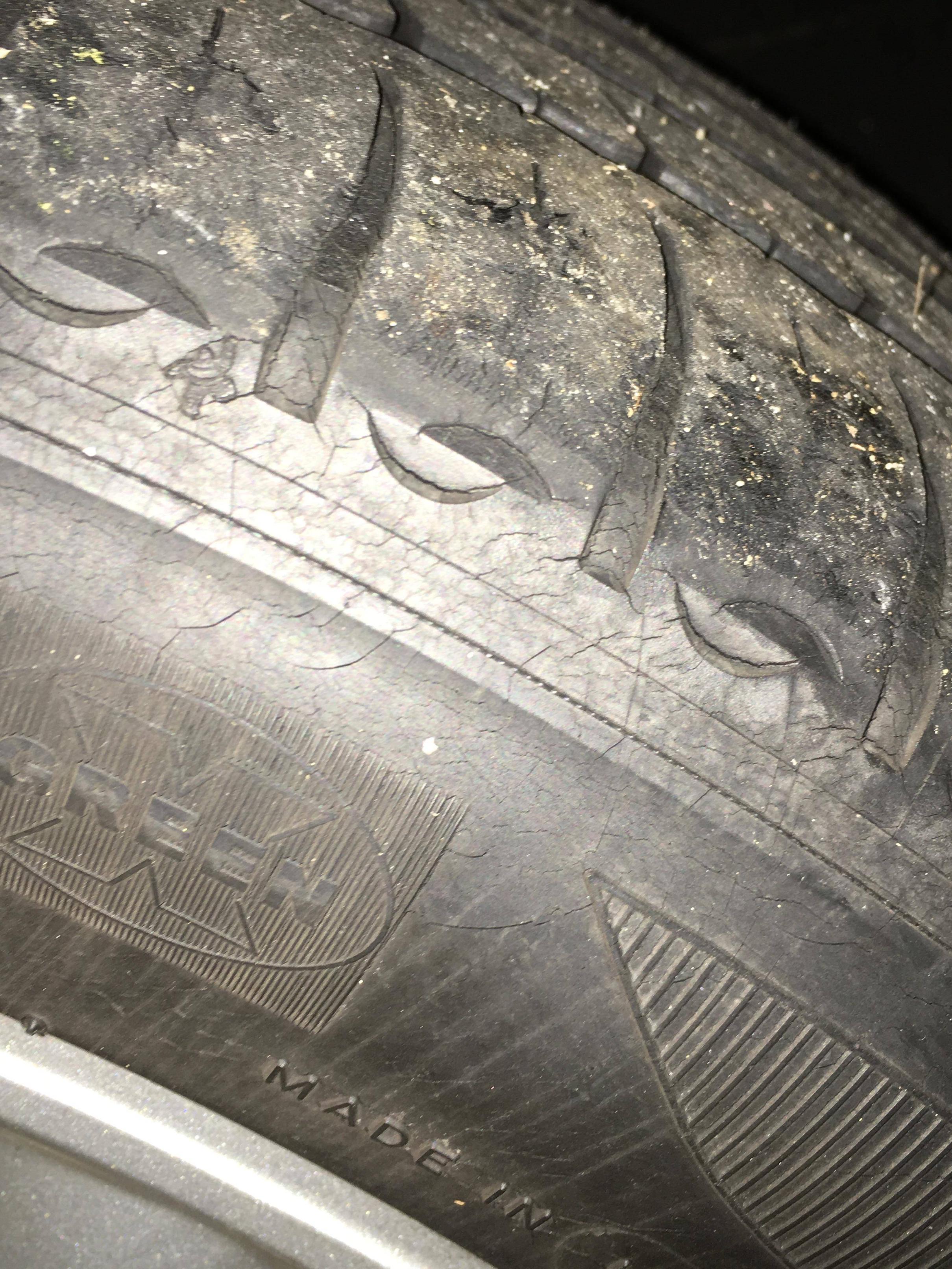

I brought my car in for an oil change and tire rotation earlier, and the guy behind the desk said the tires are starting to dry rot. They're Michelin Primacy MXM4's that I've had for about 42,000 miles.
More pics here http://imgur.com/a/RiFGo
Any idea how bad this is, and would you say they need to be replaced before holiday highway travel (about 500 miles roundtrip)?

If it were me, I would swap them before going on a road trip. If the side wall is already cracking, the rubber has already lost some or most of its properties to perform the way they're intended and it would be really unfortunate for something to happen when you're on your trip. But of course nothing may happen and you should be ok but is that a risk you want to take? If it's something you're going to have to replace, why wait to do it. I learned my lesson with doing preventative maintenance. I got stranded once because I chose to ignore something that may/may not fail at the time. I gambled and lost.
It looks like your tread is pretty worn anyway, and the sidewall cracking looks pretty severe. I'd not want to set out on a trip-or drive on the interstate for that matter-with tires like that but then I'm pretty anal about it. ~40,000 miles is about typical in my experience for this class of tire.
I'm not a fan of Continental tires. They tend to be somewhat of a performance oriented brand, but anecdotally I've known several folks who have had problems with "bubbles" in them(basically sidewall separation). I wouldn't want to plunk down big cash on those.
I like MXM4s-in fact they were the OEM rubber on my car. They are a superb GT-type tire(i.e. balancing fairly good grip with a comfortable ride), although in that class I personally think the Bridgestone Taranza is a slightly better tire. I've always been a Michelin fan, so it pains me to say it but I find the Bridgestones to be slightly quieter and-more importantly-have better wet traction than the MXM4. I've had both tires on the same car, so think I have a decent feel for how they compare. The Michelin and Bridgestone flip flop in price, and at any one point you might be looking at a $5-10 difference per tire so I'd consider the cost a wash(especially since realistically I'm guessing you're going to be around $1k out the door mounting/balancing/aligning at the size you appear to have in this class of tire).
If you like your MXM4s, I don't think you can go wrong with another set of them. With that said, I'd definitely give the Bridgestones a good look.

I would be *somewhat* leery about driving on those. Very minimal cracking on the sidewalls is acceptable but a sign your tires are aging. These hairline cracks can be exacerbated by tire shine/armoral products that dry out the rubber prematurely. It does appear the hairlines are inching towards the treads and between the tread lines (you should look at your tires tread to check for cracking between the tread).
If you are going on a trip, I would get the replaced before you leave. High speeds and tire disintegration can have catastrophic effects- to your car, others' property, passengers, other drivers, pedestrians, and yourself. If you drive in a cold climate (especially with snow), there's another good reason to replace them. Dried out, worn out tires aren't good in the snow.
I am a big fan of Michelin tires. I'm not sure what kind of car you drive, but 42,000 miles is pretty good for a set of tires, especially if you have a heaver car or AWD. My 535xi has run flat tires (which suck BTW). Looking at my dad's service records, these things only last 25k miles (another reason to to pick RFT's). My dad's Range Rover Sport (conventional tires) ate through it's first pair of Continental all-season tires in just over 15,000 miles! He switched to Michelins and got 30k miles of longevity. I feel like most cars with good quality conventional tires last ~30,000, maybe 40,000 miles. Cheaper tires use harder rubber, and actually last longer but do not perform nearly as well.
I've always been a big fan of Michelin tires and believe they're worth the extra cost in terms of performance and longevity. On my Grand Cherokee, I went through Goodyear Tires (I forget the model, but they were ~$160) like crazy in the first 5-6 years I owned that car before switching to Michelin. The worst Goodyear problem was having a tire burst and nearly ripped off the side of my car on a rock cliff.
Thanks guys. You've convinced me to bite the bullet on this one and replace them.
