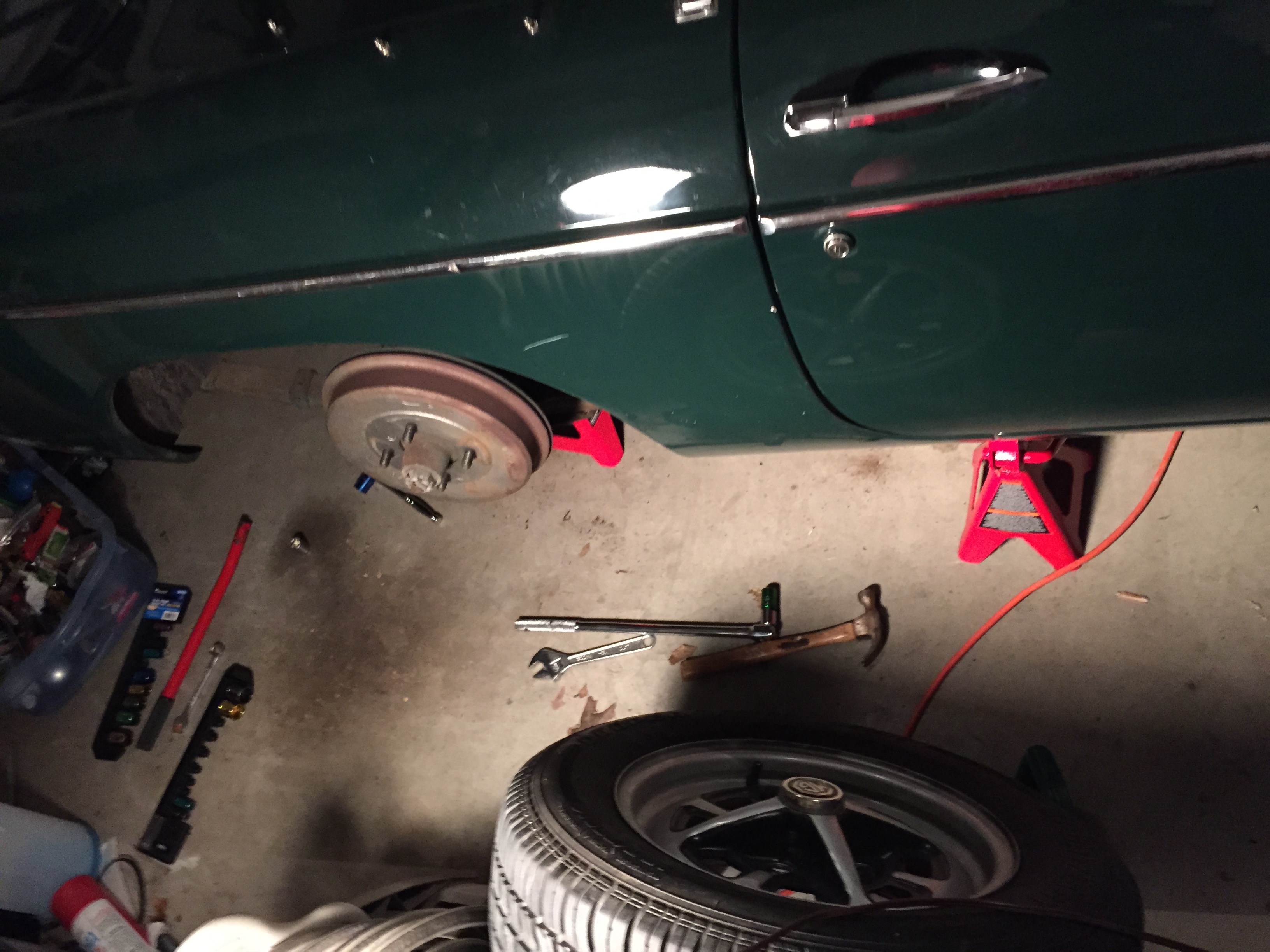

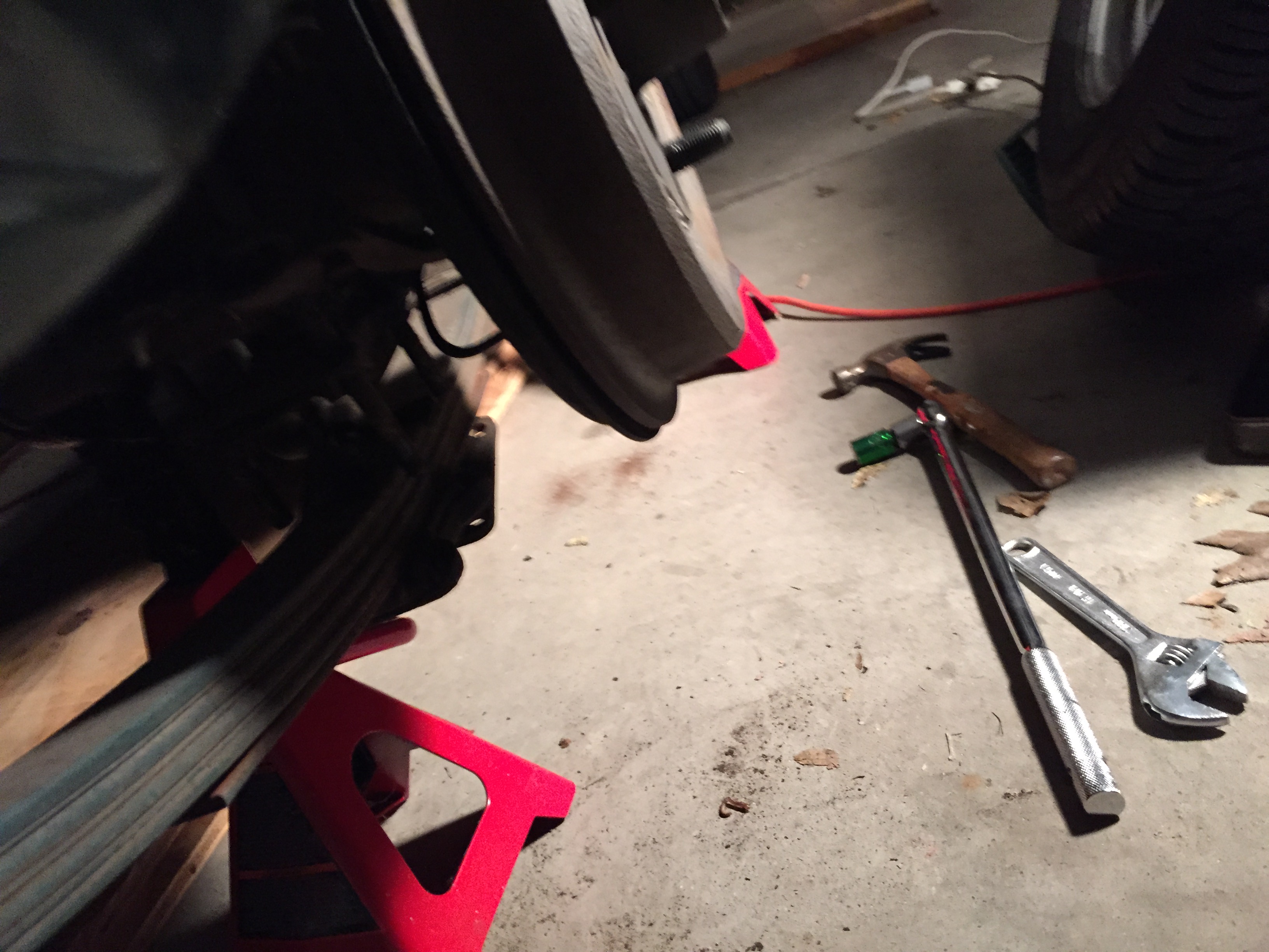

I started what should be a fun project this evening...if only I could get around 45 years of rust. I do have to say that the 18" breaker bar I bought a few months back was a very worthwhile investment. Once again, I'm finding myself back to the Hayne's manual "this bolt may be difficult to remove".
I do have to say that the 18" breaker bar I bought a few months back was a very worthwhile investment.]
I think if anyone plans on keeping their car long or works on their car, buying a set of tools is almost never a waste of money. Even if you use it once, the amount of time you save for having the correct tools on hand to make it a hell of a lot easier makes the purchase worth it. There have been so many times where I thought to myself, if I didn't have x tool, it would have taken me 2-3 times as long and would be a lot more difficult. Also, by having the correct tools, it allowed me to never see a BMW dealership outside of included maintenance. That in itself is a huge plus!
A couple tips for removing rusted bolts and nuts...
Always use a 6-point socket on a fastener that is difficult to remove. Typically socket sets come with 12-point sockets and these can strip off the hex, making removal much more difficult.
A MAPP gas torch can really help as well. It burns hotter than propane and can loosen oxidized/rusted fasteners easier. On really corroded fasteners it can help to go back and forth on the bolt/nut (with a wrench) to slowly loosen it and facilitate removal. Otherwise you could risk shearing the bolt head right off if you just attack it with a breaker bar.
PB Blaster, Kroil, and even WD-40 are your friends. I like PB Blaster myself. If you know you have a stuck bolt/nut, spray it liberally a few days in advance to allow the penetrant to soak in before attempting removal.
Another thing you could try is a crayon. If some threads are exposed, heat the fastener with a MAPP gas torch and touch the crayon to the threads. The wax will get drawn into the threads and should help with removal.

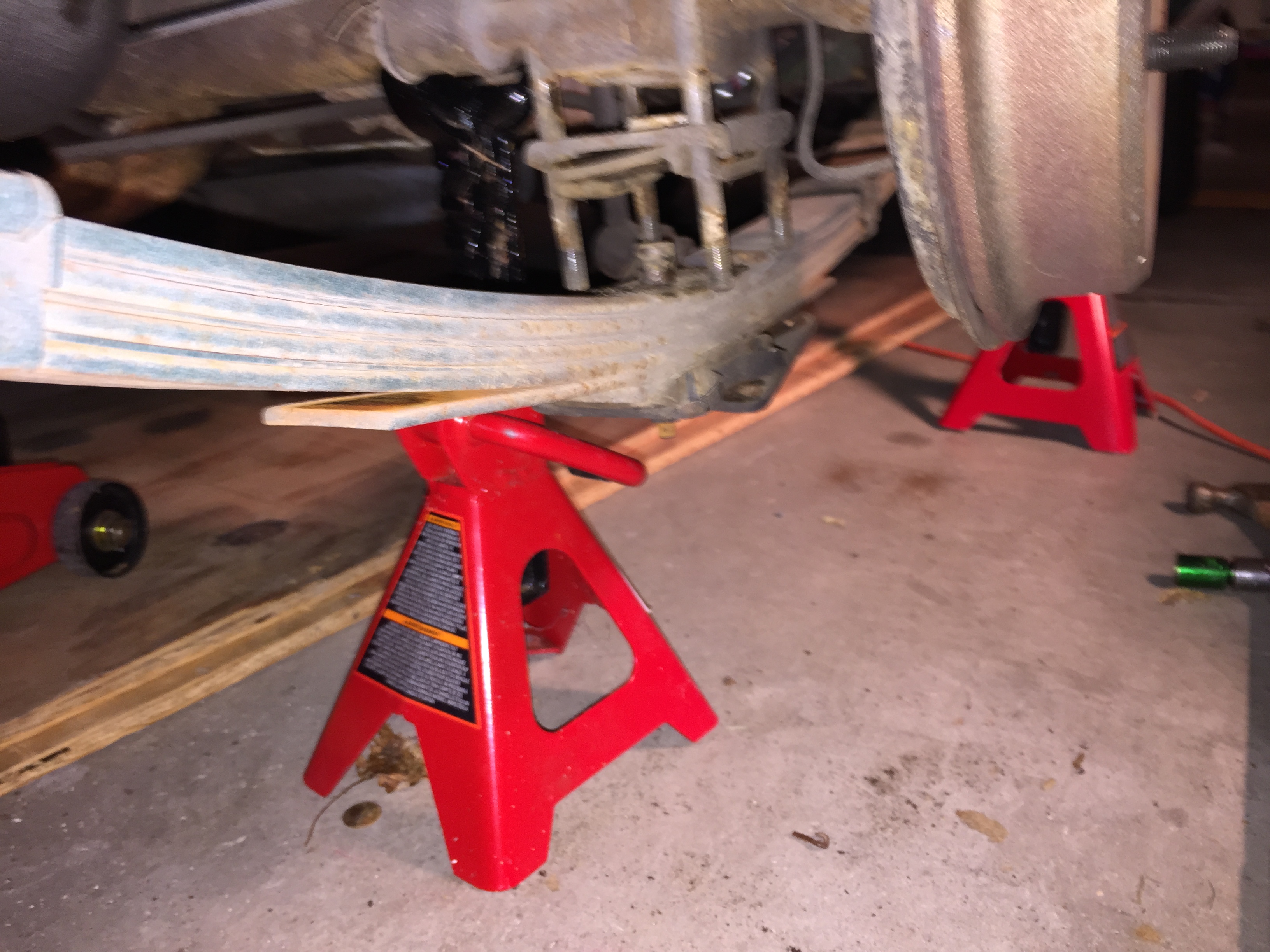

Thanks for the tips.
I'm actually down to one stubborn bolt. Most of the bolts that were giving me trouble were 9/16s, so while I was at Autozone this morning picking up some other supplies(including PB Blaster) I asked for the "longest 9/16" box end wrench they have." Unfortunately, all torches were off limits as these bolts were right next to the gas tank....
I now have everything off except for the bolt that goes through the front eye of the spring. I actually have the nut off of it, but it has to be driven out of the frame and THAT's giving me trouble. The angle and clearance is poor for working it with any tool, although I have heated the snot out of it with a propane torch. The bolt will actually rotate(somewhat) freely-I'm just having issues with getting it to slide out.
