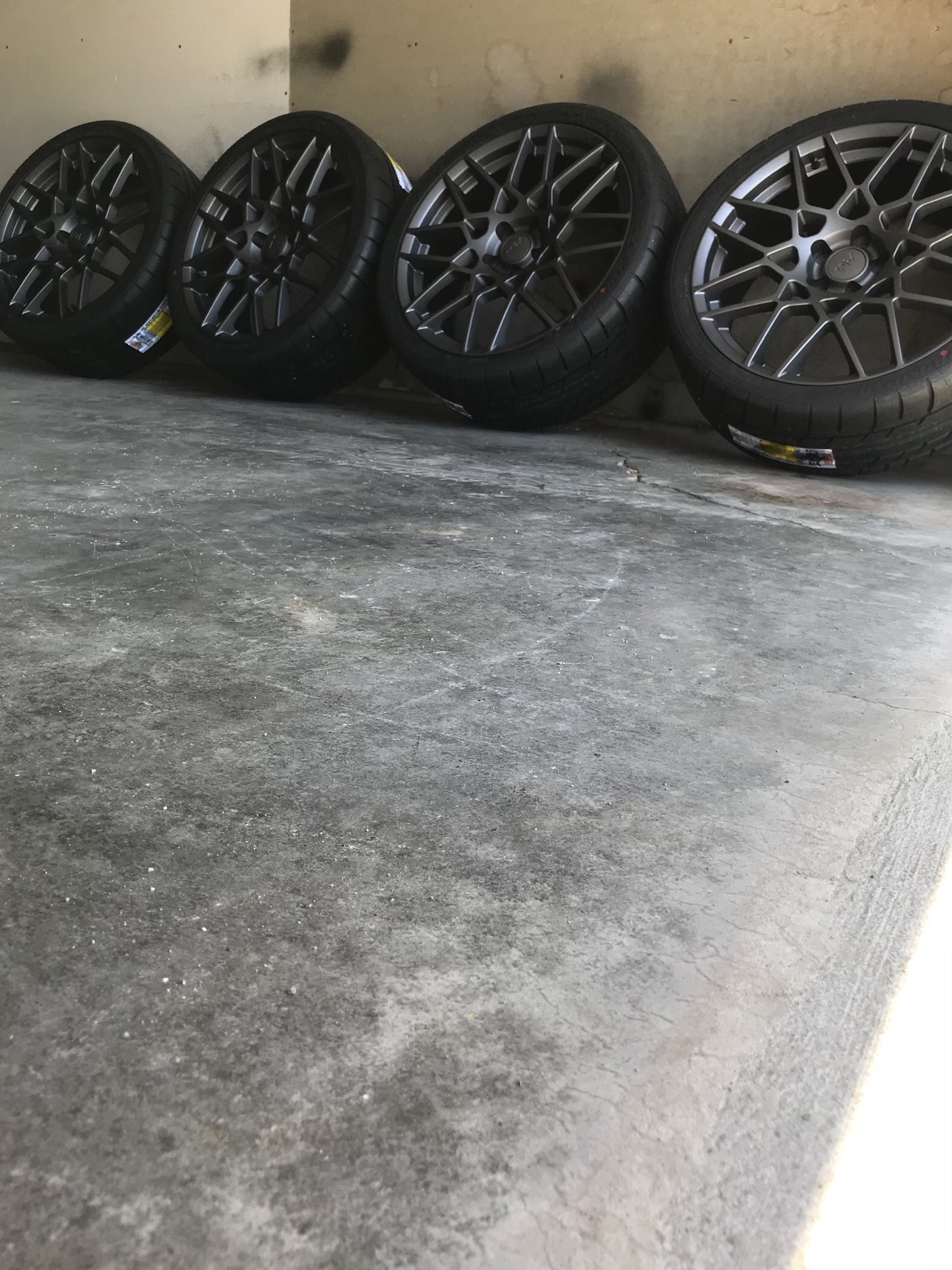

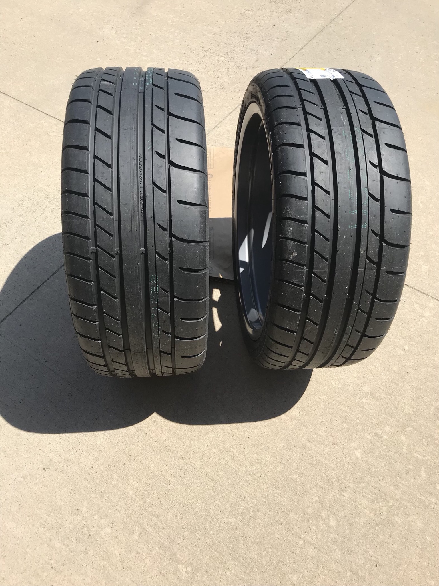

Arrived early. Those are some *FAT* tires by Mickey T compared to my current Pirelli set up.
The 20” charcoal GT500 wheels will look outstanding on my GT and will be a significant upgrade Over my stock 19” wheels. Should have them mounted tomorrow in preparation for C&C/this weekend‘s car shows.

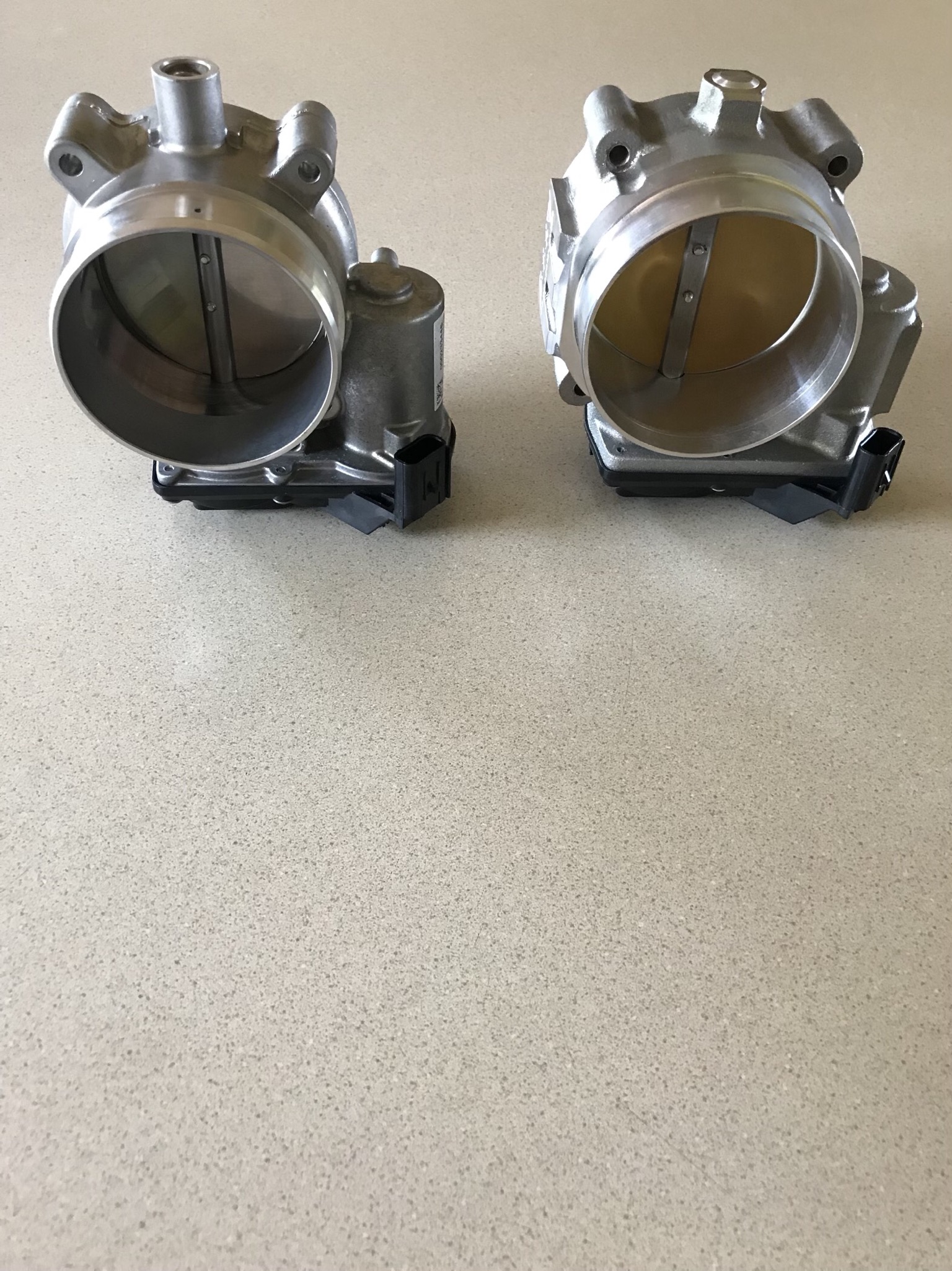

I know I posted a picture months back of the BBK 85 mm throttlebody I ordered, but here is a side-by-side comparison of the stock Ford 80 mm throttlebody on the left and on the right is the BBK 85 mm throttlebody. The side-by-side comparison doesn’t look much different, but the additonal 5 mm was actually rather significant just in terms of how much larger it really is. The build quality on the BBK 85 mm throttlebody was just as good, if not better than OEM with the construction, fit & finish.
{Notation: Just from reading on various sites, the stock Ford 80 mm for throttle body is reported to suffer intermittent ‘issues’ throughout 14-16 models, which allegedly Ford does not/has not acknowledged, so I’m content that I upgraded the throttlebody To avoid any concerns}.
Without having any type of dyno-numbers, BBK claims that you receive an additional 10–15 HP, which many have commented that it’s even more so significantly noticed if you have a tune, which I actually previously had a Bama tune, but converted over to Lund back in March.
My initial thoughts are I can definitely feel the throttle response and I can actually audibly hear the throttle body ‘Gulping’ more Air.
The only downside is when I converted throttle bodies, the ECU has to adapt a re-learn process, which I also had to uninstall my Lund tune and then have it reinstalled after the re-learn was complete, kind of inconvenient, but Lund walks you through it. [Also, Lund has superb customer service via email, and you can have a very derailed response within less than 30 minutes in most cases.]
Installed. Perfect fitment. BBK delivered.
(Minor detail, but the BBK 85 mm throttlebody looks *So* much better over the stock 80 mm for throttlebody under the Hood).

S550 owners: there's no recurring issues with 15-17 TBs, and FWIW, the BBK gains ~5HP with a tune, the GT350 is 87mm and can be sourced for ~$130 through partner Ford part dealers, there's a couple of companies making adapters for $49-59 🙂
Is there really a performance gain to be had from using a throttle body 13% larger?
This isn't the old days where you have a 400 CID or larger V8 with a 2 barrel carb, and you threw a Holley 650 on it and pulled a lot more power out of. In general, especially on performance cars, the intake is pretty carefully engineered to provide an optimum amount of airflow to the engine. Even if moving to one slightly larger opens up top end horsepower, "there's no such thing as a free lunch" and it often comes at a cost of low end power.
IF you do other things to the engine that involve moving substantially more air through it, going to a larger intake makes sense. Increasing displacement isn't that common anymore, and I don't know if folks do cam swaps on OHC-unlike an OHV engine, it seems a nightmare since-on a DOHC V engine-you'd have to change 4 cams. About the only thing left is forced induction.
They do, but it's uncommon - mostly it's people who are interested in exploring the max NA out, since it' not cost effective vs. the return. A set of (4) cams for a Coyote is like $1400 and that's a $1100-1300 install, and if you're going with most aftermarket cams, you really need to go with a completely different induction (intake>TB>manifold ... $700-1300, might require lowering the engine, etc), fuel system updates, probably way more RPM so factor in a OPG/CG swap, headers/exhaust. You run up near $4K-5K in parts (and over $6000 with labor) to get maybe 500RWHP, with power pushed up really high into the power band.
Some shops do a turnkey supercharger setup for like $7500 installed, ~650RWHP, power everywhere, and the potential to make 700, 800 with pulley changes, fuel, tuning, etc.

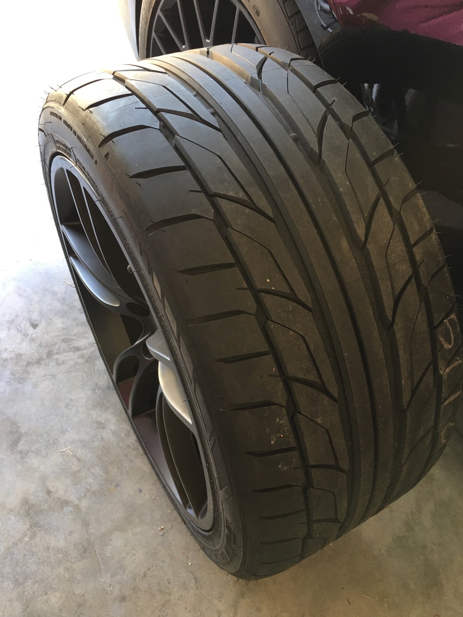

Picture of the replacement wheel. Unfortunately, when inspecting my wheels yesterday, I did find one of the wheels had a minor indentation in the finish, it somewhat resembled a ripple. I called A&M, within minutes they dispatched another wheel from their warehouse directly to me. That’s why customer service is so pivotal when choosing items like this, and I had a new replacement wheel sent to me overnight, which I received less than 13 hours and this one is perfect like the rest of the others.
This 20” charcoal wheel is just awesome.
