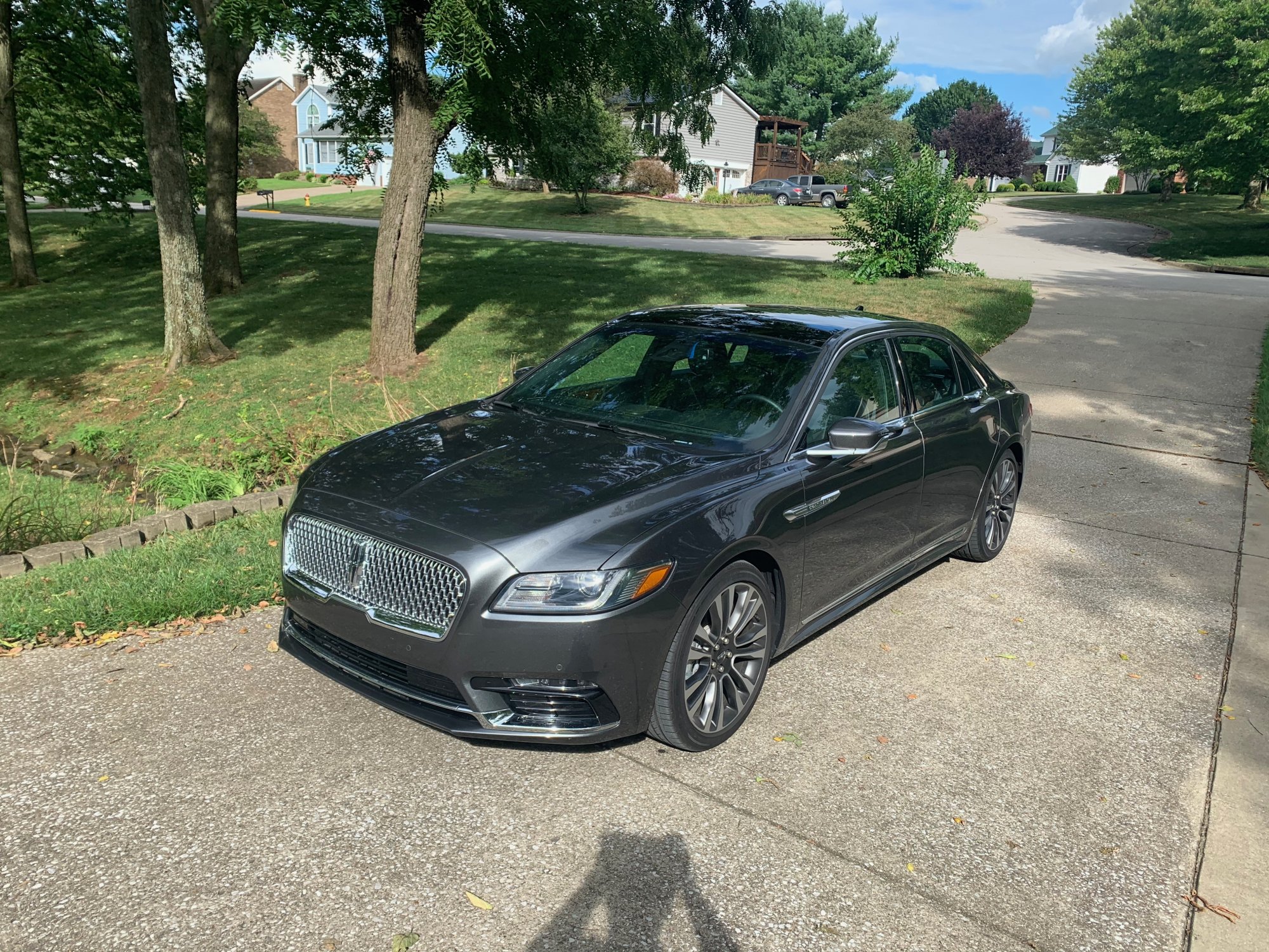

Your dad made a good choice. Looks rather good. I'd think it were a Jaguar based on first maybe even a third glance. Loving the neighbor's lawn across the street. Looks like they use a powered reel motor with a short cut length, and in a hatch pattern. Makes my heart flutter a bit.
