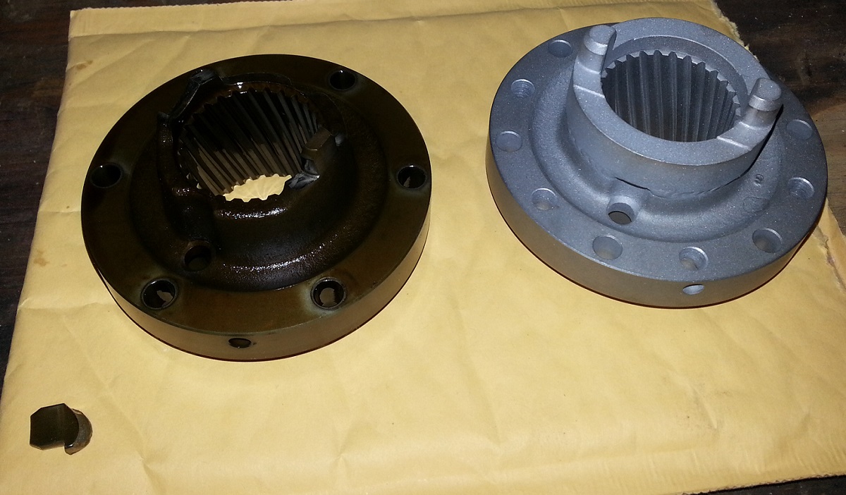

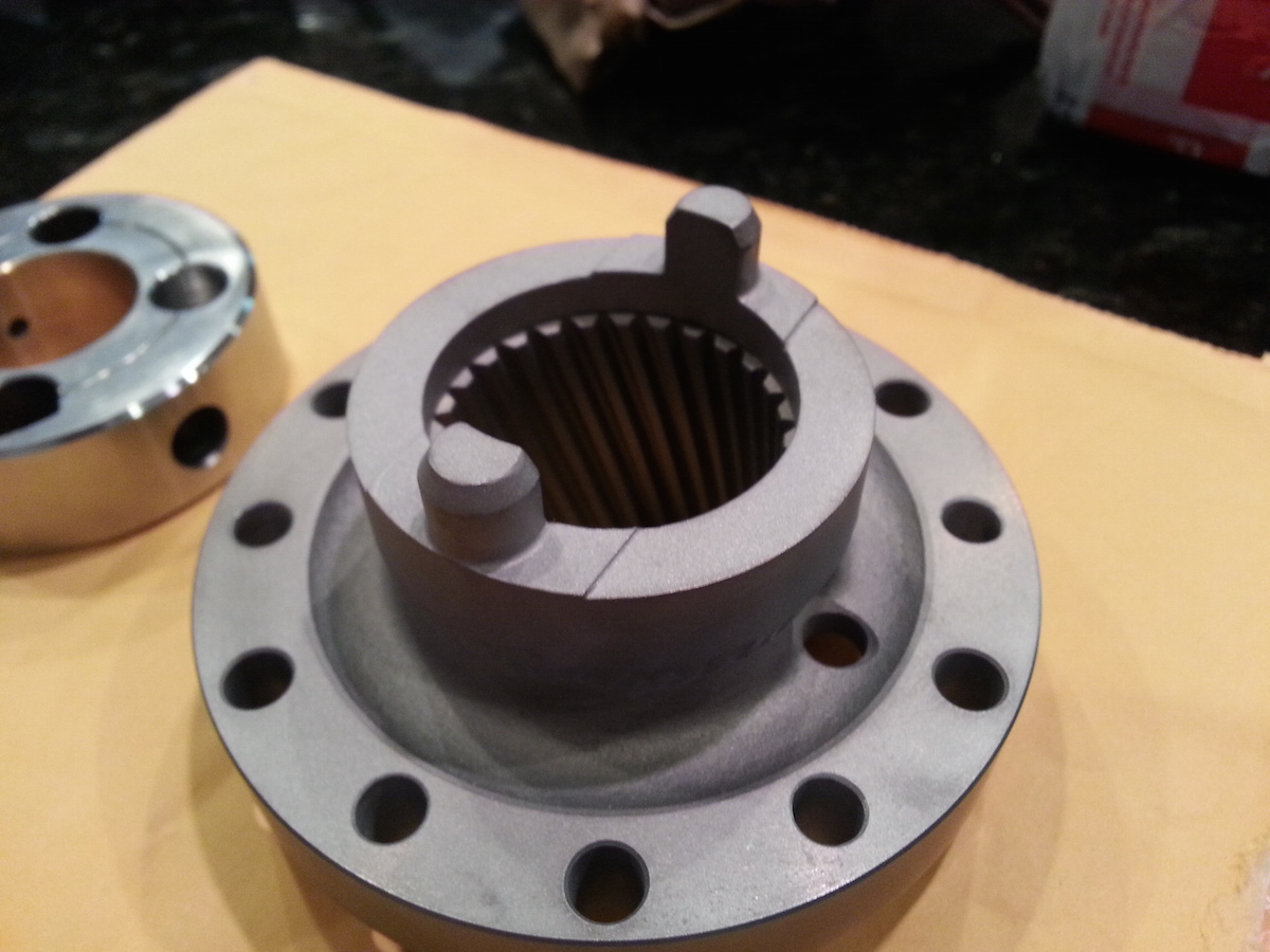

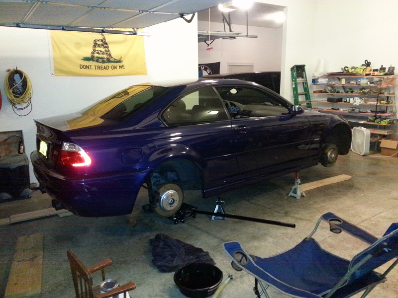

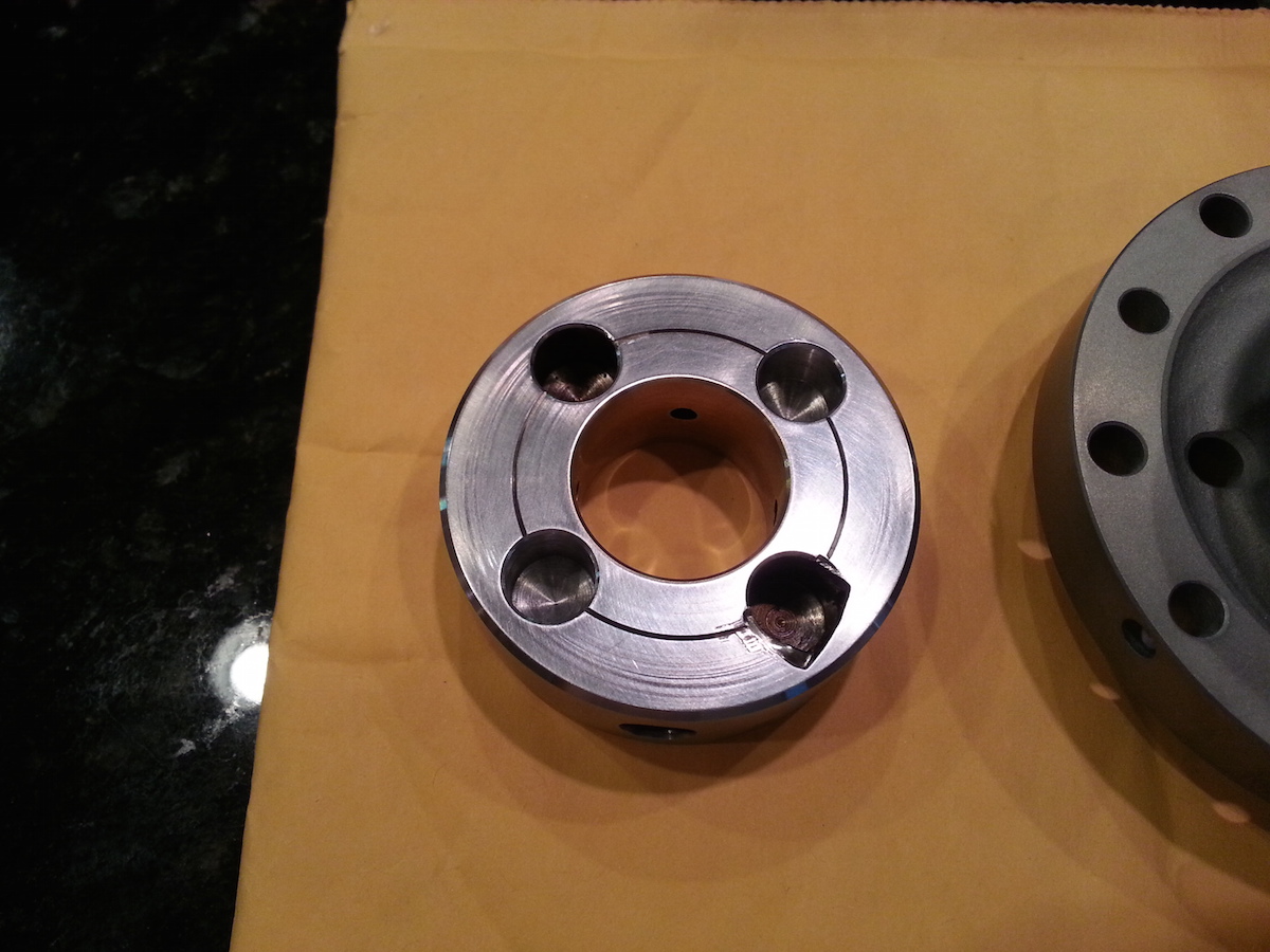

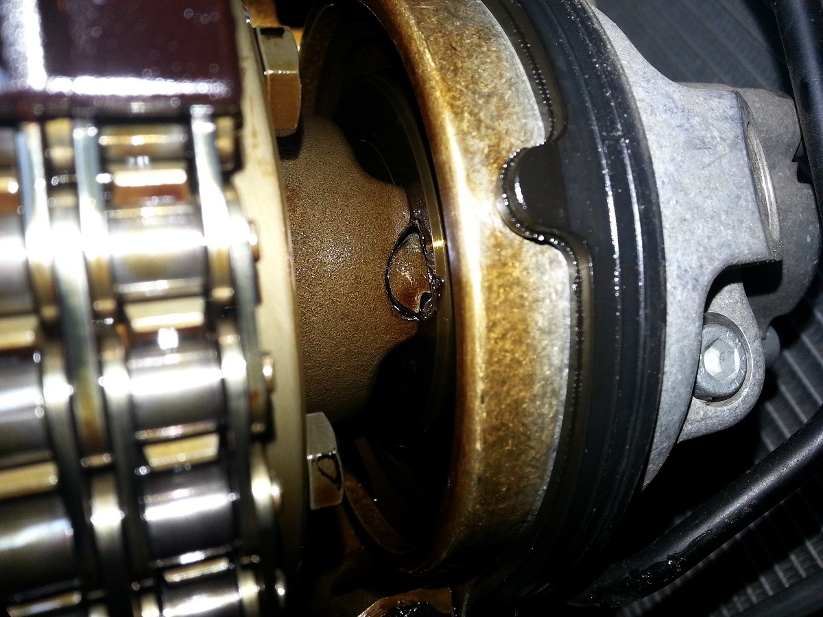

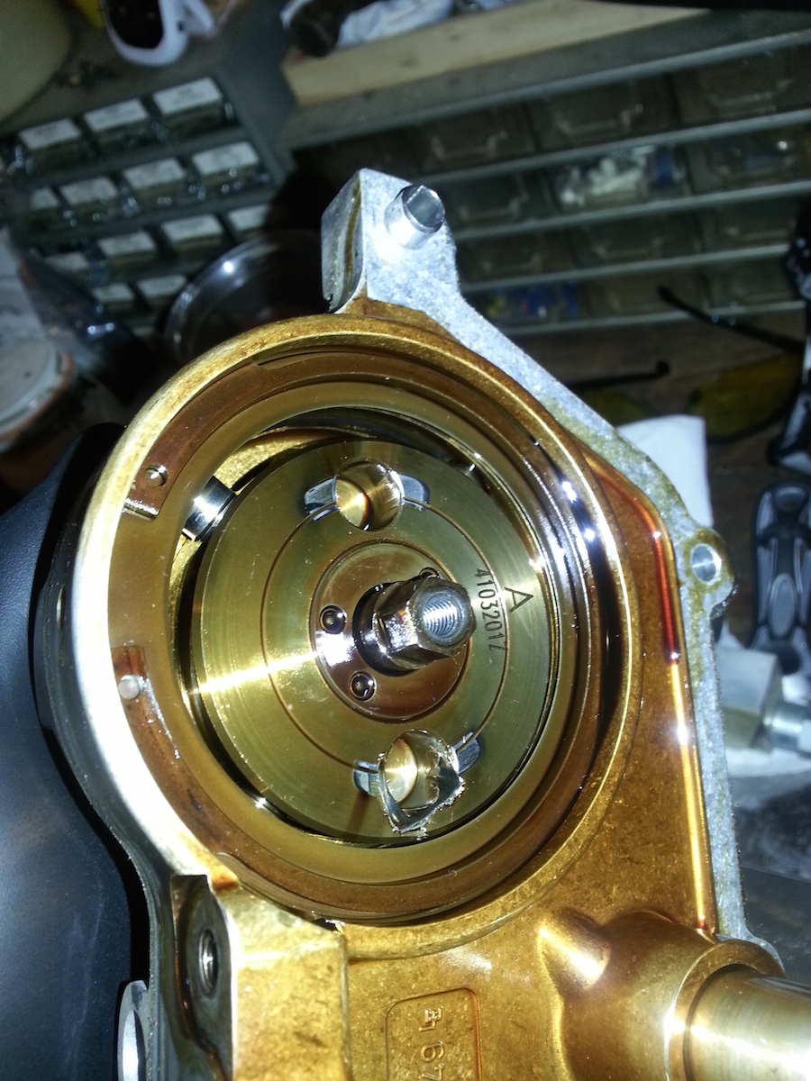

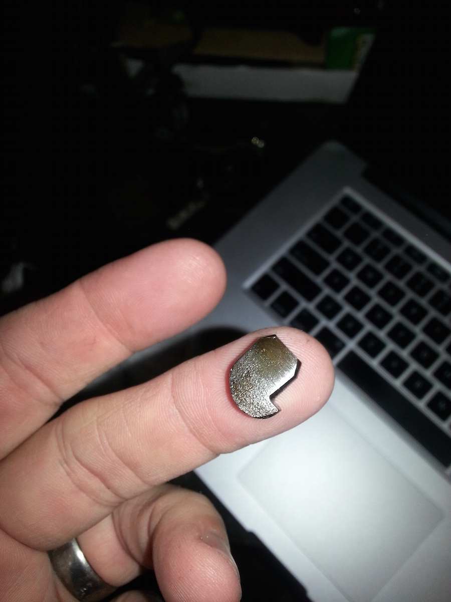

The weekend before last I set about doing an "Inspection 1" maintenance routine with my BMW. Rather than taking it to the dealer, I decided to go at it myself. It's a pretty involved process, but I figured I could handle it.
The initial plan was to do the following:
* Cabin air filter
* Engine air filter
* Wiper blade inserts
* Differential fluid change
* Transmission fluid change
* Brake fluid flush
* Power steering fluid flush
* Oil change
* Drill/tap/re-sleeve oil drain plug hole
* Valve adjustment
That's about $6-700 worth of fluids, parts, and tools. I started on Friday night. Getting it on jack stands with the wheels off was quite an ordeal. Just not an easy task with a low vehicle.
Drained the diff fluid, only to find it looked brand new. Replaced the drain & fill plugs with new and filled it with fresh Royal Purple 75w140 fluid w/ traction modifier. Trans fluid was just as easy, and also looked pretty good. Brake fluid was darker, but not horrible. Got that flushed pretty well.
Saturday I started pulling the engine apart. It's no small task just to get the valve cover off. Measured all of my valves and found only one that needed adjustment. No biggie. Swapped a shim and I'm good to go. Then I rotate my engine a bit so I can inspect the Vanos for a common problem and what do I find? Broken Vanos tab.
Sunday I spend a lot of time doing research, then dig in a bit more. Order some parts, line up some tools to rent, and get my damaged oil pump disc ready to send off for machining. Spent the rest of the week ordering crap and reading on the fixes. $760 for the hub, $150 to machine the damaged disc, $150 for a solenoid upgrade, $250 more for seals and anti-rattle upgrades, $100 worth of BMW parts, seals, and crush washers, new belts (the old ones are looking rough, fresh NGK IX Iridium plugs, and a few more tools. I figure this fix is costing me $1300-1400 on top of the maintenance stuff.
Fast forward to yesterday, and my replacement hub comes in. Do my anti-rattle treatment, reinstall the disc in the vanos, and do a little more tinkering.
Tonight I replaced my cam bolts with new bolts from Lang Racing using blue thread locker. Also drilled, tapped, and re-sleeved the oil drain plug hole with the TimeSert kit. Captured a sample of the oil when I drained it to send off to Blackstone Labs for analysis.
Tomorrow my last couple parts come in and I get to button everything back up. Vanos hubs go back on, fresh bolts, more thread locker, valve cover & vanos gaskets, and so-forth. Going to dump a quart or two of 10w40 through the engine to flush out any cleaner or metal shavings that may have gotten introduced from the top end work of the drilling & tapping operation. I think I'm good on the latter as I coated my bits with white lithium grease to trap the shavings.
Looking forward to driving the BMW to work on Thursday. Been sitting for almost two weeks now.
