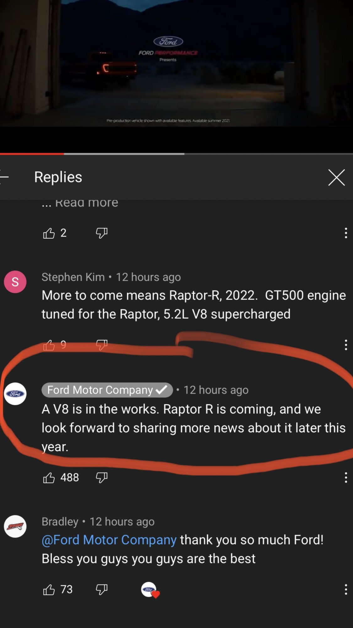

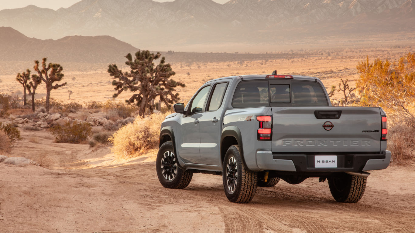

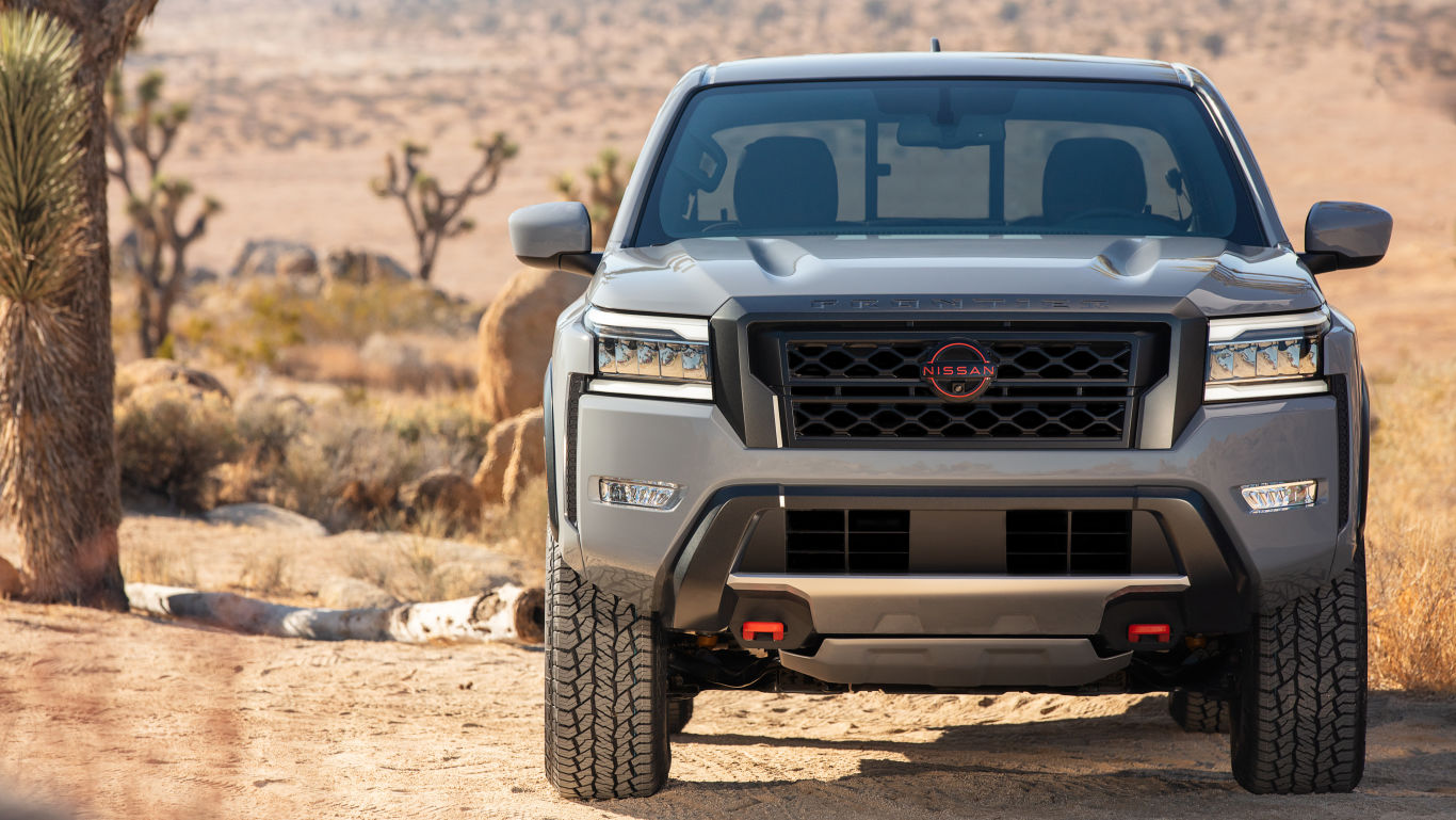

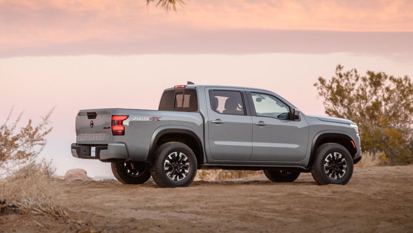

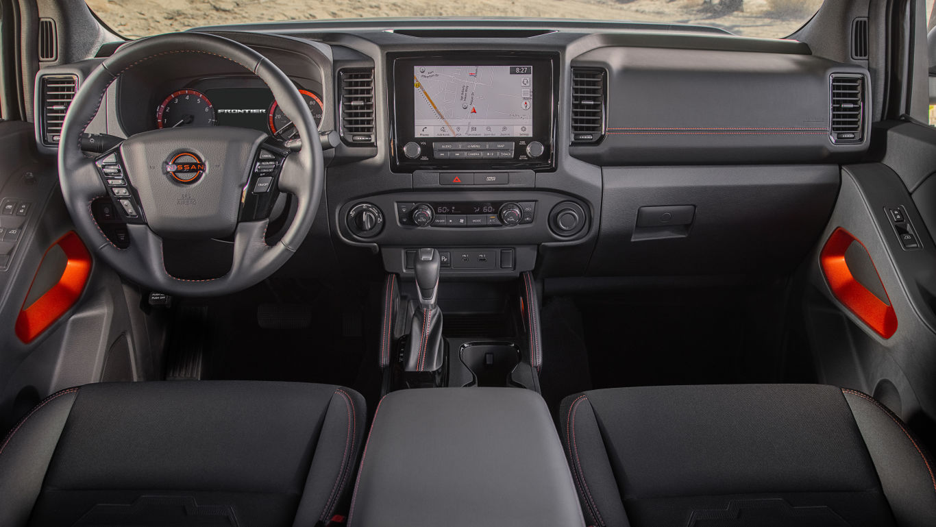

Oooh, more car (Well Truck talk..)
But.....but.....wait for it.........
Confirmed from the source themself:
Huge news.
