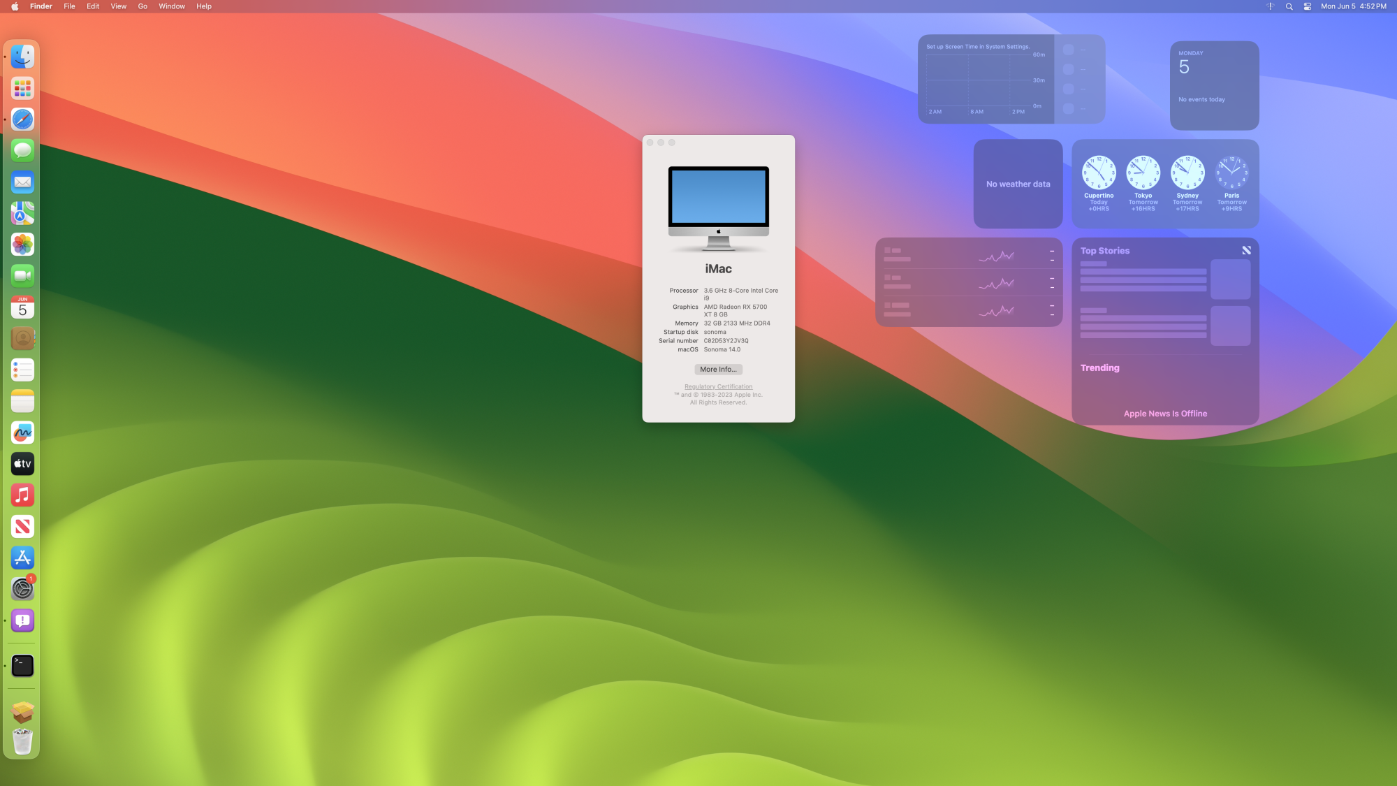

no wifi...
I thought 2019 iMac had Broadcom card?
Reactions: Flint Ironstag
no wifi...
I had no problems installing Sonoma on my Coffee Lake hackintosh but like many, no wifi. There does not appear to be a drop-in card that the OS will automatically support. I had an Intel wifi card I got to work with itlwm:

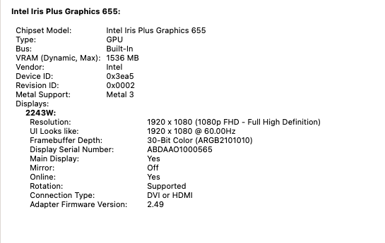

10th gen would be ideal for me, If I don't like macOS, I can just revert to windows, and move along. I think I will look for a dell system around locally with a 10th gen and see how I like it.
P.S. It has to be HD graphics too and not Iris correct?
I would think you might have an easier time of it if you took a different approach. I would try to find someone who has previously had good results with a notebook and maybe is sharing their work on somewhere such as GitHub.
Generally, graphics have to match or be able to be spoofed to something Apple is using.

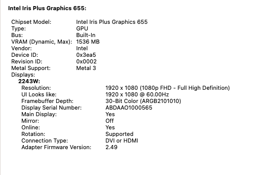

I think I would want to install Ventura with a Broadcom wifi card for better results. Broadcom wifi cards will eventually get patched for Sonoma but I doubt they will work as well.
Thanks for the information. There is a guy on youtube that has macOS running on both an XPS 13 and XPS 15 2 in 1 with touchscreen etc all working. Sounds like my kind of mac!
