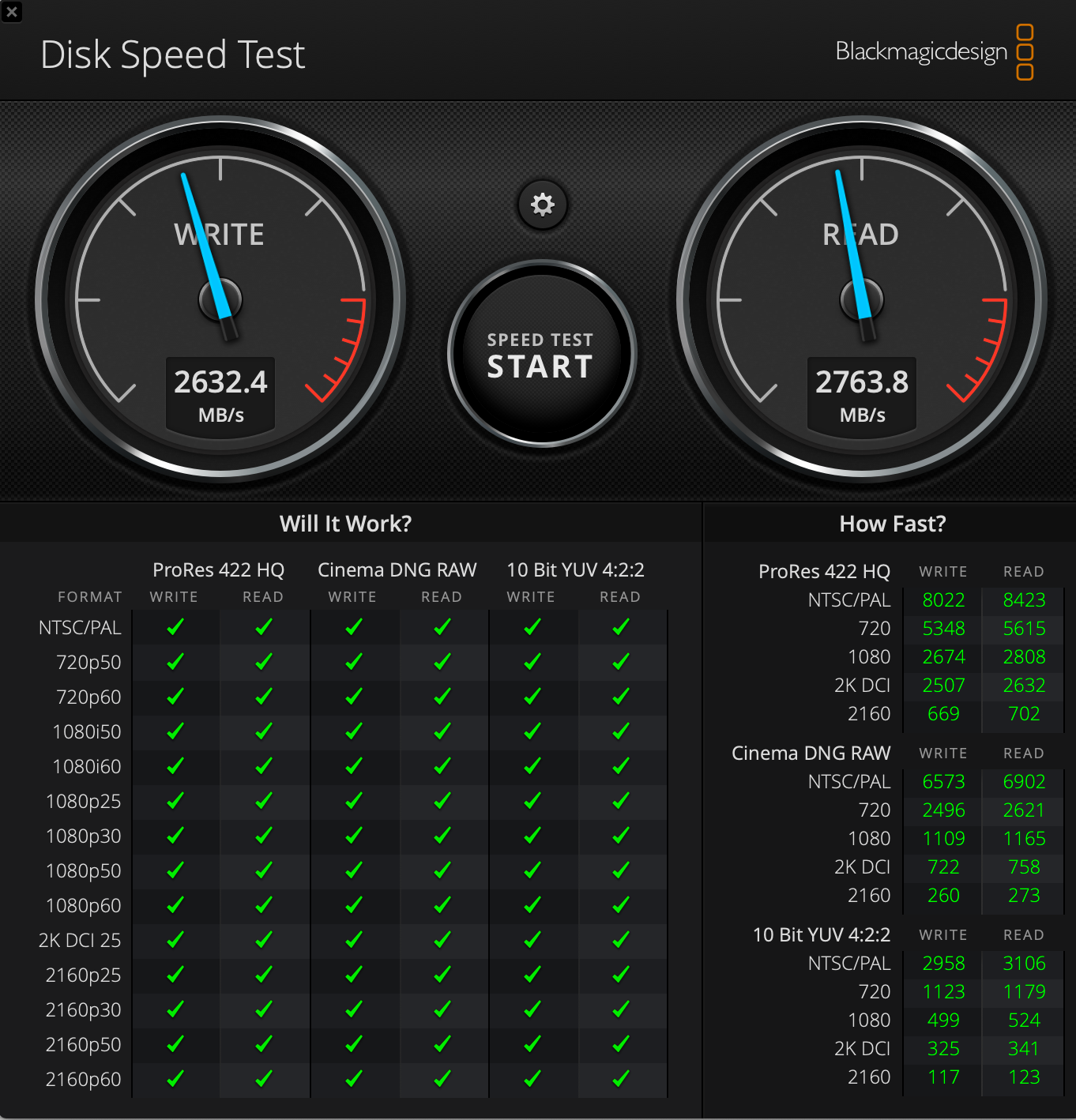

Hey guys, just giving everyone a heads up (in case you didn't see it in this thread), we now have a TB3 M.2 NVMe bare enclosure that also supports USB4/3.0.

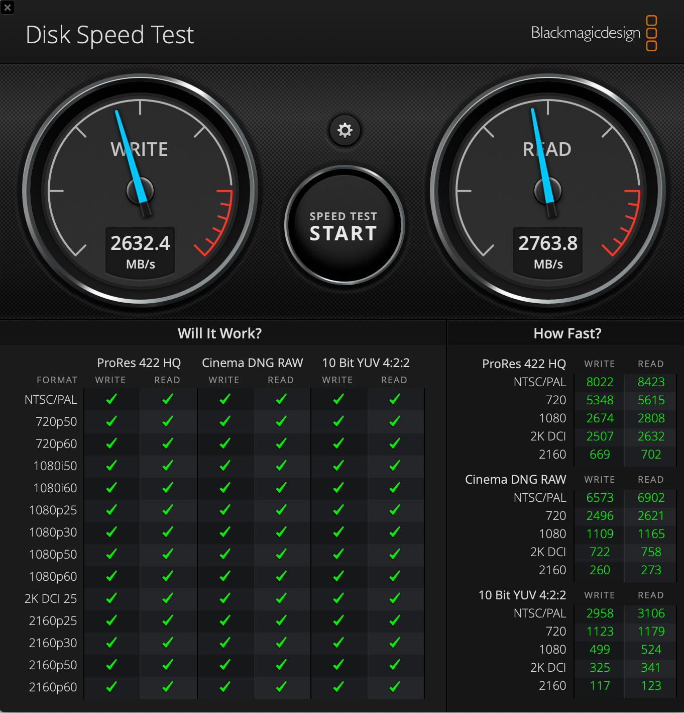

It's the ACASIS "USB4.0" enclosure, and has great read performance with my 1TB Samsung 970 EVO Plus. Write performance is still a bit perplexing, but you can se more details in my post here (same thread as above linked).

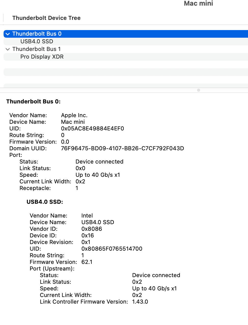

But it's not really USB4 https://forums.macrumors.com/thread...lso-definitely-not-usb4.2269777/post-29533992

That description "USB4.0 SSD" is stored in the Thunderbolt DROM of the device, not macOS. Basically, you can put any name you want there. The Vendor ID and Device ID and Device Revision and UID are also stored in the Thunderbolt DROM. You can use Linux to get the entire firmware and examine the DROM part. https://gist.github.com/joevt/4f6d4d97b560efab9603ac509bf00122
Another oddity with this enclosure: I cannot get to be recognized by my Windows PC with an Alpine Ridge TB3 card. It can't be seen as a TB3 device, at all. I know this TB3 output works, because I use it to feed my eGPU. Connection to the PC via USB-C gen 1 works fine, and Windows recognizes the enclosure/drive as JMS583 (as expected).
I guess it doesn't negotiate Thunderbolt alt mode and stays in USB-C mode which has 30% the performance of Thunderbolt mode. Maybe you can work around this problem by connecting the ACASIS to another Thunderbolt device.

Well I take the same ACASIS enclosure straight from TB3 on the M1 Mac mini, and try it on my W10 PC, but nothing. Not even recognized as USB via the TB3 port. It's not a big deal, just a curiosity.

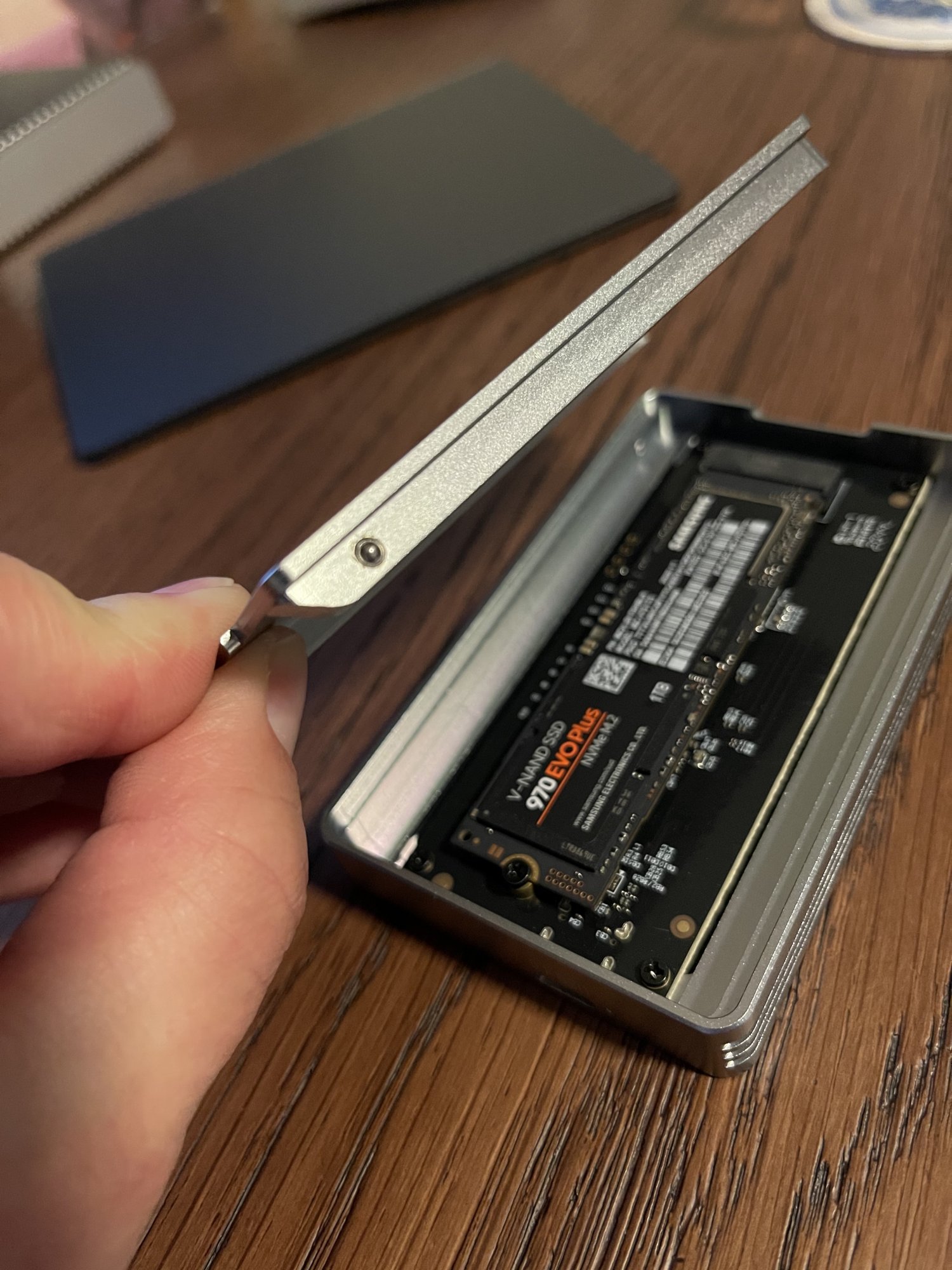

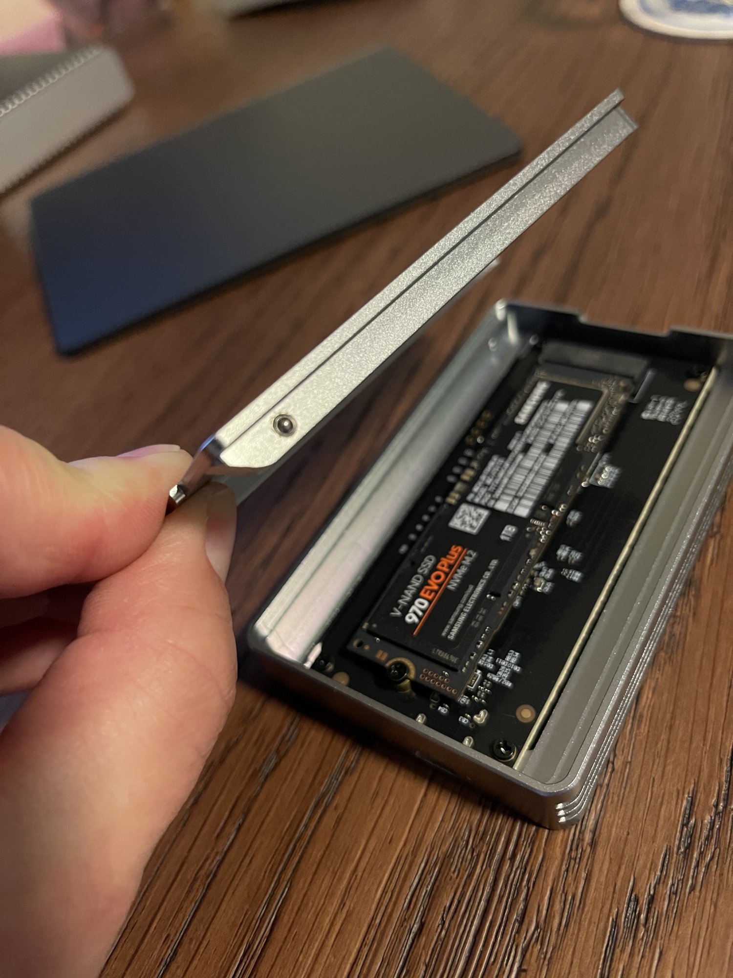

A few more thoughts on the actual ACASIS enclosure:
It feels very sturdy, and you don't need a tool to open it. It has two tiny ball bearings on the edge of the bottom cover that recess inward when you close the case.
So it should hold up to repeated openings. It's a bit bigger than it would appear it needs to be?
Assume we get some fix for the slower-than-expected Write speeds, I am pretty happy with this purchase. Which I still think is the only(?) TB3 bare enclosure that also supports USB-C hosts.

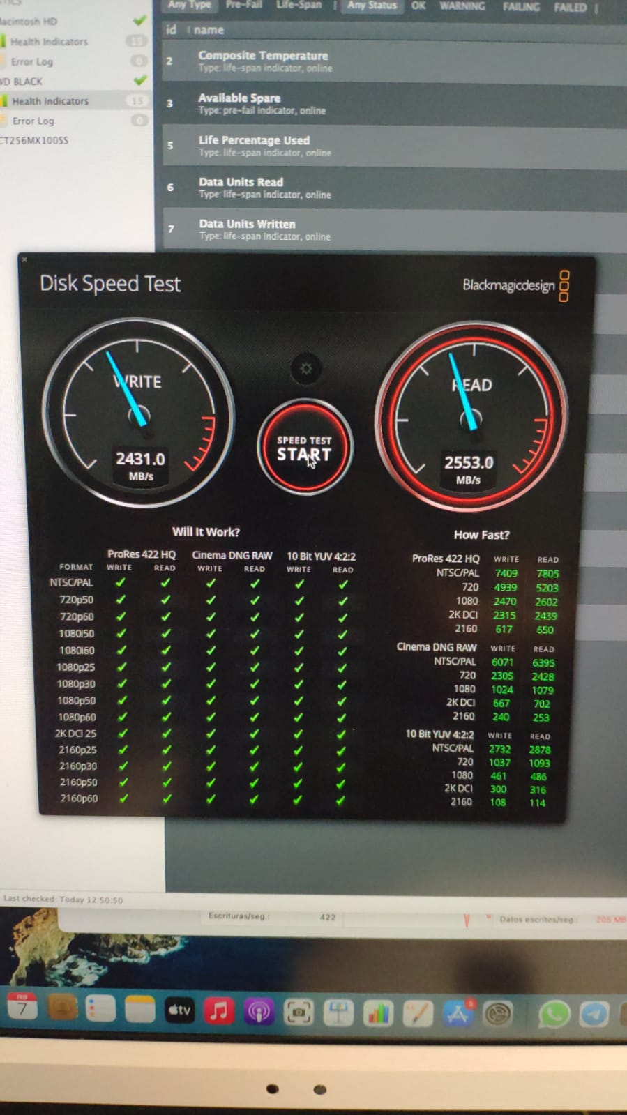

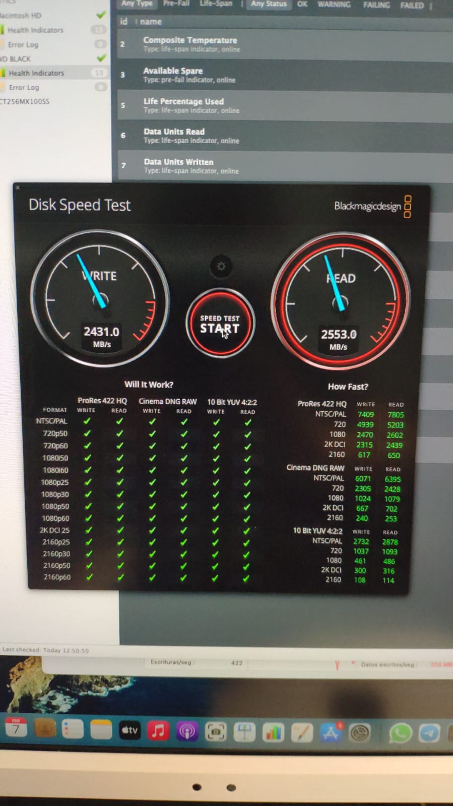

Thank you for sharing. Prompted by your post, and the video you linked, today I exchanged my 1TB Samsung 970 EVO Plus for a 1TB WD SN750.
@joevt you might be interested in this as well.
The speed test and real world transfer speed are much better with the WD SN750! This is on my M1 Mac mini and the ACASIS TB3 enclosure.

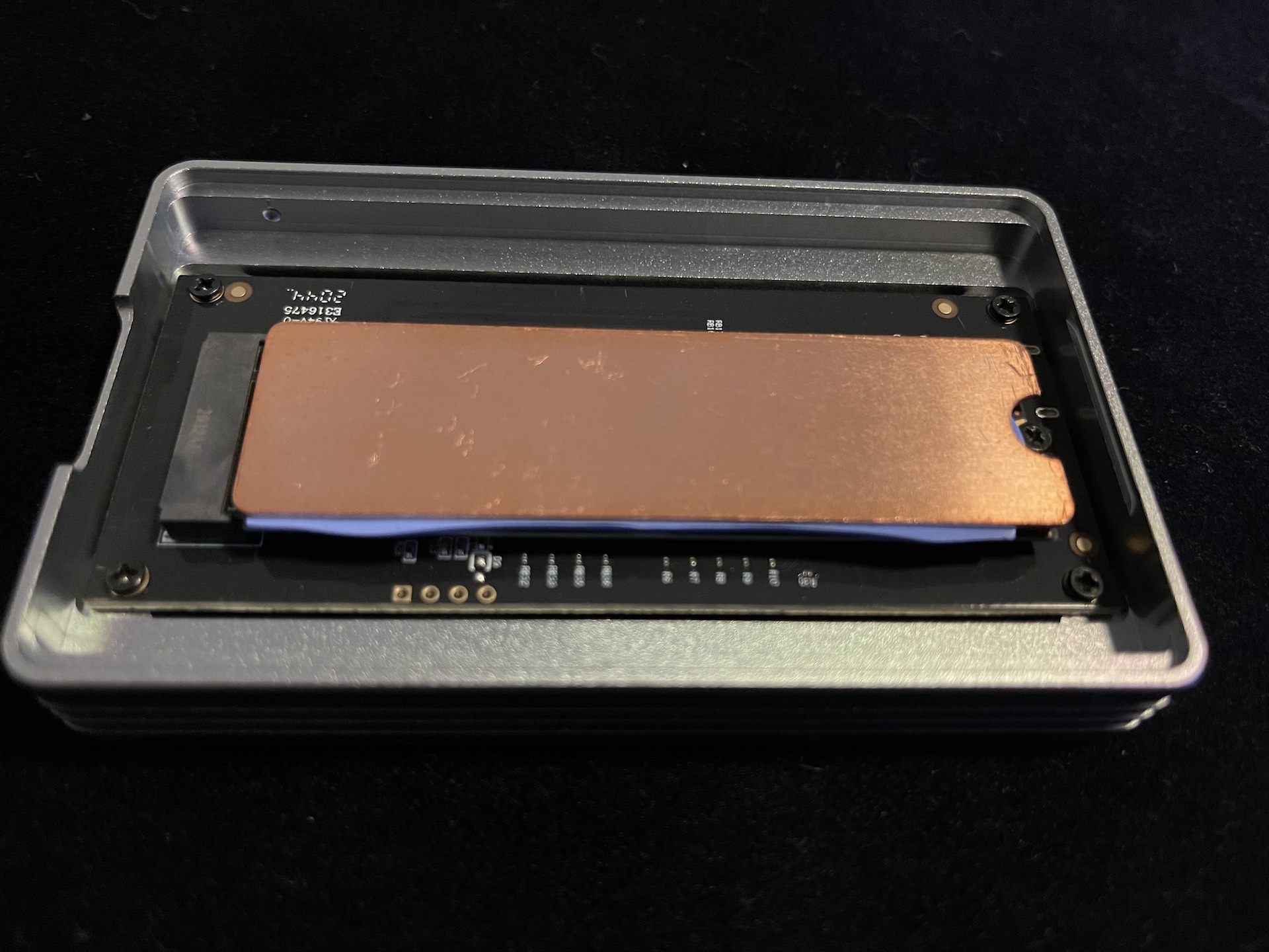

If anyone is considering the ACASIS TB3/USB enclosure, I found a thermal pad/shield that just fits, at least using the SN750. You can put both the thermal pad and the copper heatsink on, but you can't use the included rubber bands to keep the "sandwich" together. The heatsink sticks pretty well, so it's not going anywhere. Especially with the ACASIS case pressed tight.
(no affiliation)

I tried DriveDx (trial) and ran Black Magic Speed test on the WD_Black SN750 in the ACASIS enclosure with the pad/shield that I linked above. After about 5 minutes, temperatures only reached 42ºC, so I am satisfied.
EDIT: also the heatsink is more substantial than foil, it is real copper and probably 1mm thick. So the price seems decent. Mine came with 2 copper shields, and 3 thermal pads.
Howdy..
Just got the SN750 and thermal pads. Could you please send a pic of how you installed it? I don’t want to screw it up.
Are the pads permanently stuck on the nvme stick and/or enclosure or can it be removed?
I was planning to swap the SN750 around between my desktop and MBP
Thanks

Howdy..
Thanks
I think there are two different thickness of the blue thermal pads. I believe I used the thicker one. When you do it correctly, the copper shield should come into contact with the top of the ACASIS case when closed.
I don't think it's permanent, because the pad should pull off the SSD easily, same with the copper shield.
