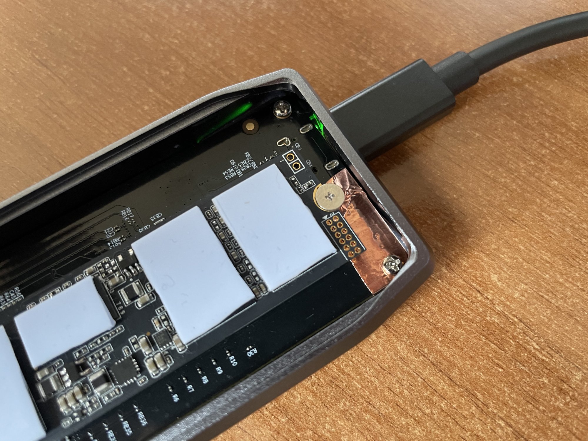

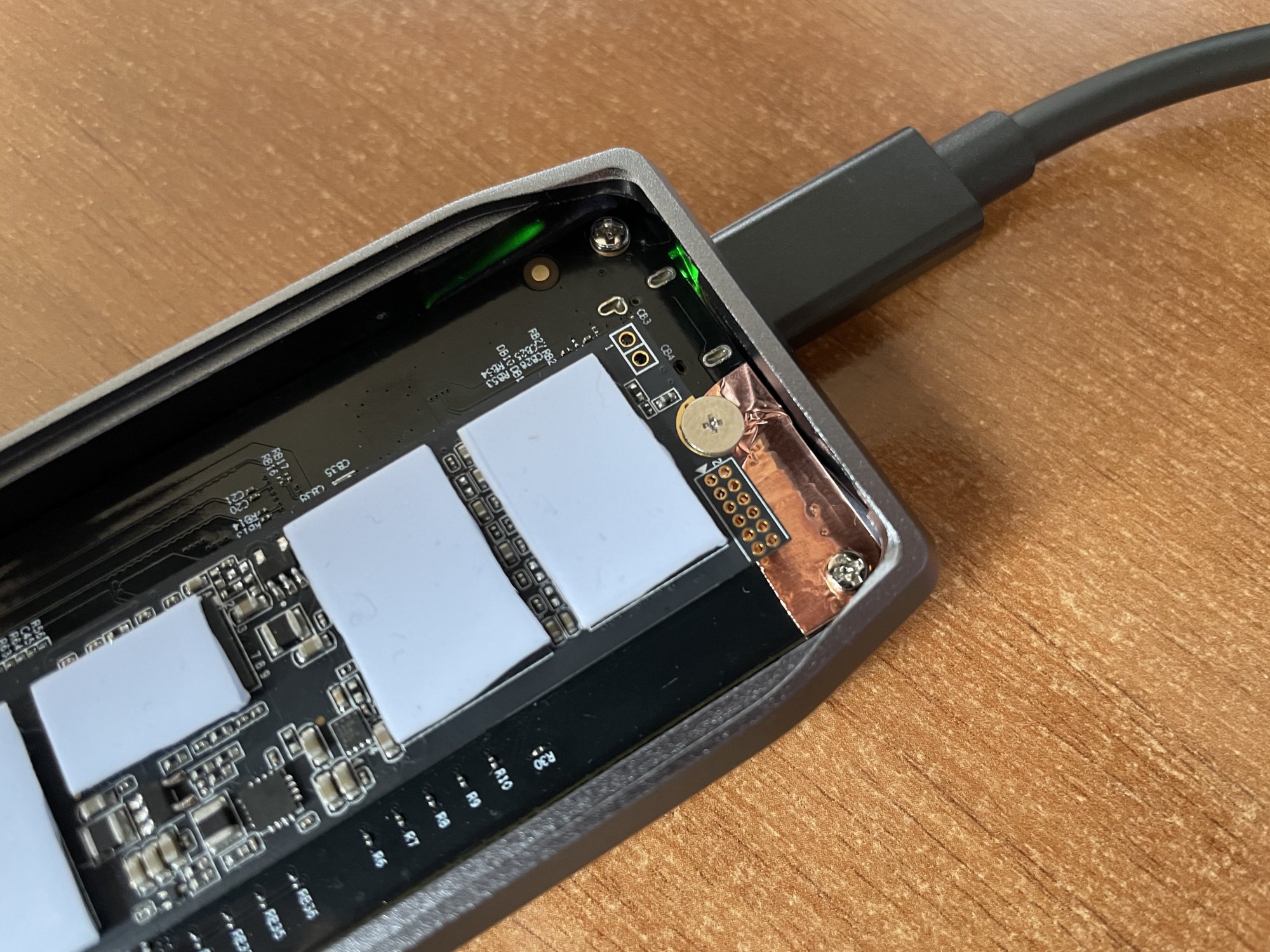

Hello again.
After my previous post I've done some fiddling with Orico enclosure and can confirm that I fixed it and made it reliable.

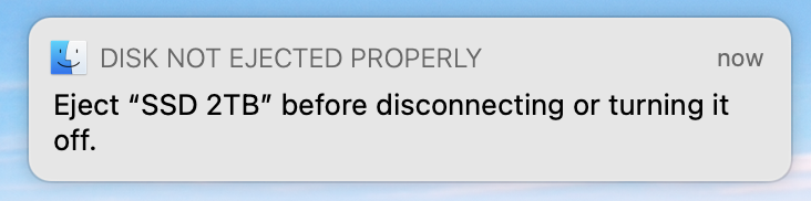

The main issue was that it constantly disconnected from my Mac. It occurred mainly when I wiggled the cable in the socket. When the cable or the connector itself touched the aluminum case the disk disconnected.
So what basically happened is that static charge was accumulating on the aluminum enclosure and it discharged to the negative lead of the cable itself and in turn to the mass of the SSD. The fact that this problem was intermittent was due to the anodised aluminum surface being non-conductive and the cable needed to touch some scratch or other imperfection while the case being electrostatically charged.
To solve this I needed to even the charge between enclosure and circuit board's mass.
I've applied a patch of copper foil between SSD mount screw and one of the case mounting screws effectively making a stable connection between the enclosure and circuit's ground. The discharge problem has gone and SSD is performing stable. I may come with a more elegant and permanent solution, but for now foil does the trick.
So whichever enclosure you use (Orico, Acasis, etc.) I recommend checking whether the circuit is grounded to the case itself.
svintuss, that's an outstanding example of problem detection and solving.
I wonder if there's any way to pass your findings along to Orico ...?
I'm also thinking the same principles you have outlined may be the cause of other drives exhibiting the same flaky behavior...

Thank you for your appreciation.
I've constantly dealt with static charge-induced disconnections with OWC Thunderbolt 2 Dock: my disks and even external monitor disconnected sporadically. After I grounded its aluminum frame to a water pipe (I know, that's not a good solution, but I needed proof of concept) it started performing reliably.
So basically what I see now is that one have to be very careful with aluminum enclosures and docks.
I hope Orico and other manufacturers will read this thread but I very much doubt it.

I'm glad to hear that. But based on the board's schematics and its enclosure I think it's mostly environment-related.
Mine worked properly at home but started behaving erratically when I brought it in my office which has a much less air humidity and a synthetic carpet on the floor.

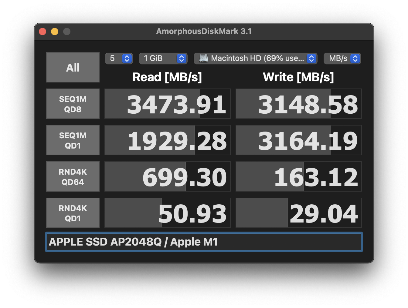

I thought I would begin to post some benchmarks using Big Sur 11.3. Here are three AmorphousDiskMark tests:
1. Native MBP M1 (11.3) 2TB drive test:

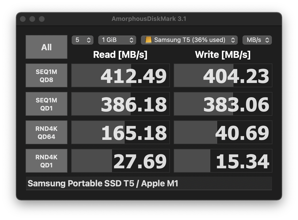

2. MBP M1 (11.3) and Samsung T5 2TB drive test:

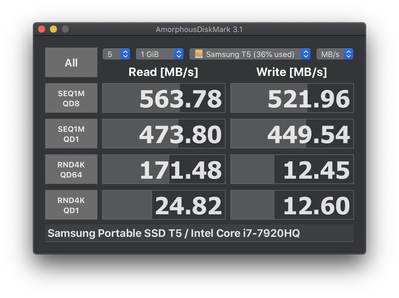

3. MBP 2017 (10.15.7) and Samsung T5 2TB drive test:
Based on these tests, it’s clear that 11.3 still doesn’t fix the disparity between Intel-based Macs and M1 Macs when it comes to the speed of direct-attached drives: the T5 is 27% slower on the M1 compared to my MBP17 running a previous version of the OS.
