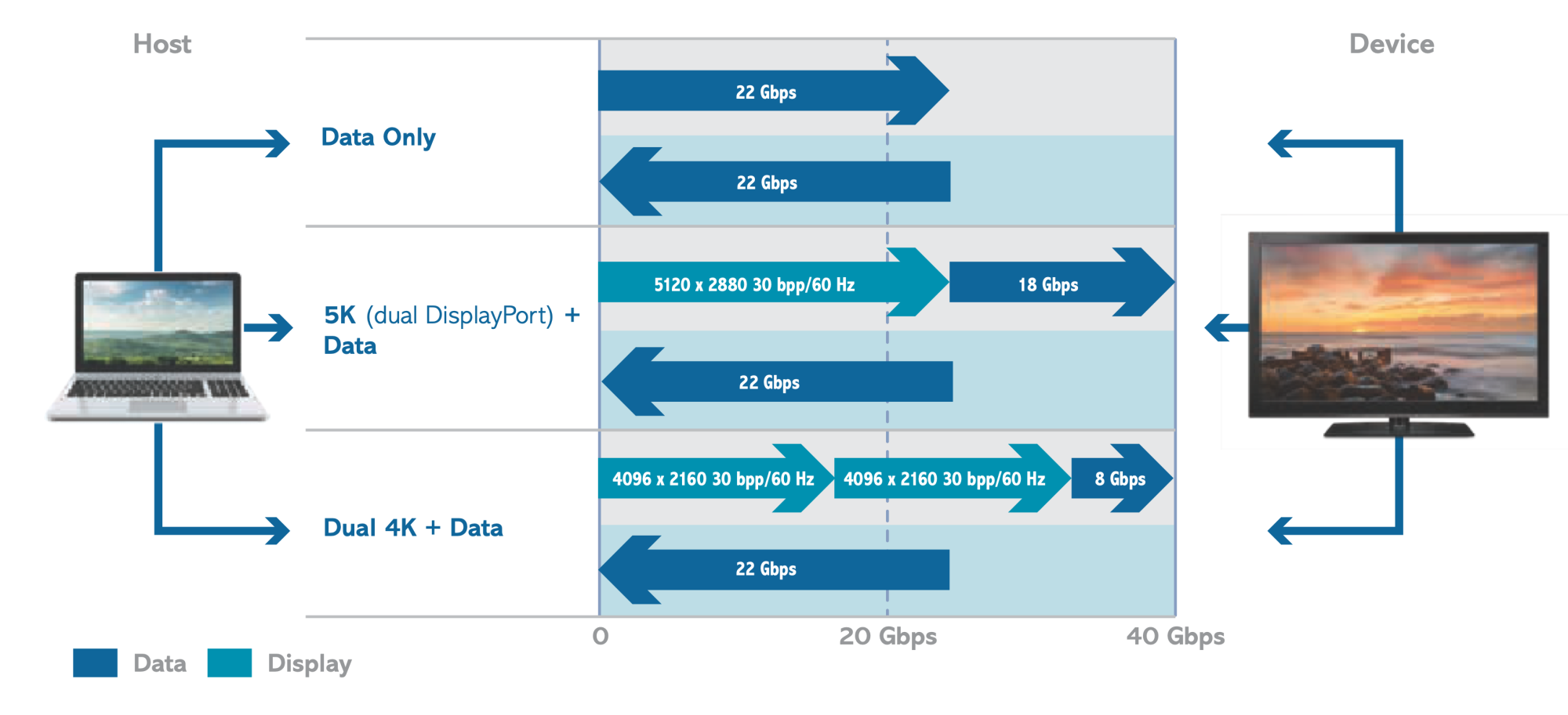

OK, I found an official source saying that 8 Gb/s is preallocated for video:
"...to fill this Thunderbolt link, the silicon extracts and routes up to 4 lanes of PCI Express Gen 3(4 x 8 Gb/s) and up to two full (4 lane) links of DisplayPort out over the Thunderbolt cable and connector to the device(s) attached downstream from the host system."
Thus, since its max bandwidth is 40 Gb/s, but the parts that can carry data are limited to 32 Gb/s, the remaining 8 Gb/s is video only.
Now what about the 2750 MB/s limit for TB3/4 data devices? The doc doesn't say, but it could be that, of the 32 Gb/s available for data, TB additionally reserves 10 Gb/s for USB Gen 2 devices. That would leave 22 Gb/s = 2750 Mb/s for the TB3 device.
Finally, the document explains that TB gives priority to video over data (makes sense--a frozen display would be much more irritating than having to wait longer for data transmittal) and, from one of their graphics (screenshotted below), it appears it can allocate up to 32 Gb/s for video (less headroom), which means it uses the 8 Gb/s from the Display Port and borrows an additional 24 Gb/s from PICe. This allows it to drive two 4096 x 2160 displays @30bpp*/60 Hz, without compression (*30 bits per pixel = 10-bit color with fulll color depth, i.e., 4:4:4):
That's the crappy marketing material I linked previously.
Yup.
Just because your car can only go 32 mph on a 40 mph highway doesn't mean the other 8 mph is reserved for someone else's car. It just means your car is not as fast as it could be.
All we know is, for a discrete Thunderbolt controller, the upstream for the controller as a host is PCIe gen 3 x4, and the downstream for the controller as a peripheral is also PCIe gen 3 x4. A single PCIe device can do up to 31.5 Gbps (after 128b/130b encoding) or ≈28 Gbps (after PCIe protocol).
That tech brief (too brief) was written before integrated Thunderbolt controllers. The upstream of a integrated host Thunderbolt controller is not PCIe gen 3 x4. For integrated Thunderbolt controllers with two ports (Ice Lake and Tiger Lake) it is known that the upstream of the controller is greater then PCIe gen 3 x4. So is there a way for them to get more than PCIe gen 3 x4 from a single port if there's multiple devices connected to the port? Probably not but but it would technically be possible since the Thunderbolt connection is 40 Gbps.
If anything is reserved for USB, it is reserved as tunnelled PCIe data since the USB controllers are PCIe XHCI controllers built into the Thunderbolt controller chip.
Thunderbolt doesn't reserve 10 Gbps for USB. Apple can use up to 38.9 Gbps for the Apple Pro Display XDR. You can connect two displays that use up to 34.56 Gbps total. When I tried, the max display bandwidth I could extract using two HBR2 connections over a single Thunderbolt cable was 31 Gbps (4096 x 2304 x 68.595 Hz = 681.76 MHz pixel clock x 24 bpp = 15.5 Gbps).
Except we've seen 25 Gbps benchmarks.
Yes, 32 Gbps is about the limit of two HBR2 connections (34.56 Gbps total).
But Apple can do two HBR3 connections up to 38.9 Gbps.
For my dual HBR2 tests, instead of using 30bpp, I used 24bpp so I wouldn't have to worry about macOS switching from 10bpc to 8bpc. Then I just increased the refresh rate from 60Hz until it would stop allowing the resolution (68.595 MHz).
Anyway this talk of reserved or allocated bandwidth is overly complicated and not very descriptive of what we're seeing. Isn't it simpler to say that DisplayPort uses what is required for the current display mode of each connected display, then whatever remains up to ≈22 - 25 Gbps (less than 26 Gbps so far) can be used for PCIe?

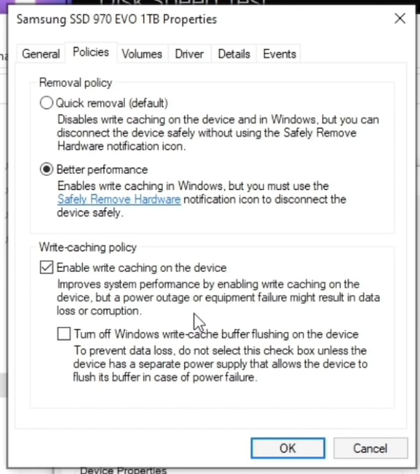

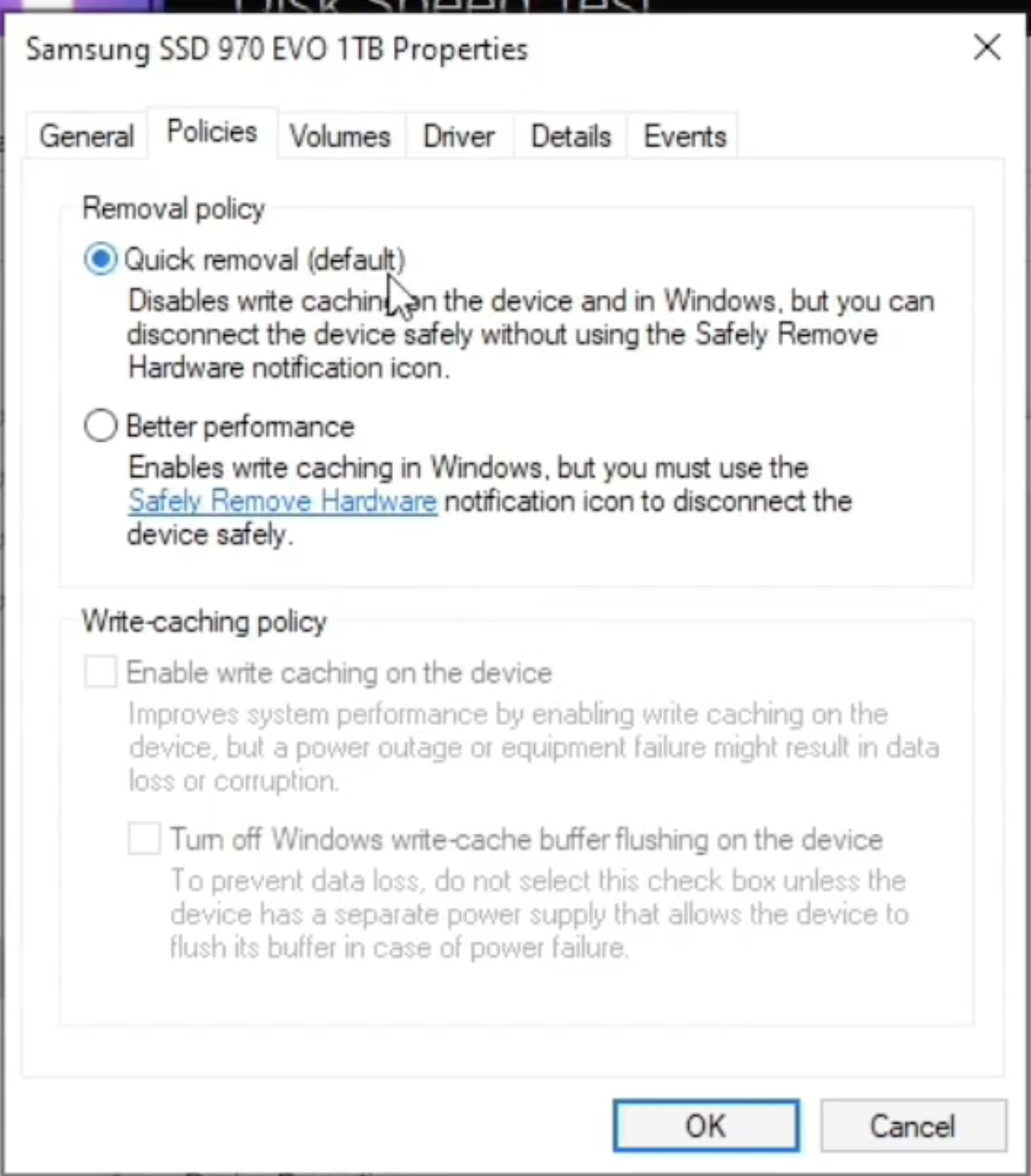

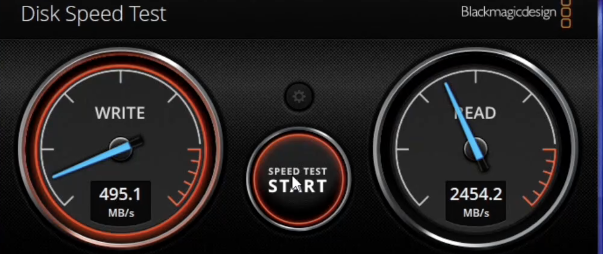

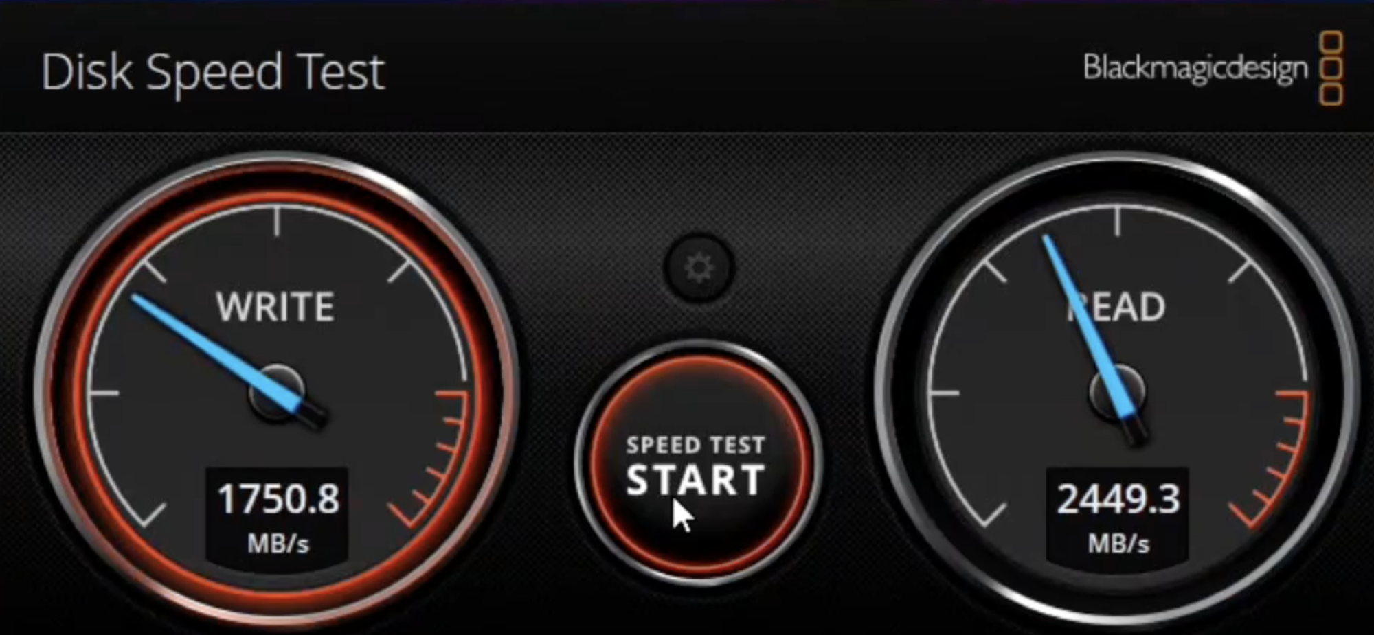

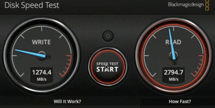

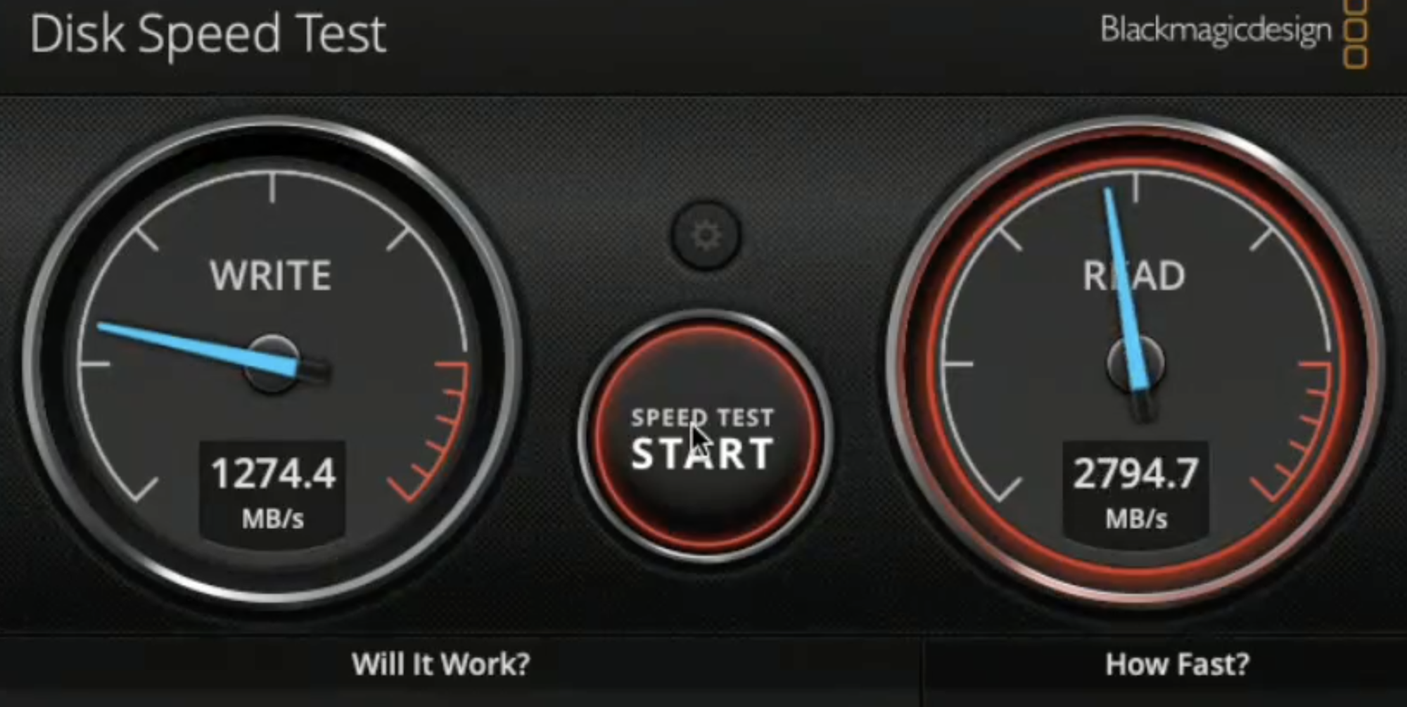

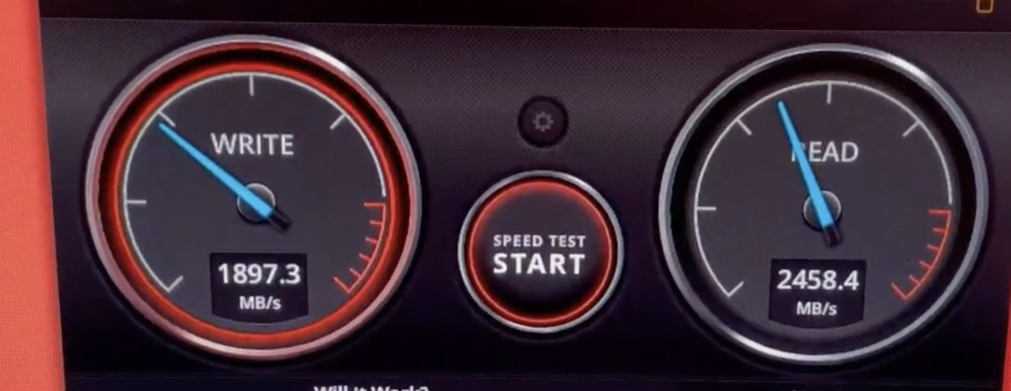

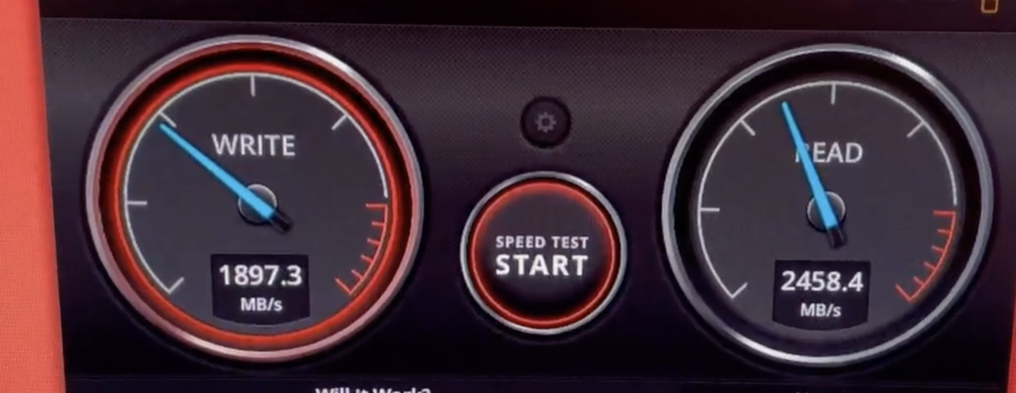

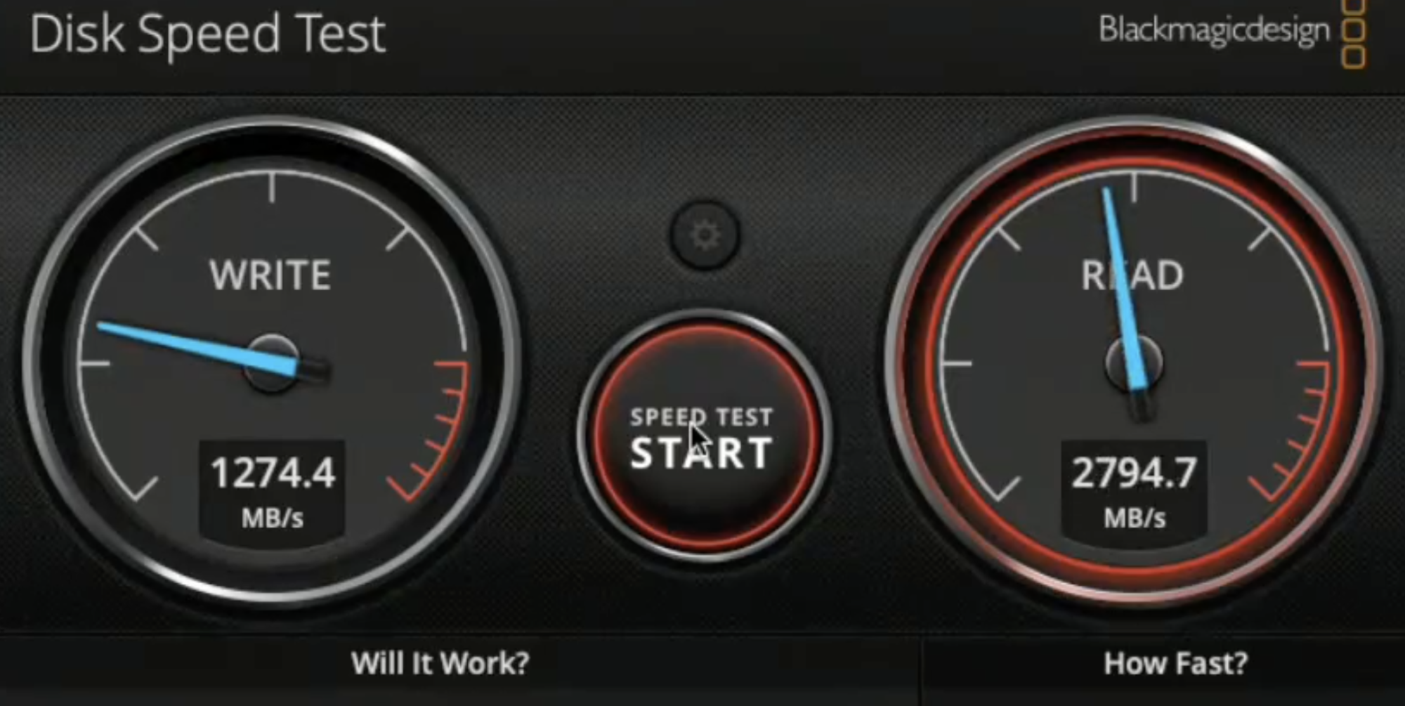

In this video (
), the poster got this speed out of a 970 Evo in an ACASIS enclosure connected to a Windows machine:
To fix this, he had to go into Properties and enable write caching, changing this (which was the default setting):
To this:
Once he did, he got this:
Do we need to be concerned about this on a Mac? I don't know how to access those settings on a Mac.

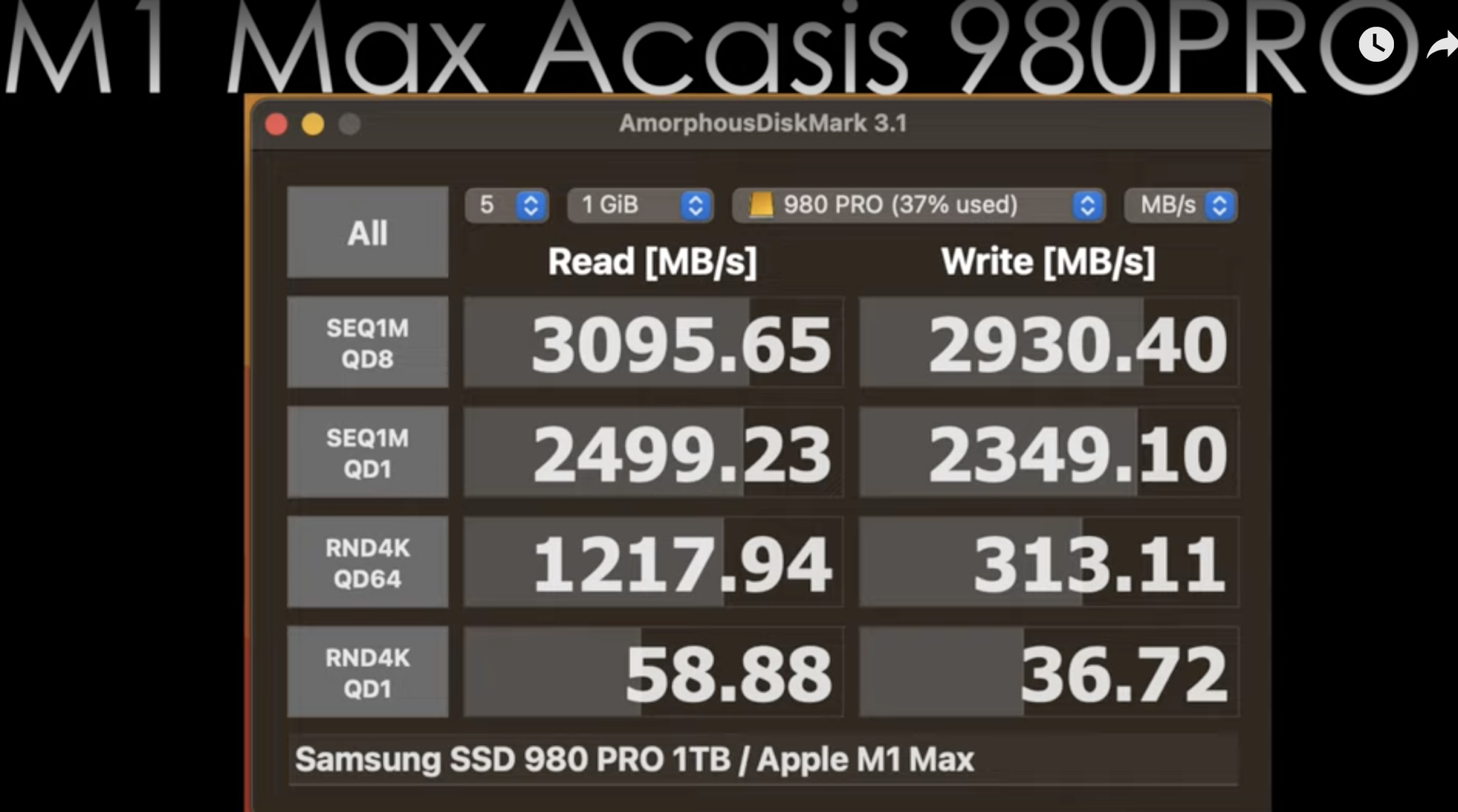

Blackmagic DST 5GB Stress on Acasis TB3/USB4 enclosure with a 2TB Samsung 980 Pro NVME. Both direct to 2019 27" iMac and 14" MBP M1 Pro, and with Acasis attached to OWC Thunderbolt 4 Hub.
27” iMac TB3 port direct to Acasis enclosure:
2521 W / 2646 R
27” iMac TB3 port attached to Hub and Acasis enclosure:
2370 W / 2637 R
14" MBP attached Acasis enclosure via TB4 port:
2795 W / 2710 R
14" MBP with HUB and Acasis enclosure:
2739 W / 2707 R
14" MBP attached Acasis enclosure via TB4 port, BUT with USC-C (non-TB/USB4) cable:
973 W / 888 R (someone asked a few pages back about USB4/TB3 enclosure speeds with USB-C cable)
27” iMac 512GB internal blade:
1857 W / 2155 R
14” MPB 1TB internal blade:
5869 W / 5333 R

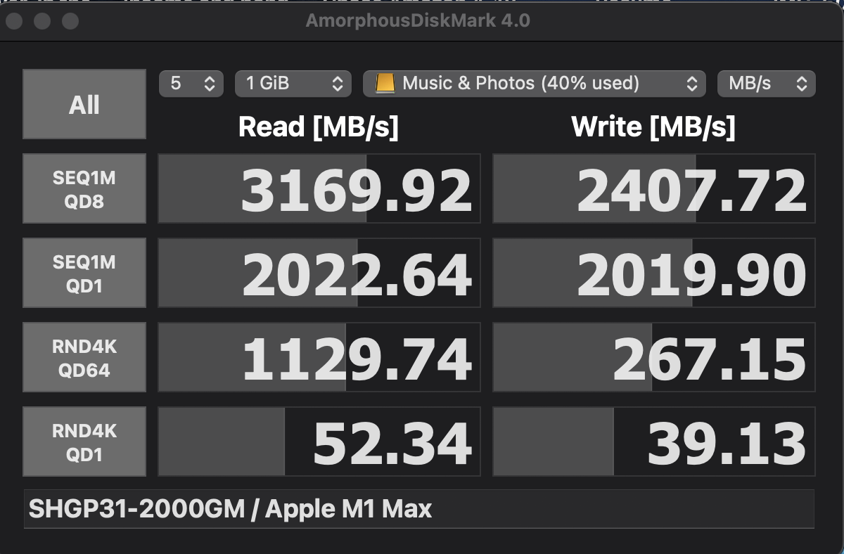

Amorphous using a P31 Gold 2 TB:
read write
seq1M QD8 3170 2407
seq1M QD1 2022 2019
RND4k QD64 1130 267
RND4kQD1 52 39

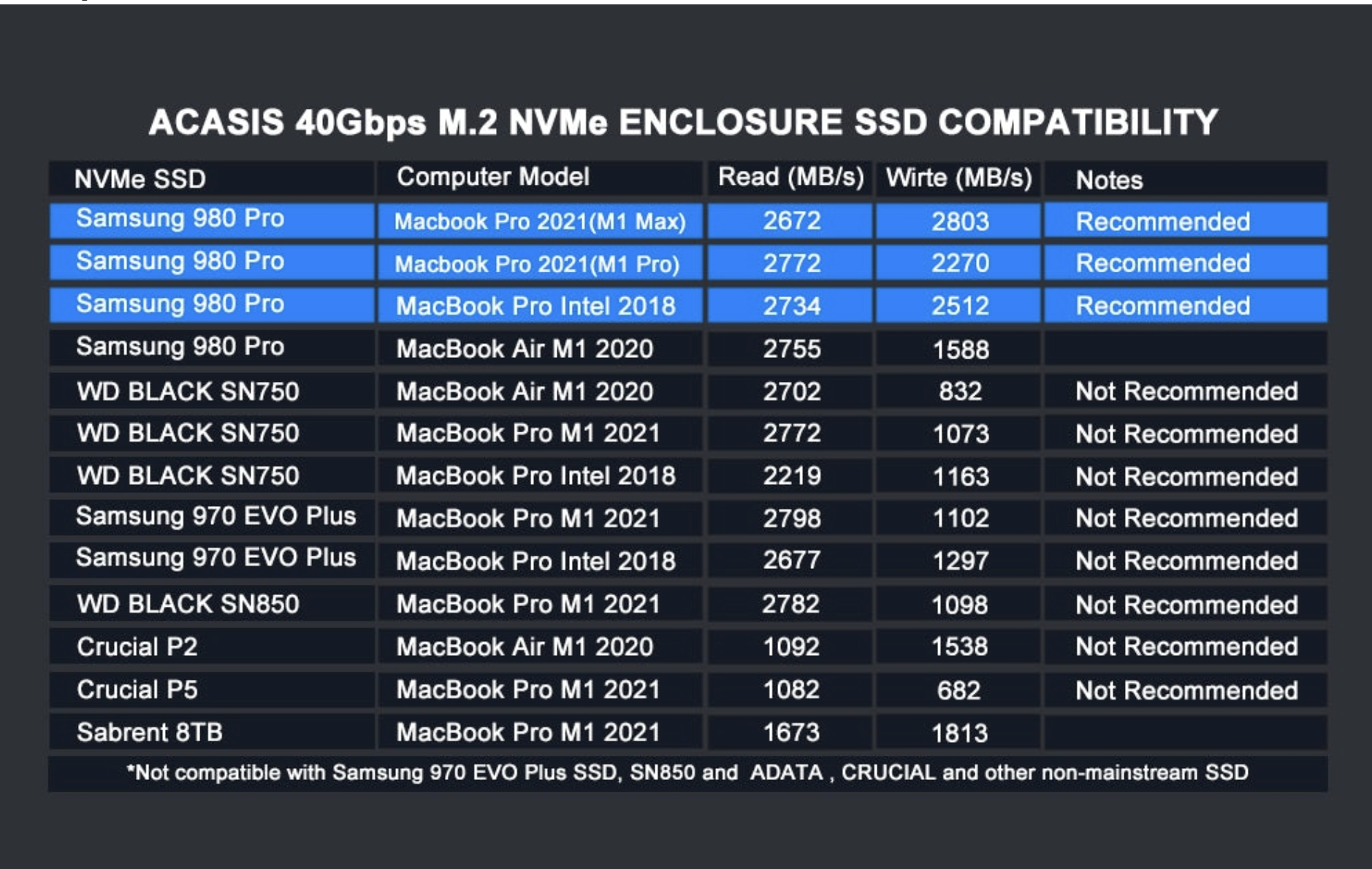

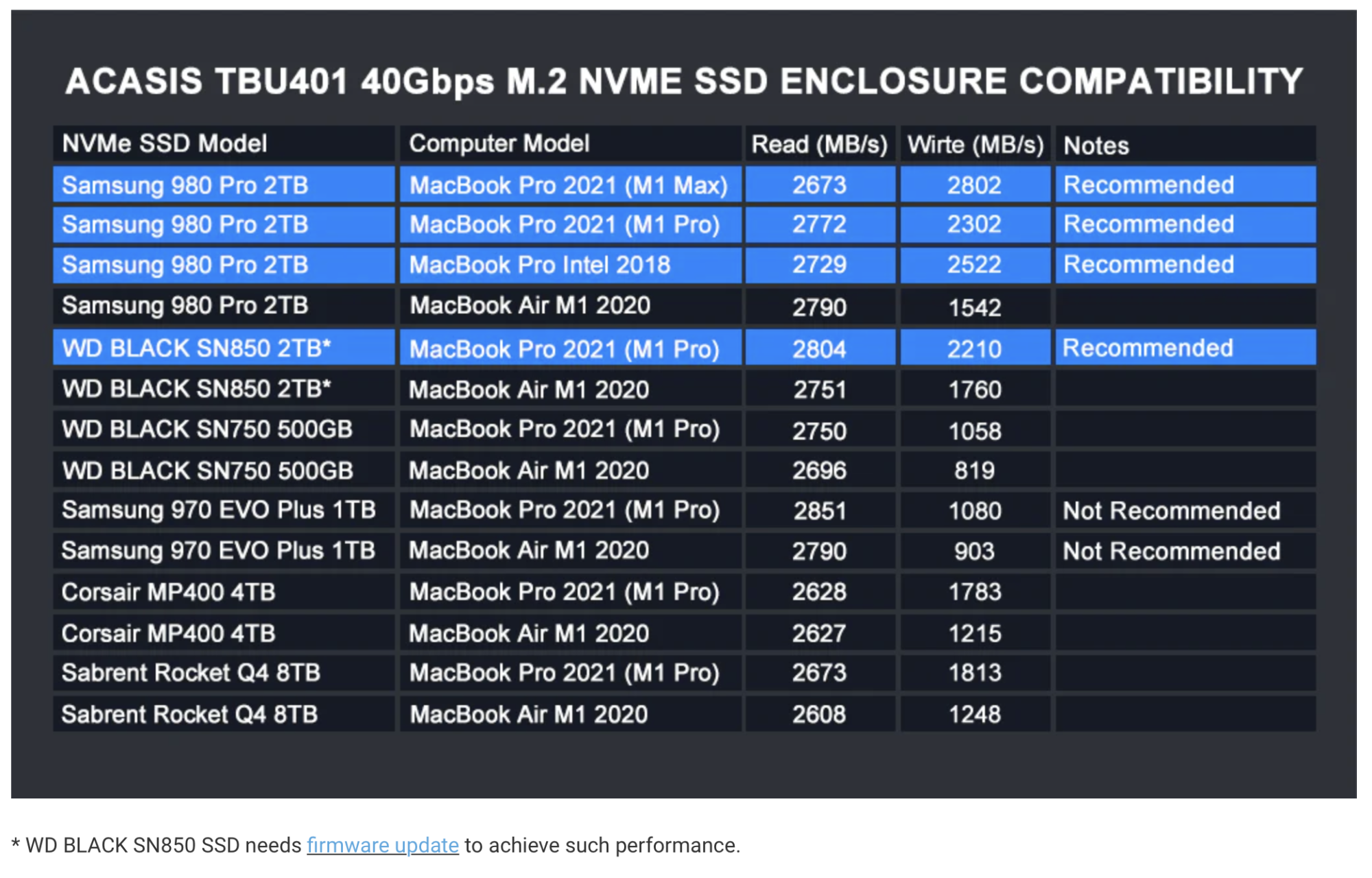

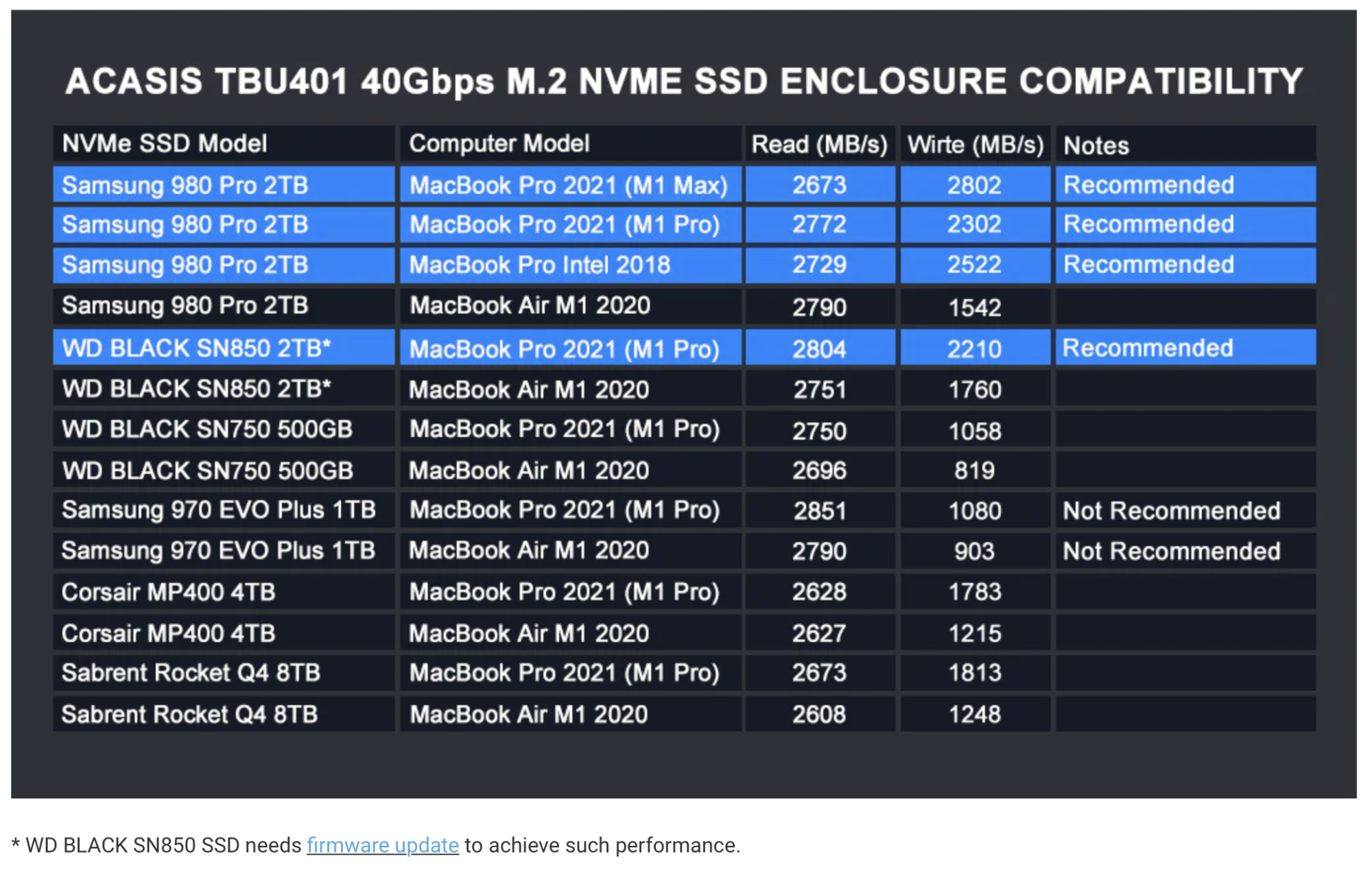

Yeah, as you probably know, ACAIS has a table showing the sequential write issues with various drives, and these might apply to the ORICO as well. Though they say, with a firmware update, you can correct the write issue on the SN850. Have you tried that? To do the update, I think you need a PC:
What I'm wondering is whether it's a write caching issue. When you connect these drives to PC's, write caching is sometimes turned off by default, which kills the write speed, but this can be corrected in Properties. In the Mac you can't make that correction (at least AFAIK, unless there's a way to do it in Terminal), so I'm wondering if that is what's going on here.

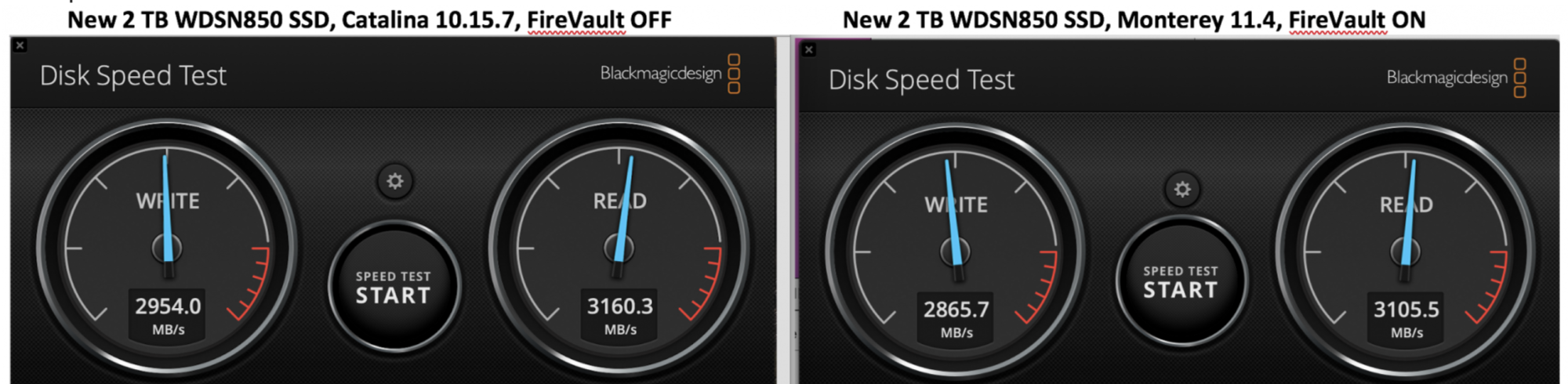

I think part of the reason we're seeing these issues is that these NVMe drives aren't designed to be use externally. So when they are, issues arise.
For instance, I have an SN850 installed internally on my iMac, and I don't get the big sequential read-write discrepancy seen when this is used externally on a Mac or PC (at least w/o a firmware update):
Note: "Catalina 10.15.7" is a typo. All benchmarks were run on Monterey 11.4.
This is the prior version of their chart. The WD850 got recommended with their new firmware. I also confirmed the Hynix P31 gold works with their latest firmware.
Reactions: dabotsonline
